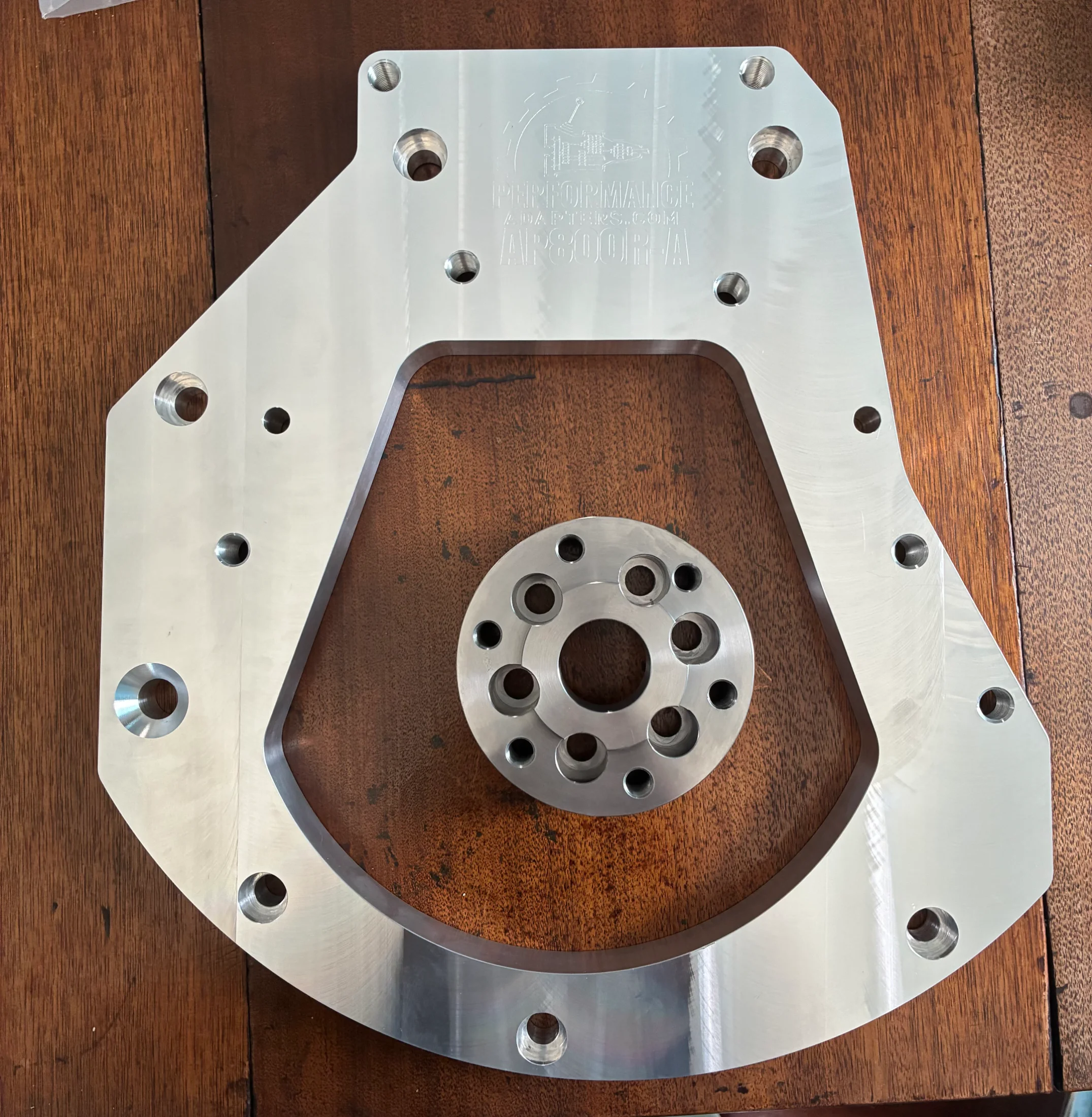

So, the adapter kit that I bought for the swap will accommodate Zeke's H42. As I don't yet own an H55... and don't need it to do the swap, my budget just got cut down big time. The H55 (and new t-case) will come along in time.

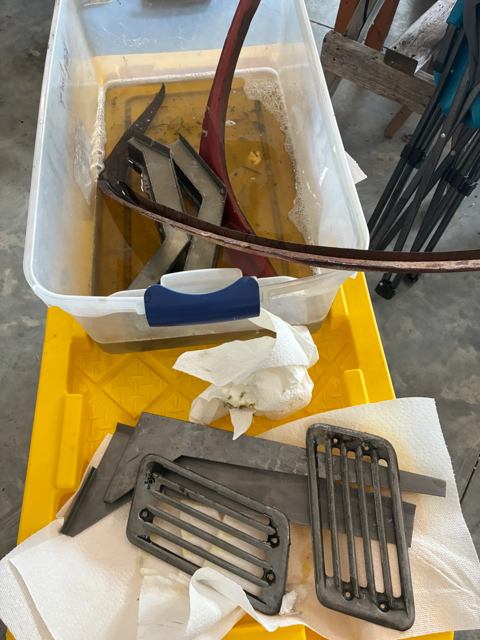

Started acid bathing some
Bits and pieces this weekend. Flash rust here stinks!
Need a few more gallons of rust dissolver to fill up a big old plastic tub. Need to submerge those fender flares (and a couple couple more) in preparation for fixing the rear flares on Zeke.
Adapter kit showed up. It is beautifully machined.
Recipe for Evaporust. For 1000ml water. Add 100g Citric acid. dissolve completely. Add 40g of washing soda (Sodium Carbonate) This will produce a reaction. After the reaction subsides add 50ml dish soap or Simple Green (Surfactant) as a wetting agent. You can find all these ingredients at Walmart. Look in the canning section for the Citric acid powder.
I like these spray bottles..
Thank you for that! I've already got all of the ingredients (citric acid for canning and such). I'll mix up a bunch of it and get a bath going. Really appreciate the info.

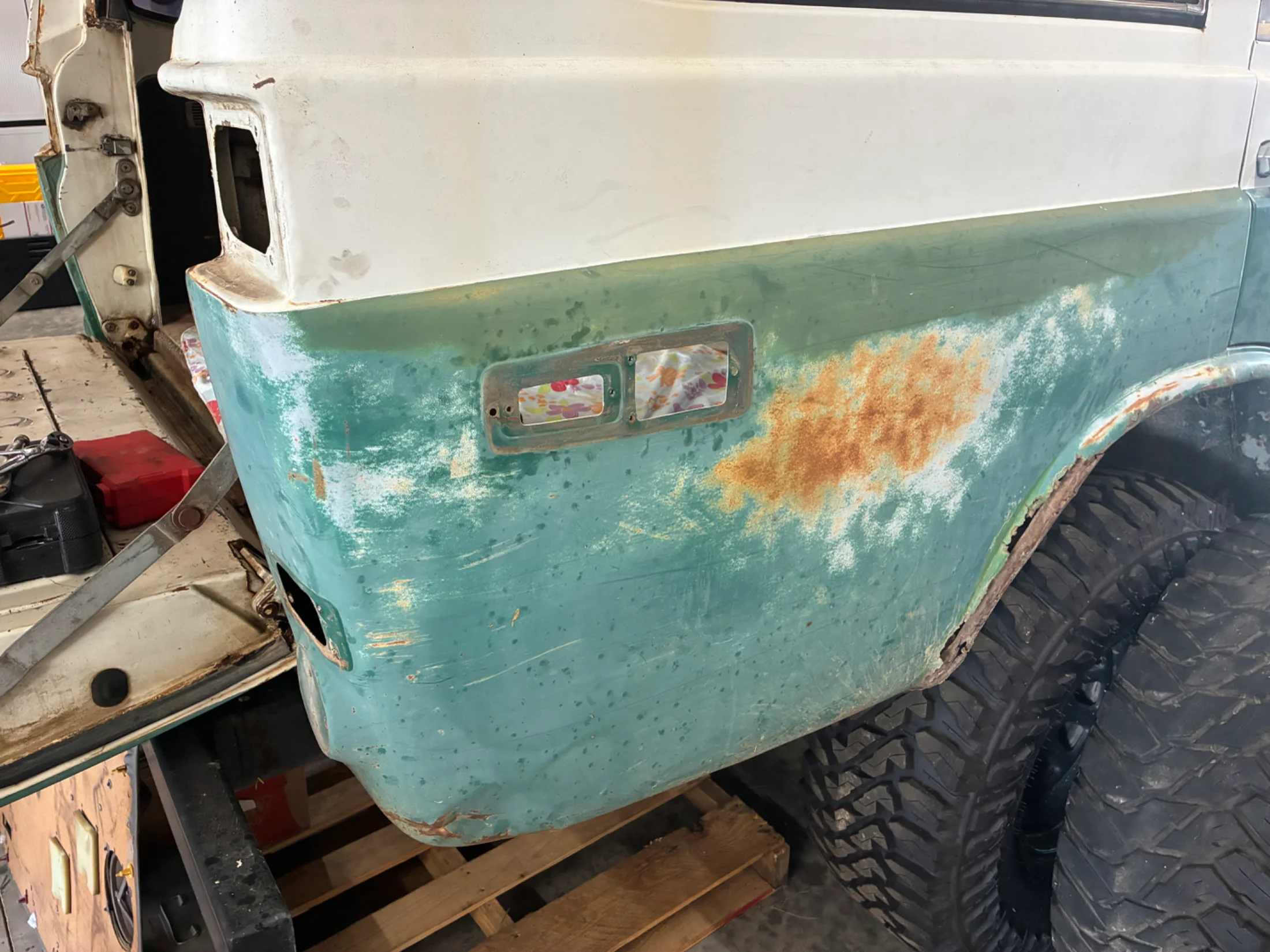

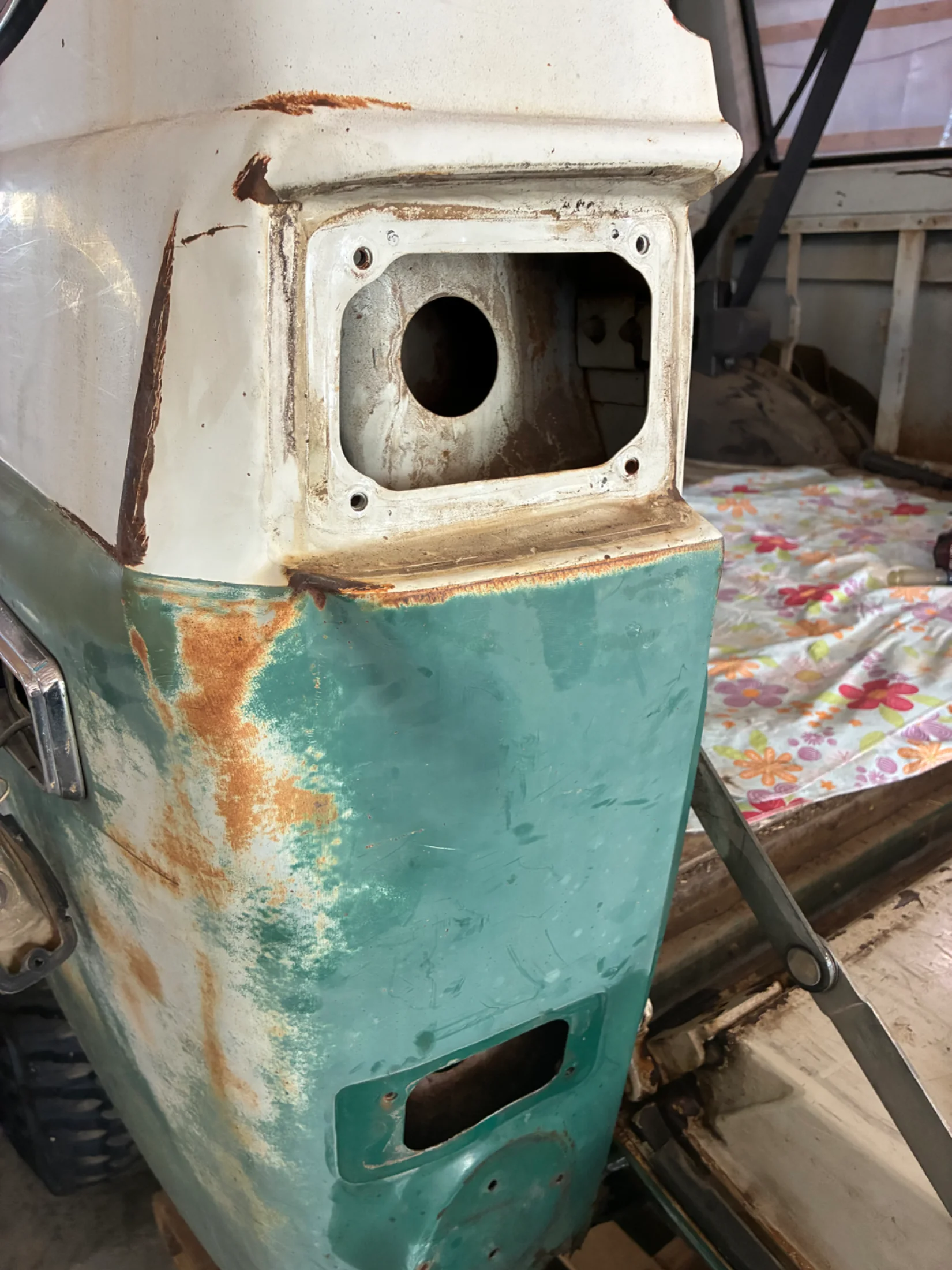

Started lubing up bolts and gently removing the rear end light. Rear ds corner has a compound dent that’s going to be a bear to straighten out… but, I’ll get there.
Couple of pics from this afternoon:
Cool! Somebody else doing bodywork - we can compare notes!
You got it. Zeke’s bones are solid, but there’s a lot of sheet my work to do. I’ll check out your thread.
Someone used deflated football and shoved in there and slowly inflated it 😉. Heat and dent puller work too 🤔🧐😉
