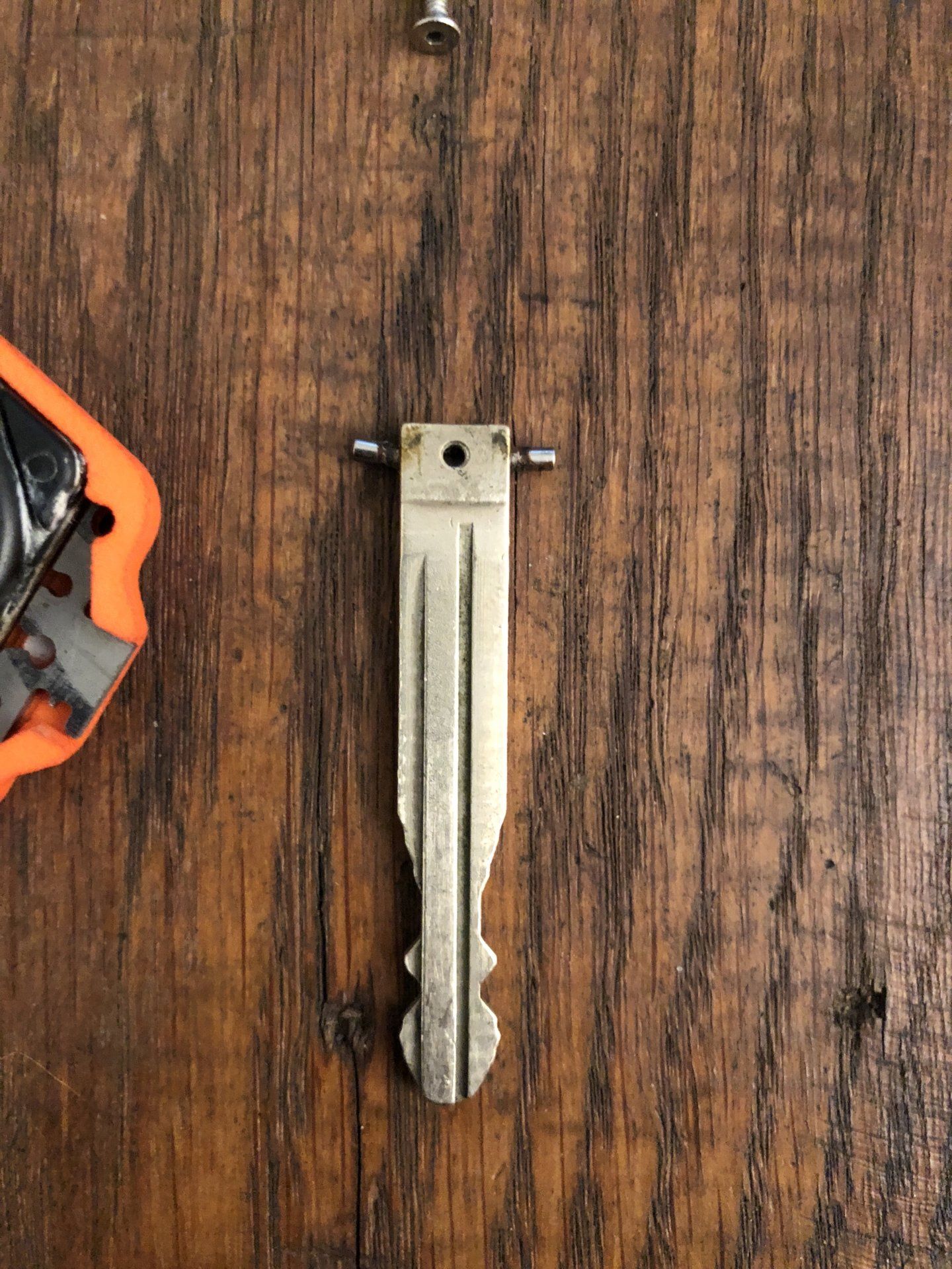

I did watch the videos but may have missed where it addresses the pins you provide in the kit for a blade with no notches
For what it's worth, I installed everything (minus the pins) last night and have been using it all day with no problems, so it may be a non-issue. Just wanted to run it by you
Whoa! That's a new style to me. I think we should call that the "Sword" style.
Id try it as is for a while and see how it does. I have an I style and a few t styles in my inventory of test keys. I've used the I style with and without the pins and the difference is minimal. If you notice any extra wiggle I'd see if the side pins in the key now will come out with pliers. Then you can use the pins as per my video.
Let me know how it goes. Any idea where that key came from? That's an extremely rare style.

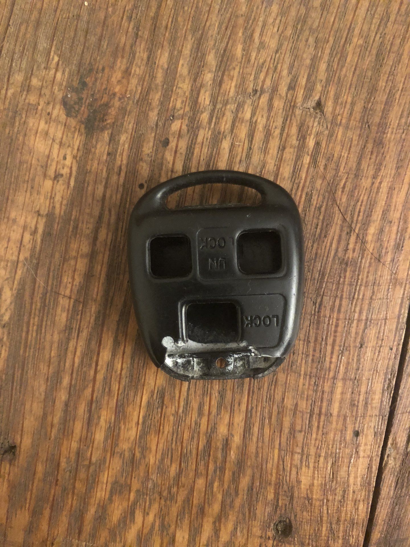

Well yay for broadening our horizons! No idea. I bought the truck about a month ago and it came with 2 fobs and a metal key. I can't get the other fob to program, so I'm guessing there was a replacement at some point. This one was solidly lodged in the housing though. Broke the fob and the blade surround came off in 3 pieces. There's zero play with the new fob
How bizarre. That key design seems like it'd be very expensive (relatively) as it'd require a couple cross drilled holes in a new axis for a press fit, plus two pins. They could have just used the stamped "T" shape and gotten more material/strength at (I assume) a much lower parts cost.

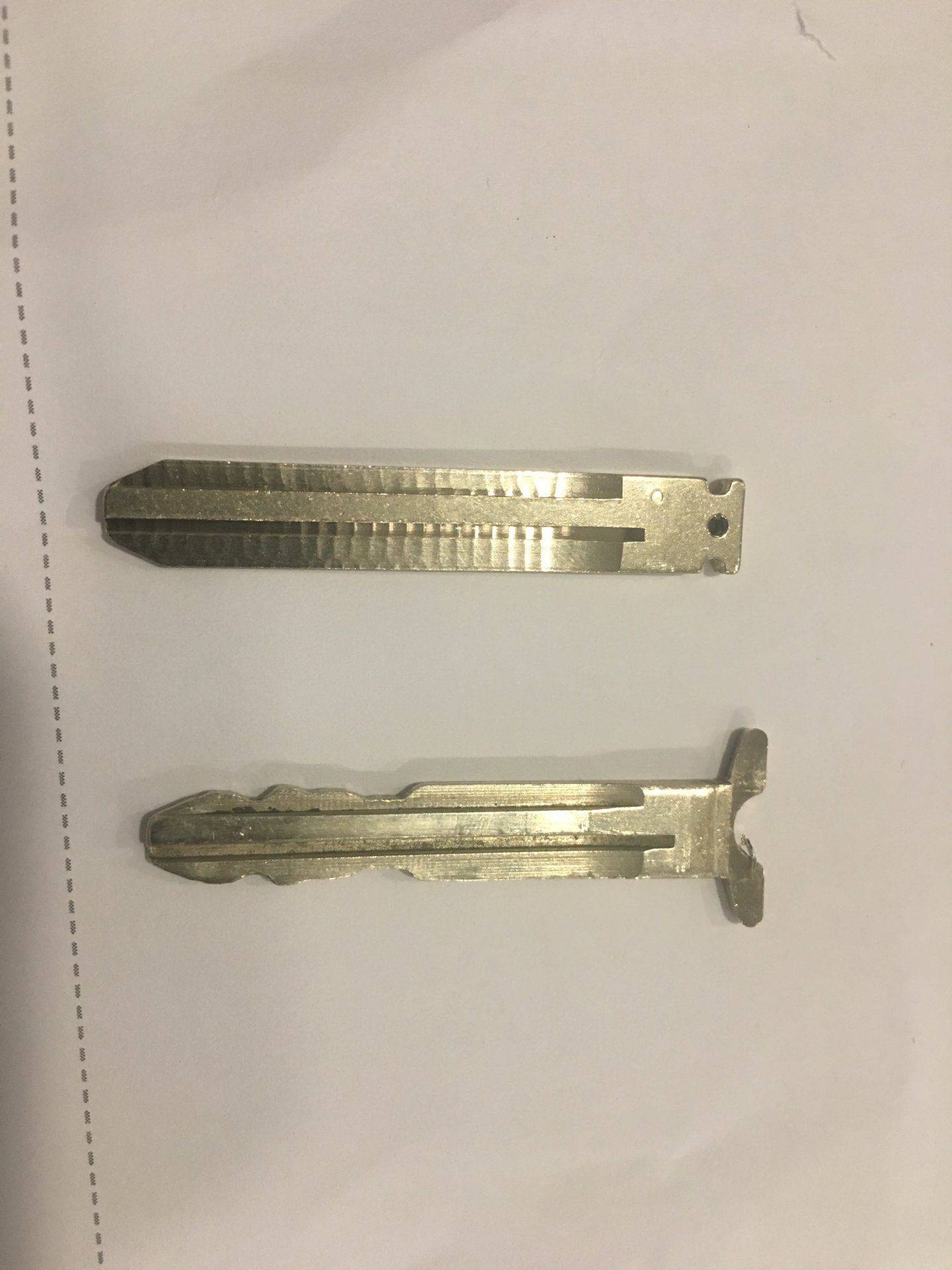

I will appreciate anyone that can help. I've watched the videos and searched the forum. I may have missed something pertaining to my issue but, my (original?) key blade does not have a threaded hole in the top. It's the regular style as opposed to the i-style (also pictured. Any idea if this style can work with the kit?
I've already torn my old key apart and was installing when I found out this strange detail.
YotaMD may have other ideas, but I would probably have the blank with the threaded hole cut from your original key, and use it. I think the threaded hole is needed to anchor the shaft into the metal structure of the titanium key shell.

Hi,

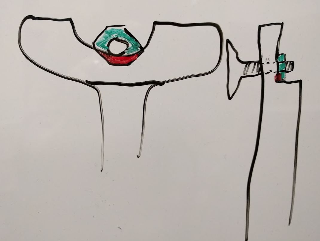

The threaded hole is helpful, but not required. The one without the hole is what I call the "u" style. It will still work just fine without a center screw, but can have a slight wiggle to it since there's no anchor.
One way to get it a little more securely anchored is shown in my drawing attached. You can sometimes get a nut to sit within the U and sandwich the blade to the back half of the shell. That worked well on my tester.
Another option is to wait for my updated revision on this product. It's got a new feature specifically for this troublesome and rate "u" style.
See what you can do with the figure attached or just without the center screw and let me know how it goes.
YotaMD, Thanks for the diagram. Without using the nut to secure the key there is some wiggle but really shouldn't be an issue, just an annoyance. Securing with the nut over the edge, there is just enough room on the U-key to get the nut to grip it, however, it can't be tightened down too much or the it will pop out. So I cinched in down just enough to feel more stable but not enough to pop it out. Now it has reduced the wiggle to just the slightest and only with a little pressure. Thanks!
