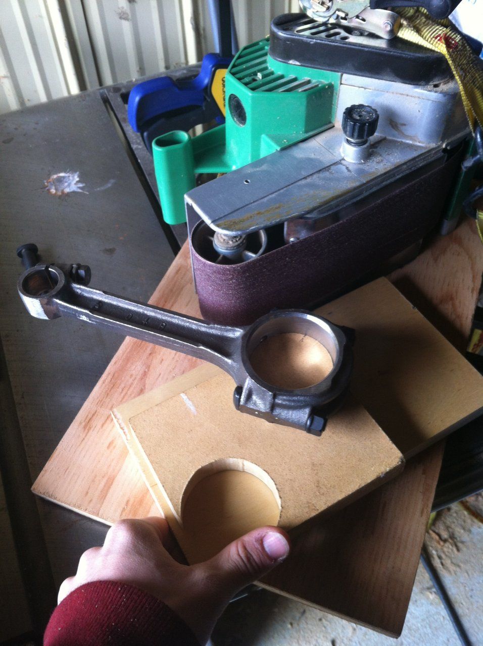

I figured out what geometry I needed and ground down to that. I also made sure I took the exact same amount of material off of each bolt by checking the weight after grinding. After I had them all ground I tested them in the block and they all clear the camshaft nicely.

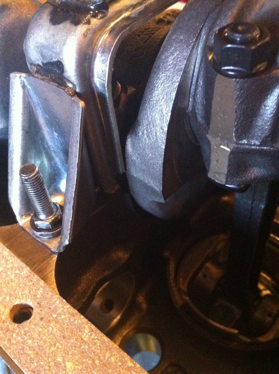

I then got the crank bolted in, the pistons and rods assembled, rings on, and bolted the rods to the crank. The ring and bearing clearances were all in spec. Bolted on the timing plate with the torx screws, pressed the brand new oem cam gear on the reground camshaft and installed it. Those clearances were all good as well. I then installed the oil pump but discovered that the crankshaft was hitting part of the bracket that supports the 3fe oil pickup tube. Also after bolting the oil pump in I double checked that the distributor slid in and out nicely.

I then messed around with the oil pan for a bit. The rod bolts were hitting in three spots with the pan bolted up with no gasket. The rods were still touching a bit even after grinding the pan as much as I was comfortable. After inspecting the situation I noticed that each nut that was hitting had the tip of the hex pointing at the pan. So I turned those a bit so the flats of the nut were facing the pan and voila! No more tapping. Double checked after the pan was bolted up with the gasket and it seems good. Tapped and plugged the oil galley in the head, bolted it on and torqued to spec, lifters, push-rods, and rocker assembly installed, pushrod cover, timing cover, and crank pulley installed. Started working on mounting the accessories. I also bought some uhmw rod to make a body lift out of.

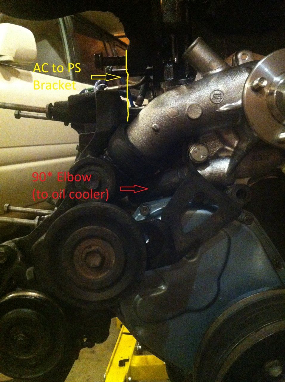

I was reading the 2fe write-up Tonkota wrote for Toyota trails and he had to move the AC bracket about 2" out from the engine to clear the snout on the water pump where the rad hose comes in. I was fully prepared to do this but guess what? The fj80 3fe AC bracket must be slightly different or something because with the AC bracket bolted to the motor mount there are no problems with the water pump clearance. :bounce:
The only thing I will have to do is to make two almost flat brackets (basic shape outlined in yellow in the photo) to extend the top of the AC mount to the PS mount. No welding. Just cut out two rectangles, drill two holes in them, and put a slight bend in them.
Clearances for the rad hose are tight but it fits well. I basically used the stock 3fe lower rad hose setup but I had to get a longer hose that comes from the water pump to the pipe. In RockDoc's thread he ran the line from the 3fe thermostat (the one that used to go to the 3fe water pump, but the 2f water pump doesn't have a port for it) and tee'd it into the lower rad hose so there would still be coolant flowing through the block and head with the thermostat closed. Instead of closing off that port I am going to run the line and T it into the heater return line.
I also discovered that if you use a coolant hose with a 90* bend in it for the oil cooler it can come out of the port on the 2f water pump and go right to the oil cooler. On the 3fe water pump the port is on the right side (when facing the engine) and the hose comes out of the port, to a hard line that goes underneath the crank pulley, and then to the oil cooler.

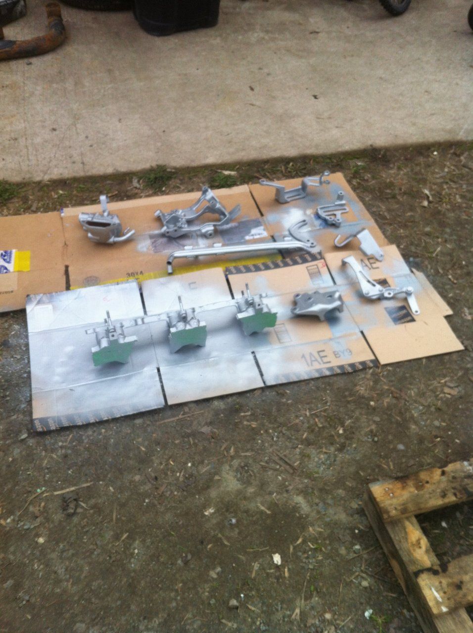

Last weekend was family weekend but I managed to get some stuff done this past week. I got all the accessories cleaned, the engine painted with por 15 then top coated with silver paint, new heavy duty battery cables made, new 10k fluid in the fan clutch, new transmission input seal (90311-42010) installed, engine mounts/oil cooler/trans adapter/flywheel etc etc bolted on to the engine, valve lash set, and more. Sorry for the bad photo's,
