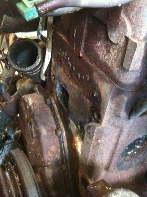

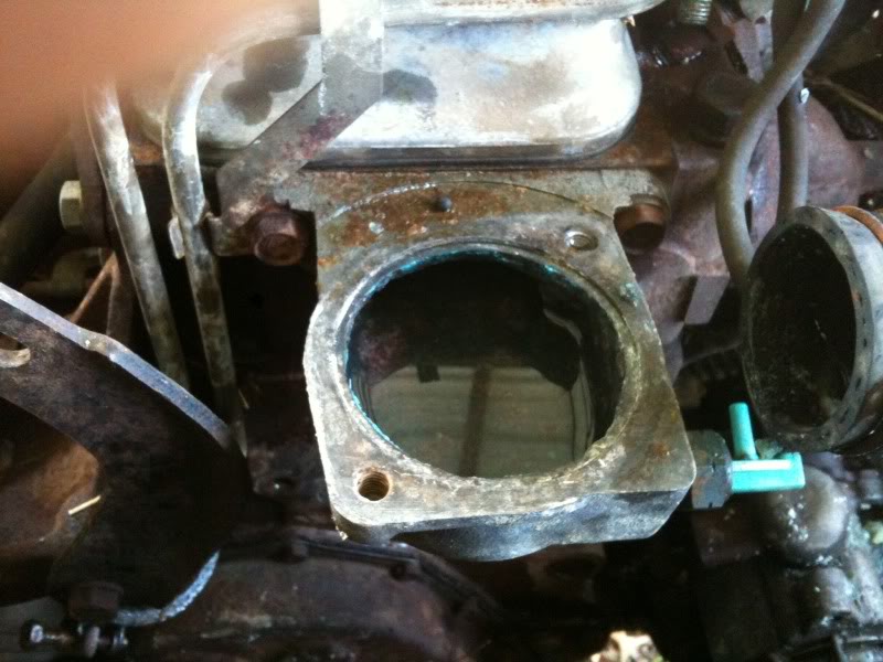

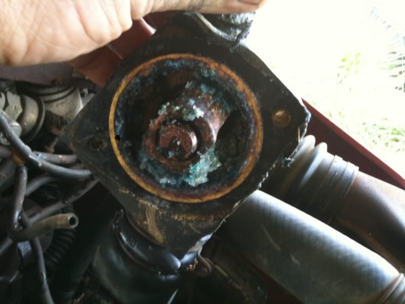

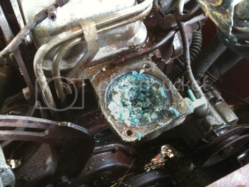

Had a chance to do a little work on the Toygoata today. Threw a battery in it and it rolled over and fired. Surprising since the gas in it is 15 years old. Kinda looks like kerosene. Ran it for just a few seconds and noticed the water pump is froze. Pulled it off, and the thermostat housing. Looks like the Toygoata has been eating smurfs.
Flushed everything out and ordered a thermostat. Luckily there was a new water pump in the back of this thing when I bought it.

Also the radiator is going to be shot just go ahead and replace it. Those green crystal will be all in that radiator.
