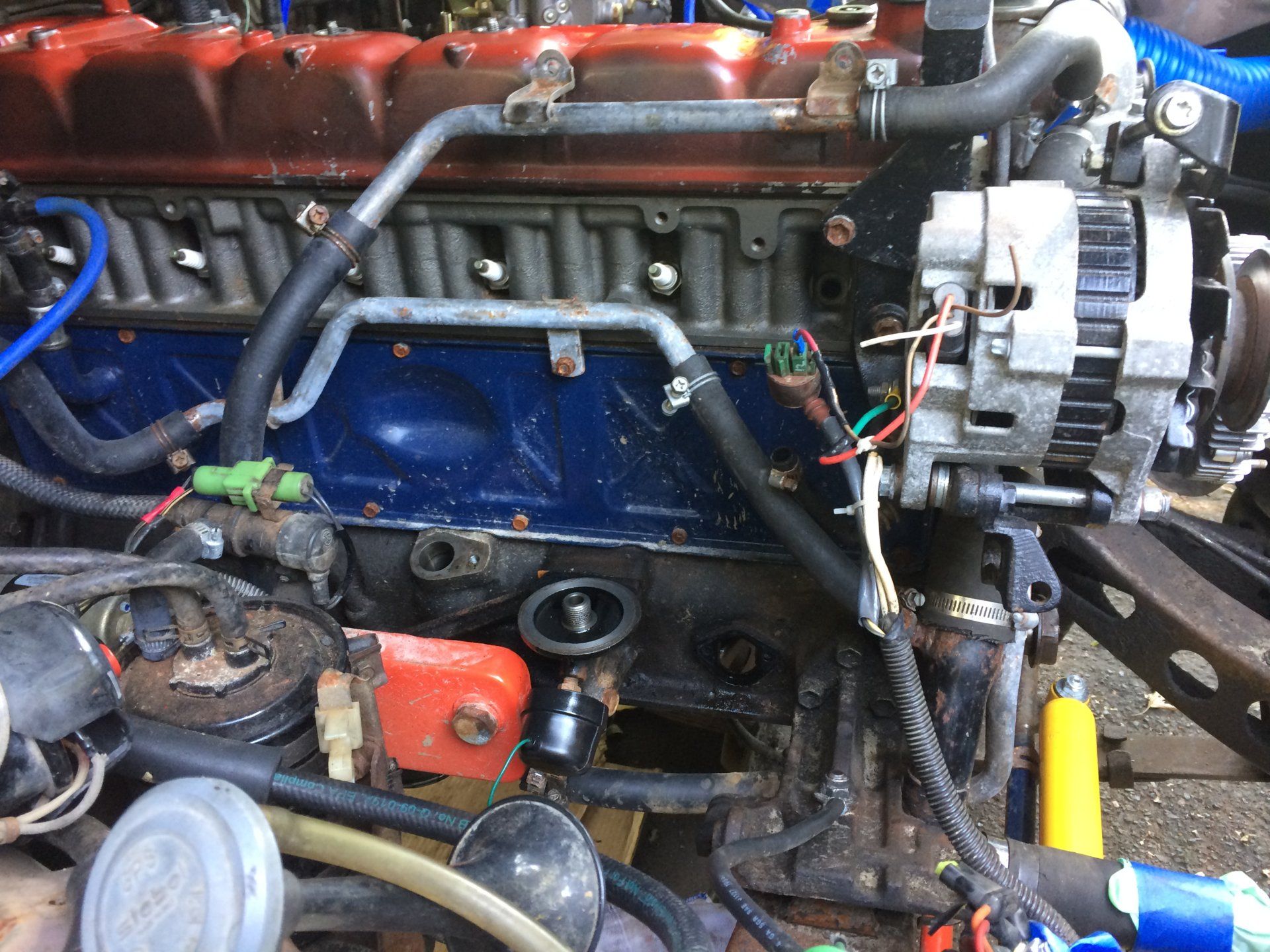

Pulled the battery and tray and emptied the rad already.
@Godwin, found this thread you wrote back in ‘10. What size jack were you using to tip up the engine?
Pulling camshaft from 2F

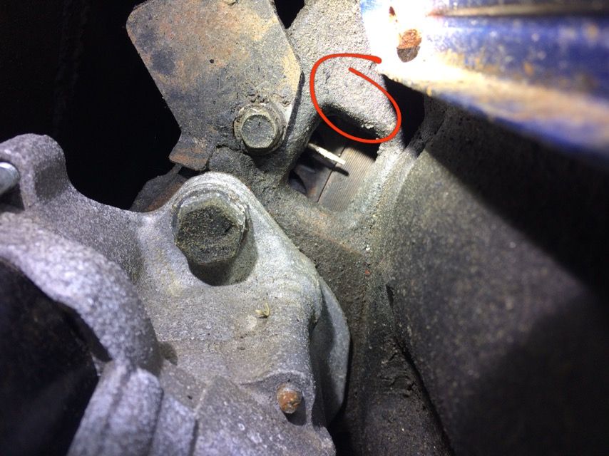

I wasn’t really grasping what had happened here. Now I do: The shiny outer part is the outside of the bearing that has worked its way 1/4-1/3 the way out of the block. What I thought was a gouge is actually the edge of the bearing oil hole being seen as it’s coming out. This hole normally lines up with the oil hole in the block for oiling the bearings and circulating the oil they the engine I think. The metal bit is either from the bearing itself or something that migrated down the oil galley. It’s on the bottom of the bearing which means it didn’t float to that position. And it’s stuck there according to what Felicity said.
My experience is very limited but it’s obvious now that the block where the bearing sits need to be checked for scoring - how much is okay? Someone once told me if you run your finger nail over it and can feel a small gouge that is greater than > 5 mils. Not very accurate but gives some idea. Same for the cam. Also get an accurate reading of diameters where the bearing sits on the cam and in the block. Make sure that is within spec.
Will it be hard to measure the diameter in the block with it in the truck? I’d definitely try and see if it’s a problem. It might be obviously still good or obviously bad. Also, the linked cam thread shows them removing the cam plug when replacing the bearings. Can that be reached for removal and replacement?
Hit up the guys or gals that know how to clean any remaining bits of metal IF bits came thru the oil passages. If it’s just bearing bits that broke away that would be better I think. Is there a cleaning method (when the cam is out) that will give some confidence that the metal won’t cause the same issue. Could some diesel fuel or just air be forced thru the oil passages, and would something like that be adequate for cleaning or would that potentially make it worse?
