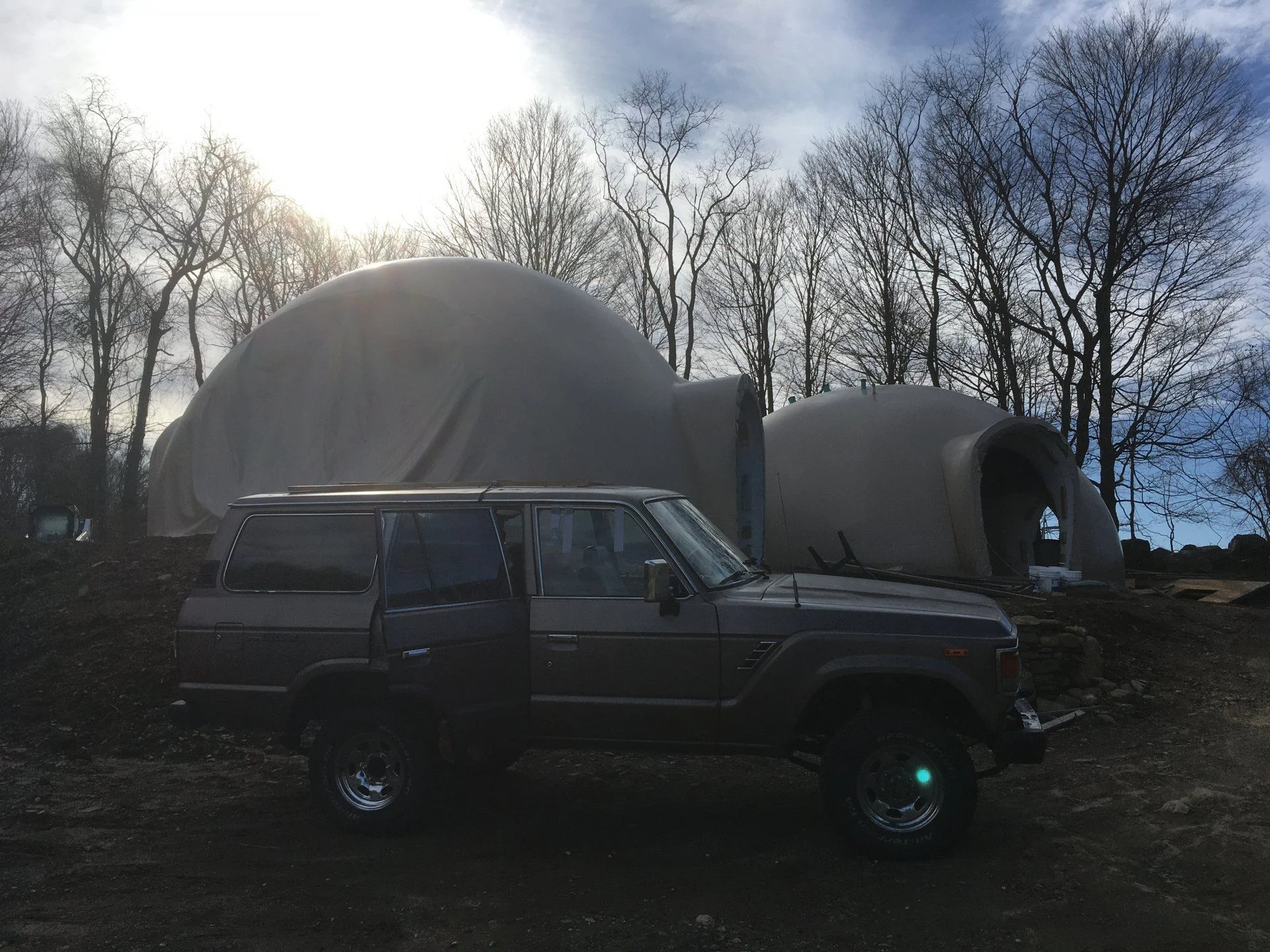

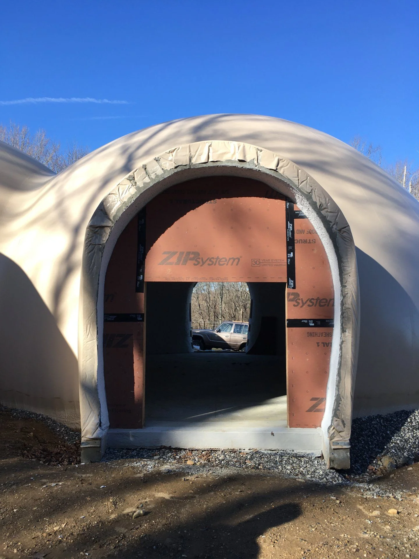

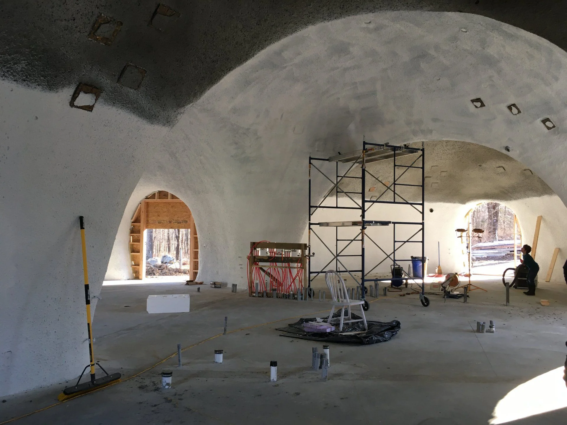

Impulsive ride to Storrs, CT to see a childhood friends dome house she and her husband are building.
In AWE... 9 acres up against 200 one way and another 11+ the other. She’s a horsey girl as I teasingly call that sort of person. Her horse Reese is 18. Their daughters are 10 and 13. What an amazing experience to give them. Move in scheduled about Christmas next year. The neighbors call it the Mickey Mouse house because it’s shaped like his head. Only one in CT. The builders who erected it came all the way from Idaho w/ a whole caravan of trailers and family. Melissa and her husband are doing the rest themselves other than the floor was done by a contractor. They have zero building experience. They are such cool people.
Her blog, Dometastic
Funny thing, when I got out of the truck she says ‘you know my parents had one of those when we were kids..’ I’d forgotten but do recall it in the driveway! I spent lots of time at her house often staying over. We were in elementary school together. She said theirs was a 60 and the same color. :)
