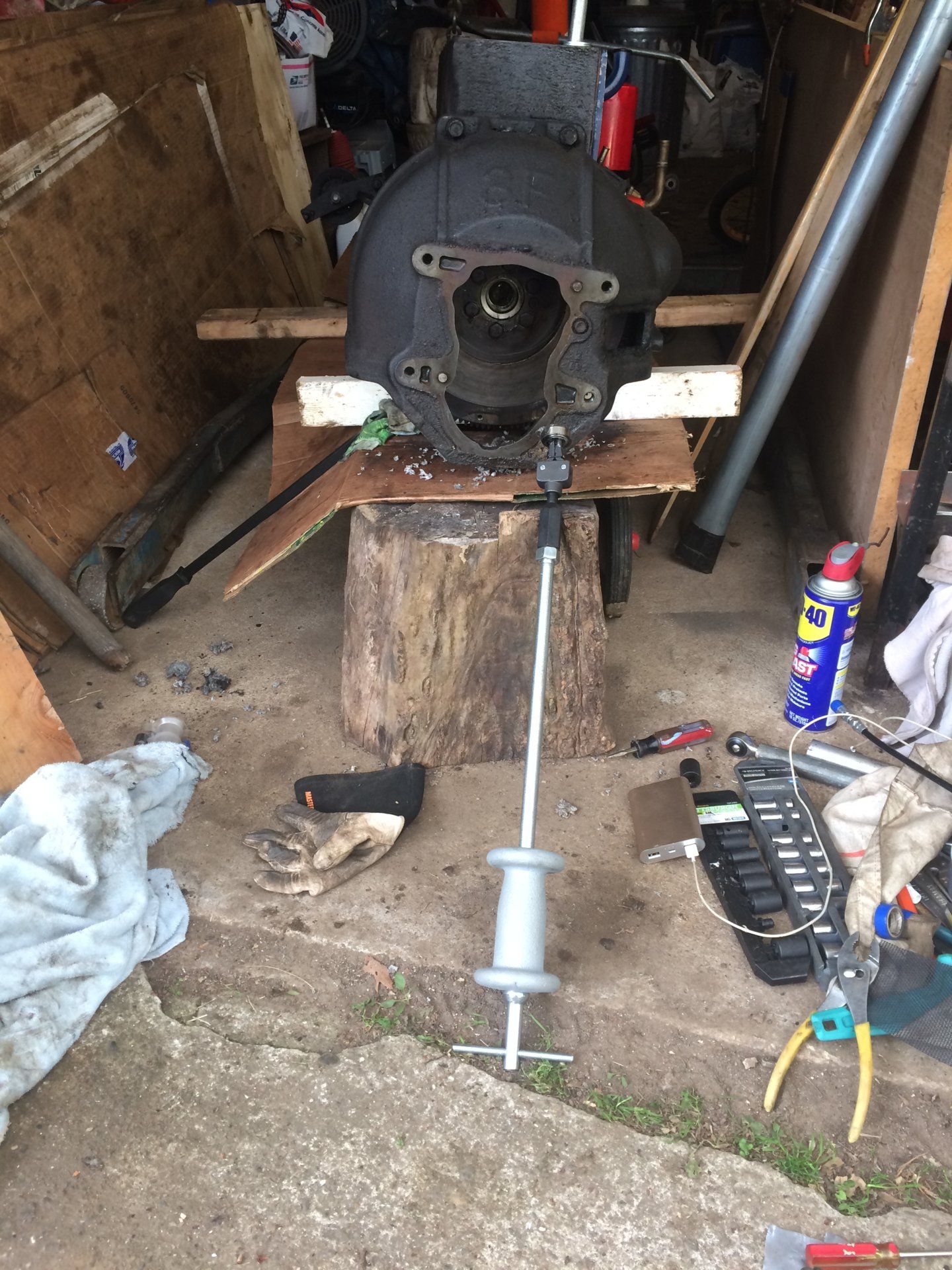

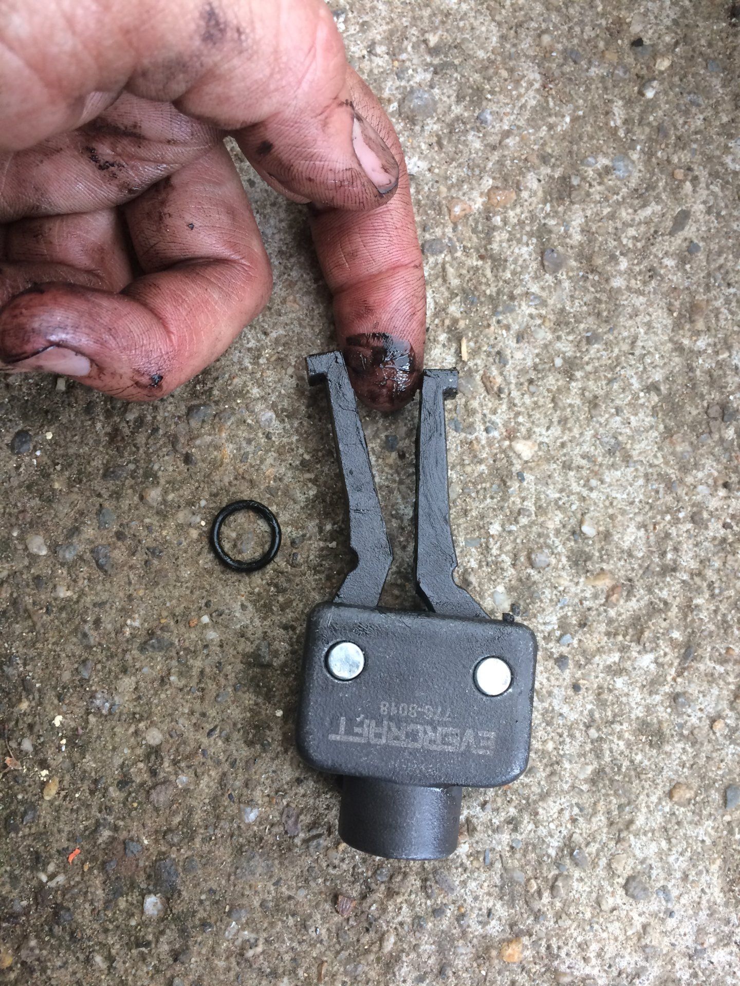

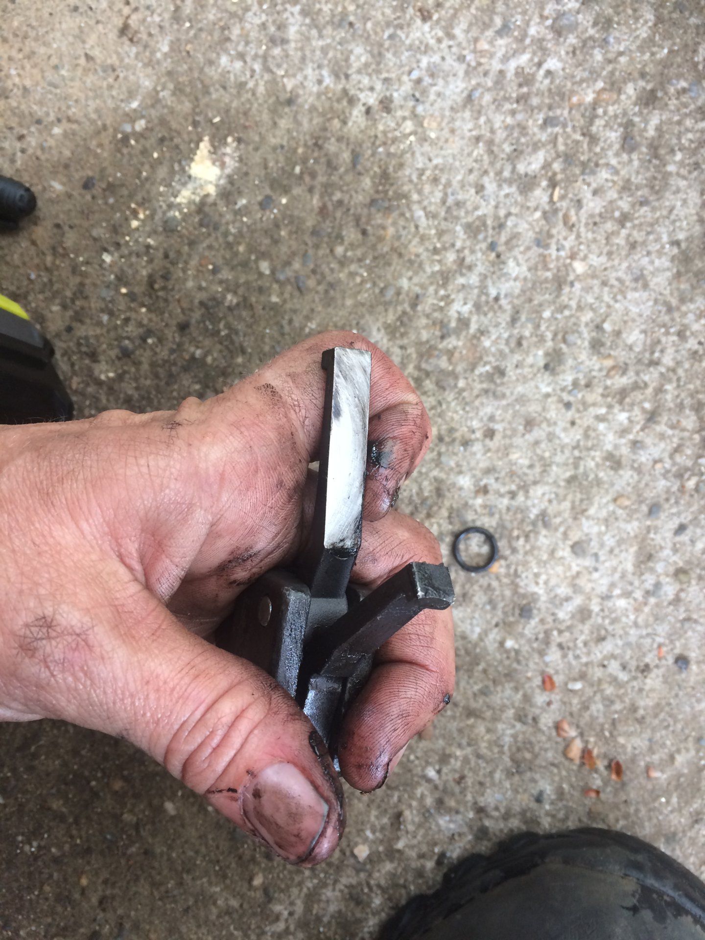

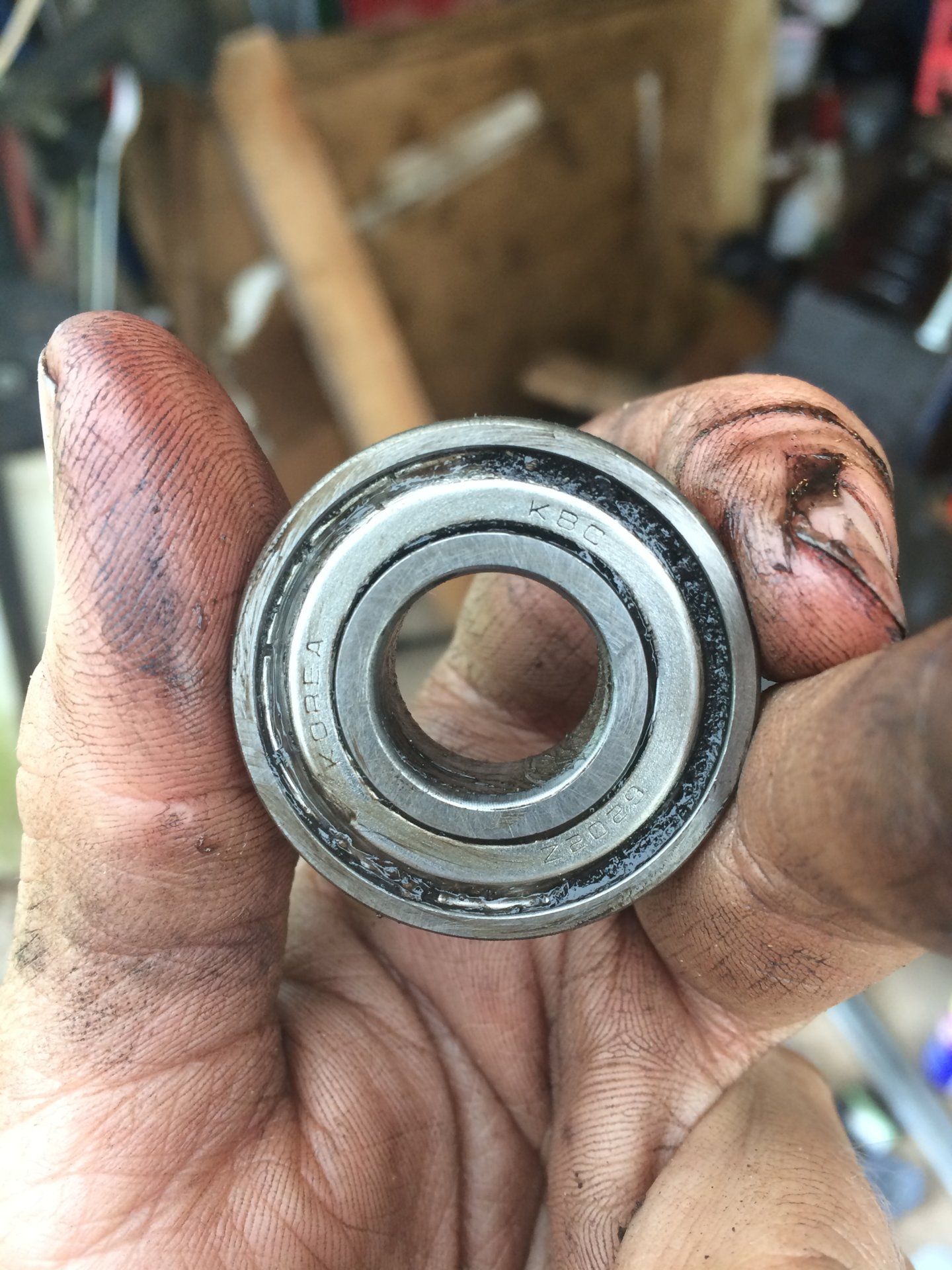

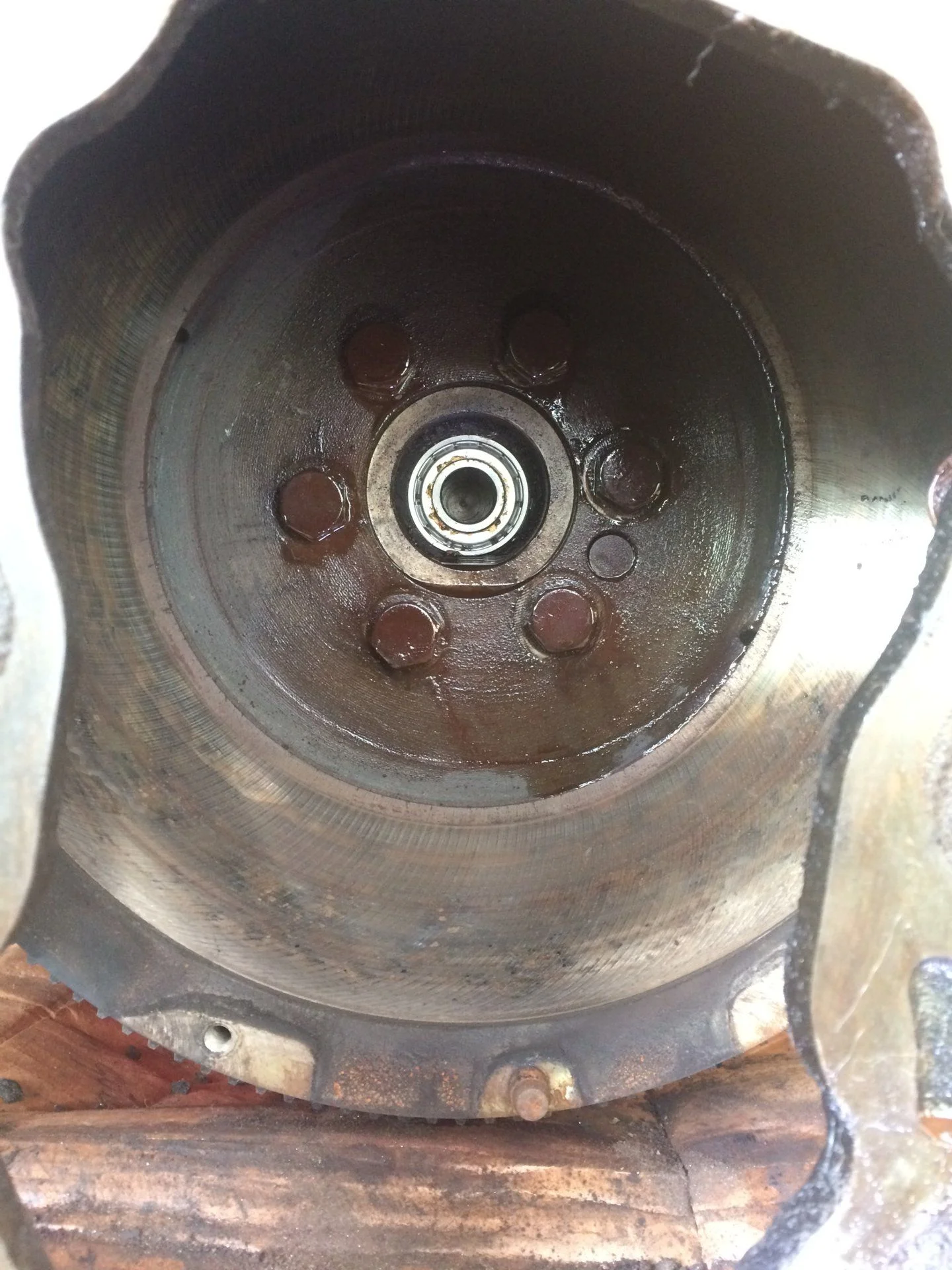

Pilot bearing is out. Wasted a fair amount of time trying to do it w/ wet newspaper (20 mins maybe) till I called Napa and rented the puller and slide hammer. Found the jaws too big to fit. So before commencing hack rented tool, I did pulled the waded paper out and tried my grease gun as a guy in the store said always worked for him. But the grease just squished out the inner rim of the bearing.
Trimmed the inner mating surface of the jaws so as not to compromise the gripping edges and it slid in slightly staggered to each other. Couple pills once I understood how to use the force (haha) and it popped right out.
Flywheel bolts are gonna be a chore. I get how to get them but I don’t want to round out the heads so I’m going easy. Impact wrench isn’t quite getting them. Long pipe and they’ll come. I do have the flywheel wedged. One is loose and gave each a few good steady pulls but stopping for now since it’s almost work time.

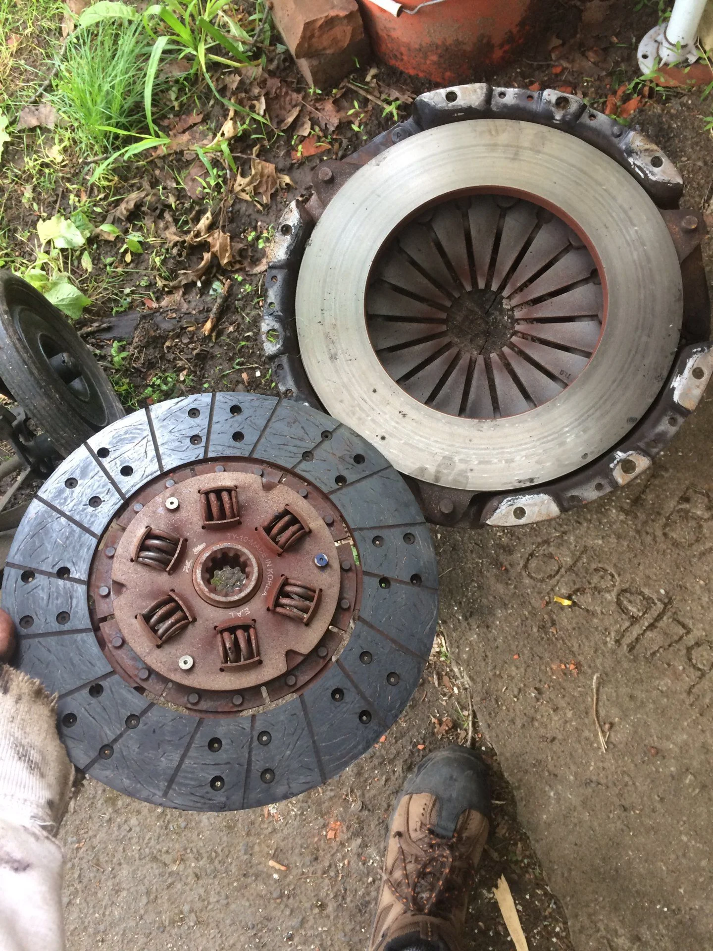

And duh, clutch is removed.
How is the clutch? Going to re-use? Yep, neither grease or newspaper or anything else worked for me either until I got the slide hammer and found something the fit the pilot bearing.

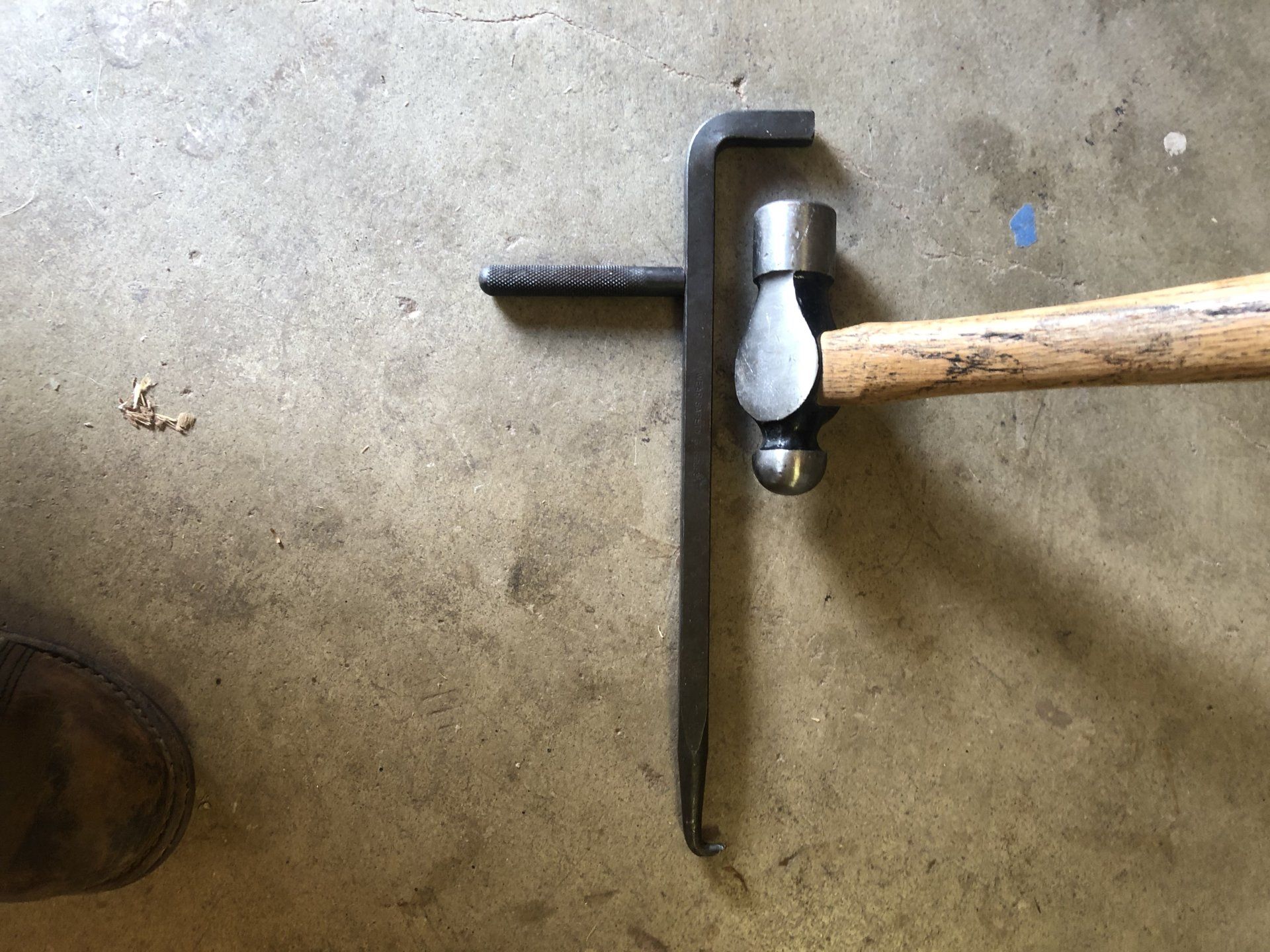

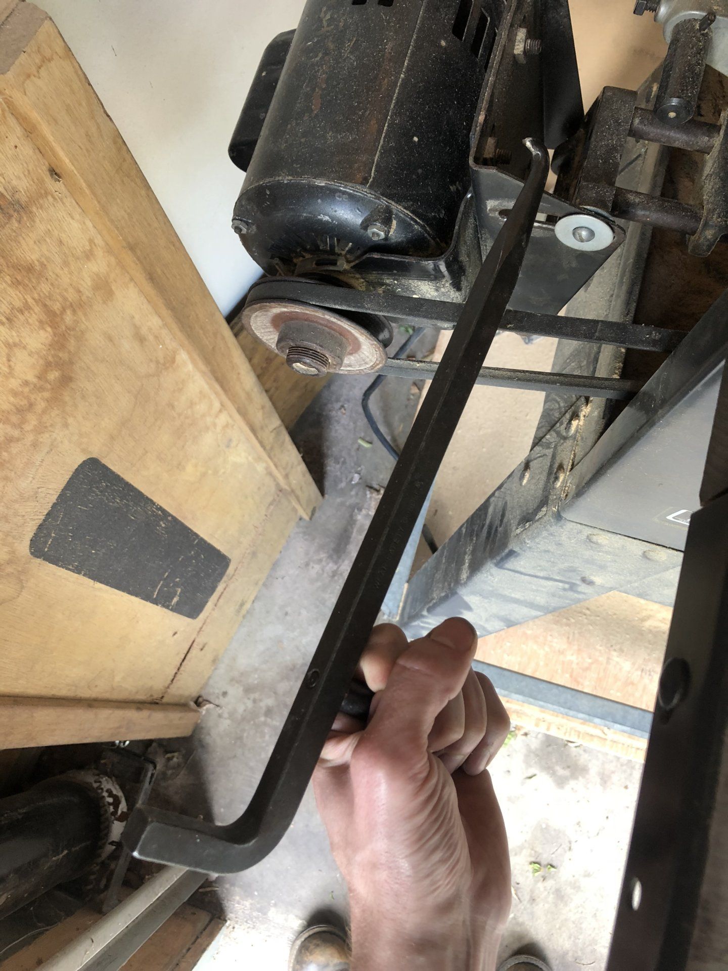

This did it for me. I love this thing (thanks dad!). Simple and it freaking works. Used it to pull every seal and bearings I’ve replaced.
Felicity, now that you’re a master welder I bet you could fab something up like this for the future!
Felicity, now that you’re a master welder I bet you could fab something up like this for the future!View attachment 2004675

Can you show me an example of how you’d use that? I do have welding rod and a ball peen so I could make that easily.
I want to know also. Looks like a great tool. Stick it in and hammer it (out)

Get the flywheel resurfaced and get a new clutch. They are not expensive. Think I paid like 150 (rounded up) for an AISIN kit. Flywheel was about 78 resurfaced.

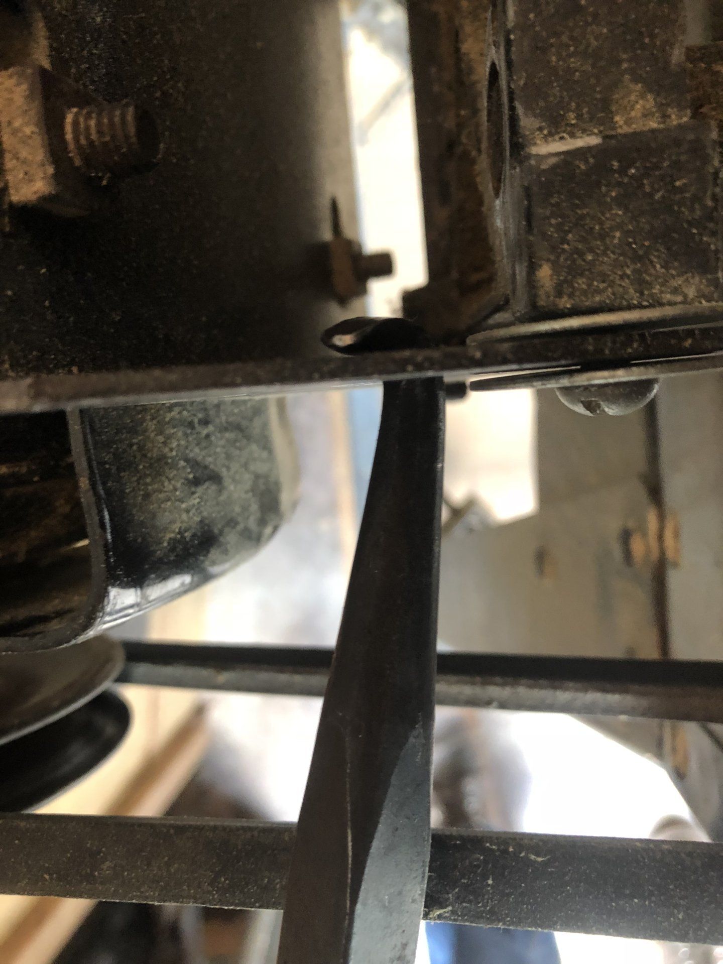

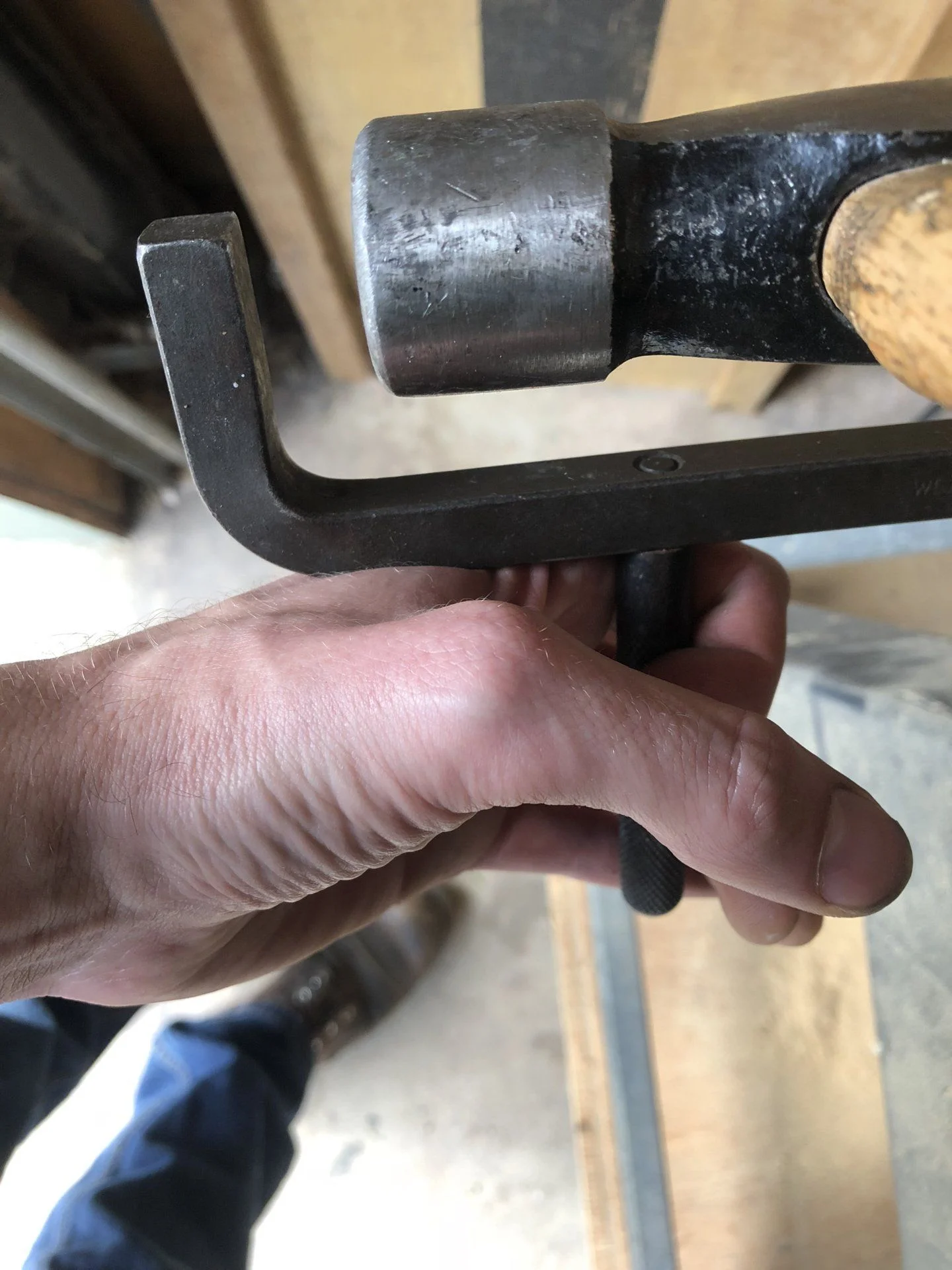

Since I don’t have a seal or bearing open to demonstrate, imagine the slot in my table saw motor is your pilot bearing. The hammer isn’t attached. Just use it to tap the tool and it pops the bearing out. The end of the tool has a little hook on it that acts like the jaws on your hammer puller. This thing was made by Matco many many decades ago. I like that there are no moving parts to fail on this thing. My only issue with it is having to be cautious not to let the hook gouge the surface of whatever I’m tapping out. Never had an issue though. I suppose it’s the same way with any tool, really. Don’t f***k up!
Since I don’t have a seal or bearing open to demonstrate, imagine the slot in my table saw motor is your pilot bearing. The hammer isn’t attached. Just use it to tap the tool and it pops the bearing out. The end of the tool has a little hook on it that acts like the jaws on your hammer puller. This thing was made by Matco many many decades ago. I like that there are no moving parts to fail on this thing. My only issue with it is having to be cautious not to let the hook gouge the surface of whatever I’m tapping out. Never had an issue though. I suppose it’s the same way with any tool, really. Don’t f***k up!View attachment 2004788View attachment 2004789View attachment 2004790
Even just seeing in your hands; now I can tell how big to make it. Easy enough. @evilorgoodtwin, if I make one, I’ll make a second for you.
