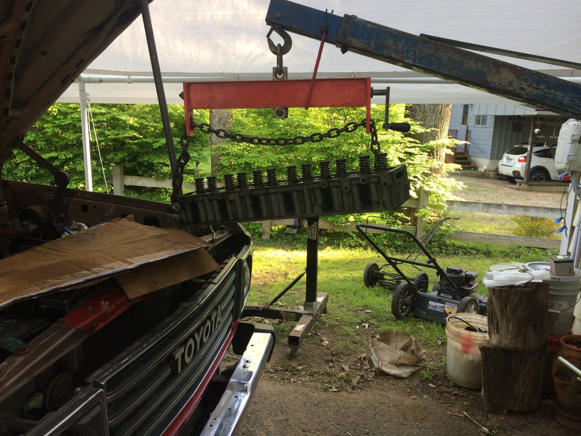

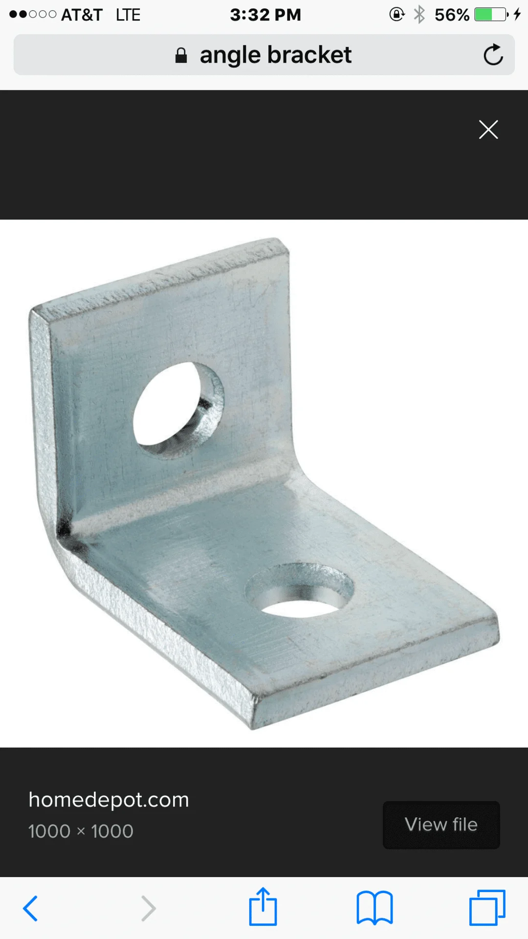

Get some extra thick washers for the head bolts if it makes you more comfortable. Screw the bolts in as far as you can and try to keep the chains as straight up as possible (avoid bending the head bolts.). If you're bored some time read up on proper rigging techniques. The weight of the motor is not something to fool with.
I bought 8, grade 8 washers from Ace for the headbolts. But thanks to a savvy thinker, I’ve got something like this in mind to make from some 1/4” steel plate I have or I’ll buy. Or I’ll pick up some shackles from Tractor Supply.

You'll have to use the head bolts. You won't find anything to thread in as it's a veeeery oddball size of 11mm x 1.75. You can buy chains, cheap, with those L hooks already attached.
Oil pump removed. Gotta stop for now. Going to swing by Ace and see about some big eye hooks to screw in the headbolt holes... not 100% sure how to lift (or how cozy I feel) w/ just straight headbolts and fat washers on a chain.

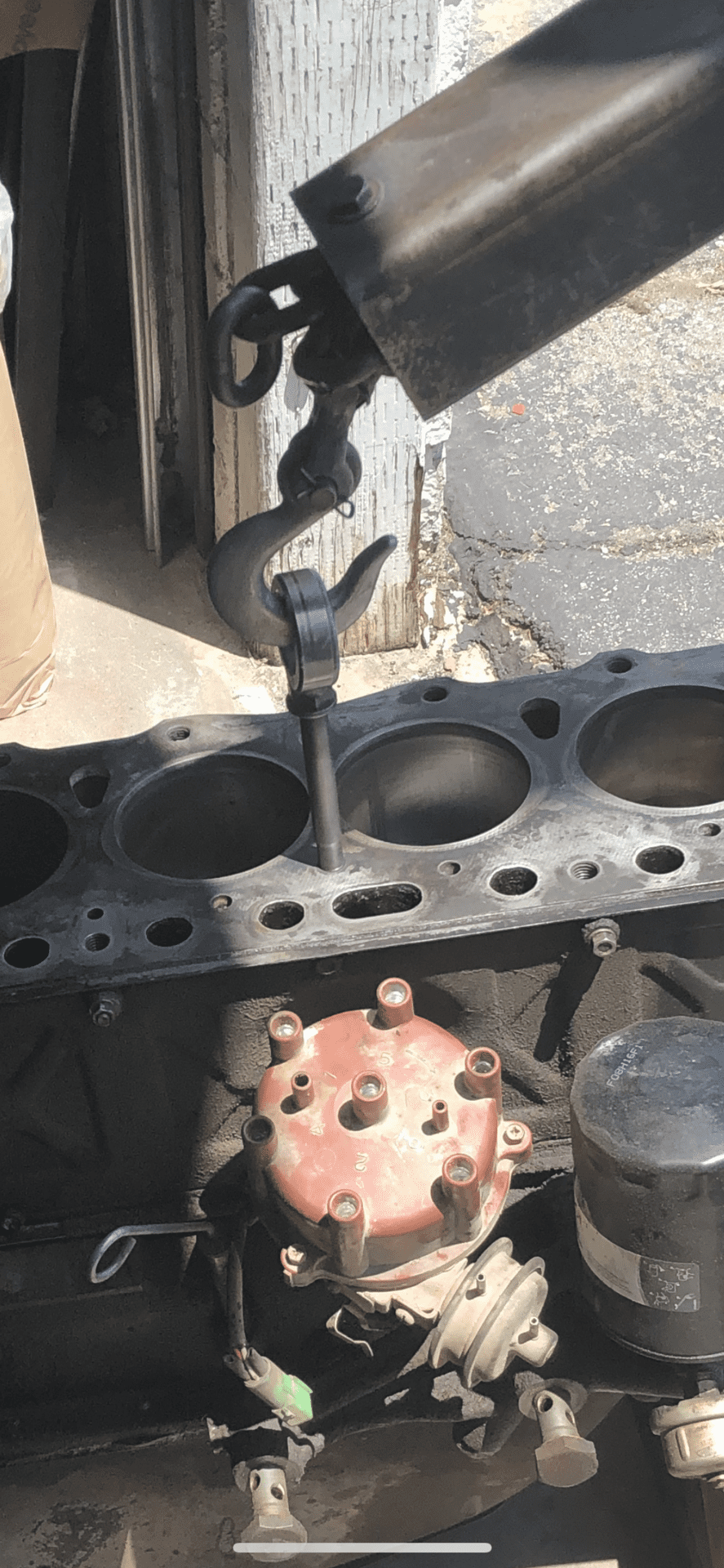

This is what the machine shop that I took my engine too came up with... Just weld something onto the head bolt and you are in business. hahaha

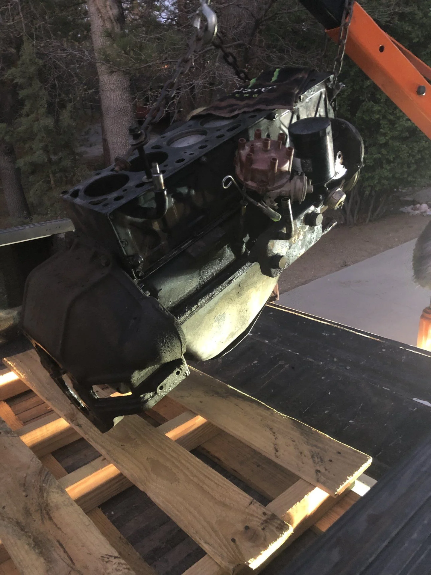

And this is what I did because I needed to get it pulled and didn't have a ton of options. Headbolt with a washer and then I had an engine hook on the other side we had from harbor freight. Worked but I wouldn't recommend my placement it made the engine very unbalanced.
Luckily the hoist I have has a leveler. Glad tho you piped in w/ a photo. I had actually told someone I was going to email you yesterday. Thank you for reading my mind!
