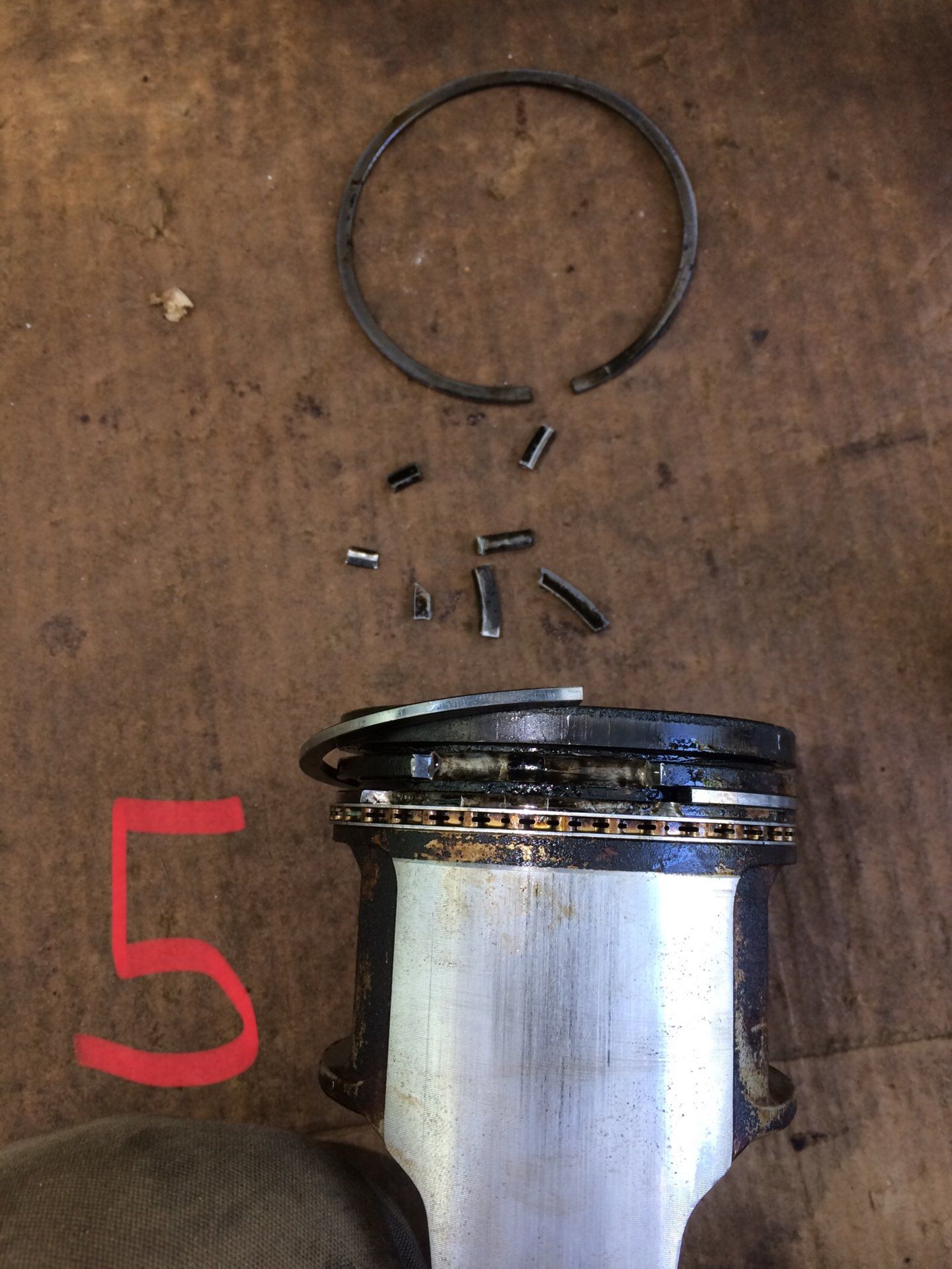

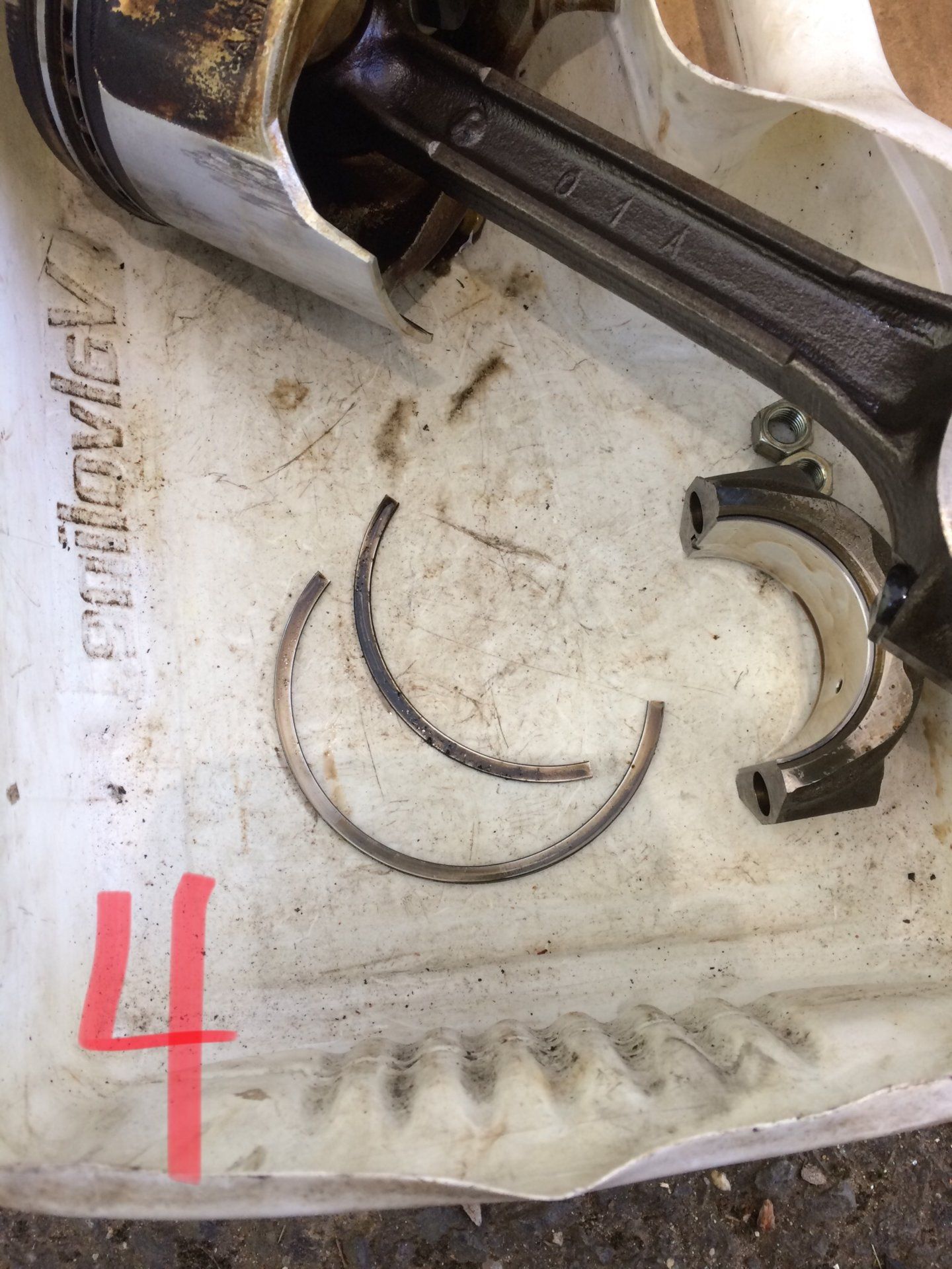

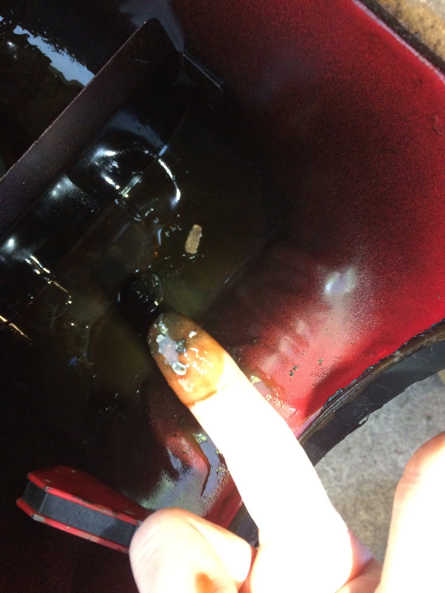

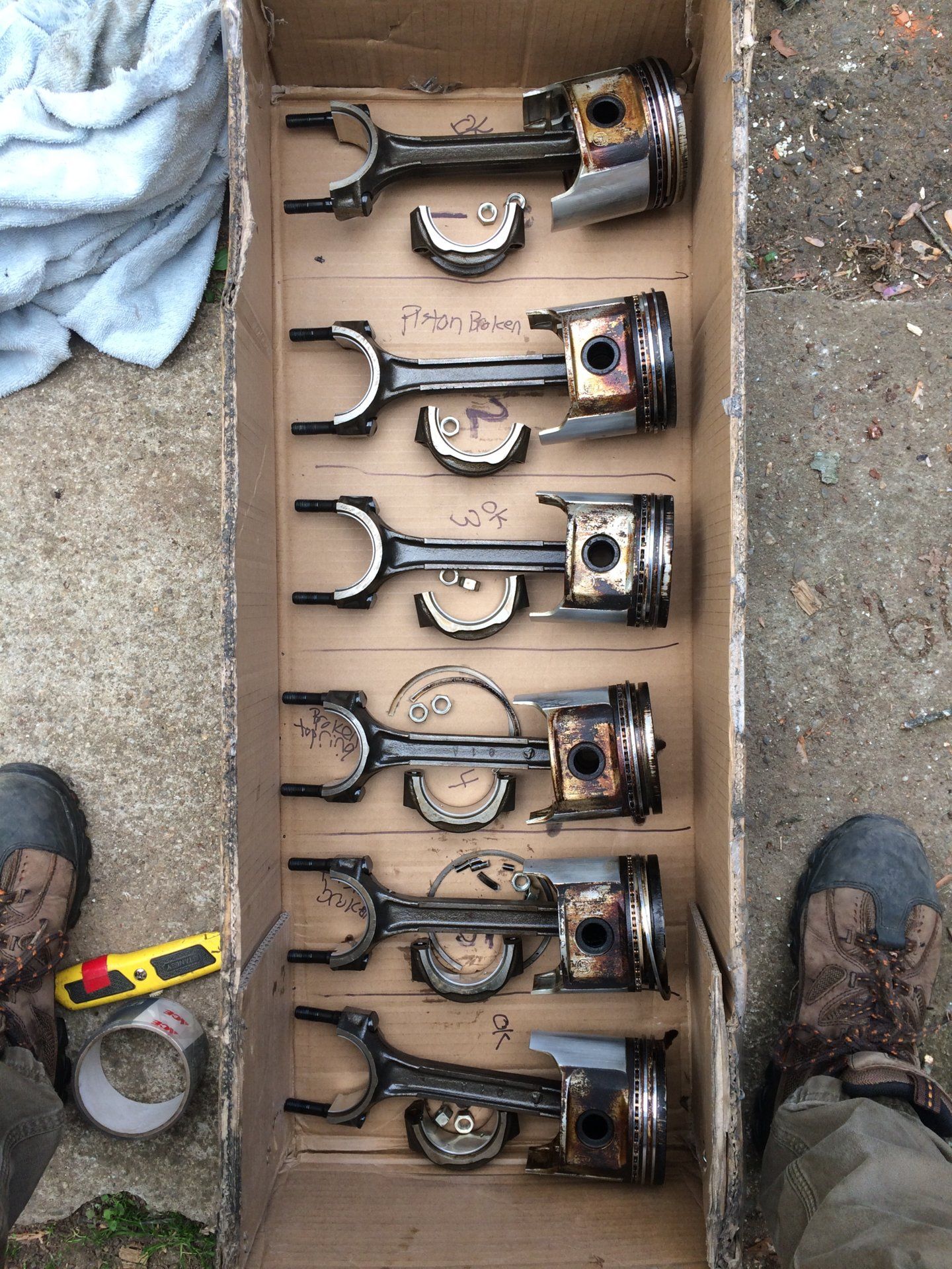

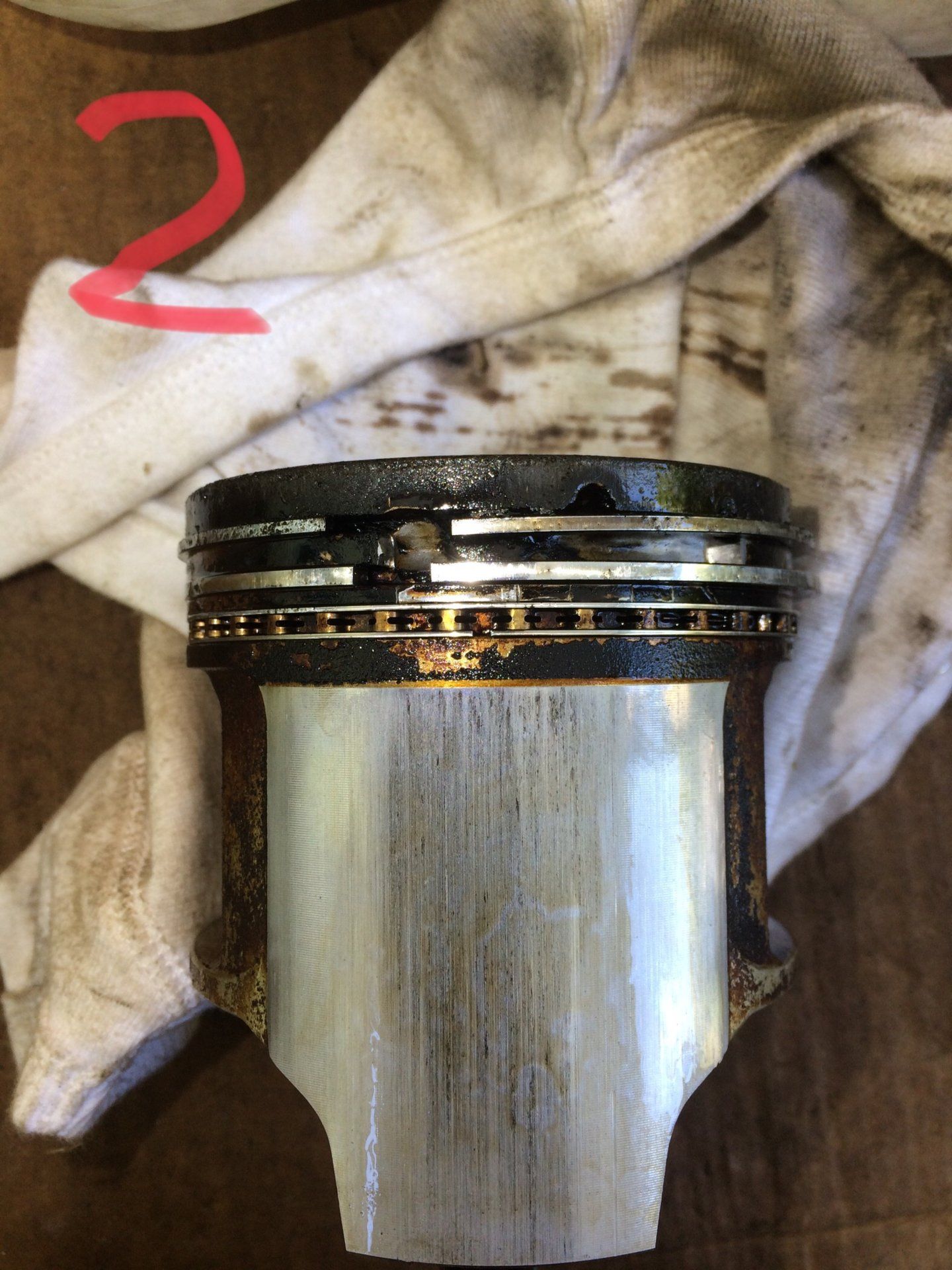

Non magnetic metal bits in the oil pan. Then, aside from the obvious ‘oh god damn ****!’ I AM highly glad I did this. Talk about feeling validated!
First out #4, broken top expander. Then #5 and 2 pistons broken into pieces. 1,3, 6 all okay.
I’m now on the hunt for a block.

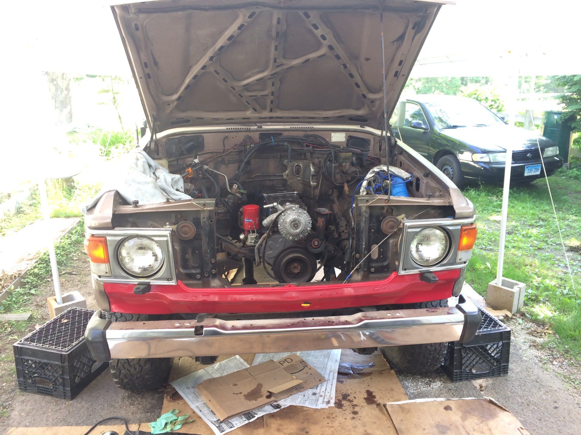

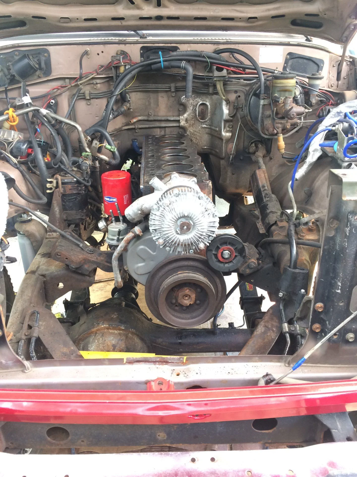

Organizing and preparing to pull the front clip to pull the engine. Crossing fingers I asked a local friend for help removing it later today.

Non metallic metal bits in the oil pan. Then, aside from the obvious ‘oh god damn f***!’ I AM highly glad I did this.... First out #4, broken top expander. Then #5 and 2 pistons broken into pieces. 1,3, 6 all okay.

So glad you trusted your gut instinct. Still so weird that you had the coolant up top, but a good warning even if not the correct warning (although I’m not totally convinced)! I’m going to check my compression yearly from now on since that’s really what keyed you in on the pistons.

I called the first machine shop because that’s the guy who’s been at this 30+ years and he was the one on the phone who was ADAMANT that any visible clouds (steam/smoke) above the engine was rings and low and behold he was dead on. He wasn’t there tho and his tech was unable to offer me any type of general quote w/o seeing the block.

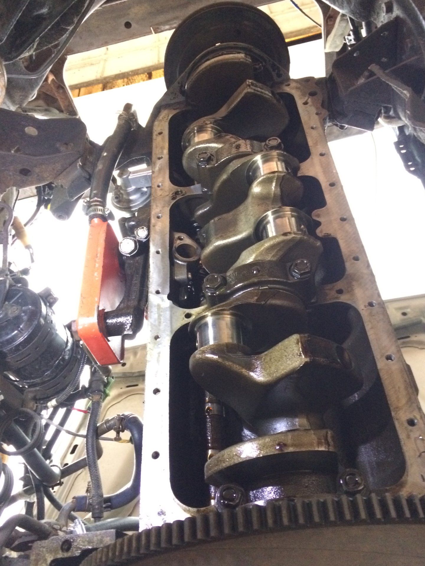

Yeah I could see that... So I'd only have the block boiled/cleaned, checked, potentially bored, honed, resurfaced (if necessary), turn the crank and cam, rods checked..... and then just assemble all the parts?
Freeze plugs, cam bearings, main bearings, rings on pistons... yada yada. Boy would that be a project of a lifetime for my soon to be 6 year old this summer to assist in and watch.
Typically the machine shop will install the cam bearings and freeze plugs, no reason you wouldn't be able to do the freeze plugs yourself and I know you did the cam bearings yourself which was impressive as hell.
potentially bored
I don't see how you get away without boring given the condition of the cylinder walls. And you need pistons and rings anyway so oversize is no big thing. And yeah it would be fun to assemble yourself. You could even go full on nerd and measure/plastigage clearances even though the machine shop should have it right. Document everything.

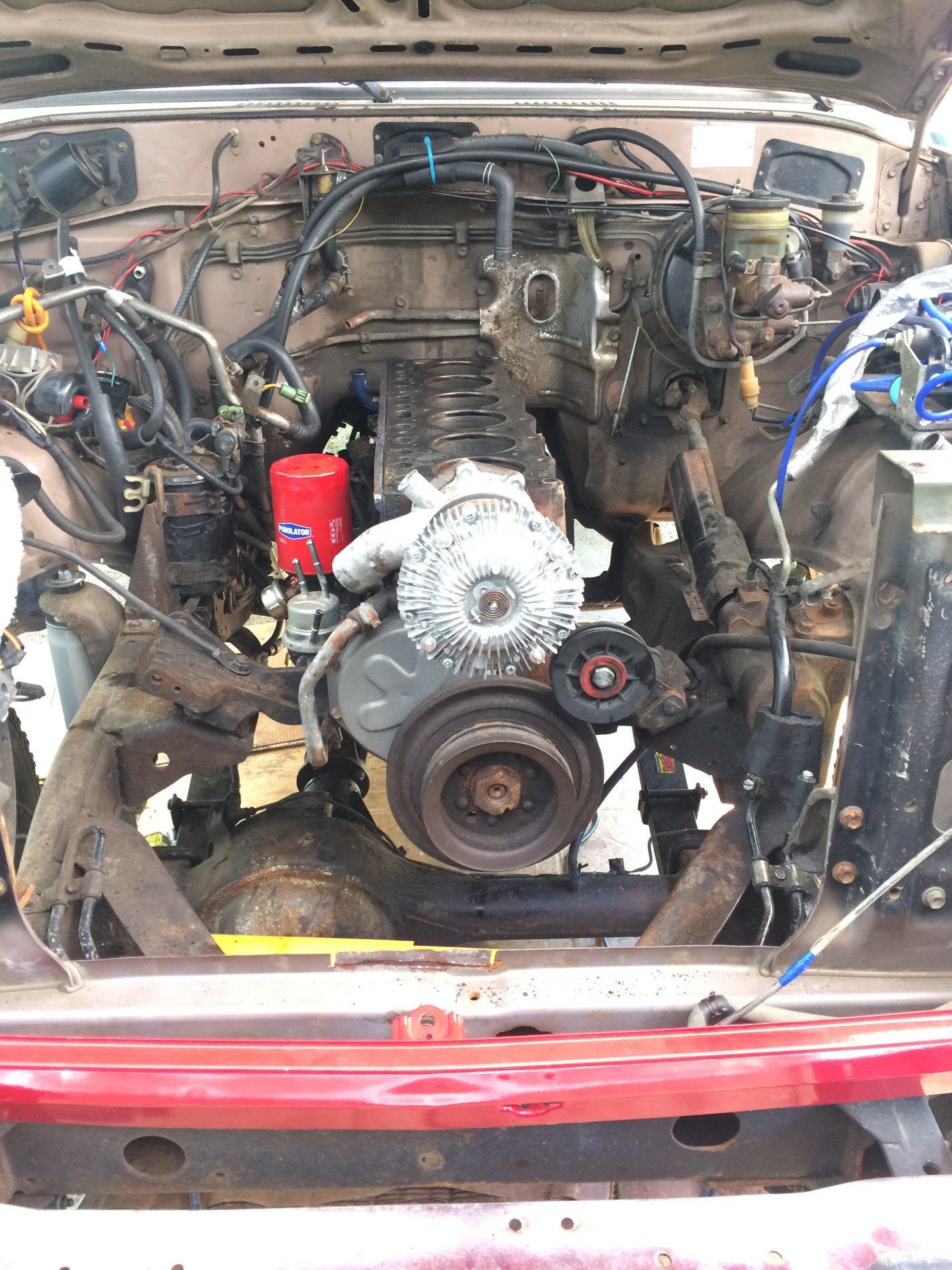

Front DS removed and two passenger side BH bolts loosened only a smidge.
Standing here looking at the HB thinking if I’m going to remove as much as I can b4 dropping off at shop, it would be easier to loosen that 46mm nut now while I have the weight of the truck holding the flywheel steady?
Edited... flywheel is all loosely goosey now. I’ll figure it out after.
Oil pump removed. Gotta stop for now. Going to swing by Ace and see about some big eye hooks to screw in the headbolt holes... not 100% sure how to lift (or how cozy I feel) w/ just straight headbolts and fat washers on a chain.
