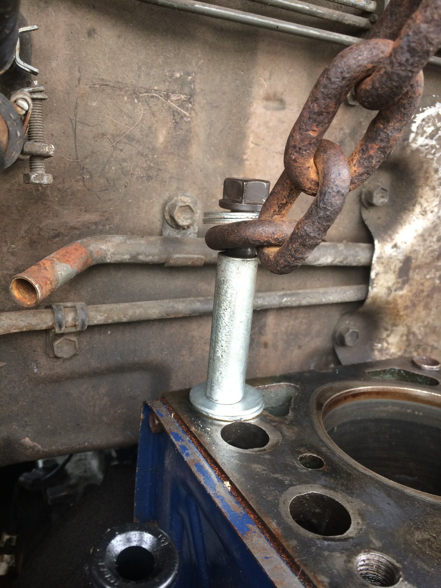

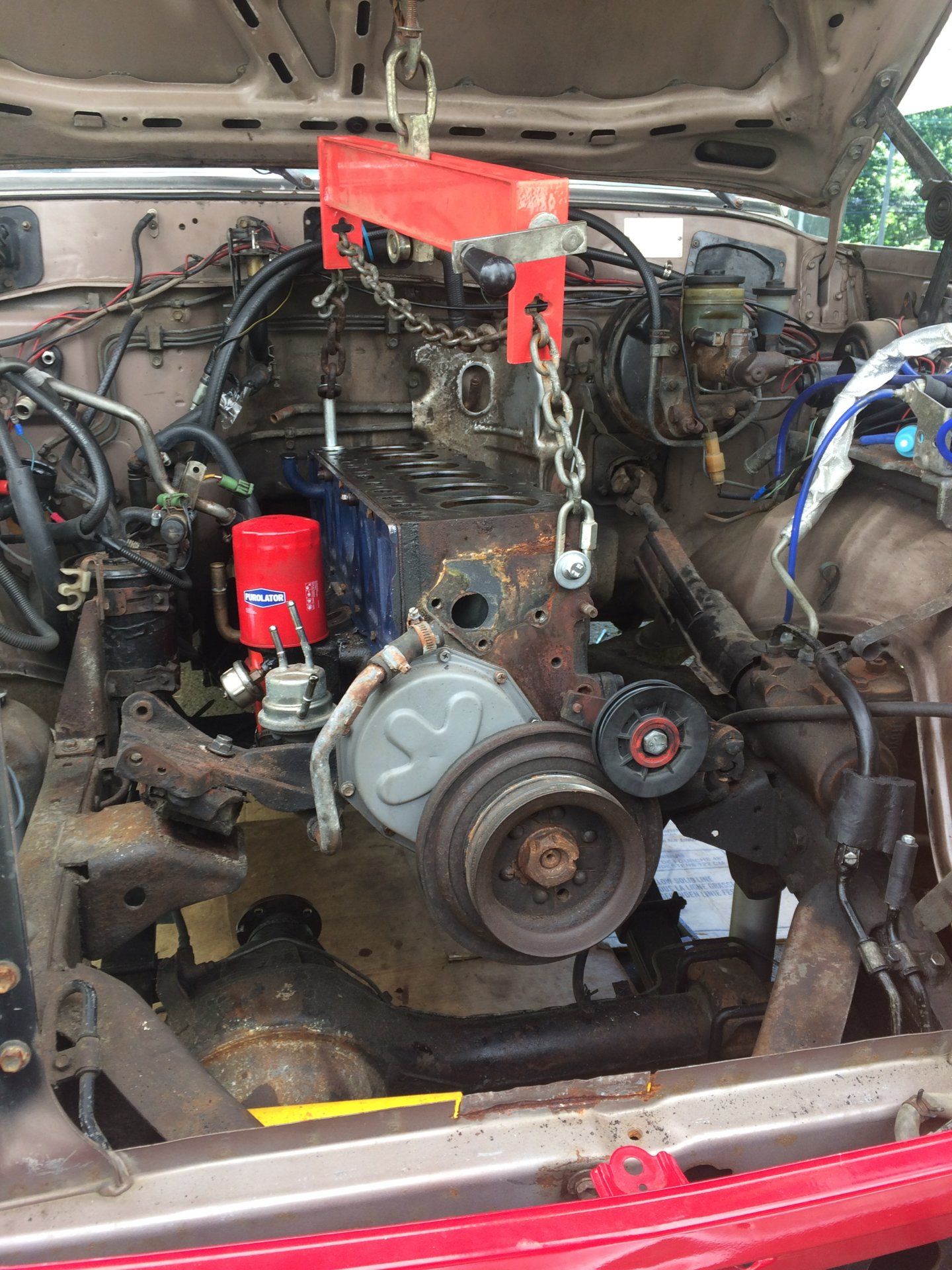

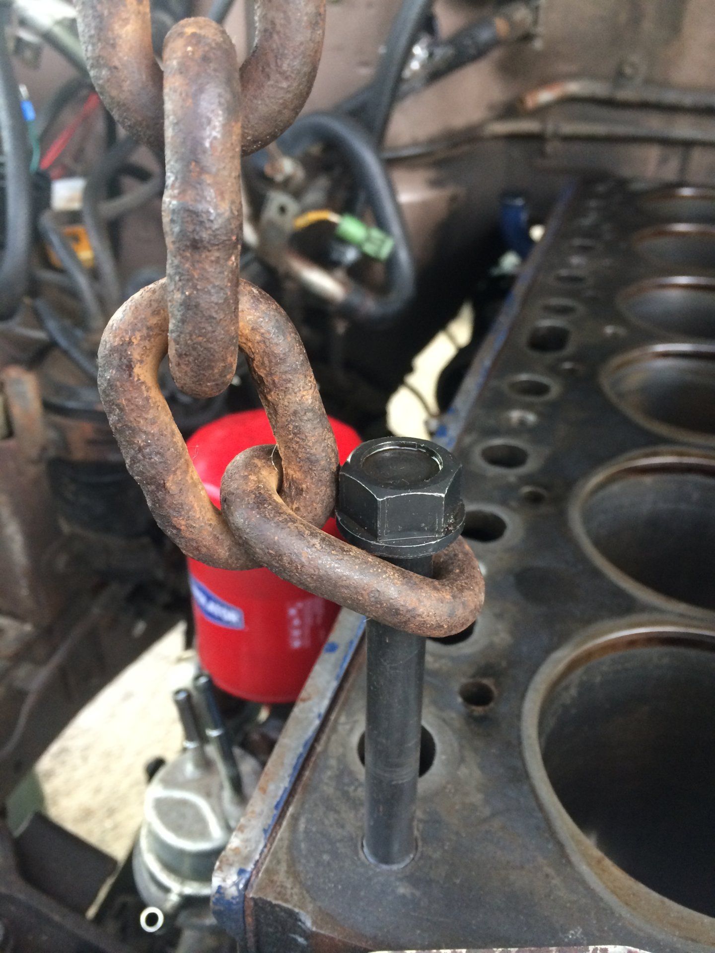

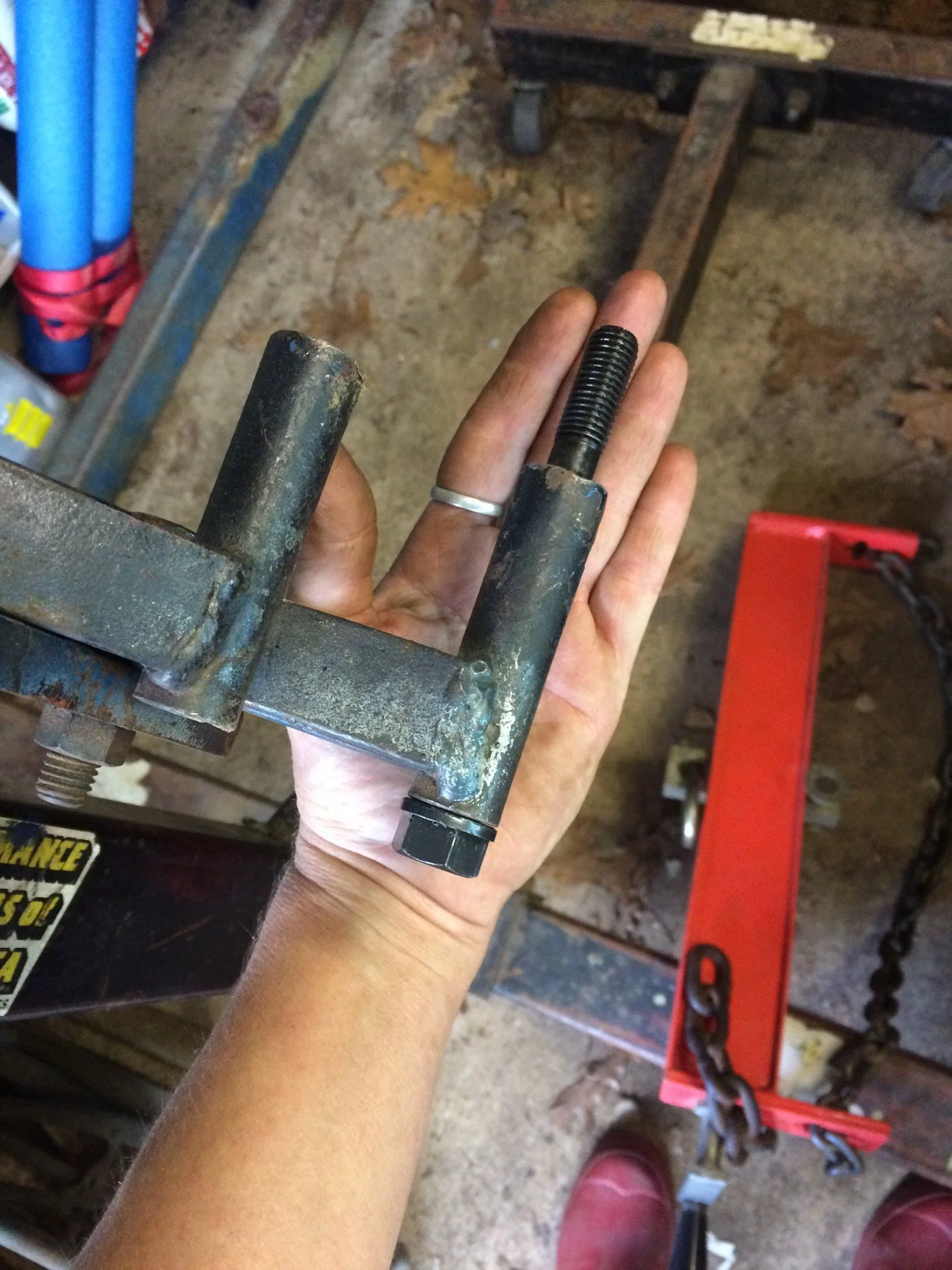

So I guess this is how I’ll approach the pulling w/o the head inplace.
I saw some chain the same thickness at Tractor Supply but was overwhelmed w/ a child and worry about dogs in car. Around here people like to report you if it’s a warm day and dogs are trapped. Chuckling I have as much a hard time transitioning to having kid to not having kid. Obviously this is a chore I am not meant to rush.
That's really going to want to bend the headbolt. What happened to the L brackets? Or were you just looking at those?

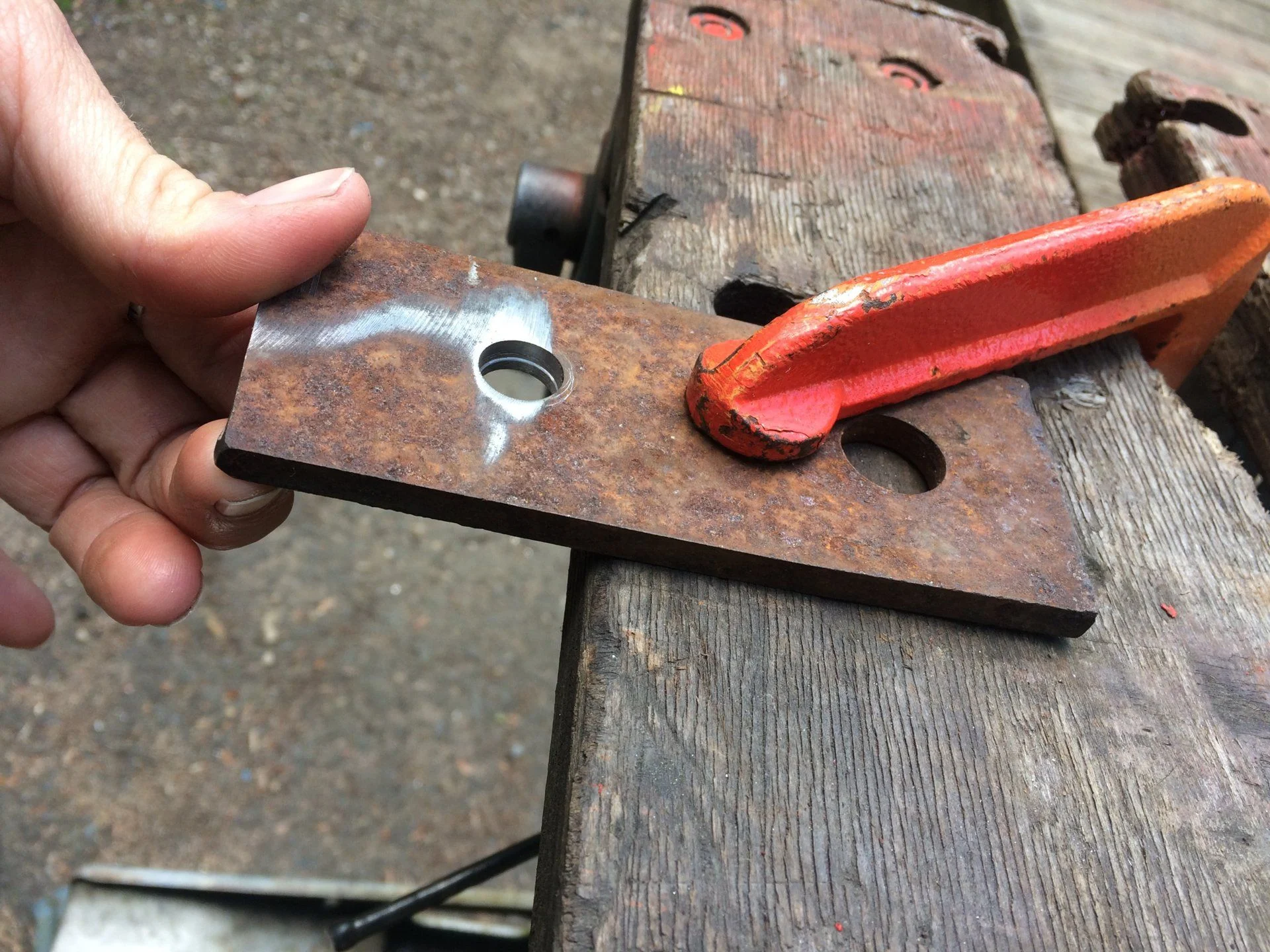

Was just looking at options. I can’t run out to a store because of child in toe. Those are not my new headbolts, they were the first set so no big deal if it bends some. But I’m not tied to that. I cut some 1/4” plate and drilled a hole through it to accept a shackle but unless I cut it further and weld it... I’m not sure I can trust MY welds to a 450lb (+/-) chunk of engine.
I used one of the water pump threaded holes and a bellhousing bolt when I pulled mine without the head on it one time
I was thinking that too. Not the bellhousing bolts but wondered about using the plate I cut to hook the chain from vertically.
So that would mean the bellhousing bolts are the same size and pitch as the WP bolts Matt? I stuck a headbolt in the engine stand wondering if the BH bolts were the same?
If you want to use chains, I guess you need to rig something up like you’re doing.
Since you’ve got the pistons out - If you have a fabric tow strap, just drop it down cylinder # 1 and push it back up #6. Do that for a few loops and lift it out like that. Much less potential to damage anything.
Good idea but I have no decent fabric tow straps. I had one I found at an abandoned house that was next to a place I rented years ago. But I was a jackass and let it go w/ all my first trucks original manuals and a bunch of other stuff way cheap. Nowadays I know not to do such dumb stuff.

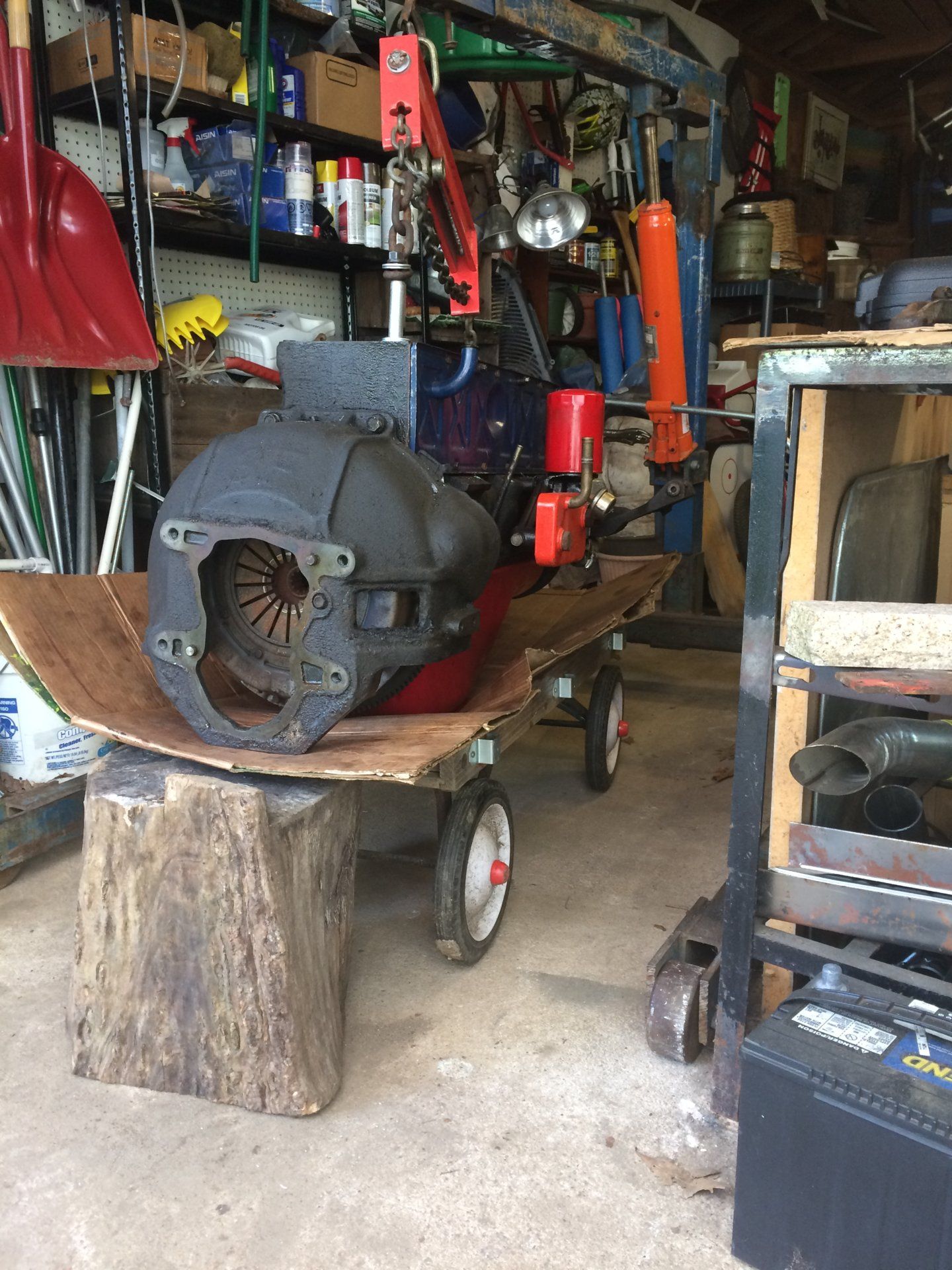

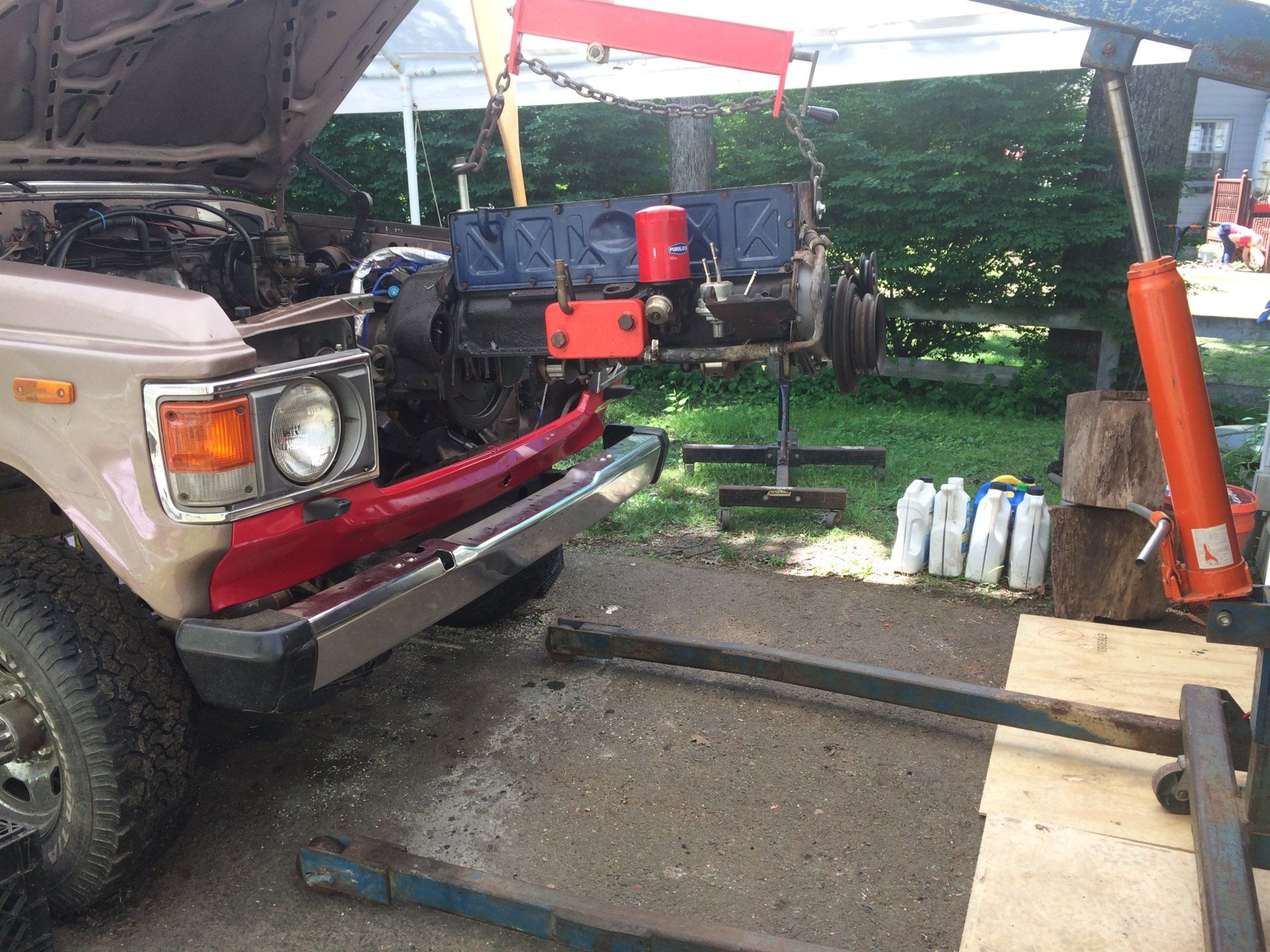

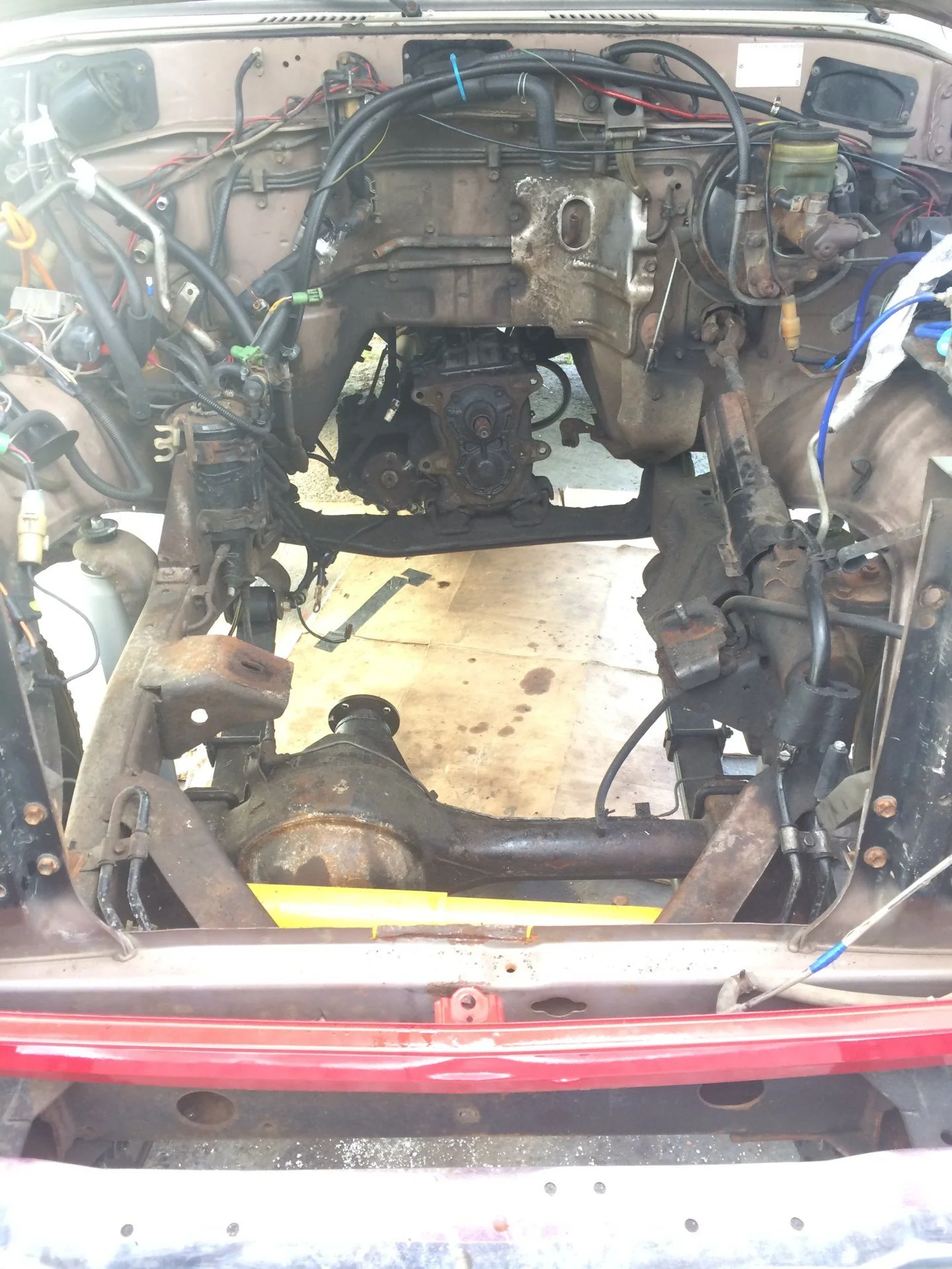

Engine is out. I did it by myself other than a couple very helpful texting mudders.
Thankfully I figured out quickly how to use a 2x4 as a prybar so I could bring the hoist backward. I was way too small to move it on my lumpy pavement!
She’s all tucked in for the night as I had to head out to work. Will begin complete tear down tmrw morning.
Holy crap am I exhausted. I didn’t break anything nor hurt myself. Honestly it’s a good thing I’m small because it forced me to go slow and keep checking from all sides.
