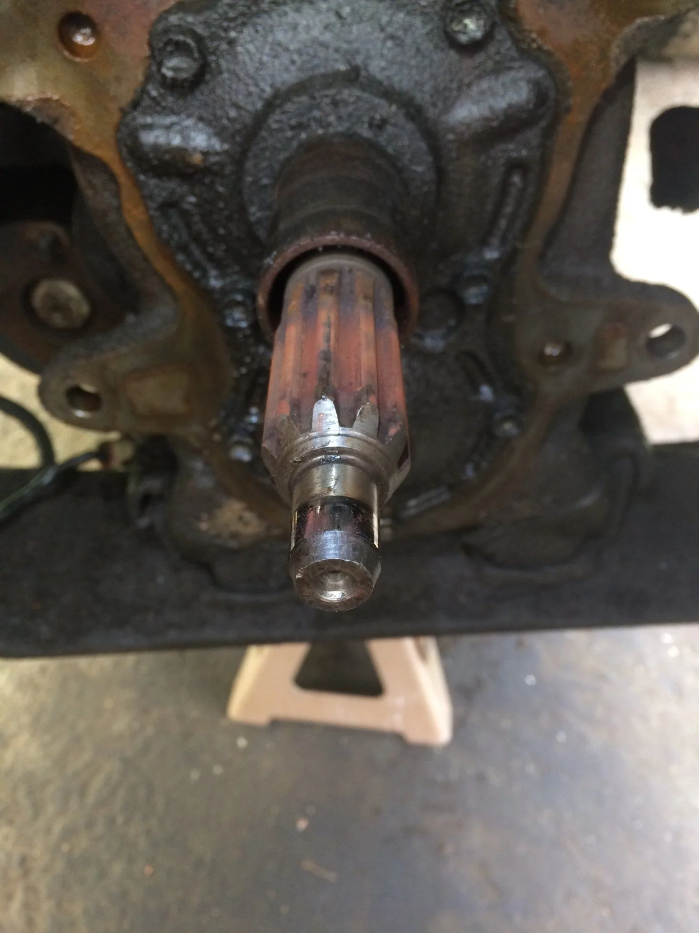

F- Only use the Nachi bearing Pilot bearing from Toyota or OEM. There is a Nachi equivalent available but I forget the number ... @OSS has posted about this ... What is the condition of the output shaft nose on the transmission?
The trick with Cork Gaskets (for me anyway) is to apply a THIN smear of black or Gray RTV and then FINGER TIGHT the cover. Cork is absorbent and will squish if you try to torque right away. Let the RTV cure for a few hours, even better over-night, then torque to spec. They never leak that way.
It’s light brown... thin wipeable layer of rust on it. I’ve yet to get in the bay and put a light to it. Again, I tell you, it’s a damn good thing I’m little or I may have been an ass and f’d it all up if I’d pulled that hoist too hard.
I’ll get in there tmrw and check it out. I take it I’m looking at the splines to see if they have excessive wear?
Splines, yes, but if it has been shifting ok I wouldn't worry about it... I was referring to the nose on the input shaft. If the bearing is bad it wears down the shaft nose that fits into the bearing.

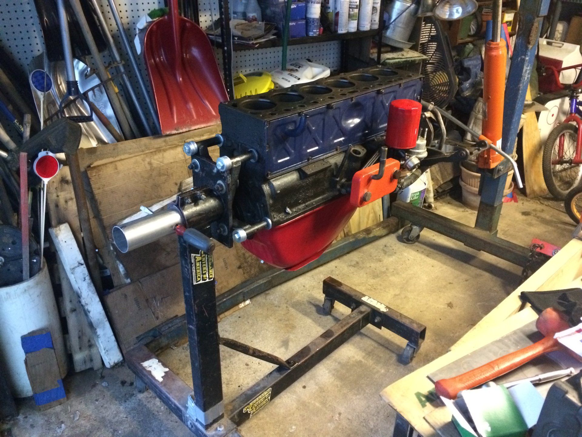

Nice work so far. It looks like you got it out without damaging other stuff...always good.
Considering you’ve already got the head done, you could have this back and running by Friday night ;)
Funny guy. Nah... I’ve begged a transport from the powder coater in town but I need to get everything off and out. Easily could be a week at the way I’m going!

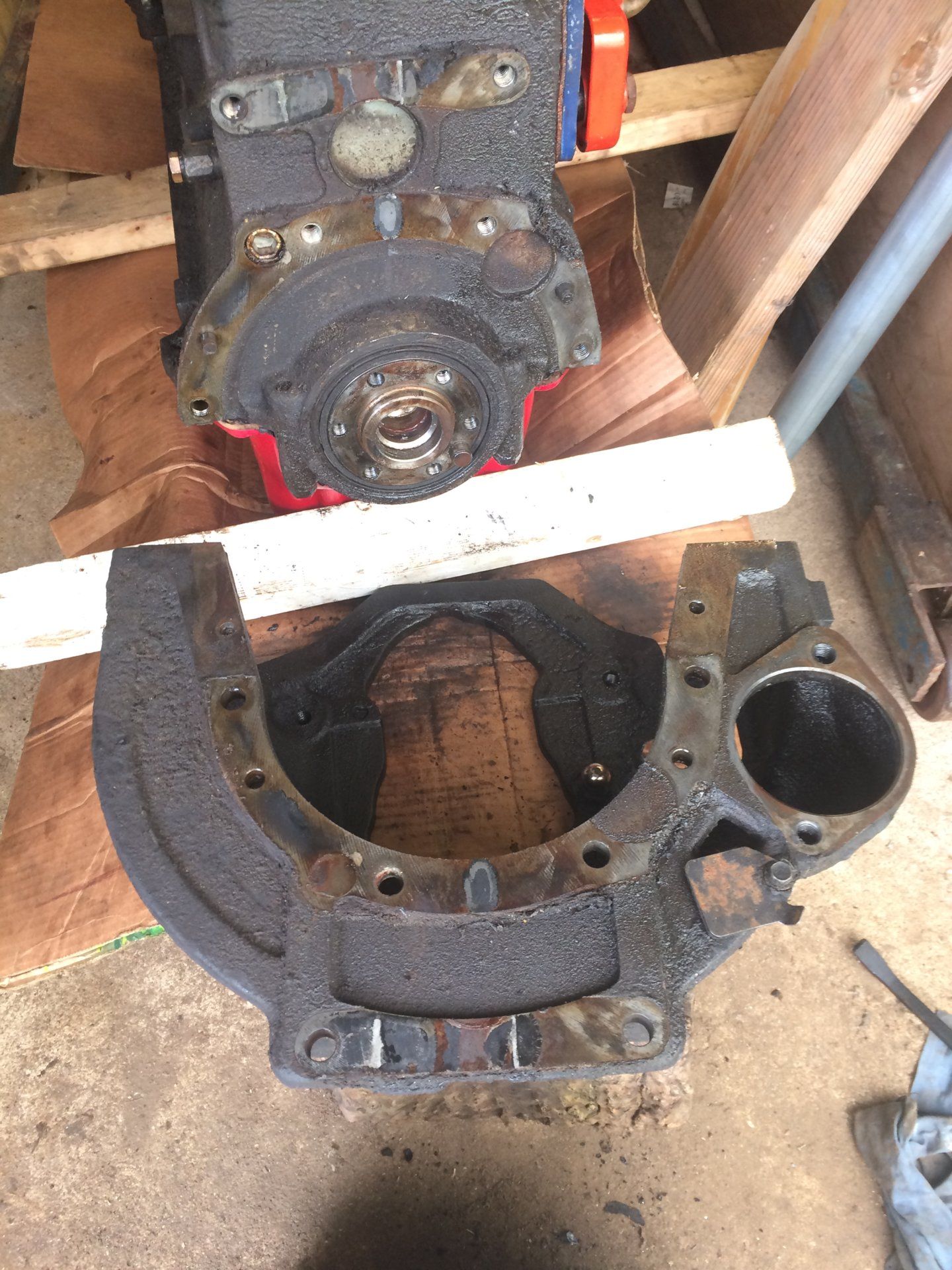

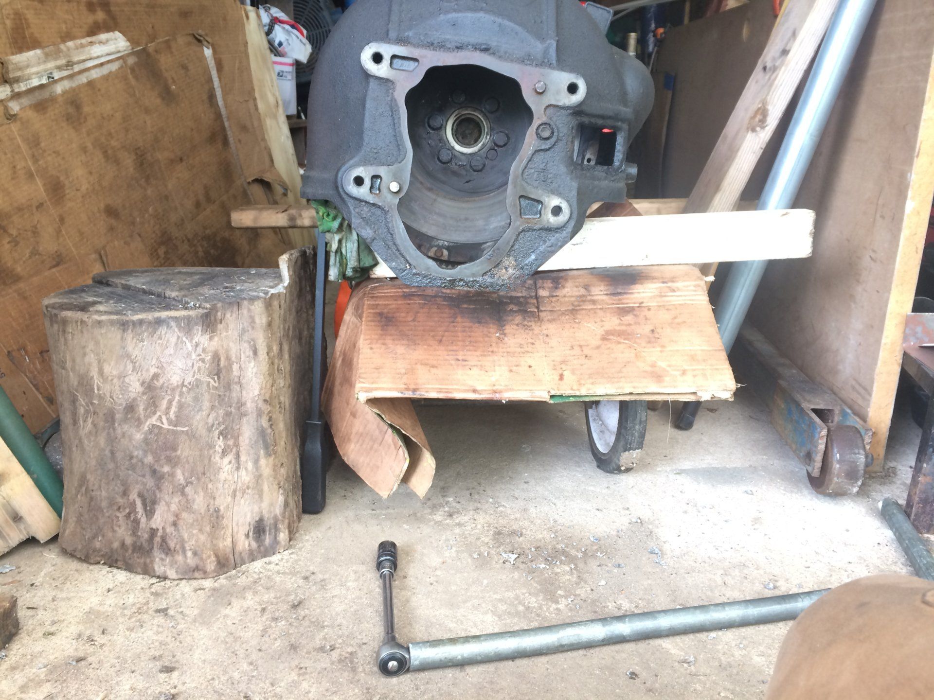

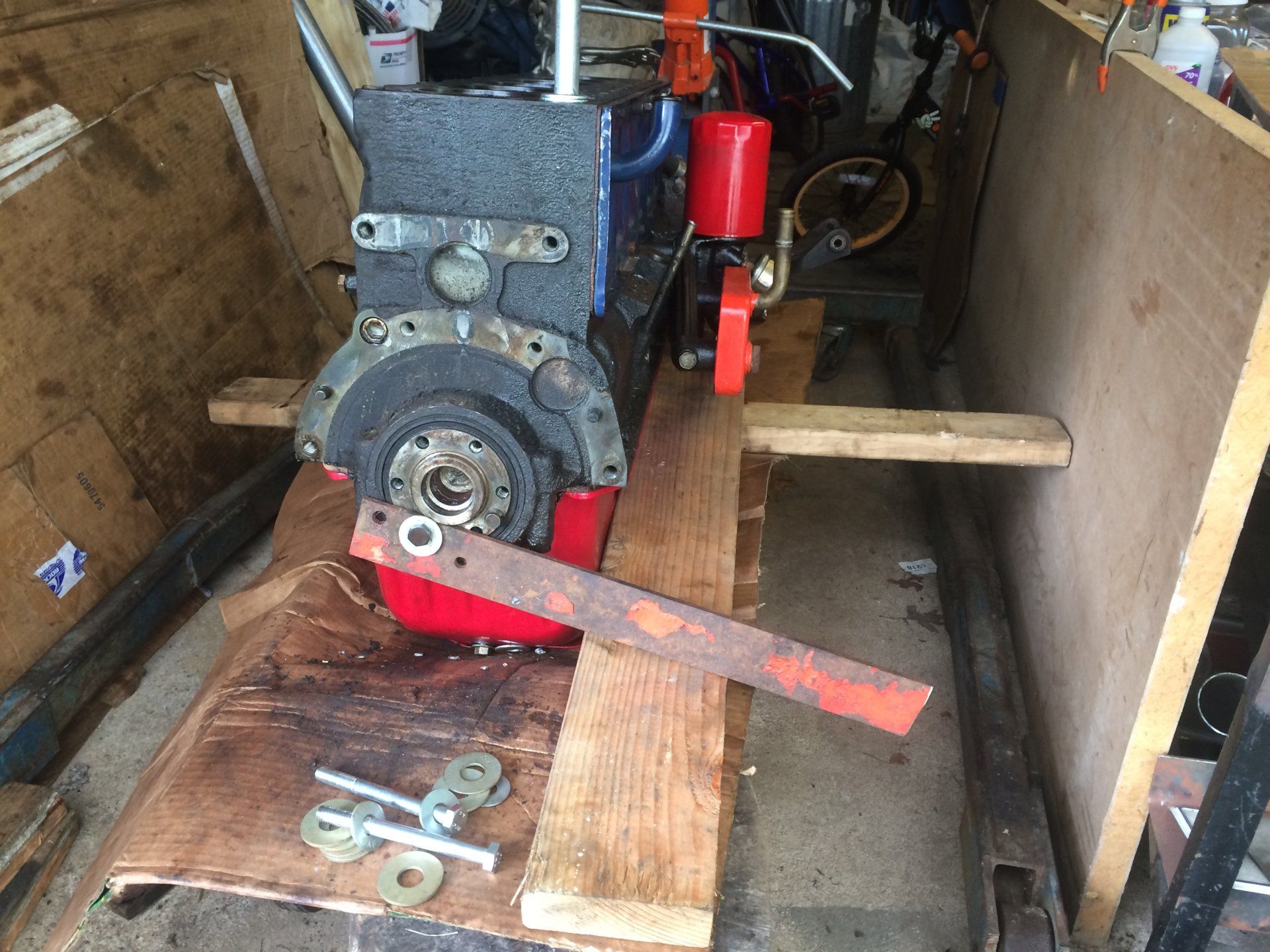

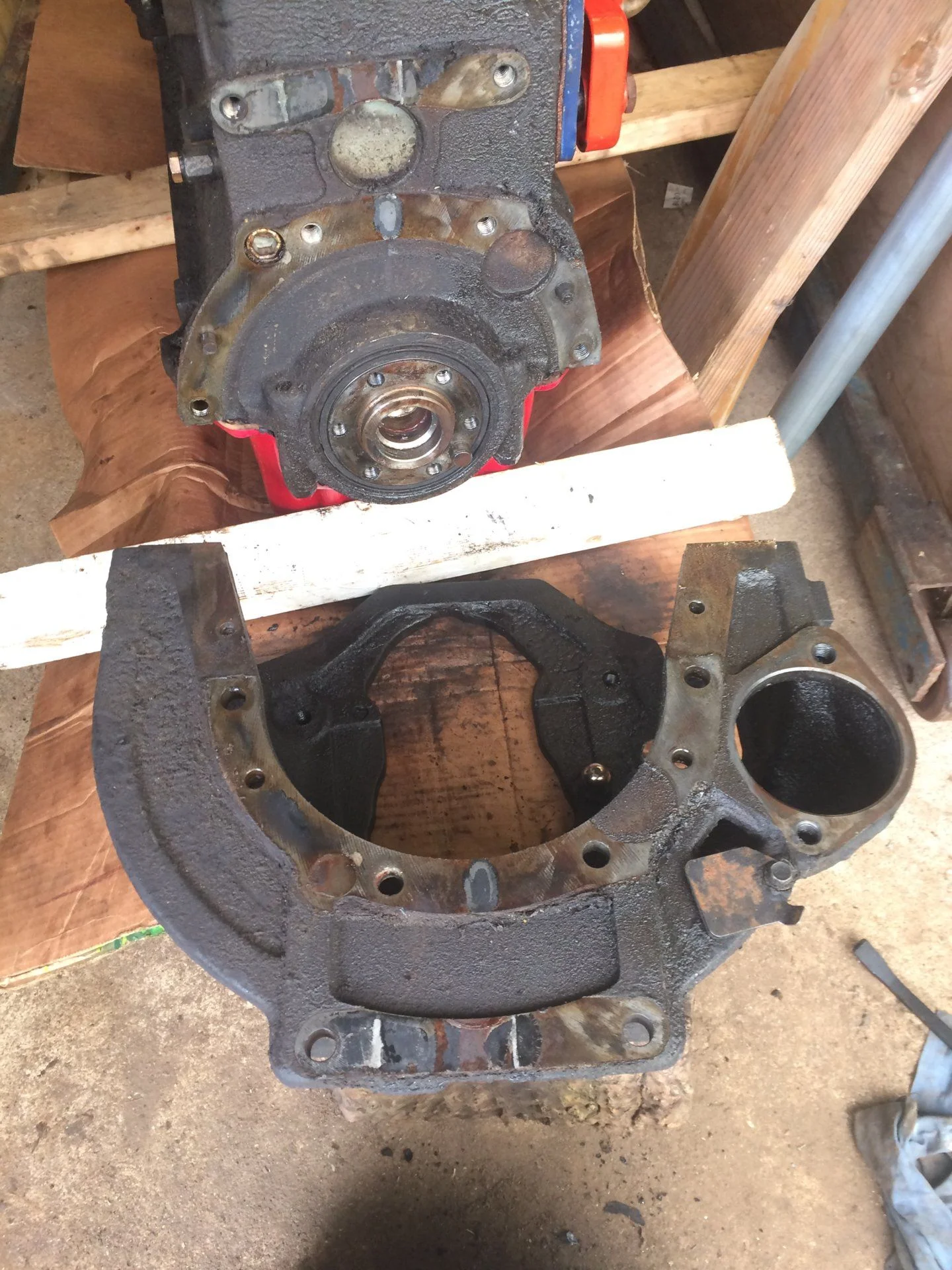

Wedging the flywheel just so took some hard thinking but finally got it.
Celebrating the removal of the flywheel and bellhousing w/ a breakfast feast!

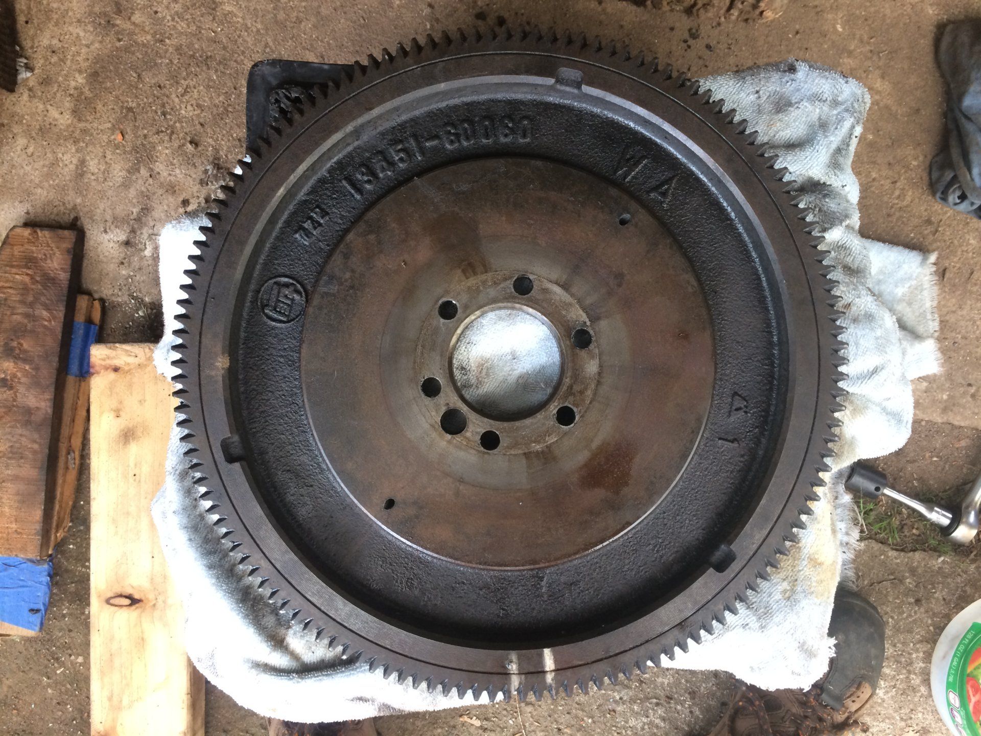

And yes, FW will get resurfaced. Feels like a well glazed rotor.

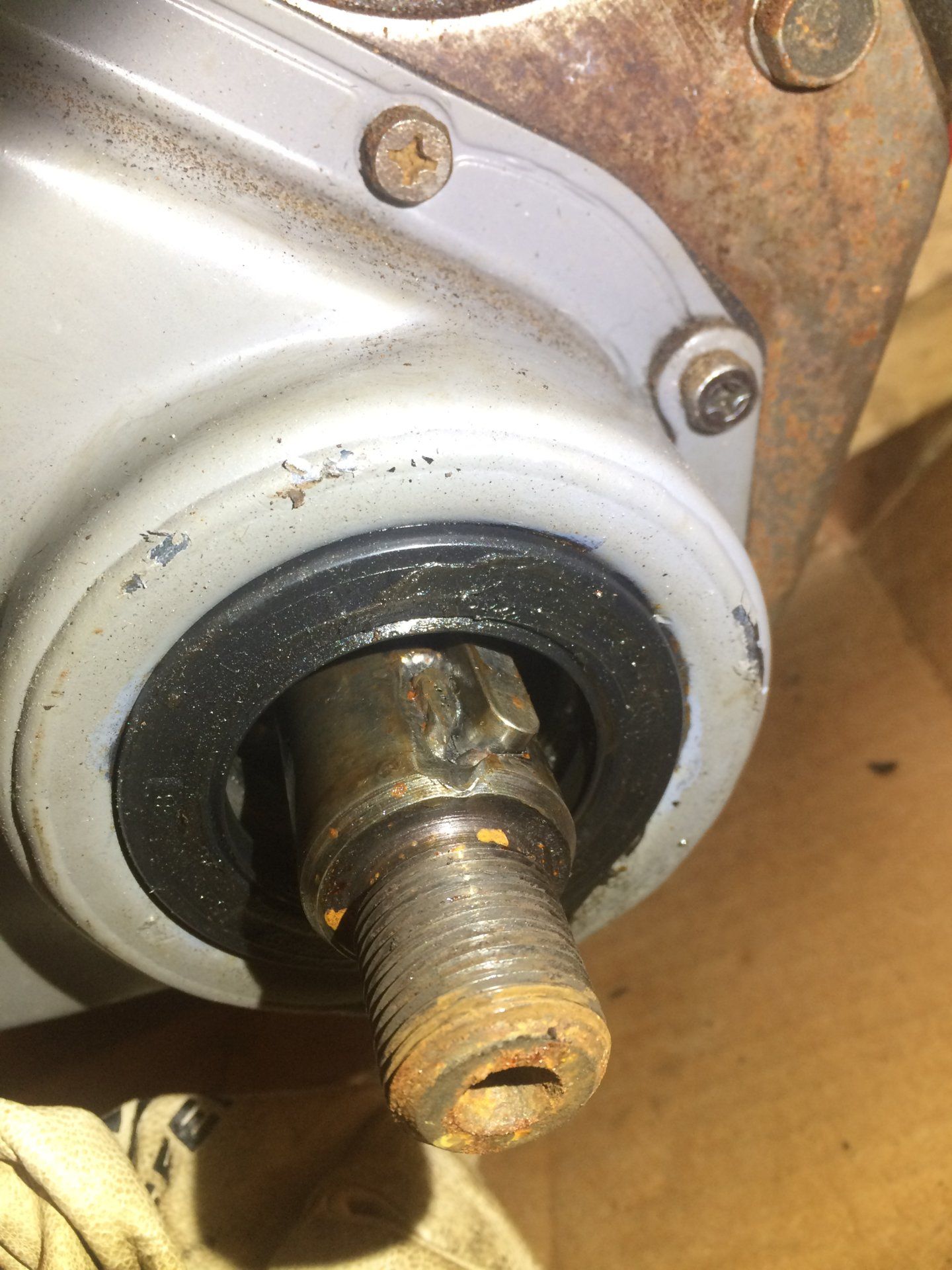

Nose looks good Alf, @Spike Strip.

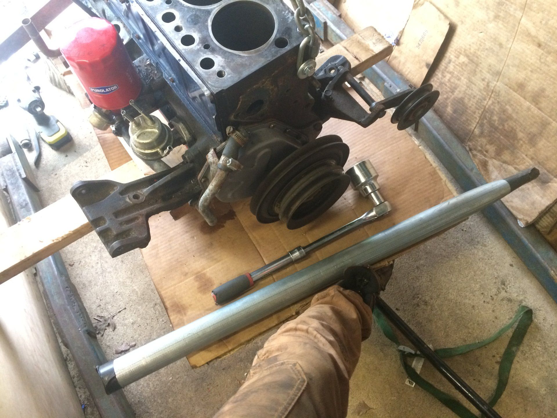

And the HB nut is now loose thanks to some more creative thinking.

Care to elaborate? I’d love to hear your advice. I’ll peobably tear back into it soon enough. How do you get a torque wrench to work properly behind the HB? Sorry to hijack your thread, F.
Hey popping back in here because I had not read this through well... I didn't see your question about the torque of the bolts behind the HB Chris. Unless you have a torque wrench with an adaptor for an open box wrench you have to go by feel. Initially the larger two bolts should be applied with sealer along their threads. All the bolts should be finger tight/loose THEN the HB slide on and its nut tightened THEN the timing cover bolts are fully tightened.

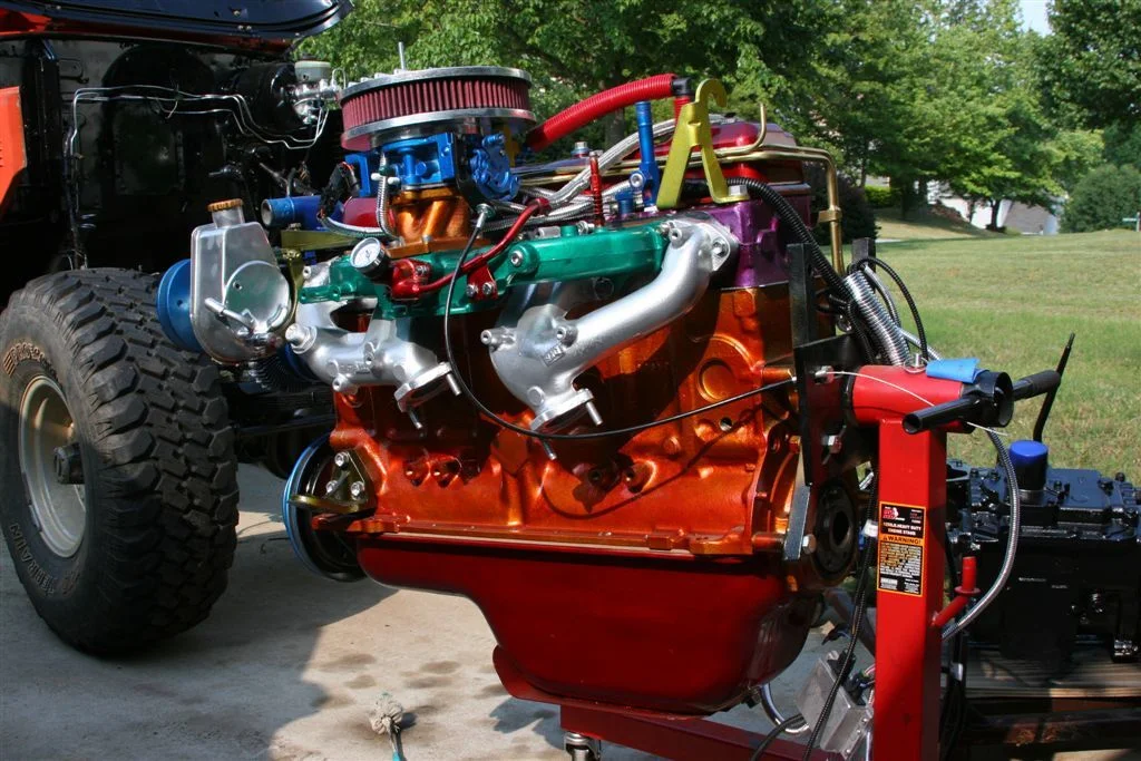

Holy Crapola! I need this in my engine bay! Orange is my favorite color and now I know my block will be sporting it! Thanks Marshall, @Trollhole for the idea off your Big Gay 2F build thread I found wile reading up on cam shafts in the stickies.
Hows that for color @evilorgoodtwin?! LOVE at first sight!
