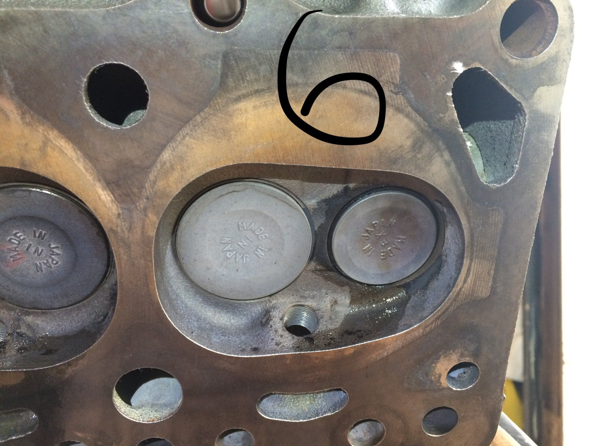

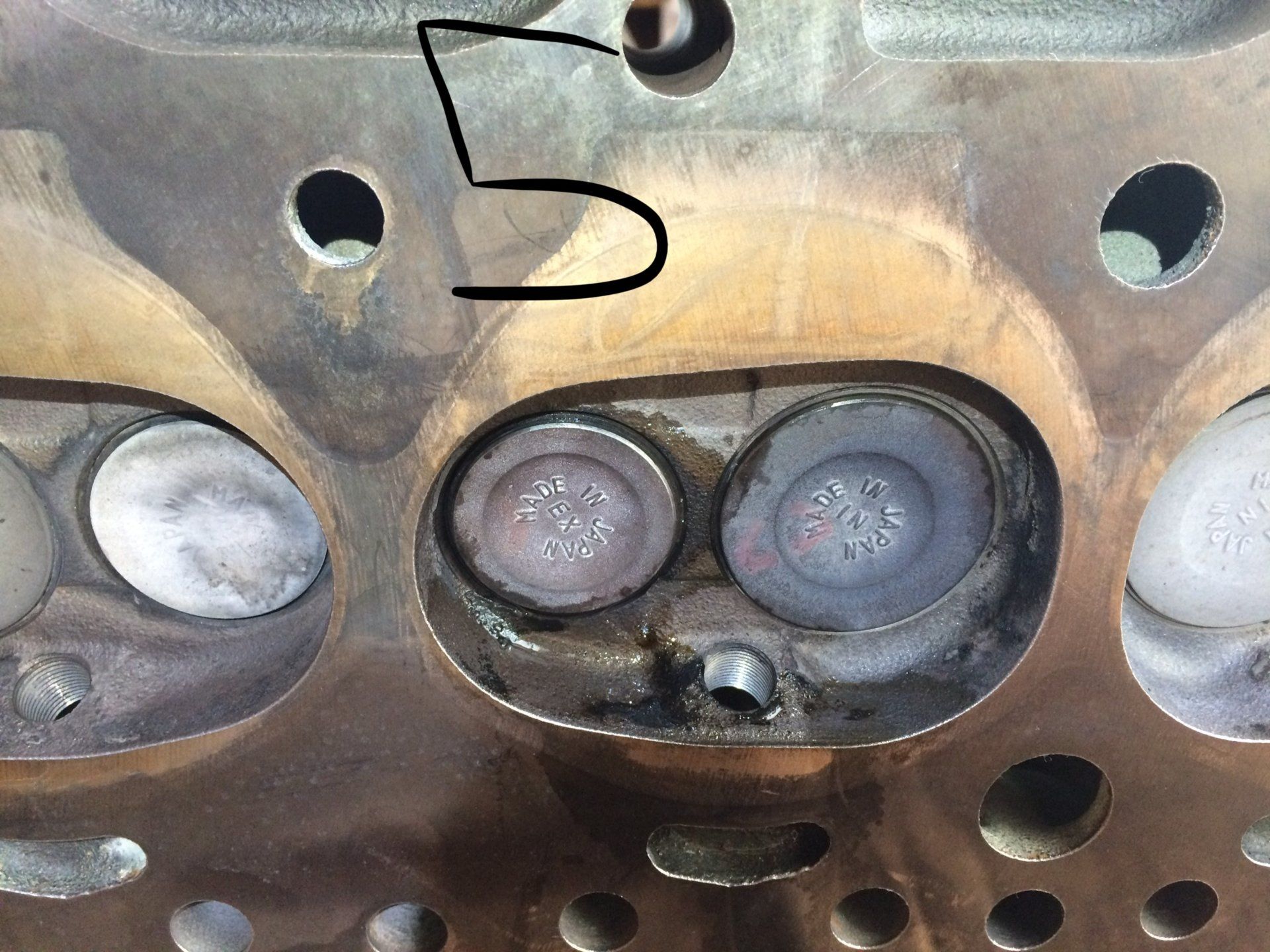

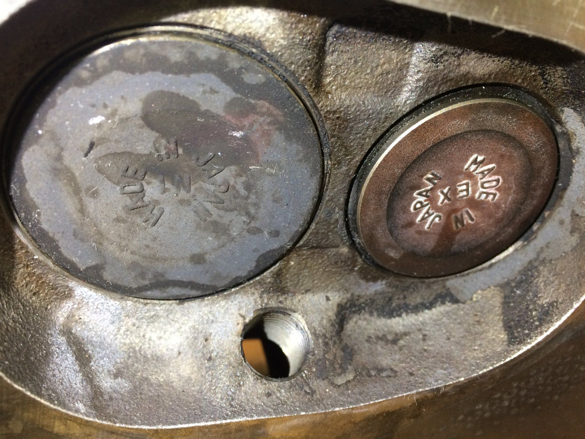

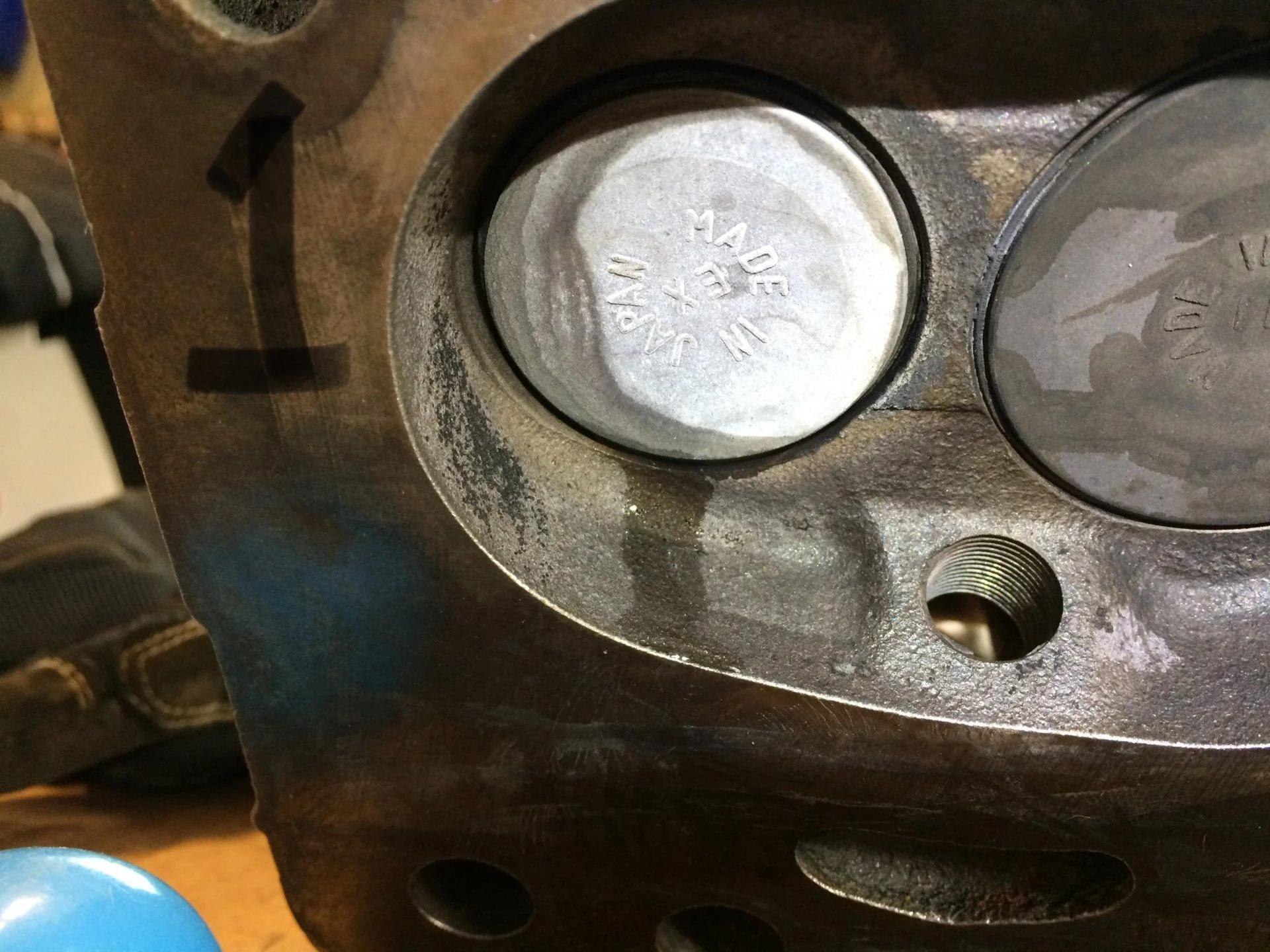

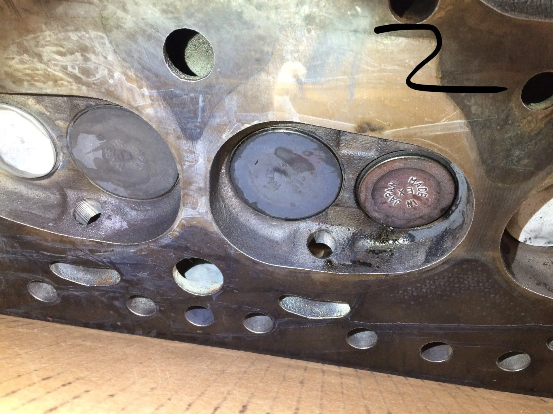

I got home and tried a test someone told me... I poured alcohol into the ports and tipped the head to see if any leaked out of the closed valves. All intakes #6, 5, 2 & 1 leaked. 3 & 4 remained dry, no leaks showed. God damn.

I’m going to smack the springs w/ a rubber mallet and run the test again. Will report back in an hour or so.
Scratch that. Nearly an hour and #2 intake still very shiny around the rim. I’ve not run the test again. I’m going to let it dry longer. I know I could use the air compressor but trying to not ignore kid too long and heating up food.
