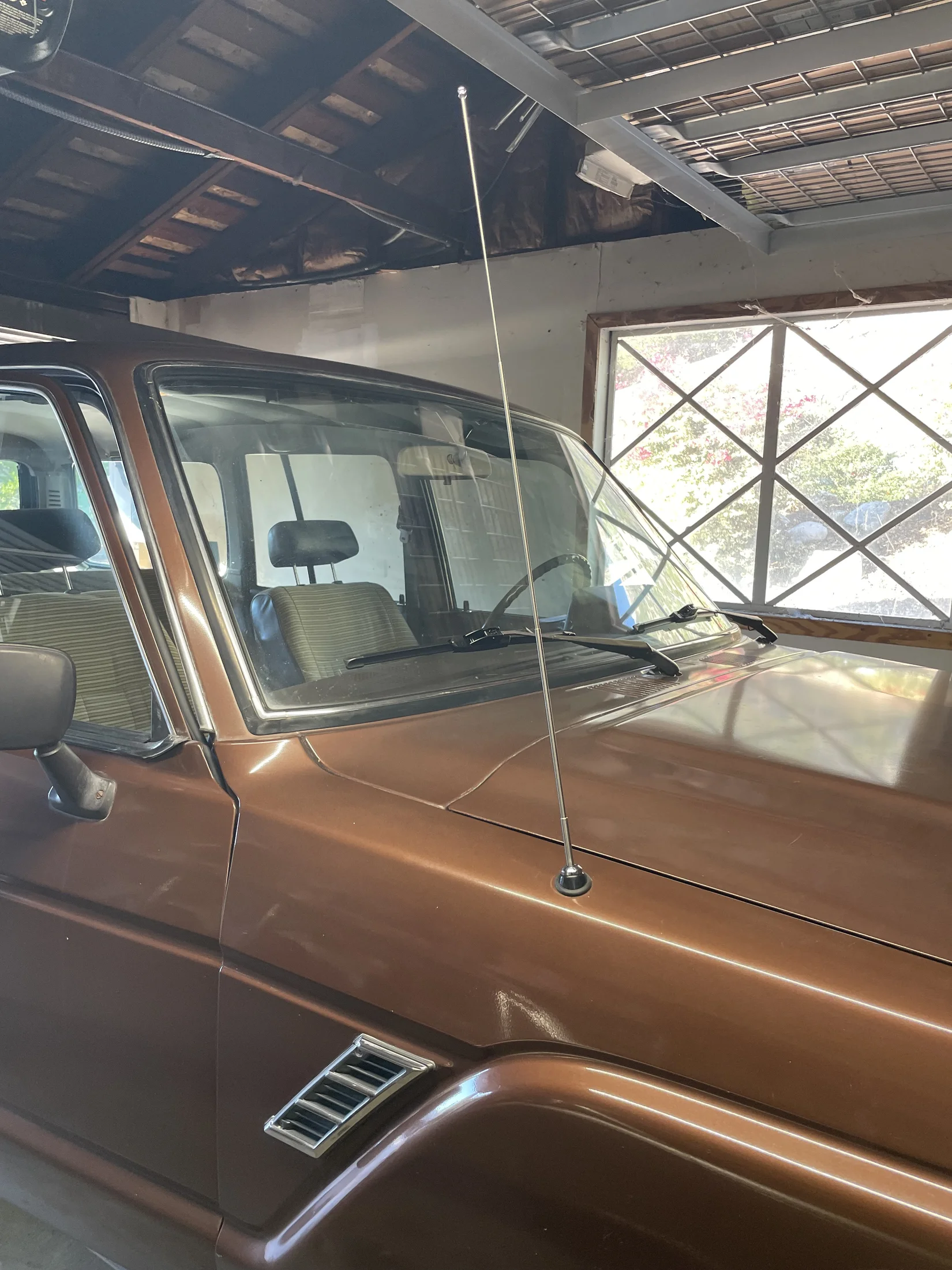

Next up was the new antenna. This wasn't planned exactly, but with another new (old) radio on the way, figured what the heck. The OEM one is $$$$$ but is really nice.
And installed. I know it's kind of a stupid little detail but it makes the rig look way less janky.

Is this an original fj60 antenna, a series 80 or something else?

If the mast is broken on your antenna, Toyota sells a replacement mast that can be installed on the motor. That unit went NLA years ago and is unobtanium, but fortunately the motors themselves are fairly stout and the mast is an easy fix. Good luck.
The last NOS power antenna assembly I saw was on eBay for like $2500 😂
