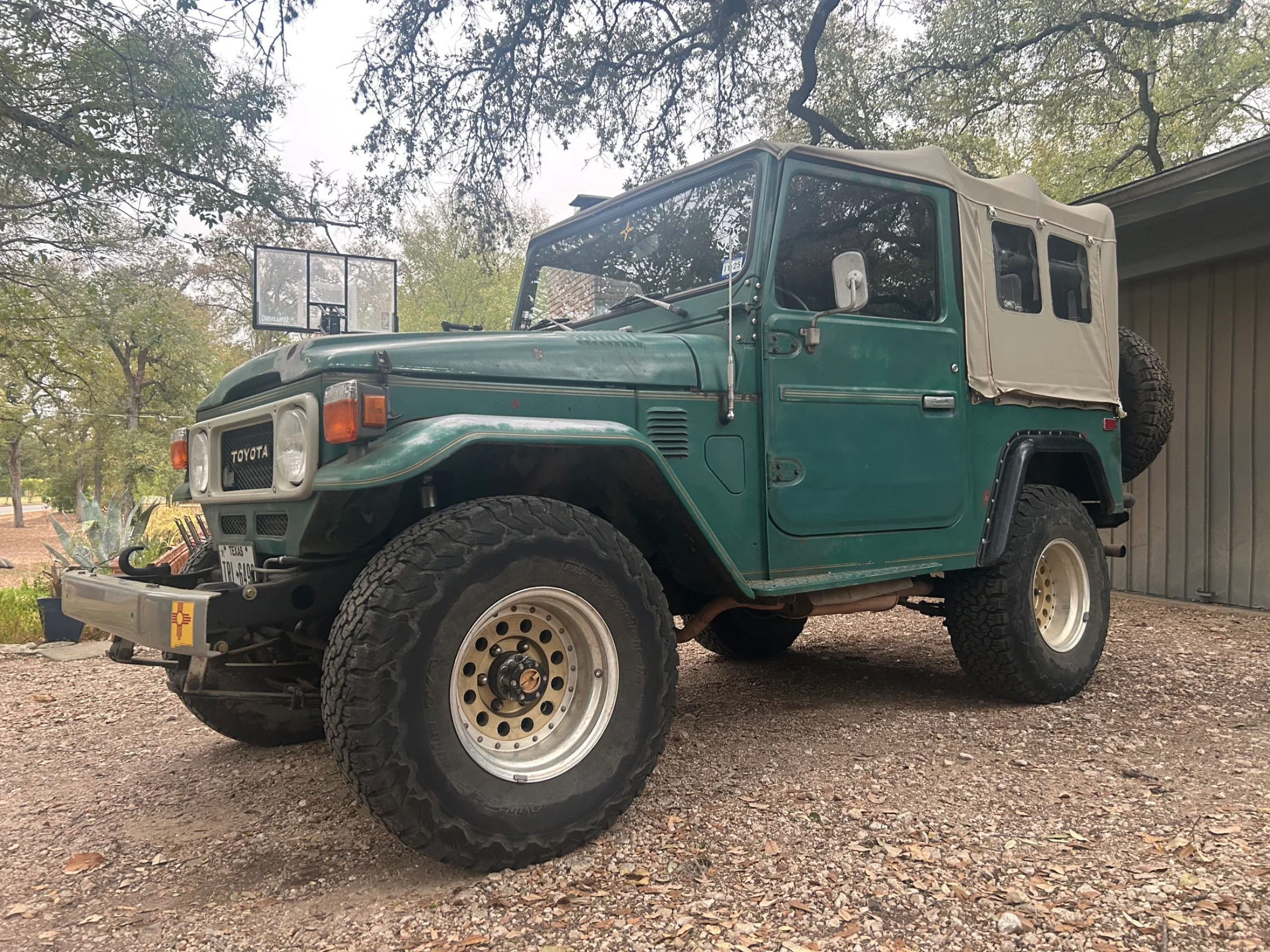

Passenger side, looks pretty good but it was time to change. Grease looked good but thinning, oil seal not leaking but it was rather stiff. Also, the trunnions had a "catch" at dead center, checking with the fish scale was 8 lbs across except in the middle, where it jumped up to 10 lbs.
Plus some genuine Marlin Ecoseals from Mark @65swb45!
Need to get some grease, and then will finish the passenger side.
Good stuff! Joint Fuji!
Yup - whole kit from Mark's Off Road. Koyo trunnions, Joint Fuji seals and felts. Re-packed the wheel bearings (relatively new Koyos as well), which were full but had more thinning out grease. Found some pitting on the rotor, but the brake pads were at about 50% and there's no pulsing, good feel in the pedal so just sent it. Stupid that you have to open up the brake system for this job, though.
Passenger side all done, driver's teardown tomorrow night and finish it out on Friday.

Are those Emkai wheels? My 40 came with a similar set and they’ve grown on me over the years.
Cool - mine are similar but they have no markings on them, suggesting they are old Chinesium whatevers. Fine for now but eventually want to get a set of stockers. Actually - I only need 3 since I already have one kicking around the garage.
