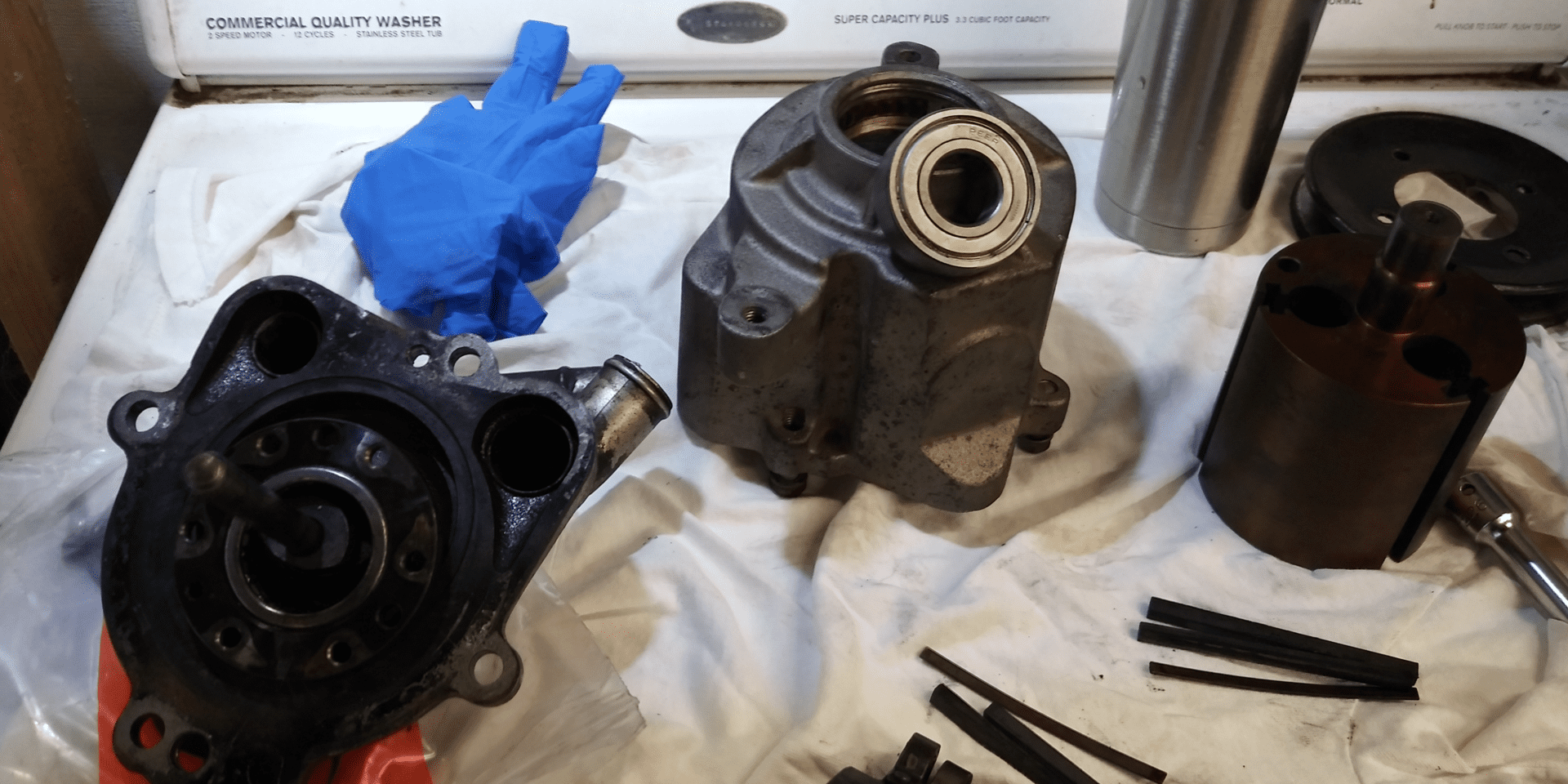

I recently found a place that does Smog Pump rebuilds for FJ40s and FJ60 - Click HERE -
But I wanted to take apart my old Rebuilding Factory pump to see what they had done and to clean and replace what I could and use as a trail-spare (F'ing Kalif!!!)
Now, @rusty_tlc had posted that the OEM replacement bearings are:
1 - NTN 6204LB (front in the Aluminium housing)
6 - NSK J-65 (small bearing in the carbon Vanes)
1 - NSK DB-36227 (rear bearing)
The 6204LB is easy to find, as are the J-65.
@RAGINGMATT or @Racer65 The DB-36227 is unobtanium. I was able to find dimensions LINK but no sources for this Torrington bearing. Perhaps you Gents might know ?
1901781
I've ordered what I could and will post more pics as this progresses, for the peeps that would like to try this themselves.
Carbon Vanes themselves seem ok, not too much wear - You can see here where the small J-65 bearings go. None of these were replaced with the Rebuilding Factory rebuild. They seem a little stiff, but that just may be old grease.
The 6204 Bearing was a Chinese 6204Z
1901784
1901785
1901792

Thanks for the pics and details.
I’ve read in other posts that the vanes are available somewhere but can only be purchased in a lot of 1000’s or so. Do you happen to have a link/searchable product name or number for these ?
And does anyone know why the air pump fails? Is it a seized bearing issue or do the vanes grenade and seize the internal workings?
In mine the thin metal strips which ride between the vanes (I believe if memory is right) slip and get bent and stop the spinning. I have photos way back from when I pulled mine and took everything out to inspect and I still have it all set aside in a box in the garage.
Why are carbon vanes used? Why not substitute in aluminum or another metal? Is it a temperature thing or centripetal acceleration mass thing?
"You can see here where the small J-65 bearings go. None of these were replaced with the Rebuilding Factory rebuild. "
Are you going to ask the Company why they didn't replace them? Seems like you should "call them out" on this.
Good work so far. How will you get the metal trim/edge piece back on the carbon blades? Did they fall out? Don't they go between the housing and the carbon blade?
My guess is the carbon soot from the exhaust coats the bearings until they fail then when they fail they cause more slop in the turning blades until they bind and break. Which sometimes causes the whole thing to seize and throw a belt. Just a poor design. Maybe we should have high flow filter mounted in the hose to take the carbon out before it gets to the air pump.
I agree with g-man on asking why they didn't replace the small bearings especially given the price.
I did the exact same thing on my spare pump. What Spike Strip did is I took it apart cleaned the inside housing, cleaned up the bearing and put it together.
Usually when it gets oil from a leaking PS pump it collects dirt and debris and makes it fail. And gums up!
I do not have a source for the vanes. Wish I did. No doubt would take someone in the industry to source those. There are no markings or numbers on the vanes. The bearings press into the brackets that are riveted to the carbon vanes. The bearings look to be directional as one side of the race is thicker than the other. I'll know more when the new bearings arrive.
"Carbon soot" does not coat the bearings as the intake air to the pump is pulled from filtered air on the air cleaner plenum.
Vanes can not be Alum as they glide against the metal housing, although there's probably a better modern material available now.
I don't intend to call RF to ask about the bearings. Rebuild was 10 years ago. Just another dishonest rebuilder I now ignore.
Purpose of this thread is to take advantage of the genius and reach of this outstanding forum and world-wide reach of the internet so somebody with knowledge and access to these parts will see this and say, 'hey, my Uncle's Cousin's lover is a rebuilder...' and know the appropriate substitutions. As well as provide an alternative to someone who may just have a bad front bearing which can be had for $10 or less if using China-made.
