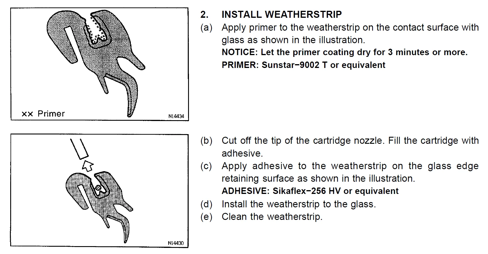

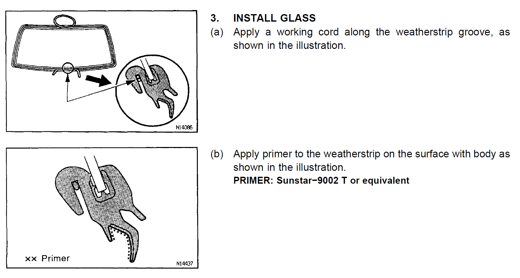

I need a glass shop who can replace and seal the gasket on an 80 series correctly. The most recent opinion I have, which I don't trust given the source, is that the sealant that is specified in the FSM is no longer available and no replacement is available, therefore the repair cannot be performed.
He told me all that was available was silicone and that it wouldn't last more than a year. He also told me that the current automotive glass urethanes will not work with the Toyota 80 series rubber gasket, because they are designed to cure dry and the Sikaflex -256 HV was not. These statements I believe.
I have a call in to Sikaflex Ireland, the only source for the current primerless Sikaflaex -256, to get an opinion on equivalency between the primer required and primerless sealants. More to follow.

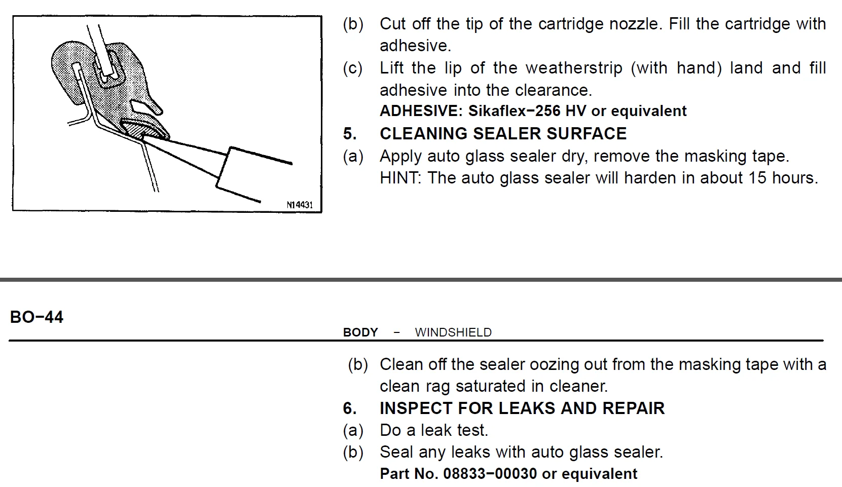

If I can't find someone who'll do it, I'm doing it myself. I have a call in to Sikaflex to verify the current -256 is equivalent to the spec -256HV. As soon as I have an answer, I'll be set. Apparently the 3M 08350 is the equivalent of the Toyota 08833-00030.

Before I did my windshield, I spent too much time reading through old threads about the horror stories of installing it yourself and how it was a 7 1/2 :banana: job. I had no other choice so I went looking for the materials listed in the FSM and, like you, was told they were no longer produced. I ended up getting/using 3M Windo-Weld and the associated primer for it.
I was mentally prepared for an all-night task based on what others had written. With the help of my wife on our first ever windshield install, we were done in 30-45 minutes. It just took the 3M products, some rope, HF glass suction cups, and a caulk gun. We did the rear glass too and were all in at about an hour and 15 minutes. My only regret was using a standard caulk gun with the lowest thrust ratio…my hands and forearms were toast; the Windo-Weld is not a viscous product.
I went a bit overboard with the urethane and had to squeeze out lumpy spots, but lesson learned for next time. It’s been about 2 1/2 years and everything seems to be holding up fine.

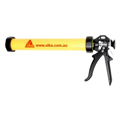

I had in the plan to get a pneumatic gun. The Sikaflex -256HV is(was) supposed to be "high viscosity", presumably requiring Popeye to squeeze it out (or maybe it was so it didn't flow out all over the place and require hours of cleanup). Now it seems everyone is packaging the commercial adhesive in sausage casings, so you really have no choice but to use an "automatic" gun.
