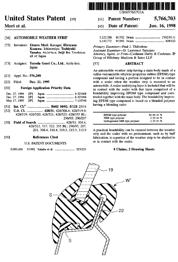

In the FWIW column (because this is what I do for a living), Toyota actually patented this gasket; the patent lists isocyanate primers Sunstar-9002T from Sunstar Giken CO.0, K500 (from Sumitomo Three M) and SL8861 (from Sakai Kagaku CO.) and DISMODULE RFE (from Bayer Co.) for EPDM. The patent also specifies urethane sealant (for example, CS1450 from Cemedine Co.), but states that other "conventional" sealers could also be used.

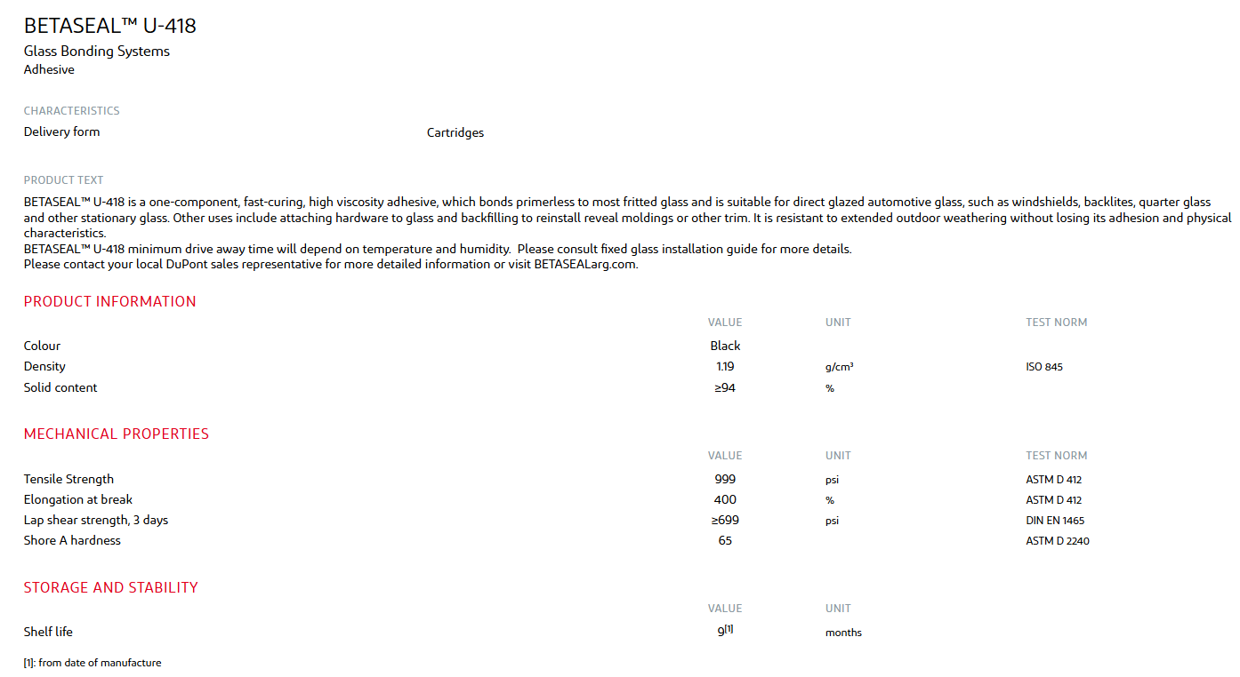

I used Dupont Betaseal U-418 black urethane on my last windshield replacement, after much searching and sleuthing:
No primer is necessary between the gasket and glass, however you do have to apply the urethane to the gasket and install that on the glass, as directed in the service manual, prior to installing the glass onto the body.
You can use this cartridge in a manual applicator.

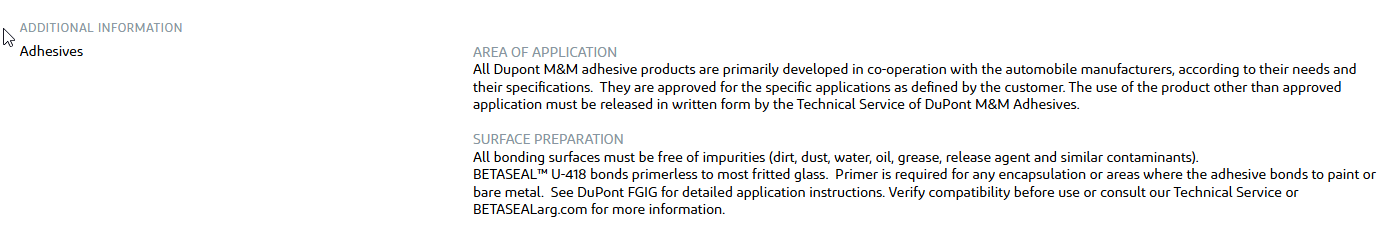

Although the product specs indicate a primer is necessary for adhesion to painted or bare metal, I had no trouble getting it to stick. 2 1/2 years and no leaks.
» Dupont 5504-G is the recommended primer, for use as an adhesion promoter and to fill small imperfections in mating body surfaces.
» Dupont Betaclean 3000 is recommended for surface preparation prior to application on painted or bare metals.
That is super-helpful. Thank you.
FWIW, U-418 is an OEM (for who, I don't know) windshield sealant.
"HV" just means high viscosity. It's the fast cure type, mainly developed for driveway installers use.
