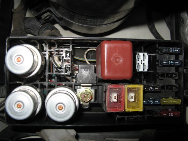

Just realized a free bonus to the LCP window mod
The relay you remove is the same relay used by the EFI system (90987-02004).
Toyota was kind enough to provide you with a convenient place to store it in the main fuse box under the hood. Just plug it into the unused socket (labeled -CDS FAN) in the main fuse panel (see photo) for safe storage. When your EFI relay acts up or goes bad you now have a spare.:)
