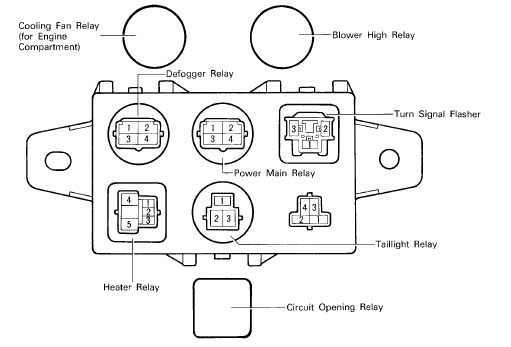

Did not find the PW relay.. The windows still worked with the key on regardless of any of the relays behind the kick panel that I pulled. I do not have any schematics to look at. Does anyone have any info on the location of the PW relay on a 1991 FJ80 so that I (and OTHER 3F-E owners) could be included in this modification.... Please....

Yes, this can work on a 91. The relay is the "power main relay". By jumping pins 2-4 the windows and sunroof will work with the key off. I changed mine to work with the key in the ACC position by changing the logic to the relay. Did this several months ago and it is a great mod.
I attached a picture of the relays in the driver's kick panel for you.
Excellent. Thanks very much!
