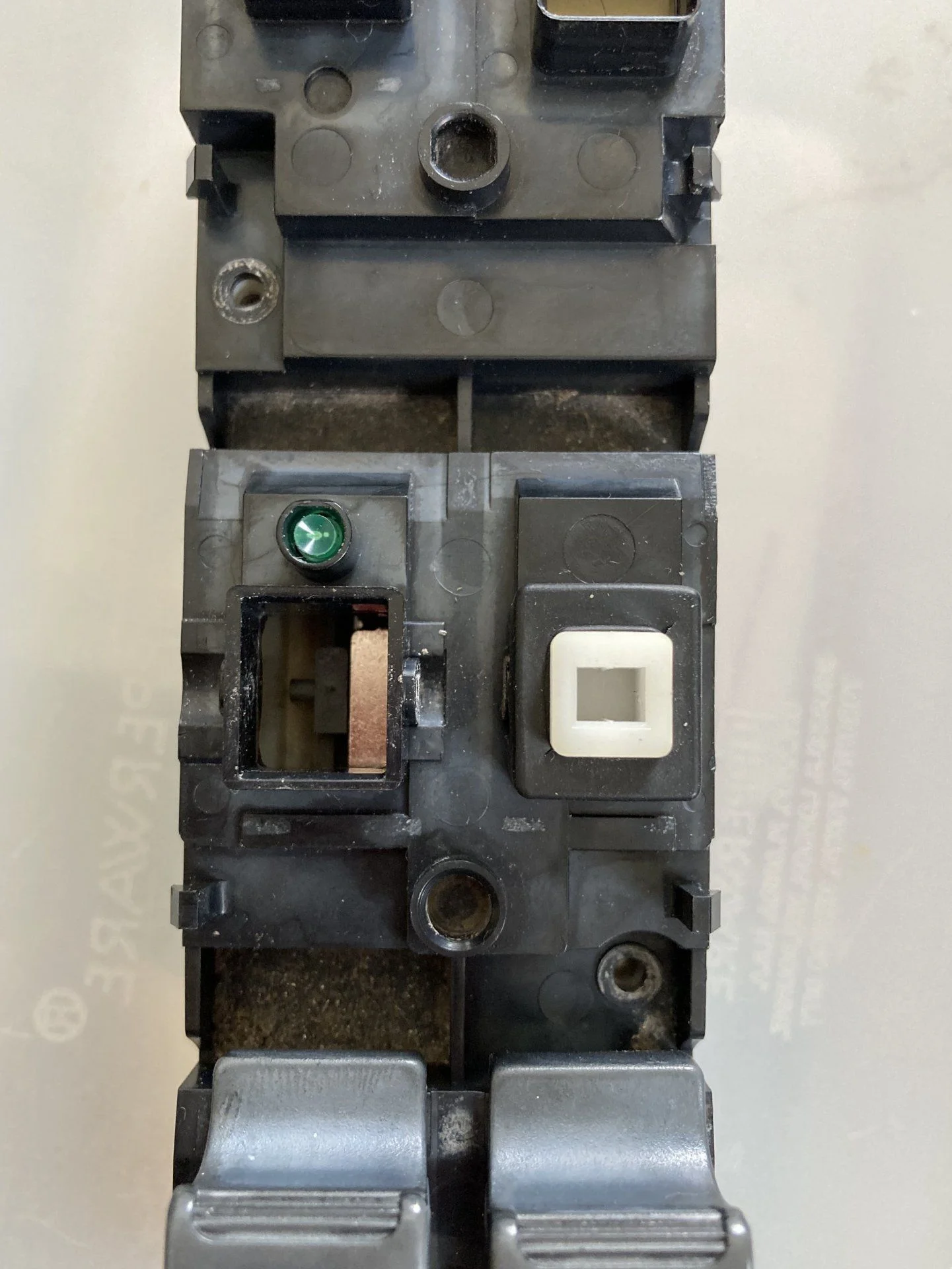

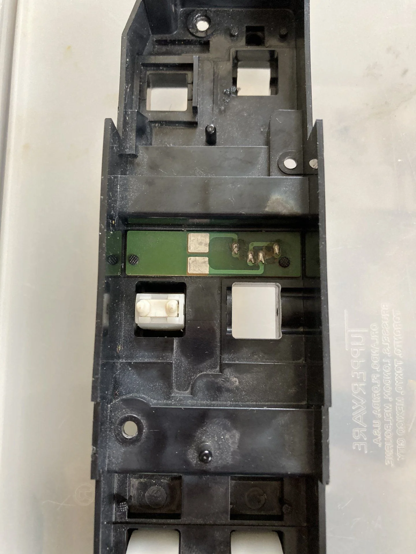

I also had about 100mA of parasitic draw: 160mA with the mod. With the jumper removed it went down to about 60mA. I ended up just destroying the auto bulb while trying to get it out, which lowered the draw to 140mA. Looks like the sunroof motor is the culprit. How do you access that?

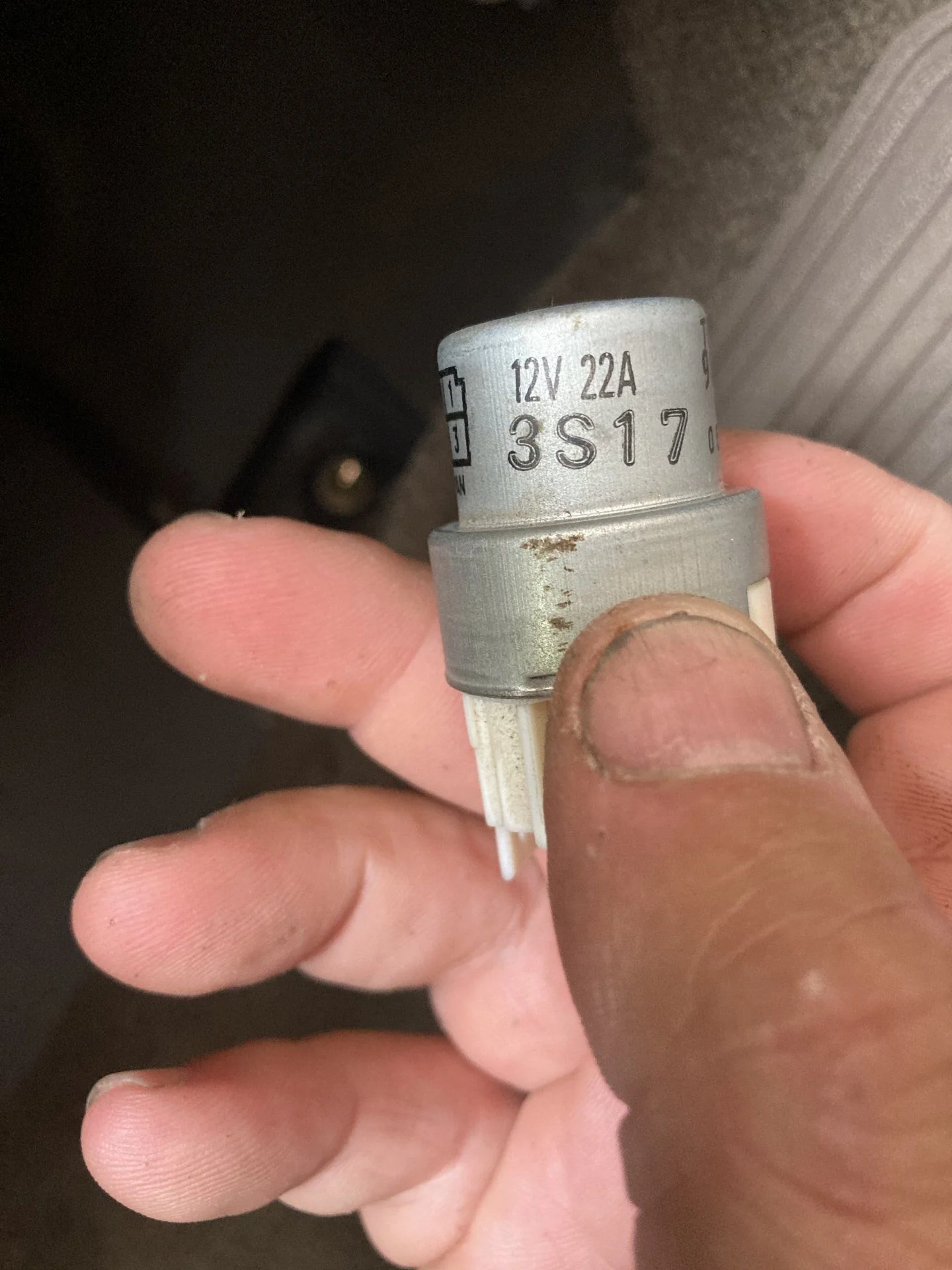

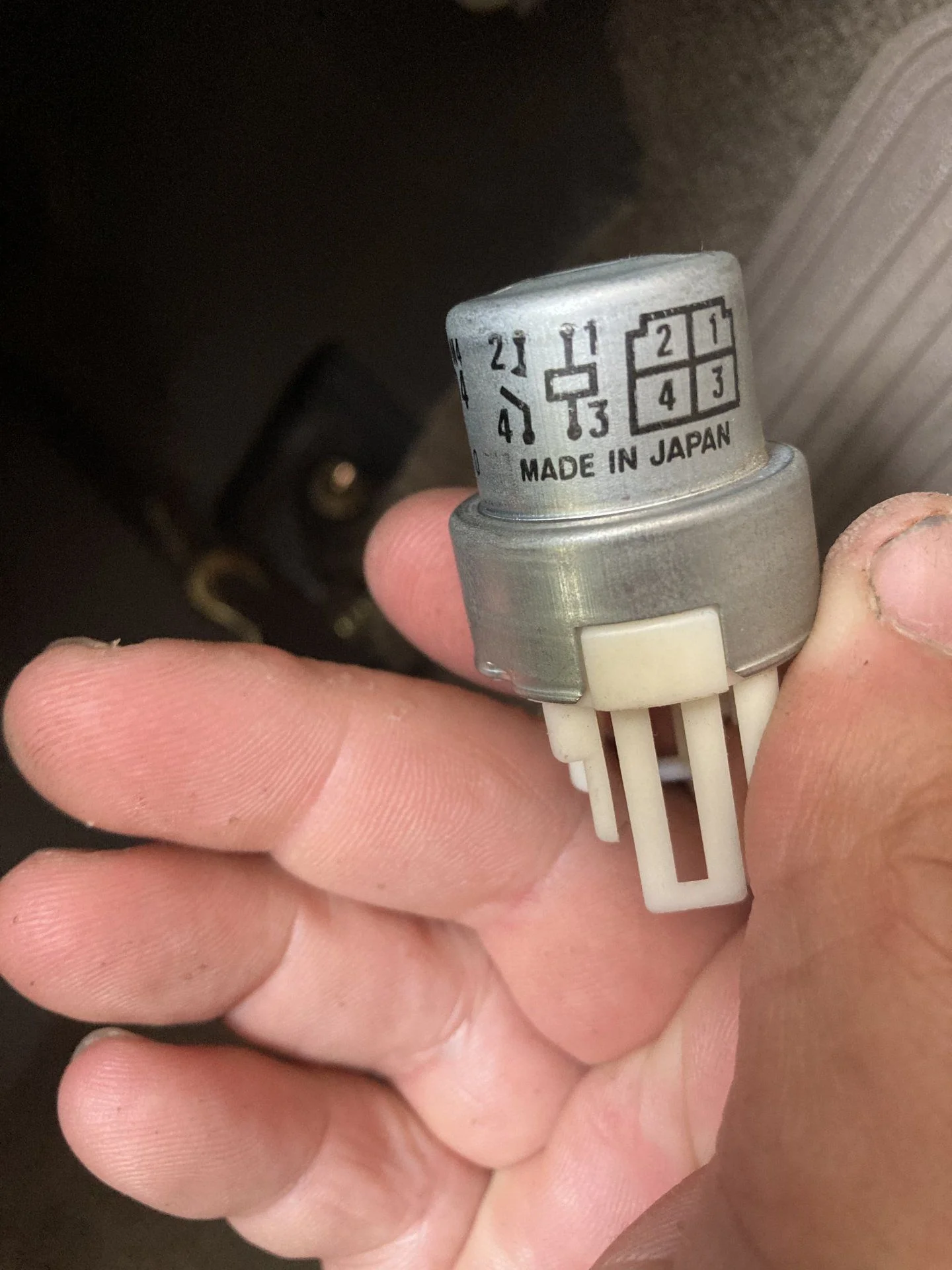

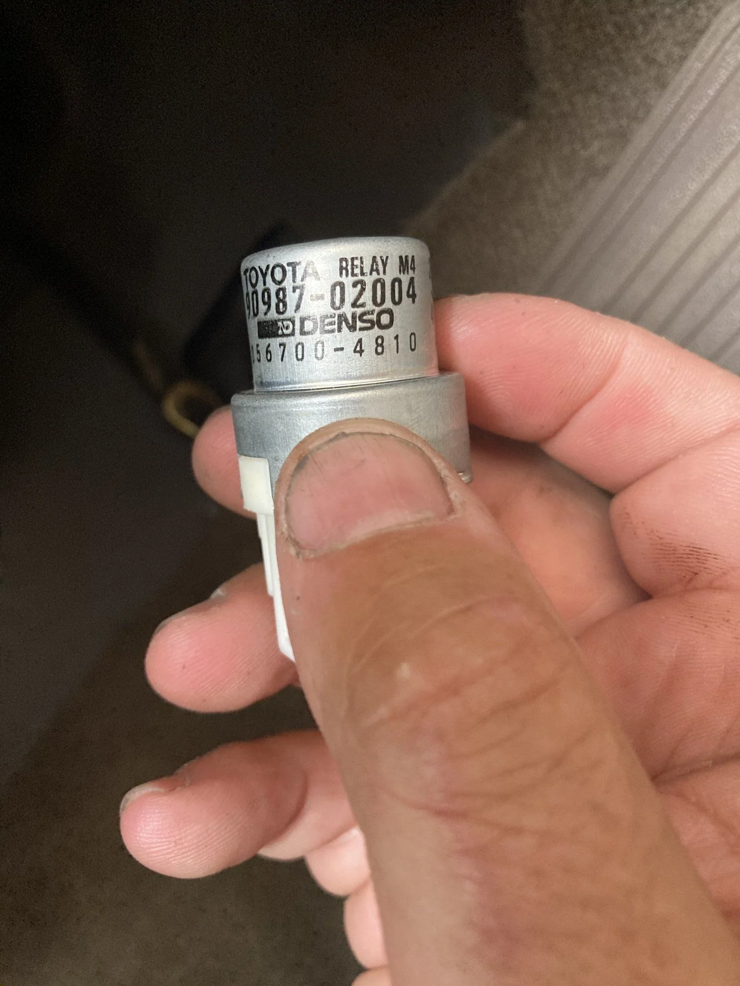

I would put the relay back in but I don't think I have it anymore. Does anyone know the part number?

ah. so i was going to go in and pull the auto light and was posting back here to ask how to do this properly.
i actually made two jumpers because i misplaced their first.
so as much as i love this modification it is going to result in a parasitic draw of 100 mA?
For me, I removed this because my battery was dying every 3-4 days. I did some sleuthing and found this mod was causing the draw. I do not drive mine very often and got tired of jumping it. With it removed, I can go 3 -4 weeks now. If you DD your 80, this is a non-issue.
