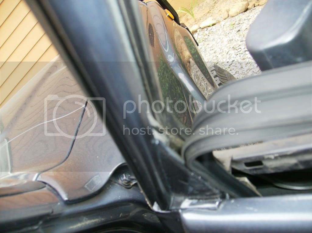

Ok I finished the last door today and also ran the window trim. The window channel (part 30) went down enough that I was able to remove the old cut piece. There was maybe 4" at the bottom- the window didn't move. Let me say the difference is dramatic, the window seals so well I am going to do the other doors. The felt also makes a huge difference and it seems alot tighter against water. Mind you I know water will still get in , but nothing like it did before. I will have to clay bar the area that was previously covered to get the bit of wax and dirt off of the paint. I just painted in 2007 so your under chrome results may differ.....
Here are the pics

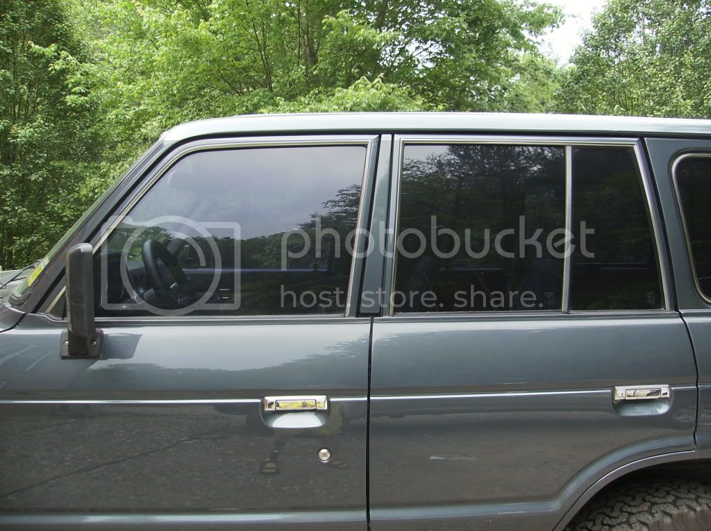

The front with chrome strip still on
Front and rear comparison

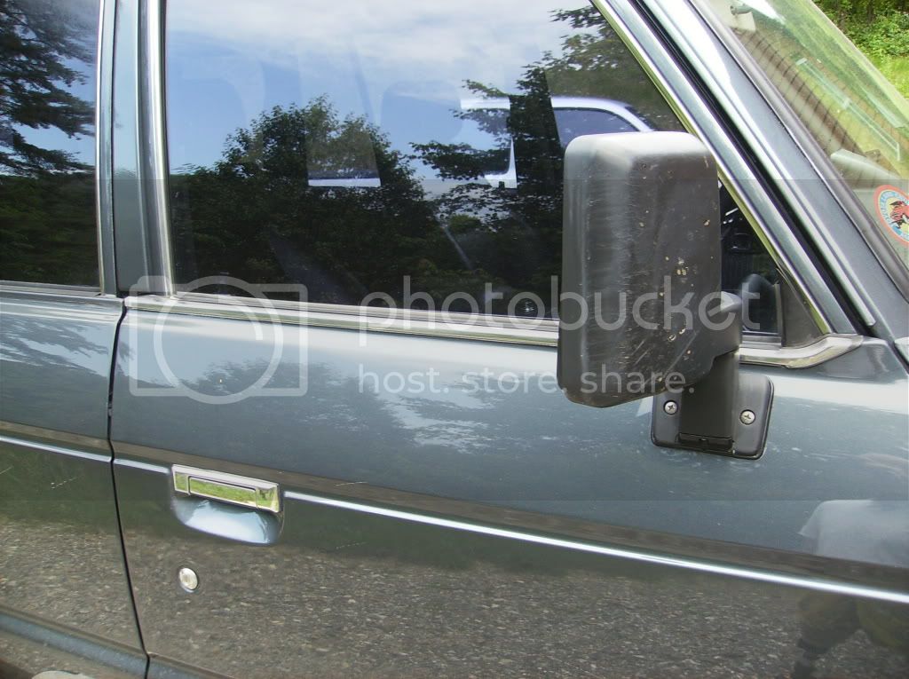

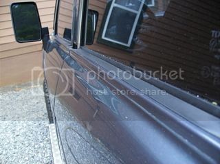

Drivers side done with no more chrome strips...I just noticed the reflection of some one legged bastard
Drivers side close up

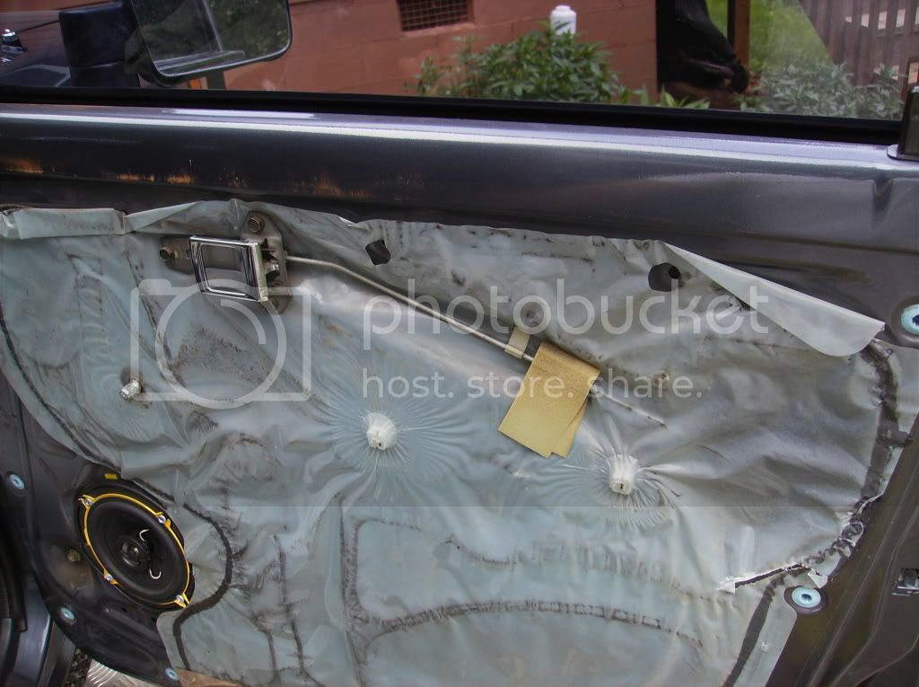

Check under your door panels every so often...rust never sleeps

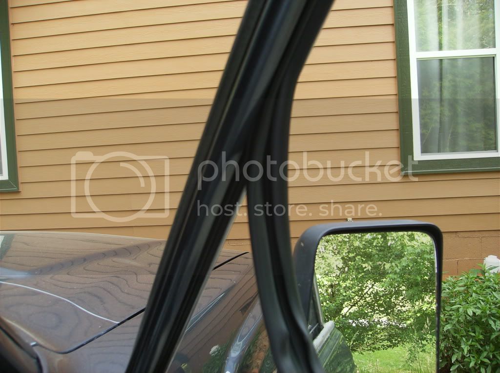

Feeding window channel rubber
It fits in very easy

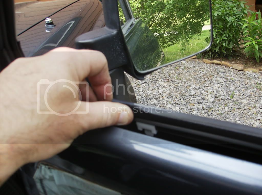

Clipping outside felt in
Just push until it clicks and your done
Titanium?
What was the total cost (the felt/weatherstripping, not the leg)?
You have some chrome to remove around the windows there, sir.
You wanna powdercoat those door handles now too, huh?
Last Q: Respray? The condition of your paint kicks the s*** out of mine (same color).
Yes to Titanium- with elevated vacuum ;)

as far as paint I had them wetsand the orange peel out. It made the paint a little thin but looks much better....and clay bar and consistent wax helps alot for maintanence.

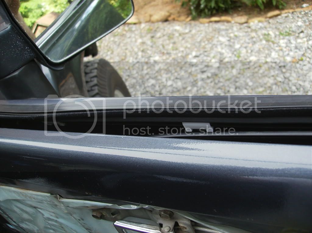

Hey smokey - another Q -
Did they come with the clip shown here? It has to help to use these plastic clips instead of the original *usually partially rusting* metal clips.
thx!
rob
The clips do come with them, they already attached when you receive them.
