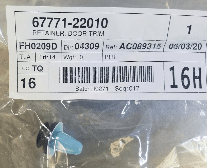

For those looking at getting new OME retainer clips for the window felt or door card clips....

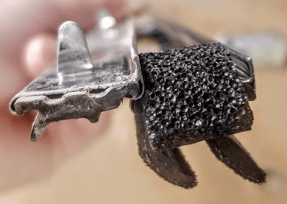

I pulled the rear driver side door card and compared the old felt to a new front door felt (both inners).
Other than the new felt being too long (needs cutting to size) it's a perfect match ( the tabs line up).
Guess what Im doing.......
Old vs new....
Piece of new felt for sizing....
