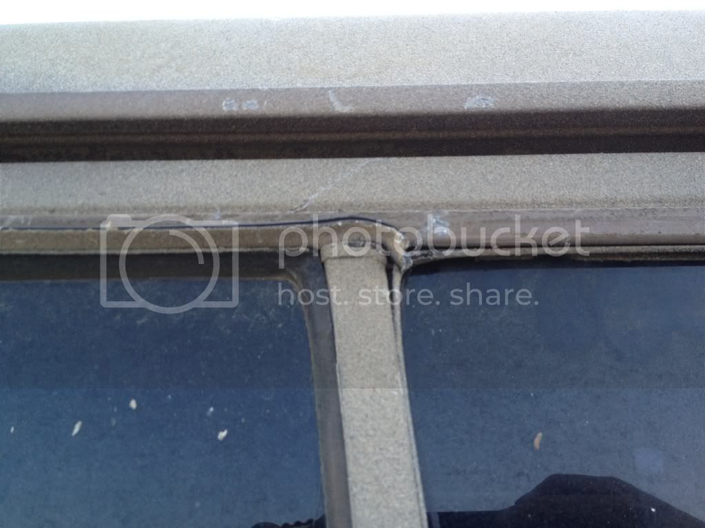

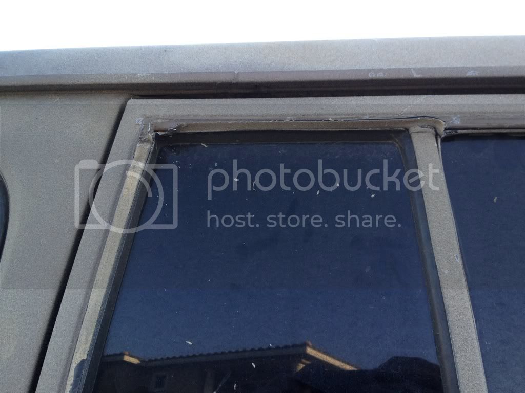

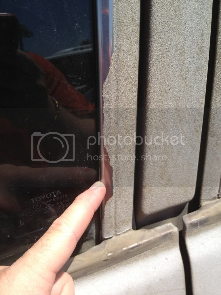

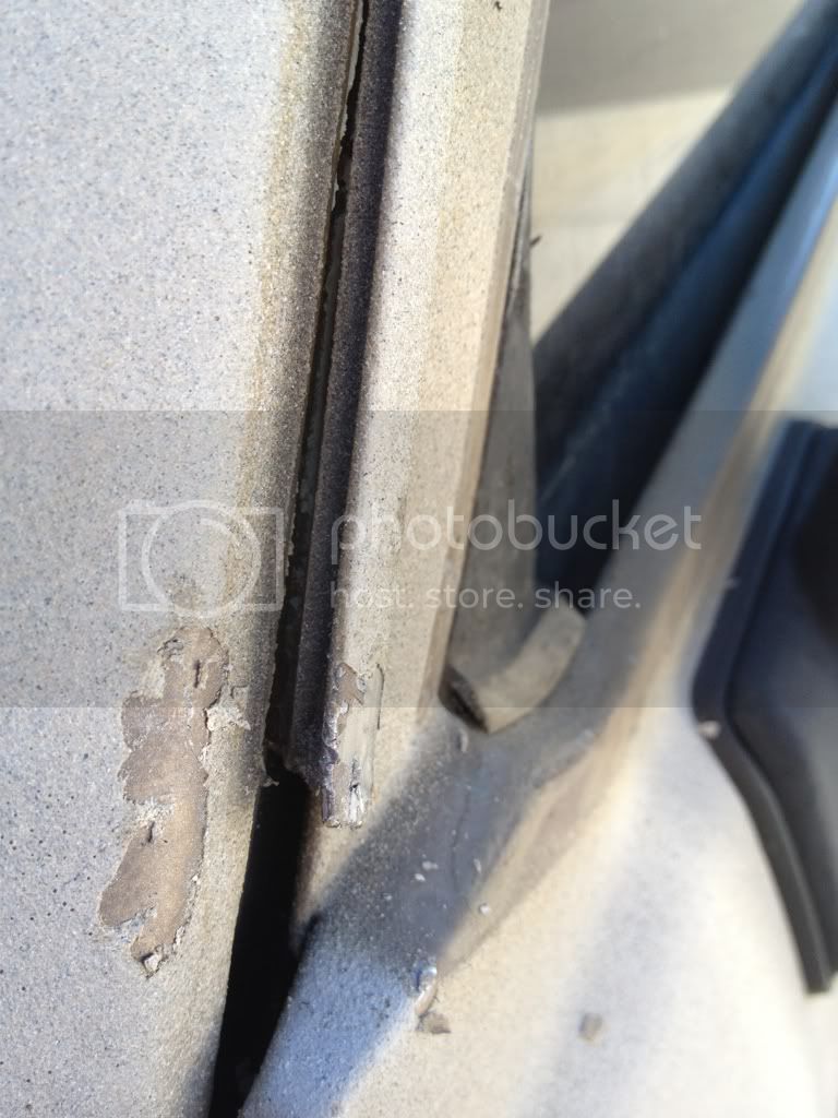

Got it....the issue I have is that the PO spray painted the WHOLE truck with Rustoleum and didn't mask anything off at all. So ALL the trim is painted....so I am stuck. Rustoleum is just NOT coming off at all....
Gotcha.. How much have you sanded on the window trim? Try and take a piece of 220 or 320 grit and fine sand this. The finer paper will clog up fast especially if the paint is Rustoleum. Maybe if you can get a good enough surface prep you can spray an etch/prime and black out..
Good luck
J
I've heard nasty things about the removal process on that stuff. I thought it was regular roll on or rattle can you were talking about. I've never dealt with the textured but, read on another forum about a guy soda blasting everything to make him happy and get it off before he could refinish his ride...
