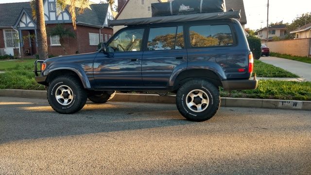

Last Fall I installed an OME 2.5” lift on my ’95 (heavy springs: OME 2850 Front, 2860 Rear). A local specialty suspension shop installed the OME caster correction bushings. After installation, the caster is still slightly negative (Front R -0.3, Front L -0.2).
I plan to install an ARB front bumper, and at Christo Slee’s recommendation I am not going to further mess with caster correction until this is completed (Joey made the same point earlier in this thread).
As the truck sits right now, measurement from the center of both the front and rear hubs to the base of the flares is 23”. Minus 21.5 is 1.5”. What does measurement this tell me? Many thanks again, Ted

As the truck sits right now, measurement from the center of both the front and rear hubs to the base of the flares is 23”. Minus 20.5 is 2.5”. What does measurement this tell me? Many thanks again, Ted
What it tells me is that you have around 2.5" of height over stock. Caster changes at @ 1.75* per inch. So based on the formula you would theoretically need 4.35* of correction to get the caster back to where the factory had it. OME bushings only provide 2* of correction which is 2.35* short from what that formula calculated.
