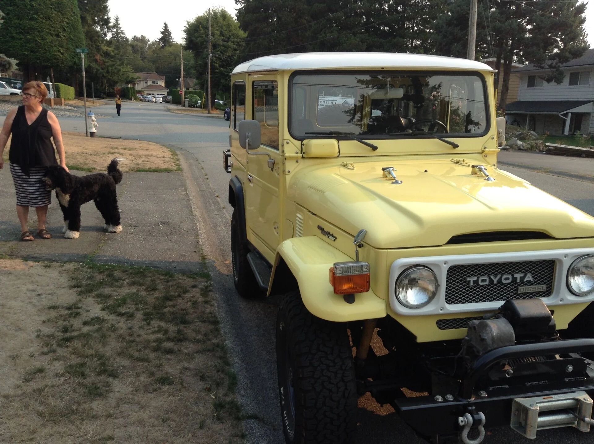

Who has a Warn 8274 Winch on their FJ40?

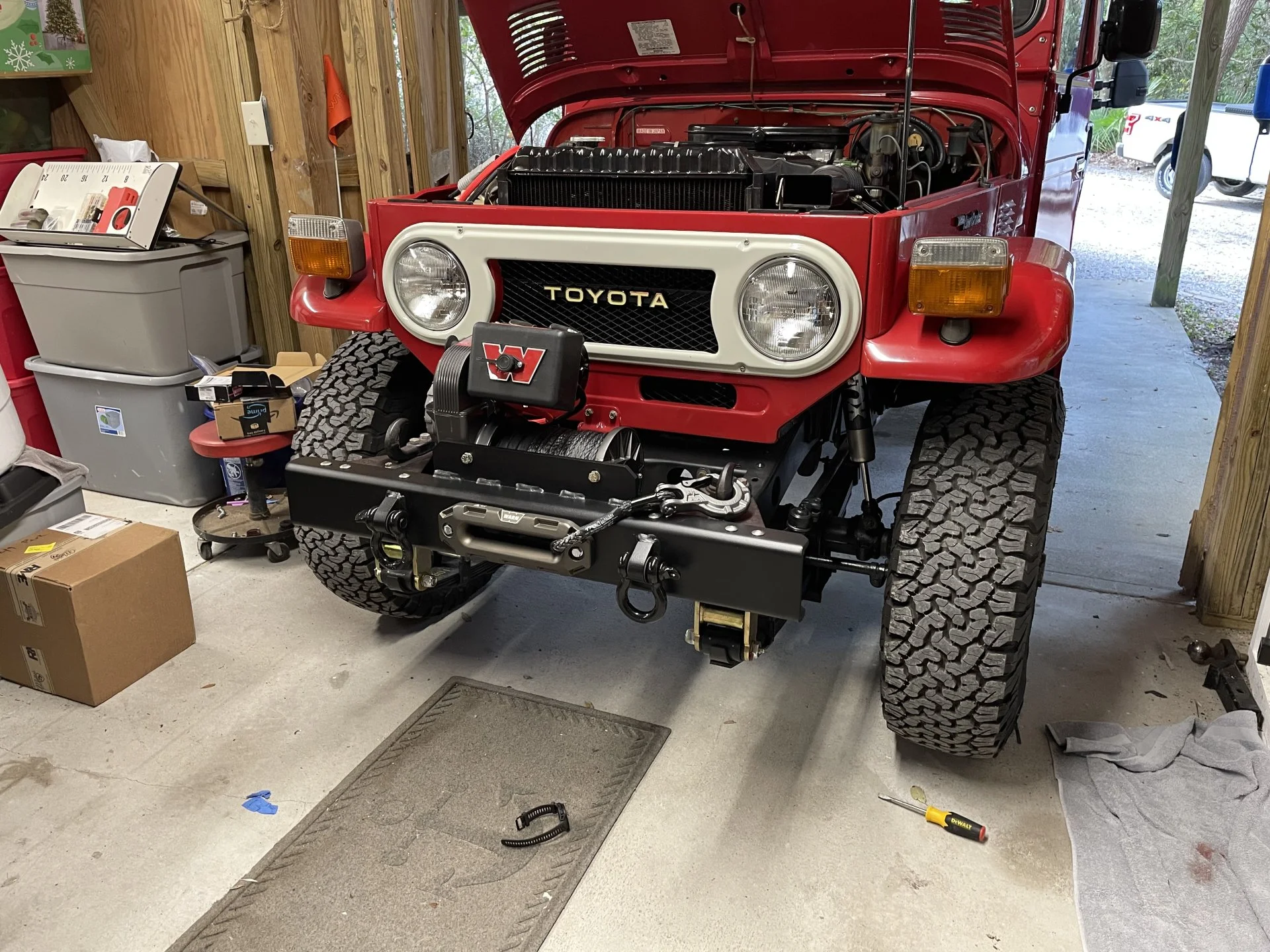

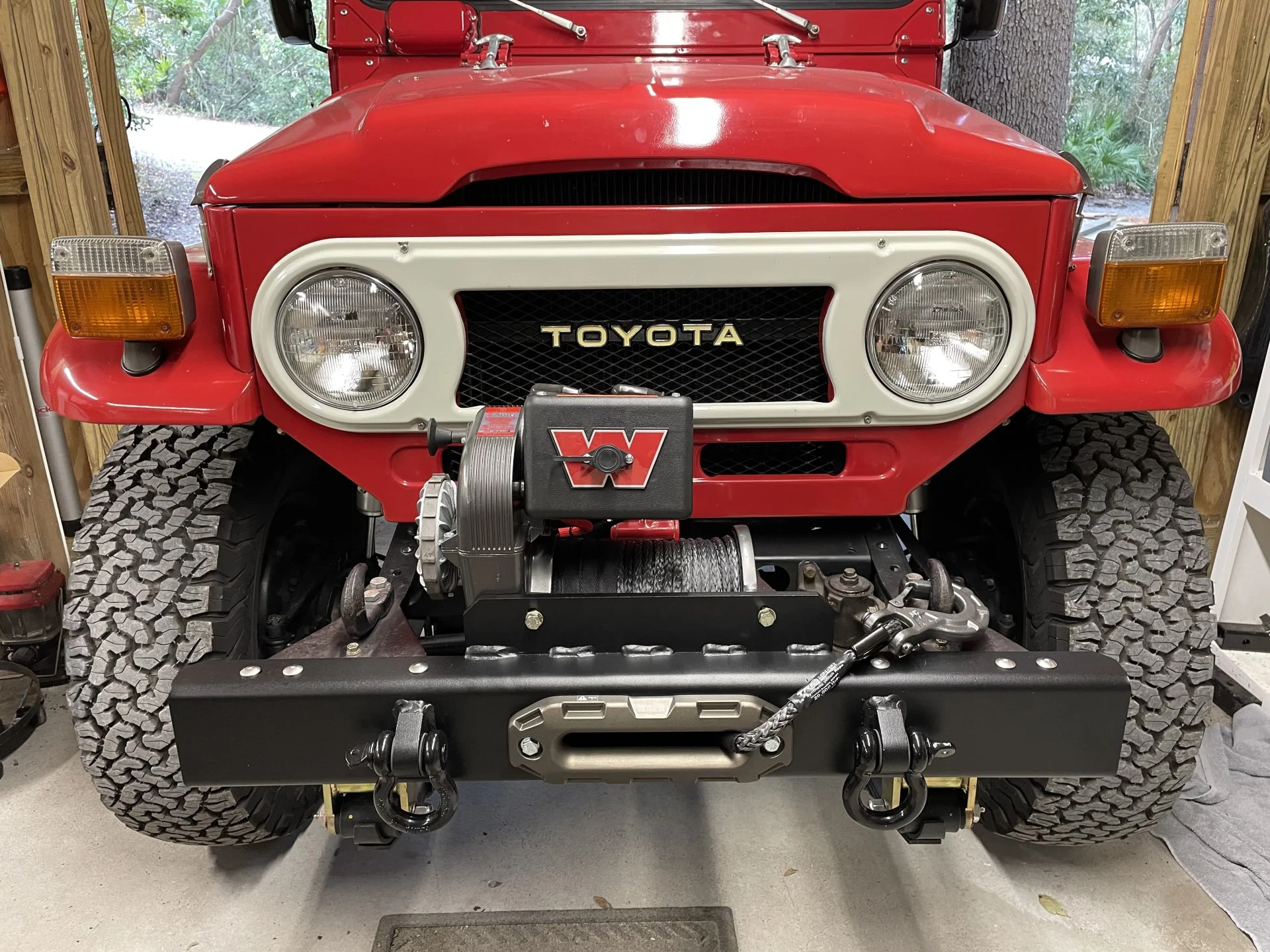

Beautiful work. Sucks cutting into a fresh bumper but the results are worth it!!
Thanks, I had a little help with this one as i’m still learning body and paintwork. The pics make the bumper look better than it was. I wanted to fill the extra holes as well, worst case scenario was more welding.

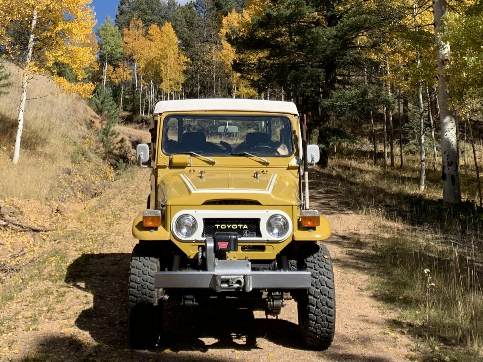

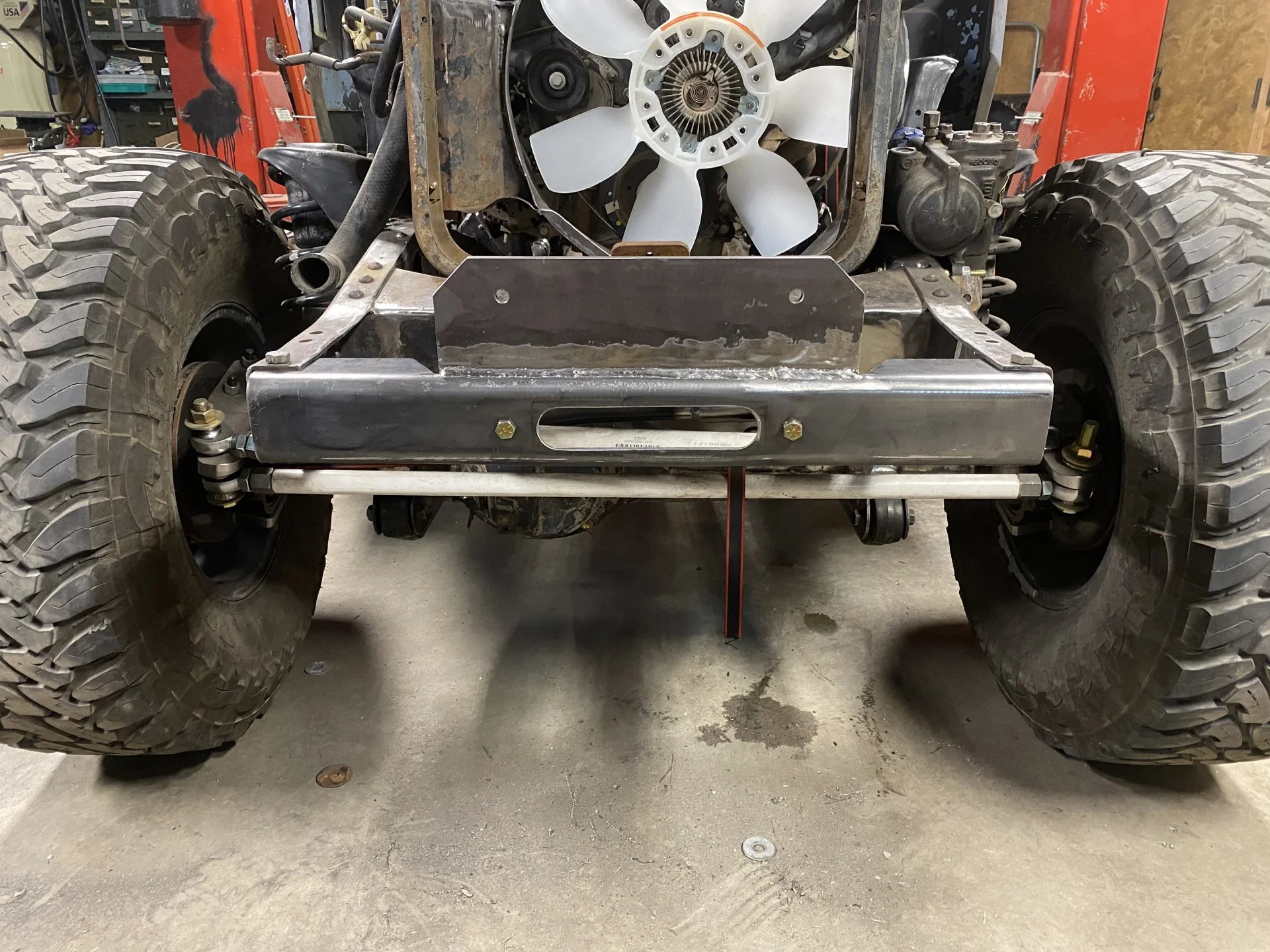

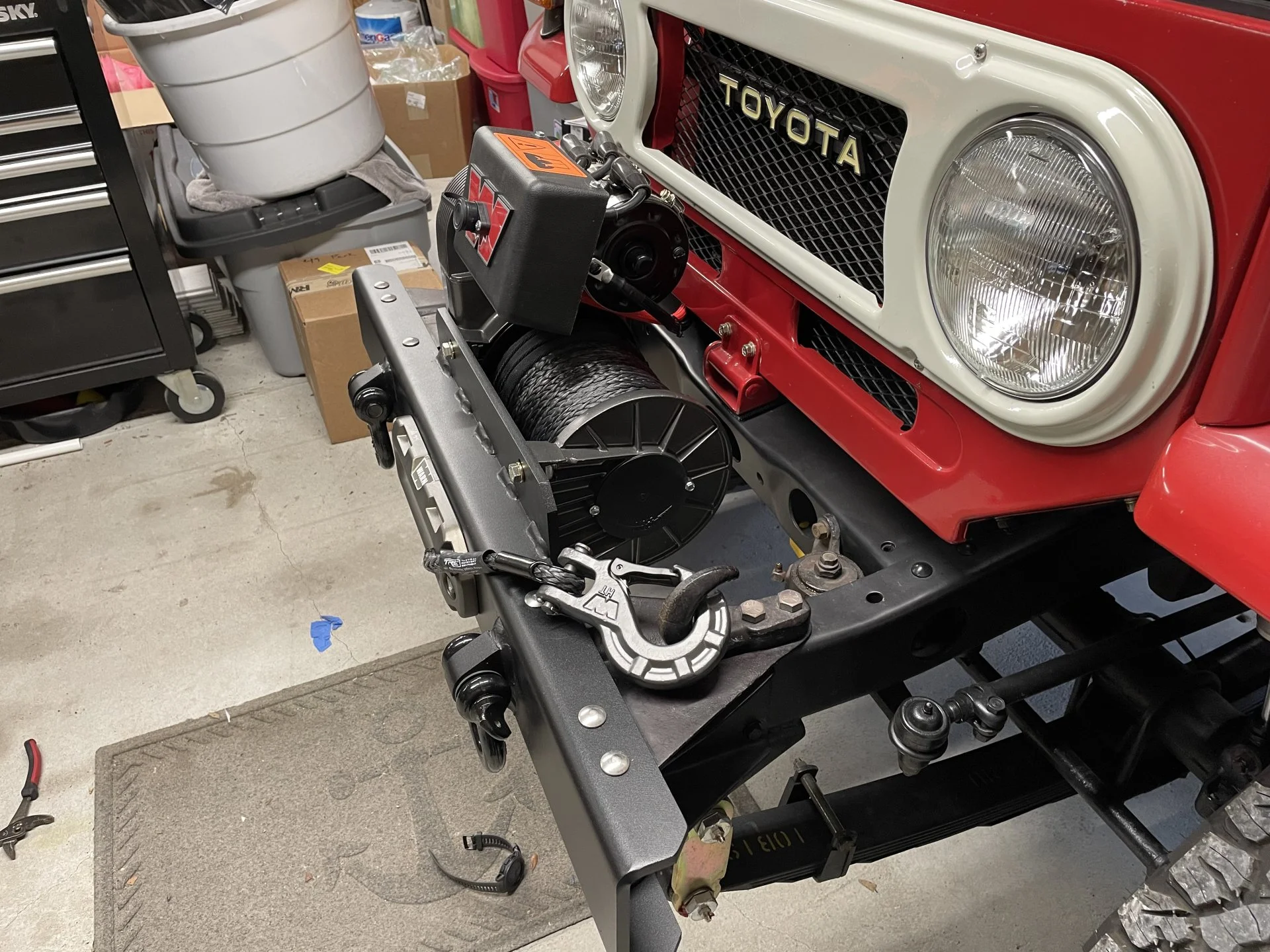

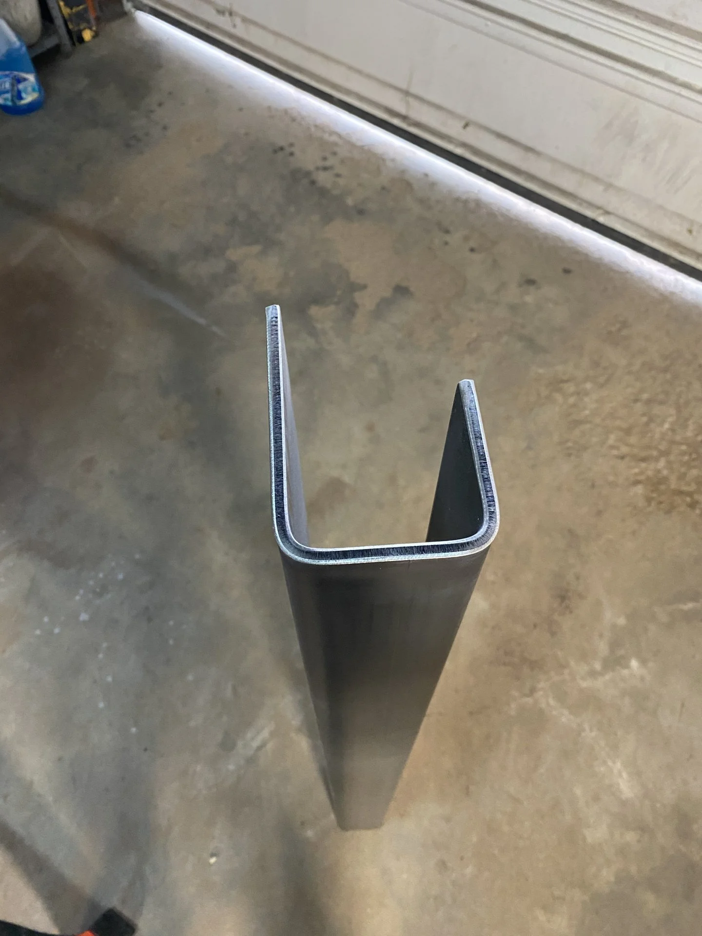

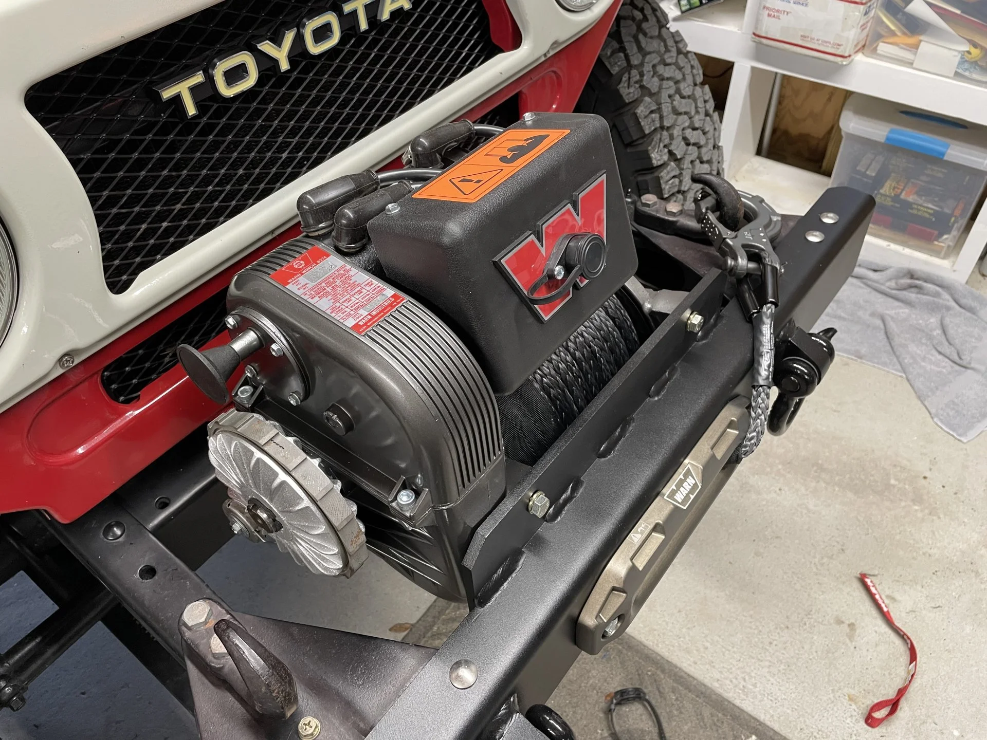

I built my own 8274 mount for my 45 build. I wanted a factory look with a recessed fairlead. I don’t have leaf springs so I had more options for mounting.
I had a custom piece of 1/4 inch steel plate bent to fit in the front frame rails. I then cut and angled the bottom of the channel to allow the 8274 to sit as low as possible. I had the winch mounting plate cut from 3/8 steel then welded it to the front support.
I used an OEM bumper to cut and bend a recess in. There are more Details in my build thread.
