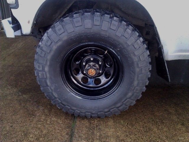

I'm running Pro Comp Series 52, 15x10 3.75 BS. Tires are 37x12.50r15 TrXus M/T's. Fronts have a 3mm spacer to clear the caliper. I've yet to stuff tire, but if anything rubs it'll be minimal on the rear lower bottom corner of the front fenders.
Series 98 Rock Crawlers by Pro Comp
got them at 4 wheel parts, 3.5 bs, 15x8, no spacers, running 33x12.50
PCW98-5883S3.5
98 15x8 6x5.5 3.5BS -25mm

I just ordered series 52 rock crawlers from 4wheelparts. 15x8 with 3.5" backspace. Did lots of research before I bought these because I didn't want to run spacers. They took a few weeks (like 4 i think) but They clear perfectly, I think you could slide a piece of paper in there between the wheel and caliper. Im running 33x12.50 Toyo Open Country M/Ts

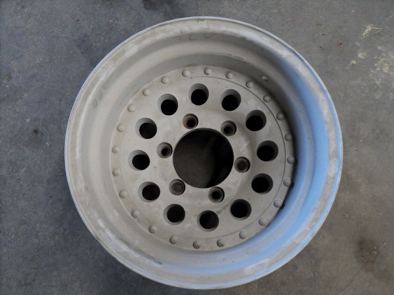

I have a set of 4 aluminum wheels 15 x 8.5 that came with an old Toyota pickup that I parted out that fit perfectly on my FJ62 but I have no idea who made them. The only markings are cast into the aluminum on the back side of the wheel, I will post pics, maybe somebody can tell me what the markings mean. They are also marked as having a 1900 LB load rating. Not sure if this is good enough for an FJ62 battle cruiser?
this is what the wheels look like, I can't get the other pics to upload here, but the only bit of info cast into the wheel onthe back side other than size and DOT are M.I.T. M162.
