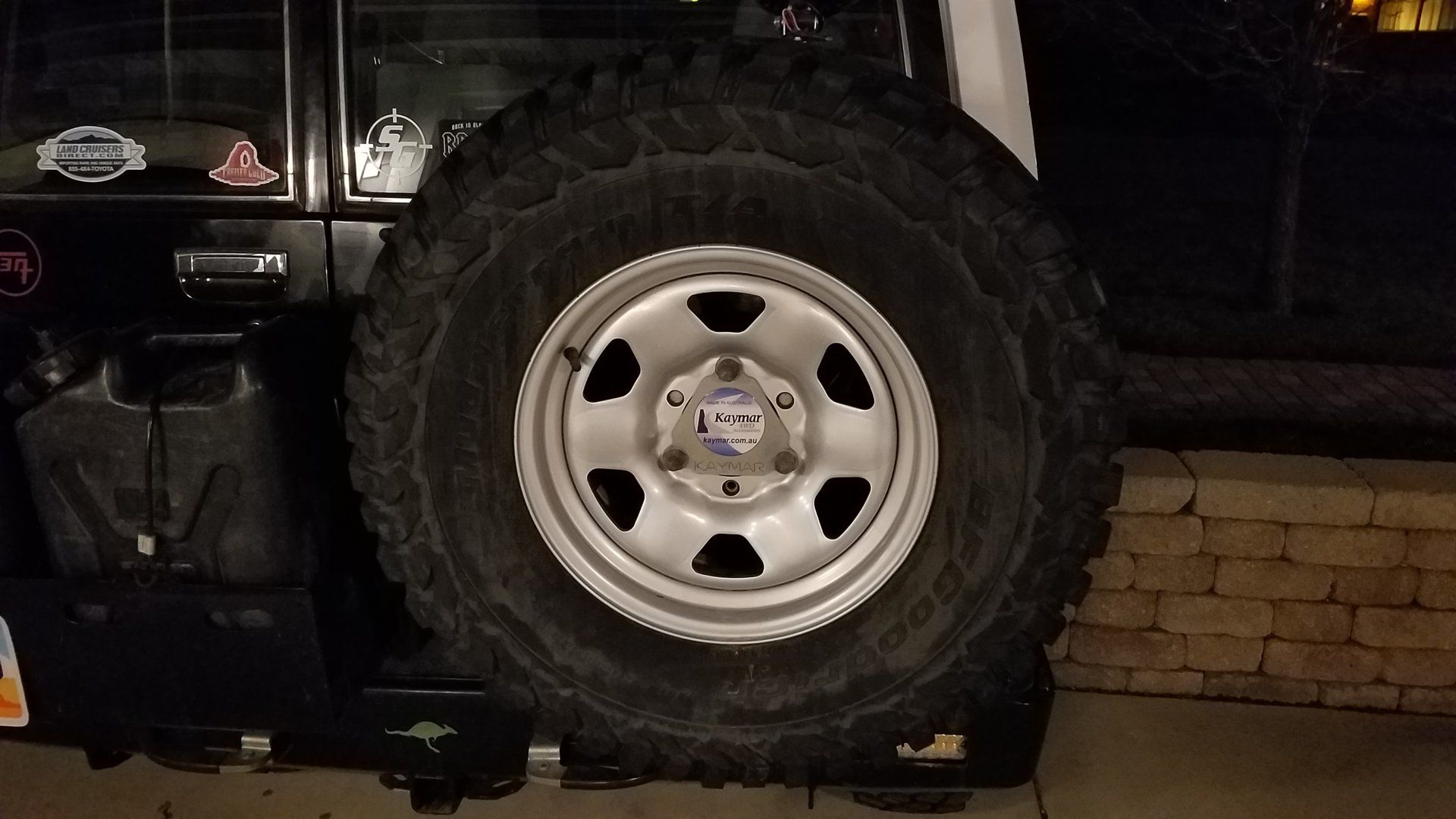

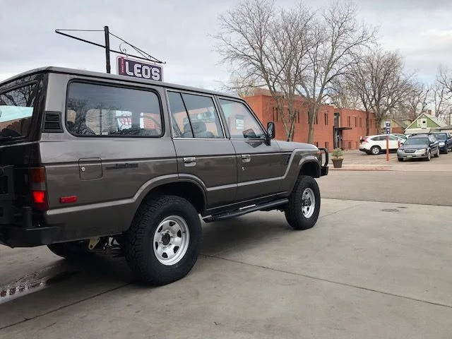

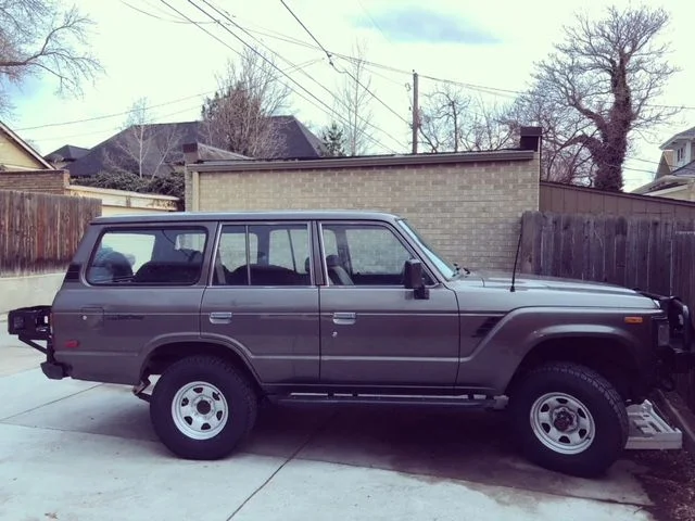

I'm leaning towards getting a set of the 70 series 16x7 wheels as I want something to bolt on without rubbing, but I can't figure out which tire size I can mount on them. I'm currently running 33x10.5" and would like to move to something more common, even if it means losing a little bit of diameter.
Anyone running a 265/75 on a 16x7 rim? Any issues?
Edit: More specifically, I'm interested in either Cooper AT/3 or General AT2 on the 70s series rims.
Yup on running them. Nope on problems :D
