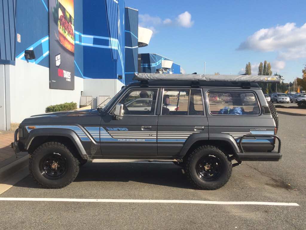

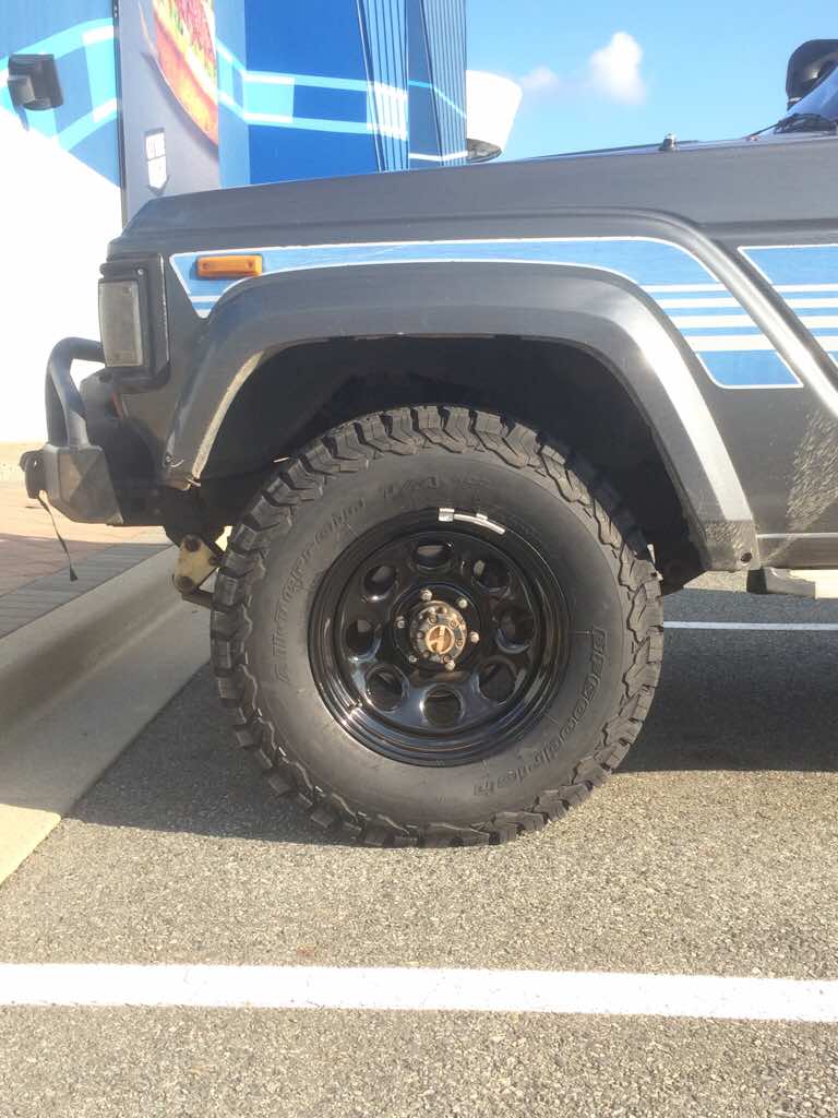

I also went with 285x75 R16 in BFG KO2s.
My FJ62 runs on the stock suspension and didn't anticipate any rubbing issues with these and there are none.
But I had a problem with the front rims rubbing on the tie rod. America's tire installed everything but as they were rolling it out of the bay they noticed the screeching sound and stopped. We took off the wheels and noticed where it was rubbing. No other wheel they have looks good (too blingy) so I decided I was going to grind a bit on the tie rod. After a bit of grinding the wheels fit. I hated doing that but it didn't need much.
Just wanted to make note that these wheels didn't go on without a bit of modification. They cleared the caliper fine.

As far as I can tell that link is the same one that Theron used and the same backspacing. He runs a 60 but that shouldn't matter. There could be some type of alignment issue that had my tie rods pushed out further than his? My alignment is good right now so I'm not sure what else it could have been or how else I could have made them fit.

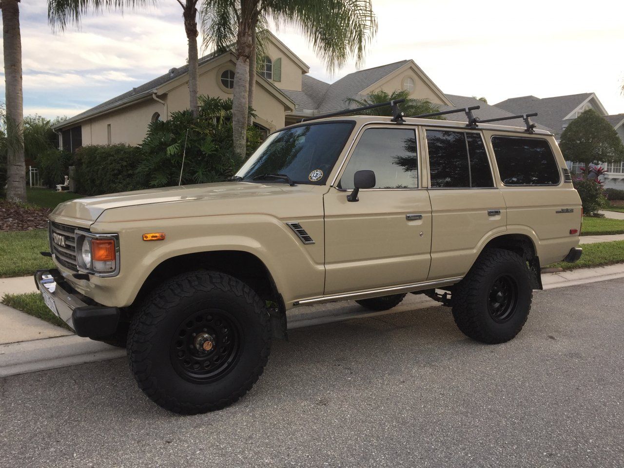

34x10.5/17 ko2's with 8" wide steelies - 4" backspacing
View attachment 1158236View attachment 1158237
I'm looking through the thread again and I did not notice where you mentioned the brand of wheel or the specific model or part number of the wheel in in teh pics...mind sharing the details. I presume the wheels work both front and back with no rubbing or interference with the caliper or steering linkage..etc?

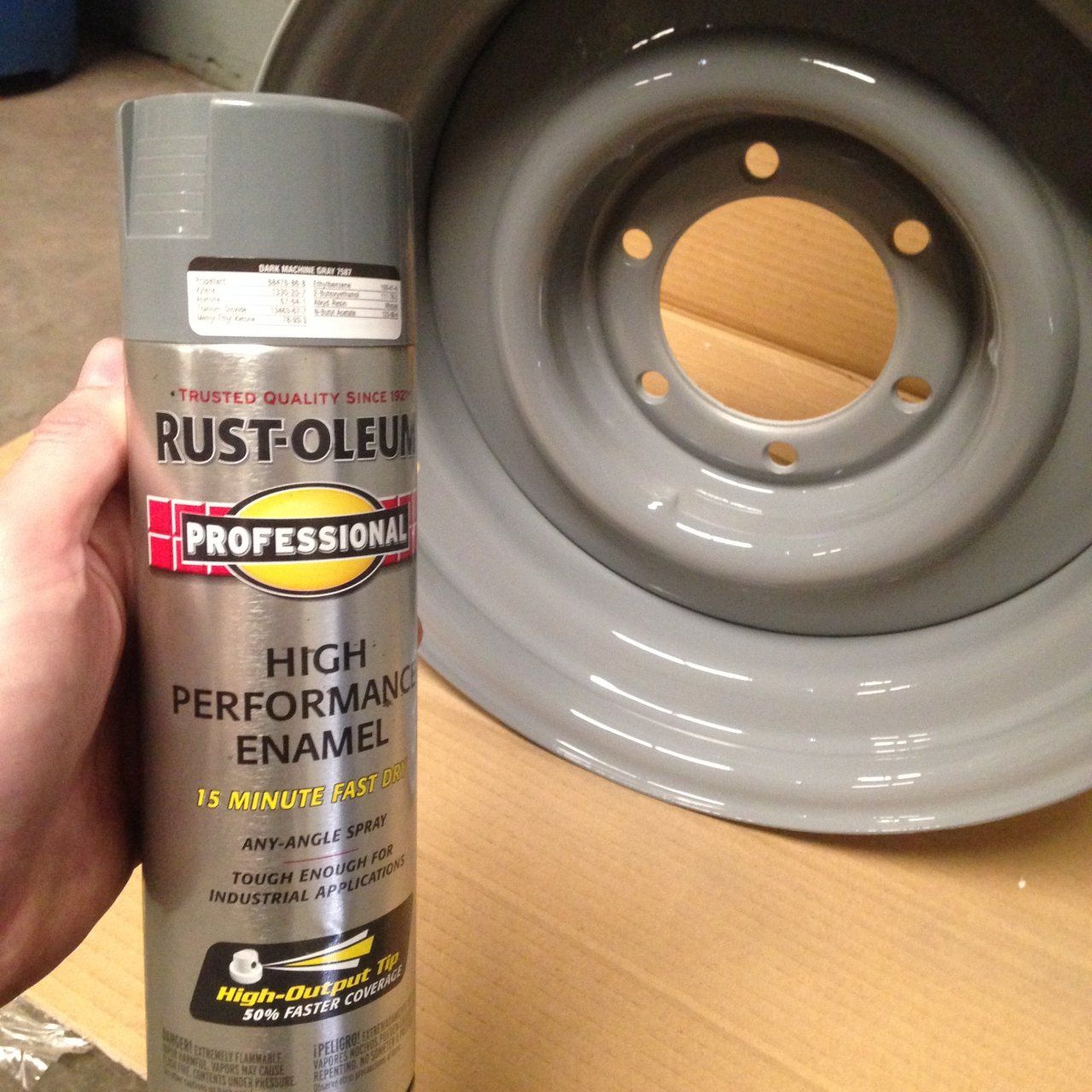

They come in gray primer, but I painted them with this.....
"Dark Machine Gray". Not perfect, but close.
I like those....remind me of the plane jane stock GM wheels of years ago... I need some in 17inch... gray looks good
