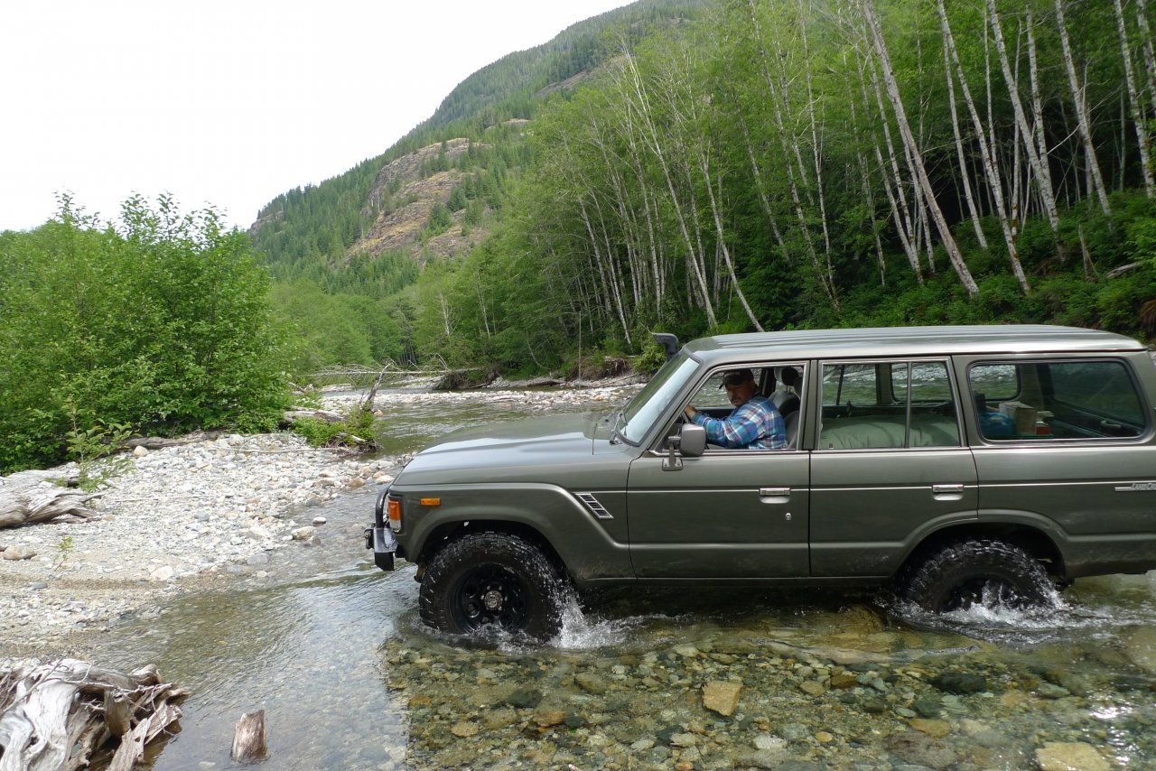

62 on 18's, 305/60 nitto grapplers.
Yes there are spacers and also noted a significant loss of turning radius compared to my 60. Suspension appeared to be stock with a leaf or 2 added in rear. I say bleh.

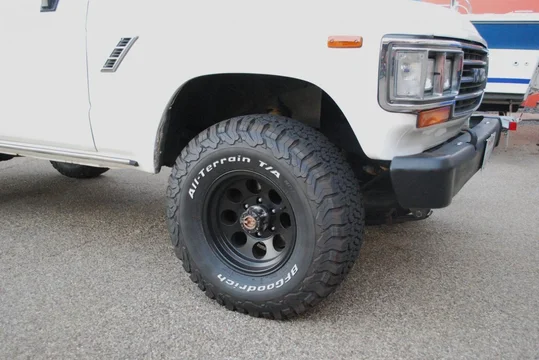

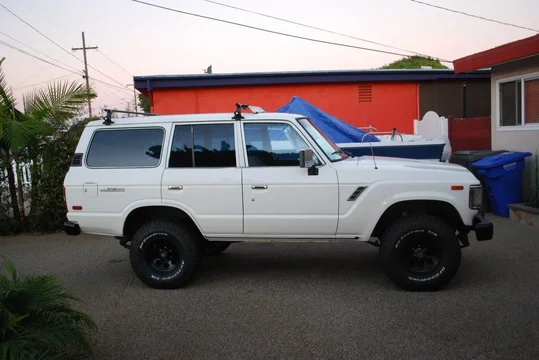

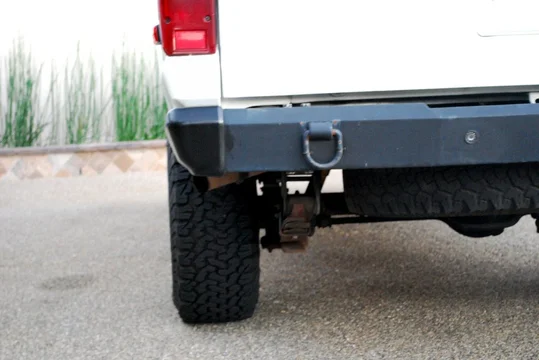

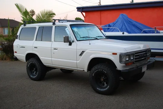

Wheels that work. No spacers. Tracker Level 8 - 15x8 -30 offset, from Discount Tire. Plenty of TR and caliper clearance, seem well made, and sit really well under the truck with OME lift. Tire 32x11.5x15 BFG AT (new model). Very happy with the ride. Sorry for blinding you with the neighbors house, the sun was this direction..
Thanks! Very pleased with them as well. I had planned on keeping the stock chromies, but since Discount wouldn't mount a 10.5 on them any longer, I ended up needing the wheels if I wanted anything over a 30" tire. Not bad price-wise, $105 a piece, but the dude at Discount gave me a good deal on them for the previous two attempts at steel wheels that didn't fit (according to their 'fitment list' they should have). Overall, very happy with them.
Txnight, they are 6/5.5 with a -30 offset. I think they were the only model in a 6/5.5 pattern, as I don't recall any debating about offset with those..
