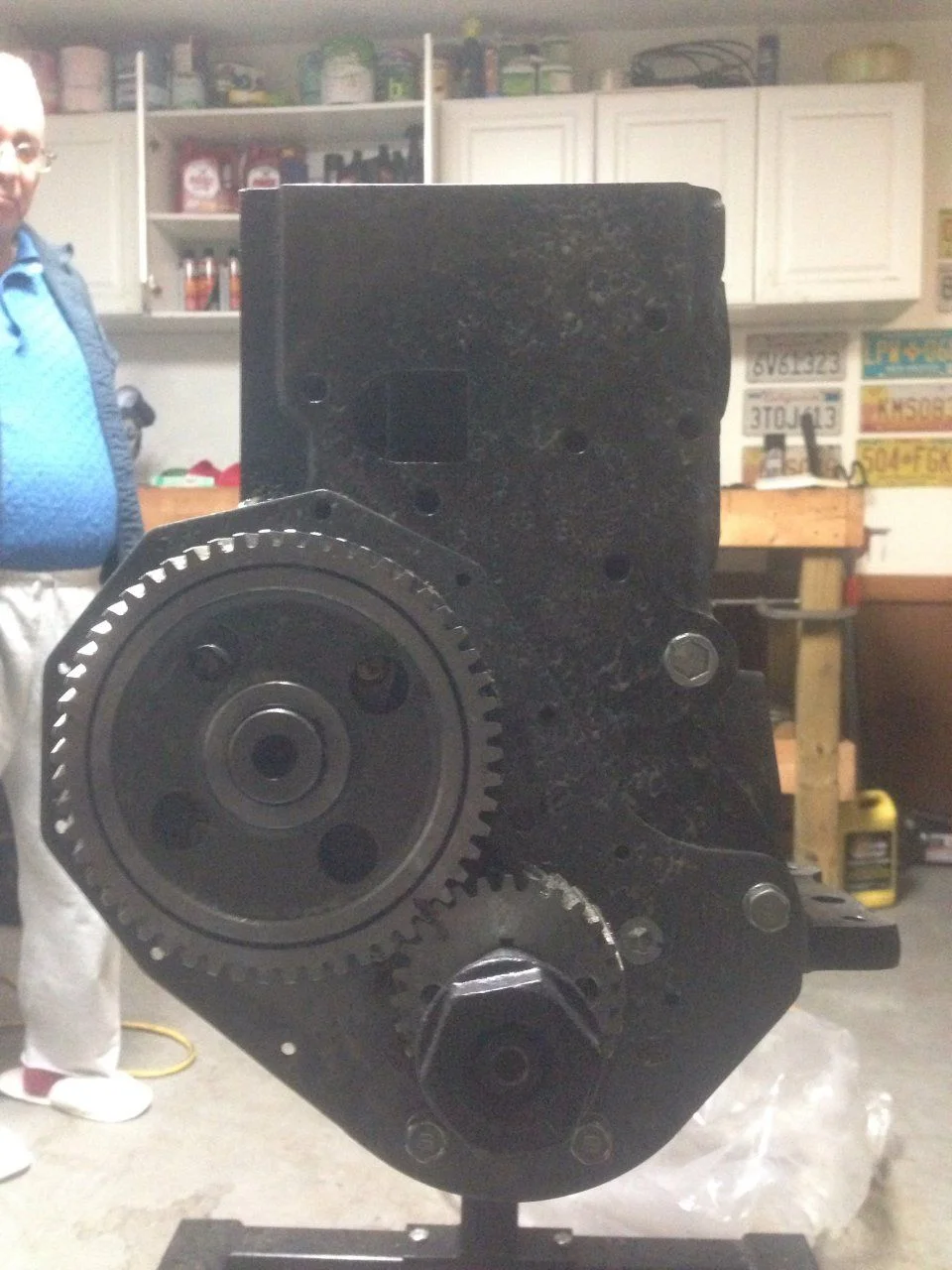

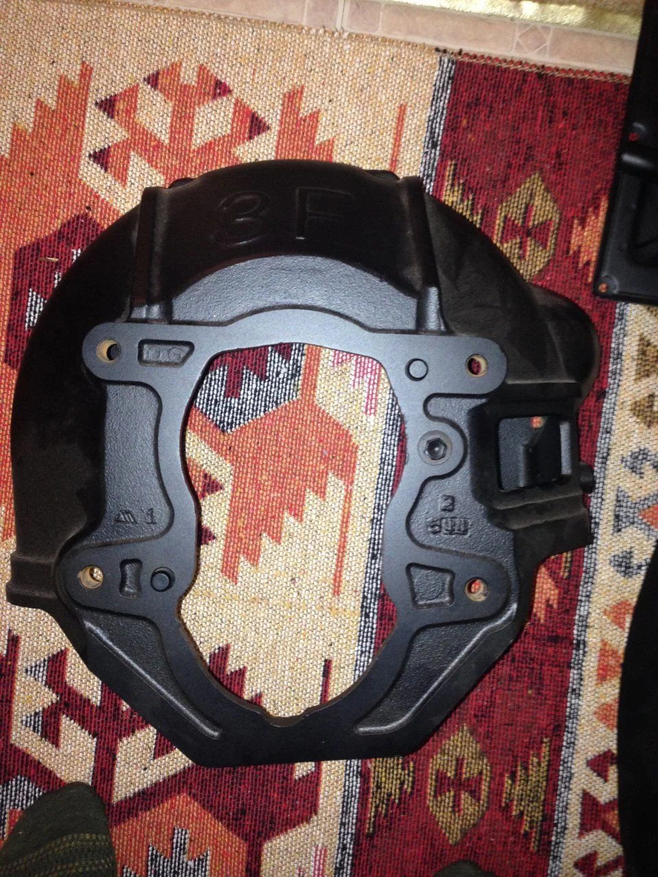

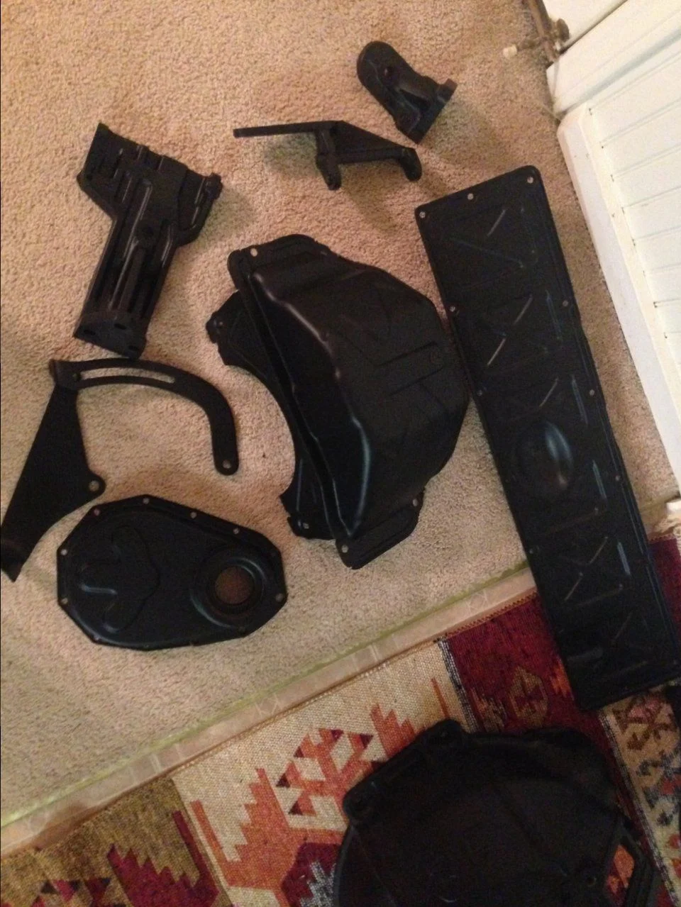

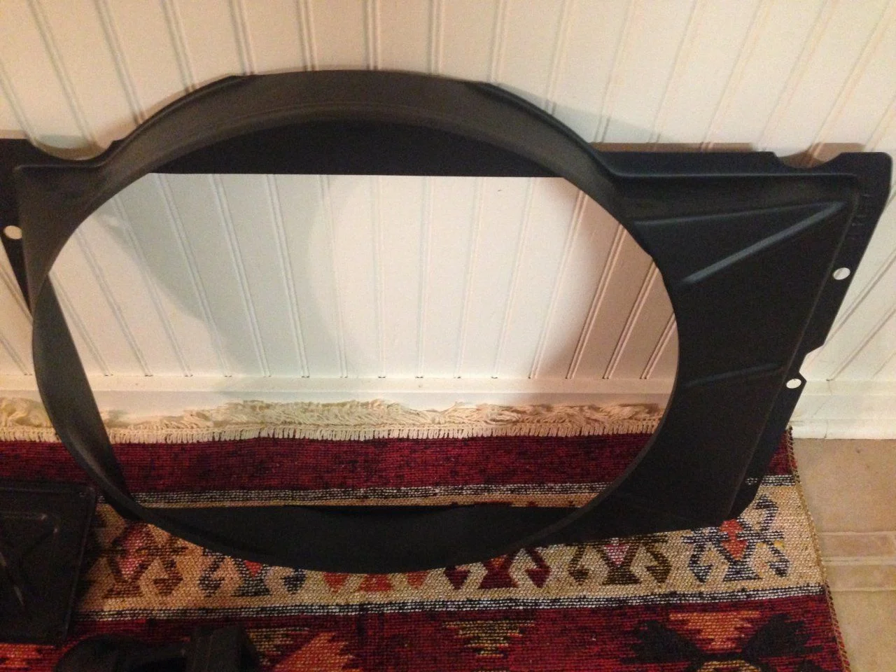

Got some parts back from powdercoating. Looking clean. I have a few more bits to have powdercoated while waiting for the block to be completed at the machine shop. Hope to have everything back for assy and reinstall at the end of October.
Thanks to Smoking Gun Powder Coating in ATL as always. Top notch work as usual! Highly recommended.
:cheers:
^^Got some parts back from powdercoating...
So Beno, I see that the timing gear cover got powder coated. I chickened out PCing mine & ended up painting it with RustSeal... cuz I was nervous that the solder holding the seal retainer in the cover would melt in the PC oven... So it turned out well for you? Please take a look at it's orientation in the cover and let all of us know that it turned out just fine.... pretty please? I would have much preferred to have PC it.
Thanks!

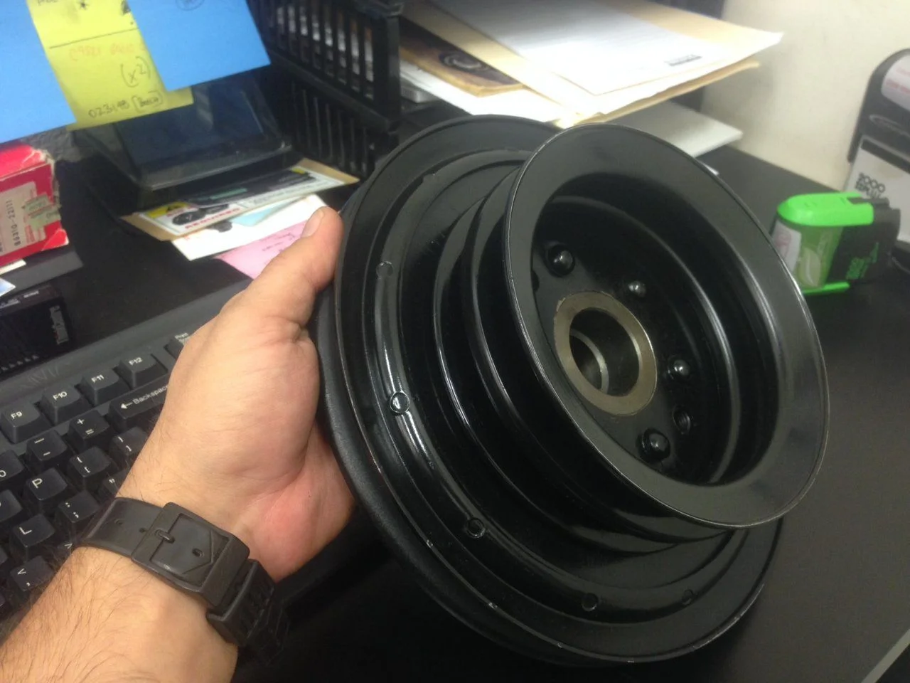

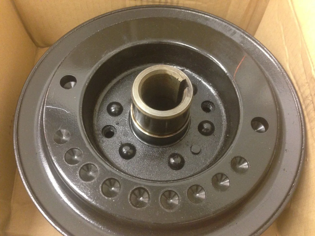

Oh and I decided while I was doing this correctly to install a new crankshaft pulley as well. No use in not going all the way at this point.
The world's most expensive 2F ever.......:)

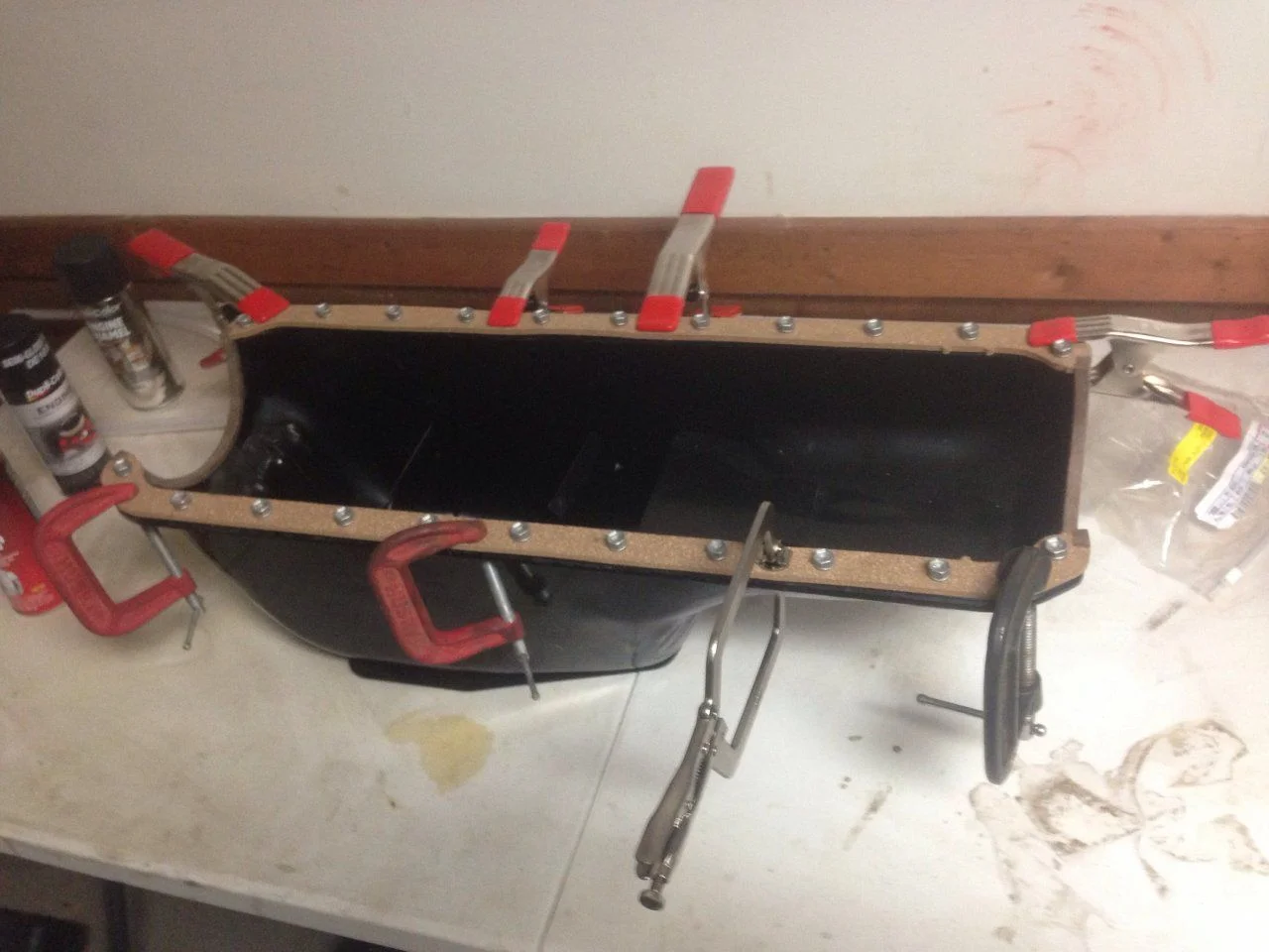

Forgot FIPG at work so I set the oil pan gasket on the new pan overnight.

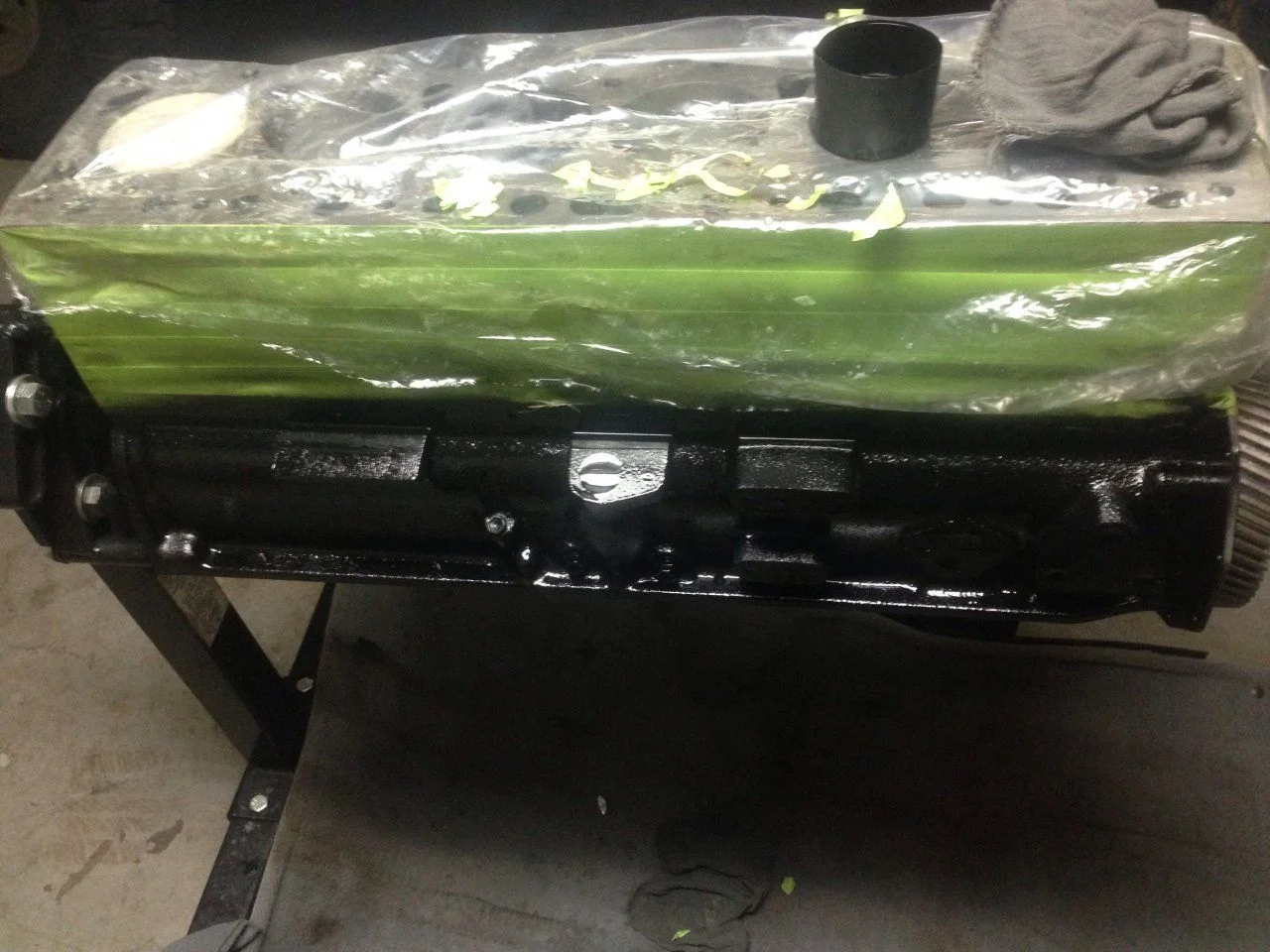

Then cleaned the PS block, taped if off and threw my first coat of paint on it.

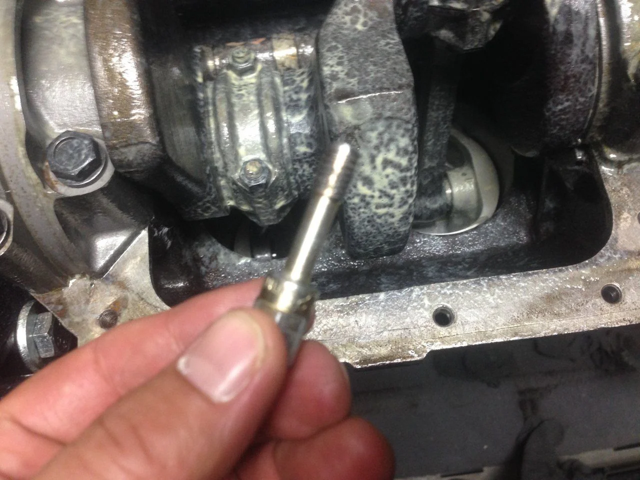

I cleaned up the bolt holes for the oil pan as well with my Cornwell rethread Kit. M8x1.25

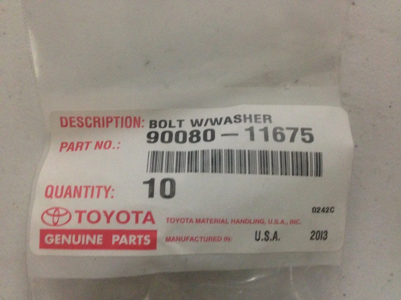

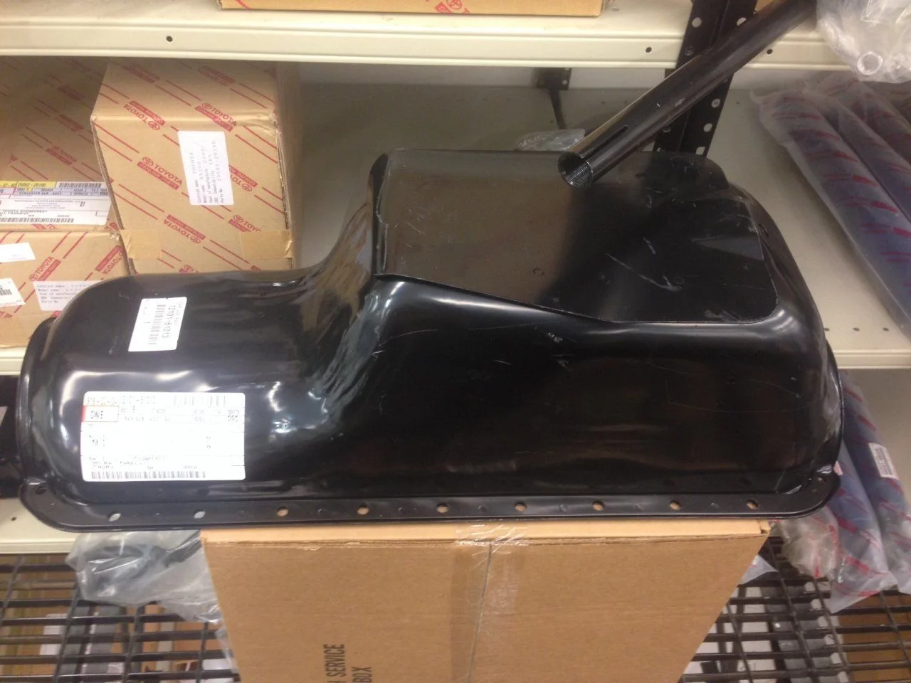

Part number for the oil pan bolts with captive washers. Made in USA. :( One of the few things on this engine that will be US sourced Toyota parts.

Careful with the metal shavings created by tapping those holes.
