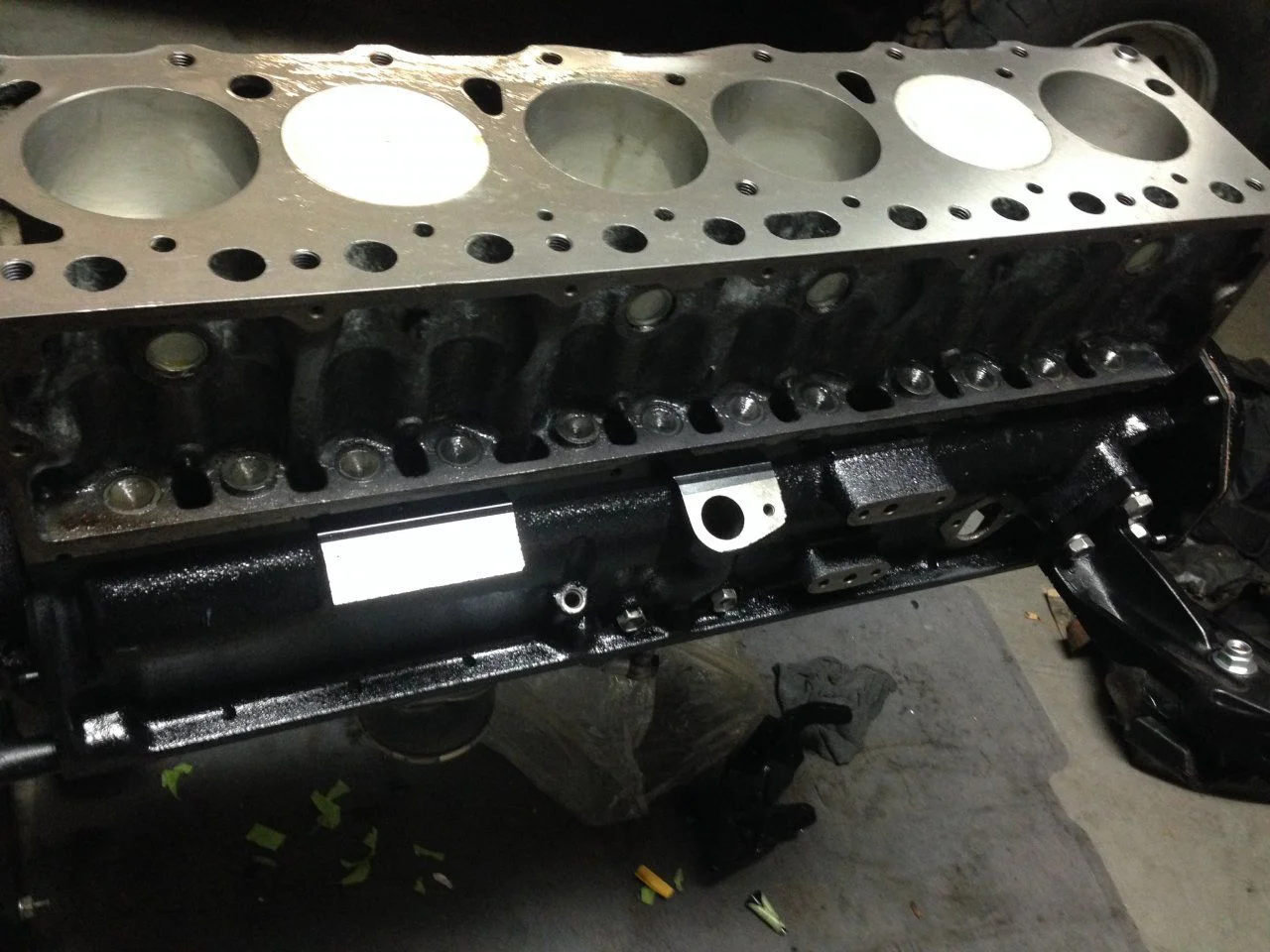

I have 2 HG's im able to use. The correct one (11115-61030) doesn't seem to have te correct cut outs for the water jacket holes in the block.
The incorrect one has three out of the 4 water jacket cutouts correct but like the later one closes off the one toward the front of the block on the DS.
Perplexed by this since it just does not make sense to make a HG and close off a water jacket hole.
This last bit is where the ass-u-me-ing will get you. What you call a water jacket hole, a casting engineer calls a core cleanout hole. The fact that the core cleanout holes can be used to access the coolant system is a happy coincidence.
Rule of thumb: on any engine where there are HG choices, the HG should match the head. Since the head on this engine is 85-newer, it should use the 85-newer HG.

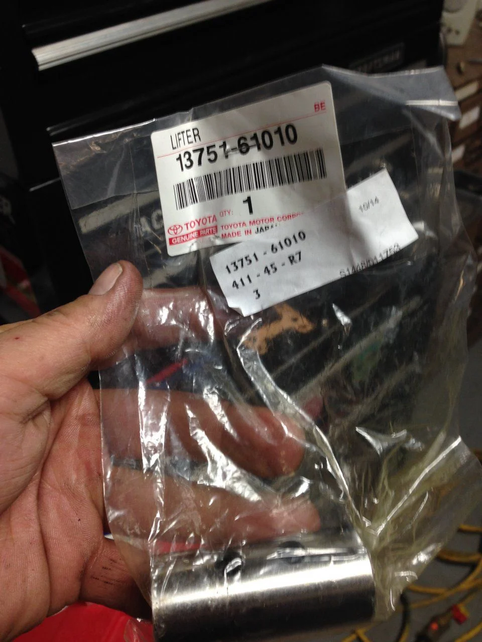

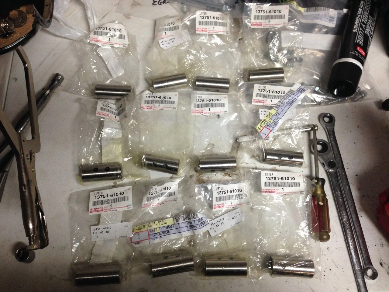

Got my new lifters in last night. They come nicely lubed in the bag from Toyota. I coated them in some moly-fortified engine building grease that I've been pretty much putting on all of the metal parts as I assemble them. Hoping to get the head on tonight since I don't have to be at work tomorrow morning.
:cheers:
Nicely lubed from the supplier.

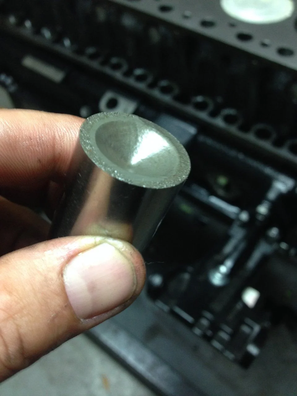

Flat side down into the engine against the camshaft assy.
Indented side where the pushrods ride.
Installed in engine. :)
