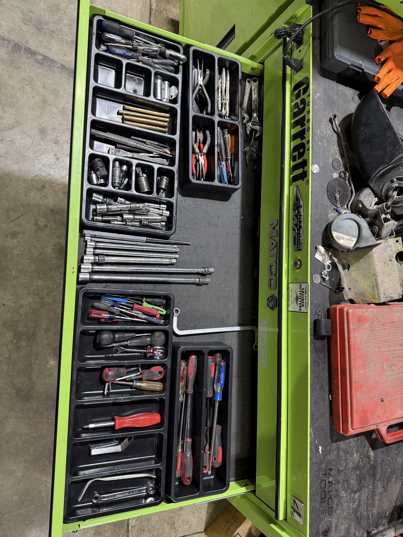

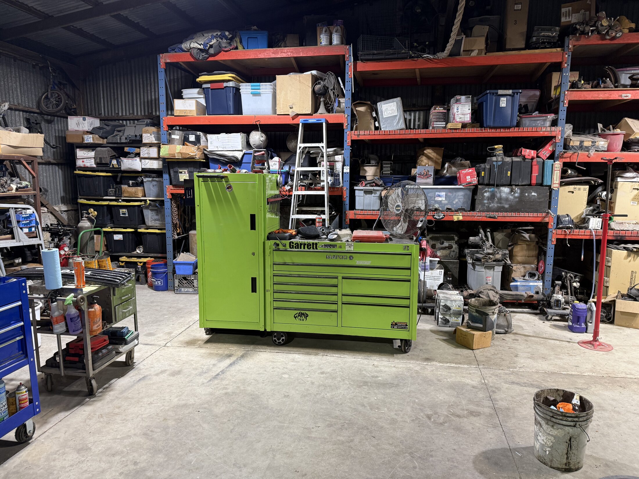

Yes sir. He wanted a few coins at first but then he thought about everything I’ve done for him and he rattled off several things. From there it was a silent acknowledgment that I’d just take this box home without exchanging any denero. I’m slowly getting tools transferred. It’s turning into a reorganization of the barn. The footprint is so large vs the available space this is necessary. That back left corner is what I worked on tonight. Found a lot of things I forgot i had. This is where it sits as of now. Still several drawers plus the cabinet to fill.
