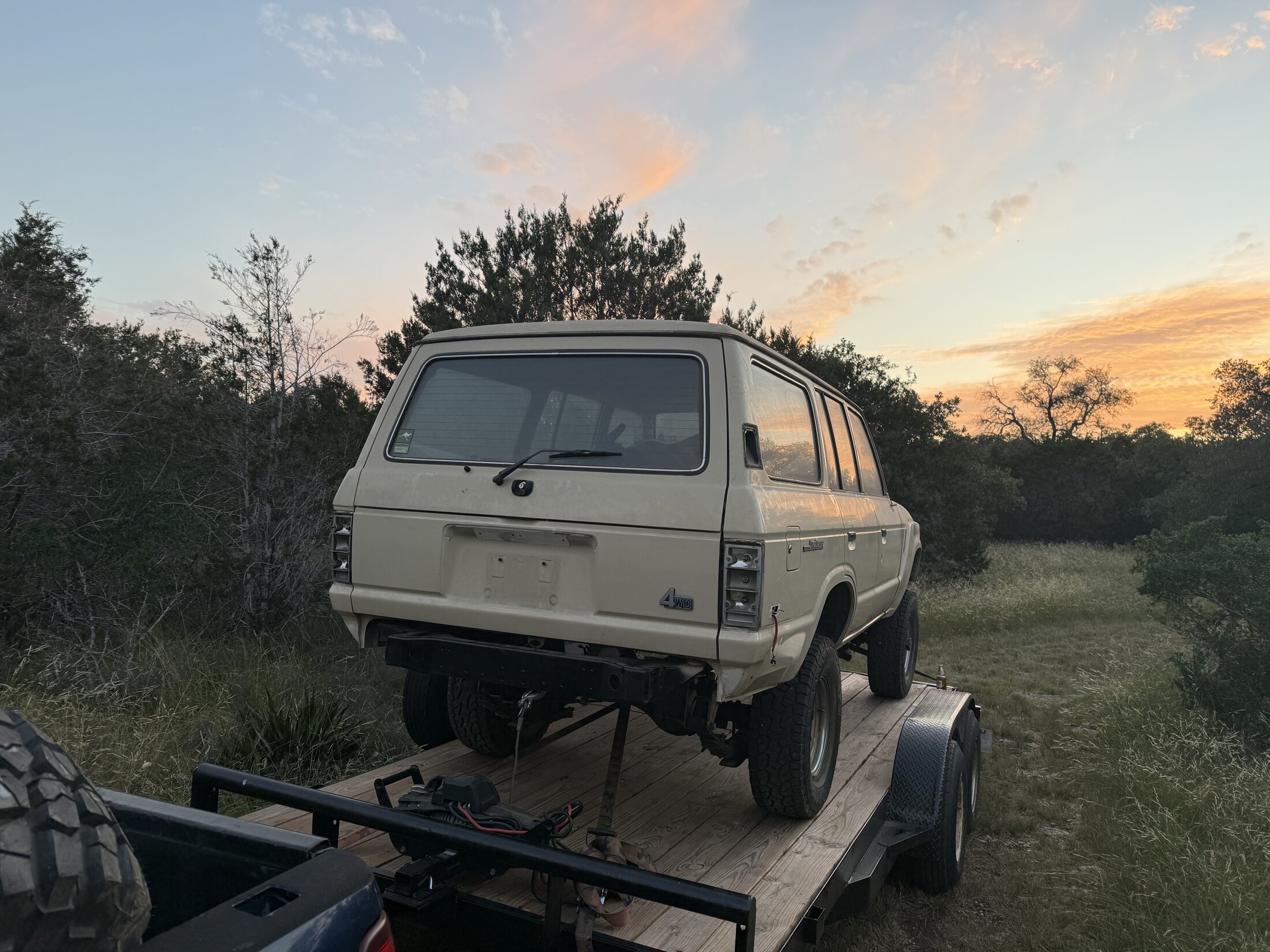

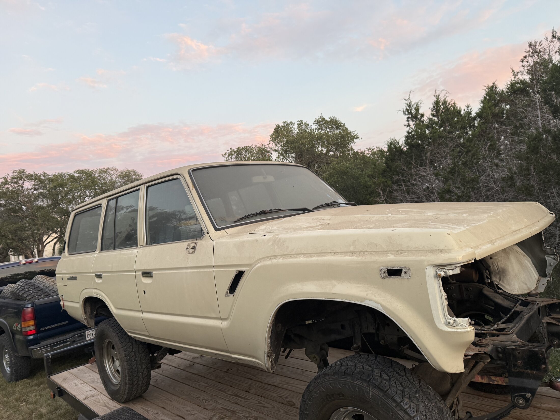

Slow going in the barn with little to zero activity. Fetcher did get recommissioned the other day. Bought this very nice 62 from a very good friends wife. This was originally slated for a LS conversion but they are going in a different direction. They still have a brand new automatic trans, adapter plate, motor and all this bits for sale if you’re looking to do an LS conversion. If so hit up @LETSROLLEM
The motor is set up for fuel injection, has the wiring harness etc. the hard part collecting everything has been done.
This is a beautiful tub and the plans are to swap it into my euro 61 since the bodies are identical as well as the original color (white). My 61 is complete but the body is rusted beyond what anyone below the sunbelt would generally tackle.

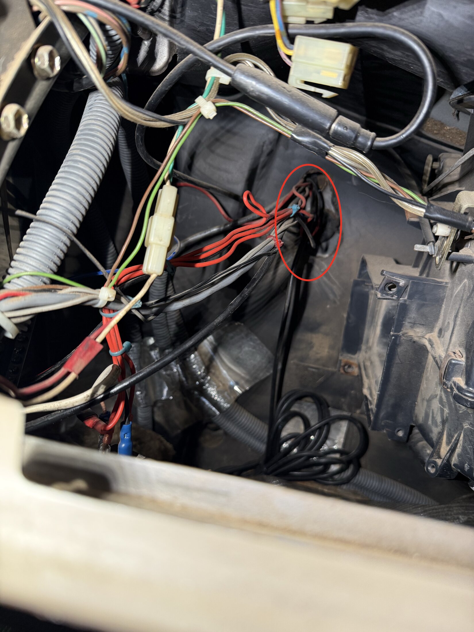

Then I decide to test fit the evap core plenum. Seems to fit but then I see the rats nest of wiring several previous owners did. And their passing right through the two holes I need for the air conditioning lines. A few hours later and a lot of soldering/shrink wrap the holes are clear

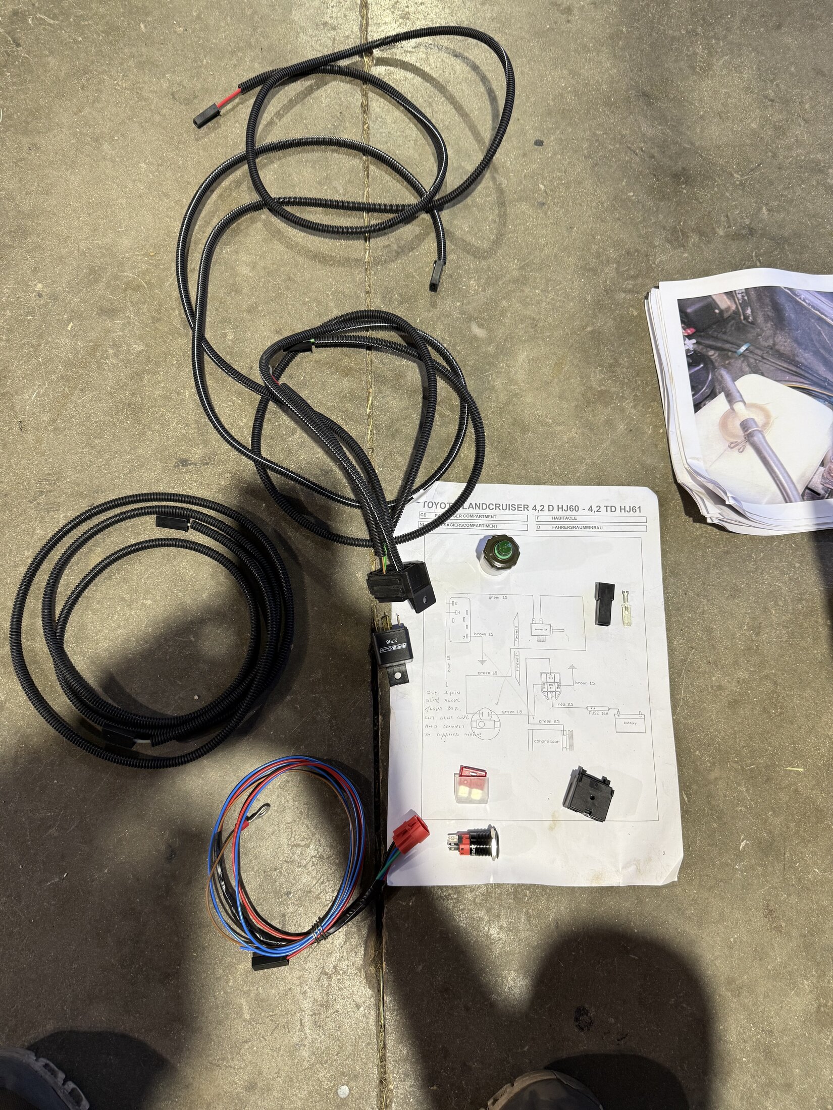

Now back to the manufactures shi**y directions. I get a bag of wires, clips and relays and a “one pager” wire diagram. Very little makes sense other than where the firewall, battery, relay and compressor are. The kit includes an ac activation button and harness, but they send a separate factory style ac button (blue light) that clips directly into the factory harness. Problem is I can’t find the male clip on the 61 harness due to the massive amount of aftermarket wires behind the center bezel.
My customer sourced this kit from Maarten at Cruiser World. I’ve communicated with him over the years and he’s a great guy/resource for parts. His answer to me on email was “the company that makes this has done a ton of installs.” Said he would reach out and ask them about the condenser etc. I just shot him an email asking to put me in touch with someone and take him out of the middle. I need something more than 12 pics of the completed install. Some documented steps, hints, tips would be awesome. So the point is this job is a black hole :).
