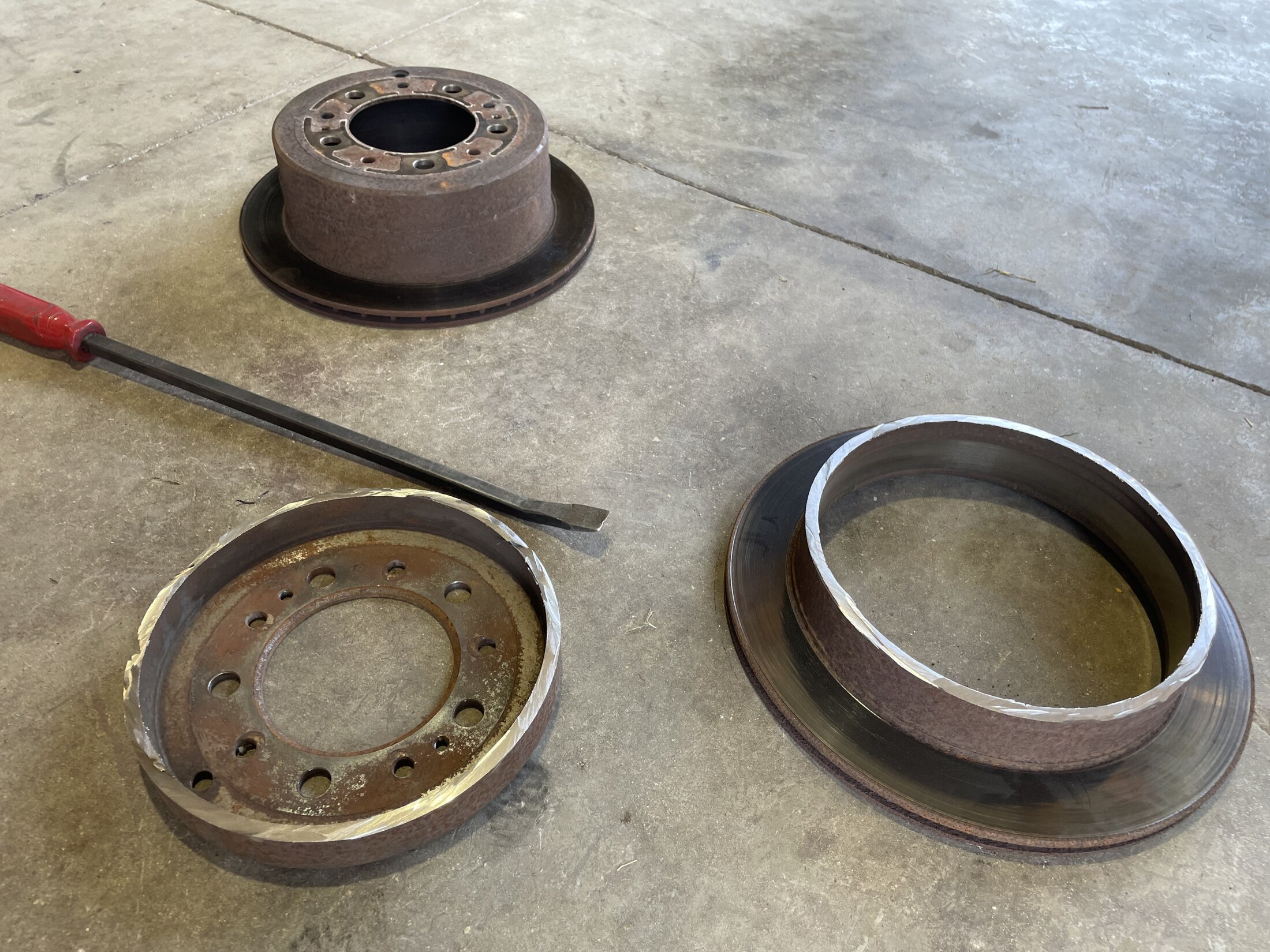

This is an interesting one. I don’t work on 100 series too often. I local guy I met at the Spring Branch cafe a year or so ago called me out of the blue last week. Said he was getting some noise out of the back end. Drivers inside pad was metal on metal. So had him order two new rotors and pads. Pulled the drivers side rather easily and the passenger side started dropping parking brake springs, washers etc when I got the drum about half way off. Nothing would pull it beyond the tip of the wheel studs. First mistake was to keep trying. Finally decided to cut it off which worked out beautifully. I was able backoff the star thing-a-ma-gingey. Everything went back beautifully This guy is one of the coolest dudes I’ve met recently. 50 years as a furniture maker. Has his own mill shop down on Rebecca creek on the north side of the lake. Would not let him pay and he promised he would surprise me with something that has his thumb print on it. Saw his workspace and I can only say I’ve never seen anything quite like it. He’s definitely an artist.
