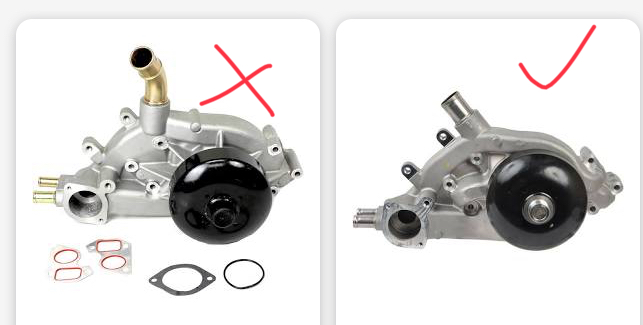

2007 truck/suv water pump on the right

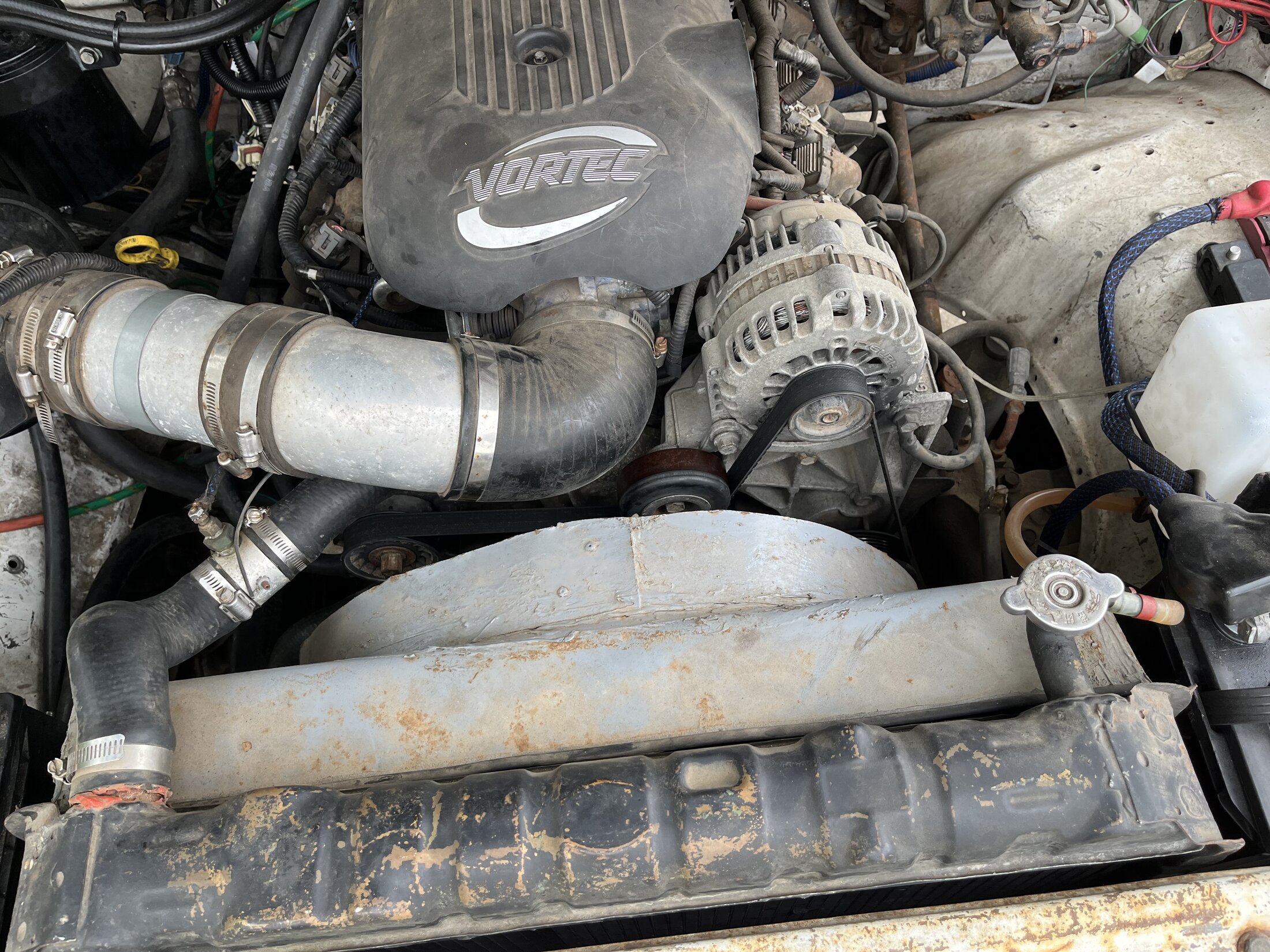

Jimmy, here’s a picture of the setup I’ve been running on my 60 for the last 8 years. I used SOCO muffler/radiator here in Austin. I called the guy who did the work and he said it would cost <$200 to do this
Finally figured out the cooling issue on the LS62. Probably ran the truck to operating temps (and a bit beyond) 15-20x’s, released the steam and could never get her under control. The PO is a buddy and he recommended using compressed air to force the air pocket out via the steam line. Worked like a charm. Solid fluid for a bit then a lot of air. Topped off the radiator and then took it for about a 25 mile trek. Seamless. Just really glad to be done with this part of the project. Love the power of the LS but can say I’ll probably never venture down this road for myself. Way too many mods to keep track of :).

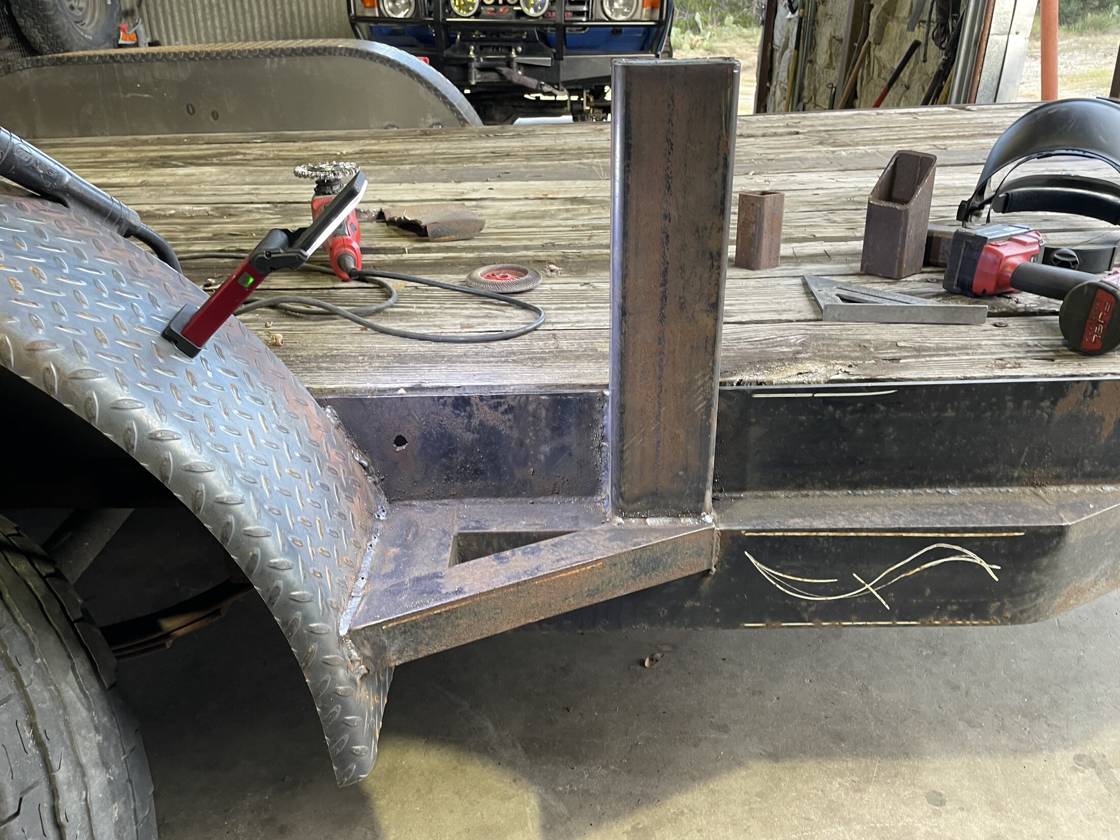

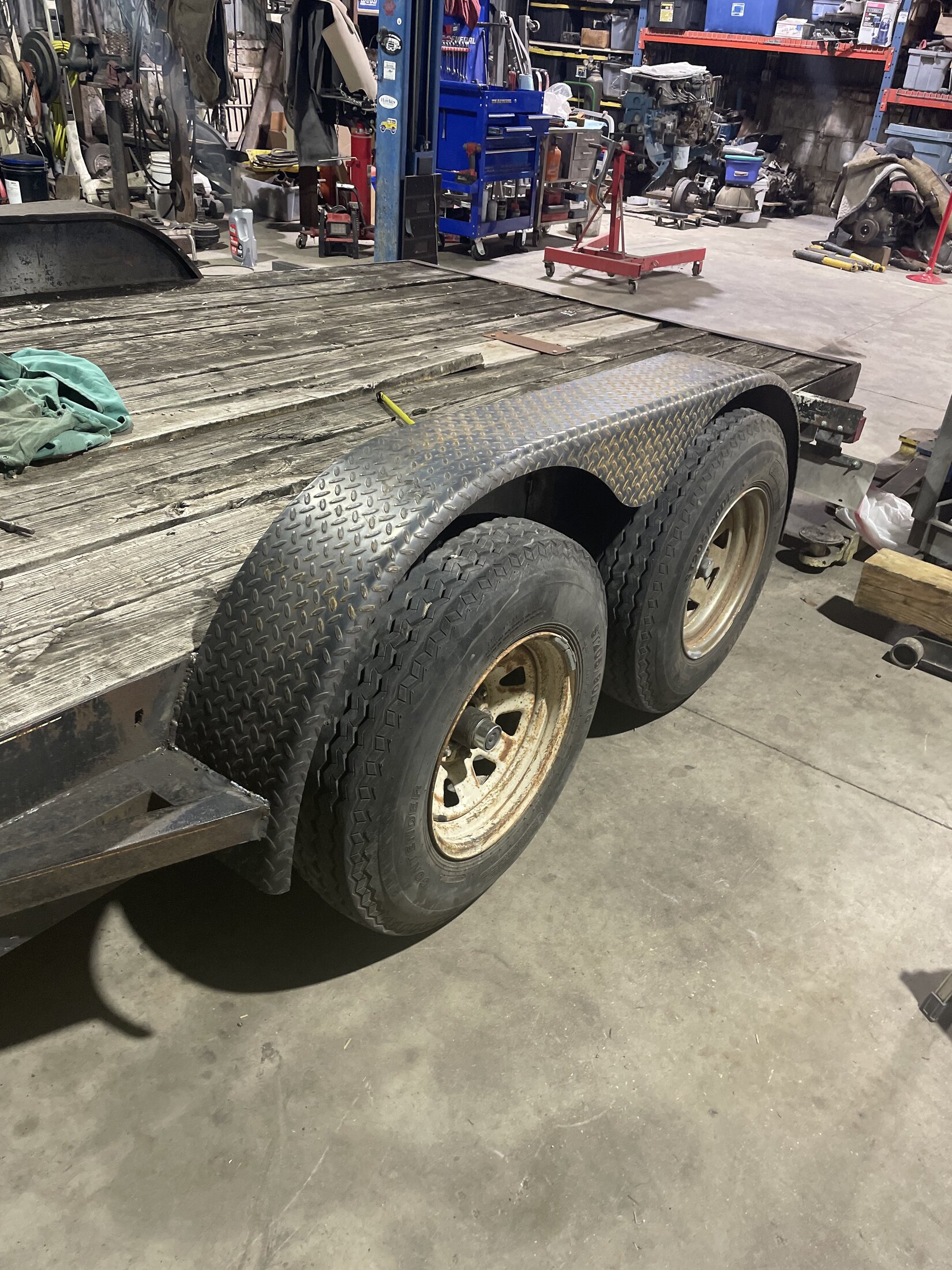

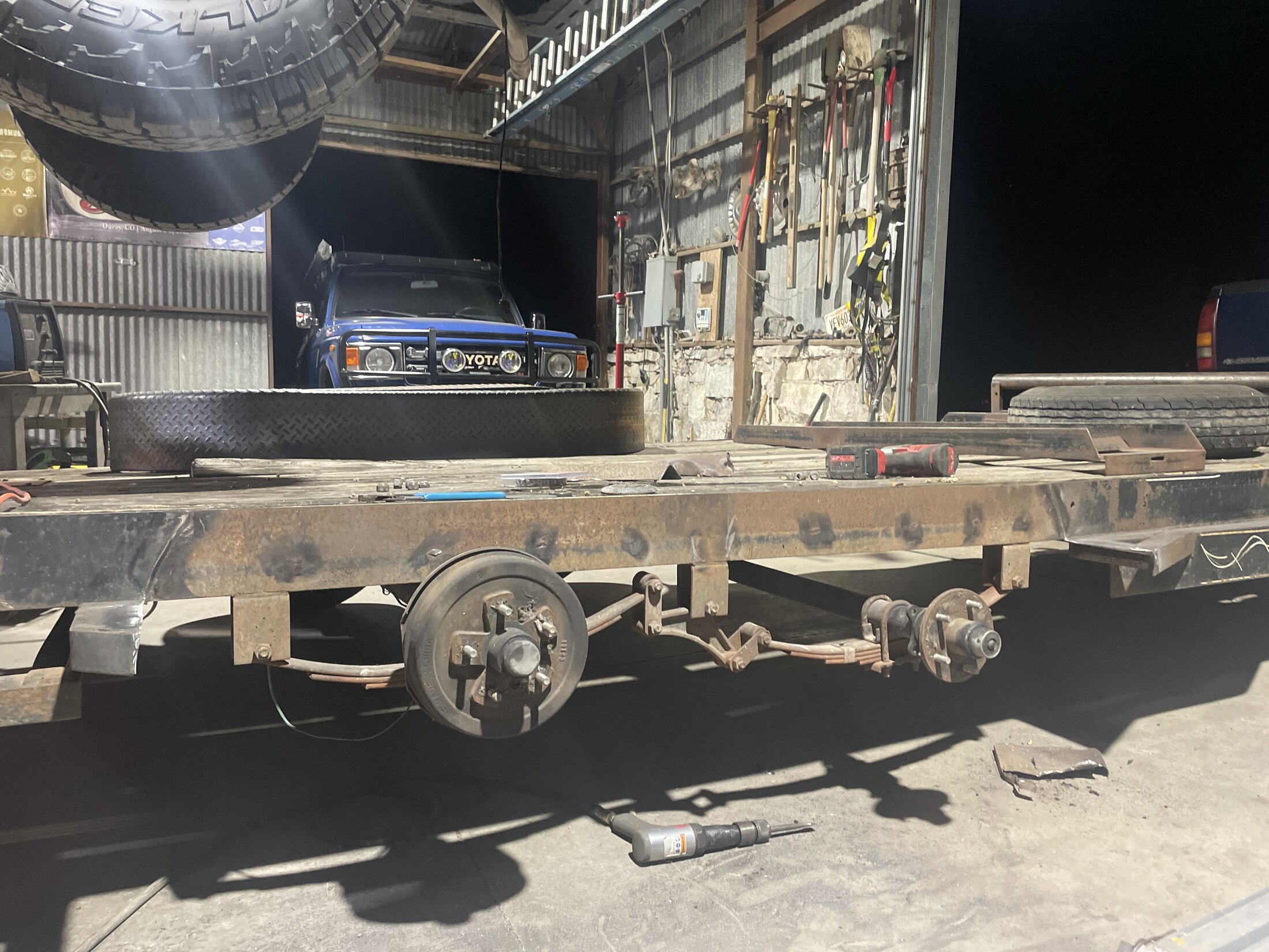

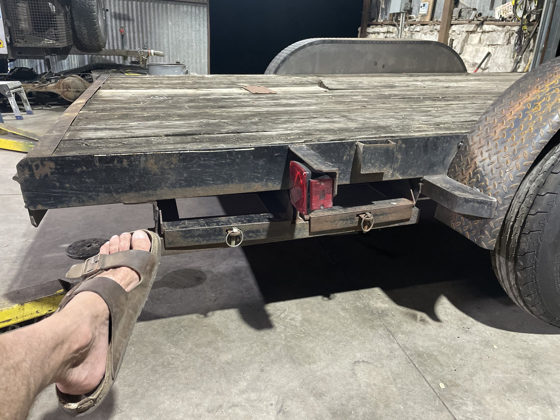

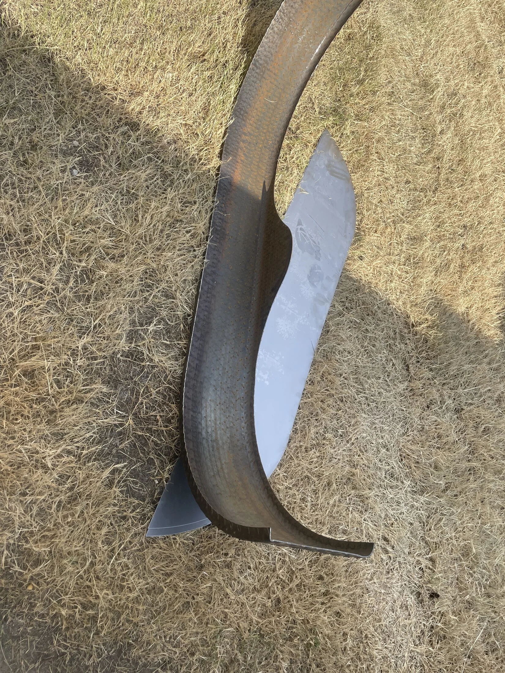

So I’m done with SAS. Was an awesome trip this year. Down to focusing on my business (day job) and not taking on any other cruiser jobs. Unless is a total “boxed in job”. IE…knuckles, H55, or something that’s squared out and easy to see a beginning and end. Also, #1 rule is no timeline with the truck owner. Focusing on many things that have been nagging me around the hacienda. Will get that copper 85/60 in here and finalize things. My boys mother has been very patient on her end. Wonderful lady. So I’ve got a car hauler that’s been used as much by others (primarily one dude) as it has by me the last 12+ years. Lots of things been bothering me on it so I’ve decided to tackle the #1 issue. The factory 16g fenders are being replaced with 14g diamond plated fenders. Sweet upgrade and completely necessary. Many folks have driven right up on the old fenders…deformed the inner skirts, rubbed on the inside of tires and the rest is history. Super excited to have this behind me. Ran out of welding gas tonight so I’ll finish burning in the passenger side once the gas is replenished. Then I’ll get it on the lift and straighten out the guides underneath where the ramps slide in. The dude that’s mostly used the trailer over the years destroyed the ramp and the underpinnings years ago when he was using the trailer and the ramp slid out while going down the road and hit a curb. His comment was the trailer jumped several feet in the air!!! Regardless, I’m tired of having to carry the ramps in the bed of my truck vs under the trailer where they were intended to go. Lastly, going to make a spare tire mount using an old axle hub and some square tubing I have laying around. This trailer has hauled a lot of cruisers over the 24 years I’ve owned her and hope to get many more out of her. Oh yeah…going to replace the deck with some new treated lumber. This current wood is actually original.

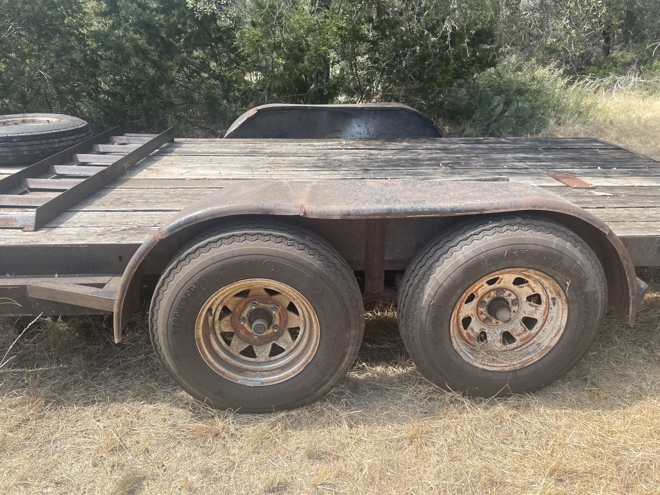

That dry Texas weather ! Looks as good as my trailer and it's only 7years old.
The salt air around here just eats them up 🤨
Yes sir Richard. My first thought was to paint the wheel wells and trailer but the reality is it will outlast me in its current state. I’ve never been one to worry how it looks so I think I’ll save the prep/paint work for cruisers down the road
