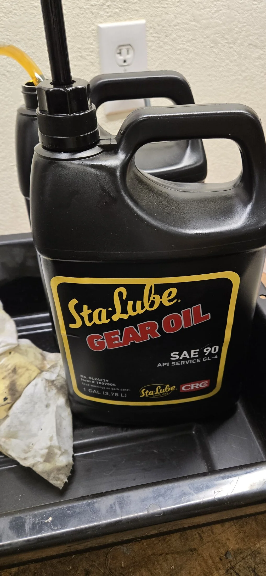

Is this a good oil to use in my 4 speed landcruiser
I'd say it's probably too low viscosity. 80W90 GL4 gear oil is what they get here.
Are you adding this or have you drained it? I run a Shell GL4 in the transfer case and transmission due to cross border movements. I had drained what was in there as I had no idea what it was or how old it was. I run a more common Klondike GL5 in the differentials and use a simple oil transfer pump to fill.

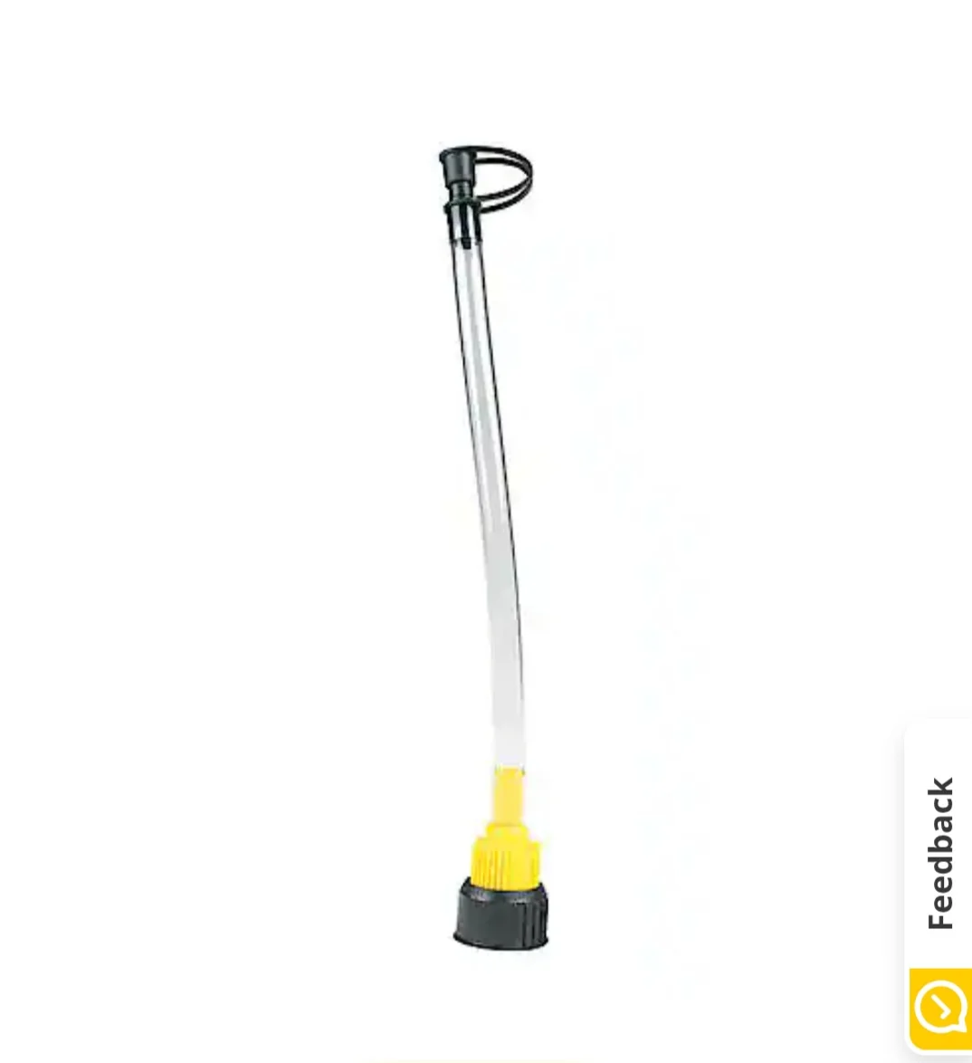

I bought a widget you dump the fluid in, pressurize the tank, and it pushes it out a tube.
If I were to purchase again, I'd go the next size up. I think it was less than $100. I tend to drop driveline fluids at least once a year and this thing makes that suck a whole lot less.
I have something similar and agree makes this task soooo much mo'better
I've used something like this forever. I put it on quart gear lube bottles, but I think it might work on gallon jug too. I buy a 1 or a 2 gallon jug and then refill the quart jug. You can squeeze jug.

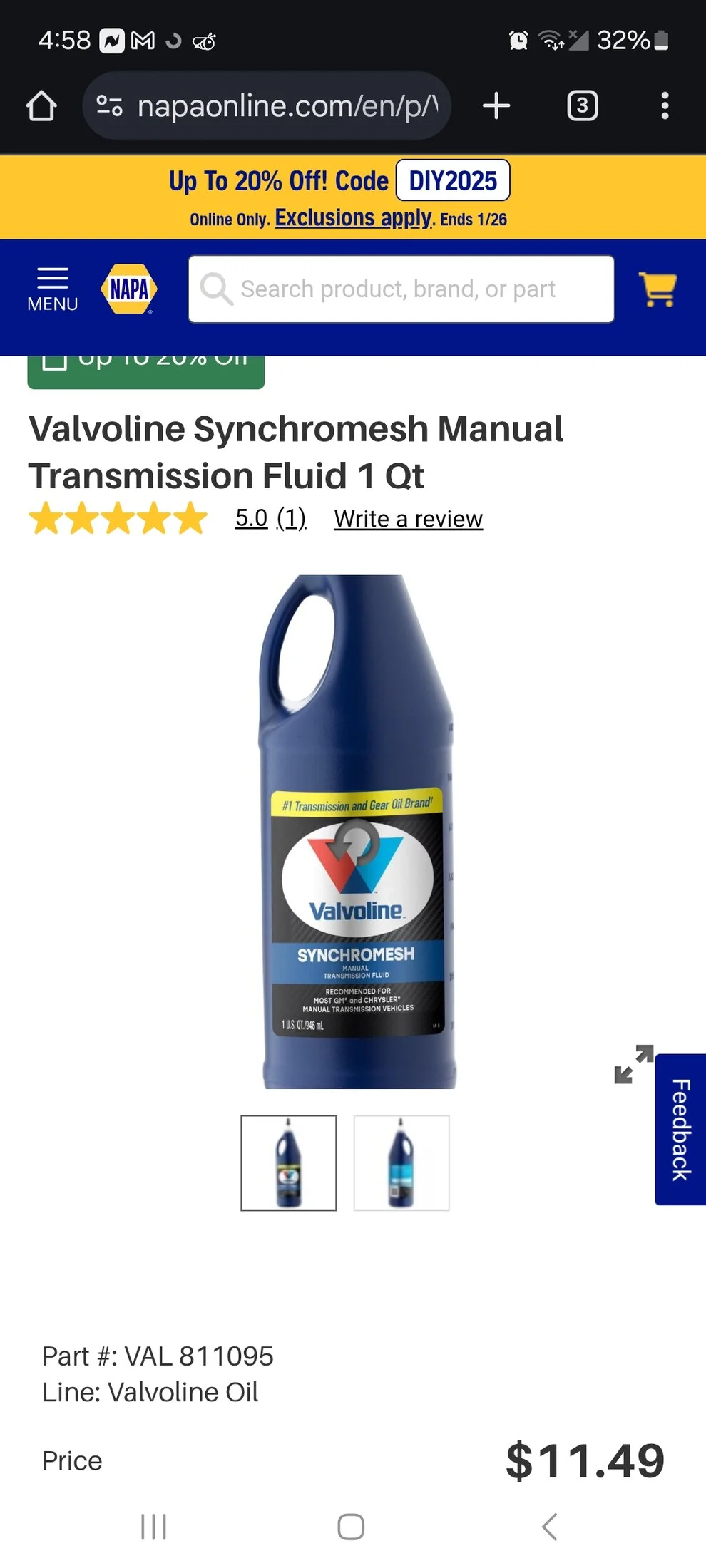

I just swapped out the fluid in my three-speed transmission. I bought a quart of that Valvoline full syn GL-5 because it came in that little squeezy bottle. I couldn't see another way to get fluid into the fill hole without removing the transmission hump or rigging up some kind of elaborate tube or pump system.
Once I emptied the squeezy bottle, I refilled it with GL-4 80w90. So I guess if you average the two fluids, I'm running semi-syn GL-4.5 in a 77.5w90. :hillbilly:
What viscosity is the synchromesh?
(Looked it up, 5w 30)
