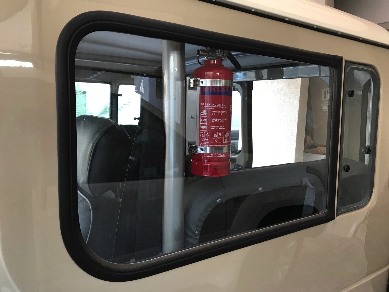

Installed a fire extinguisher on my roll cage. Has a nice quick disconnect so I can use it in a hurry...
