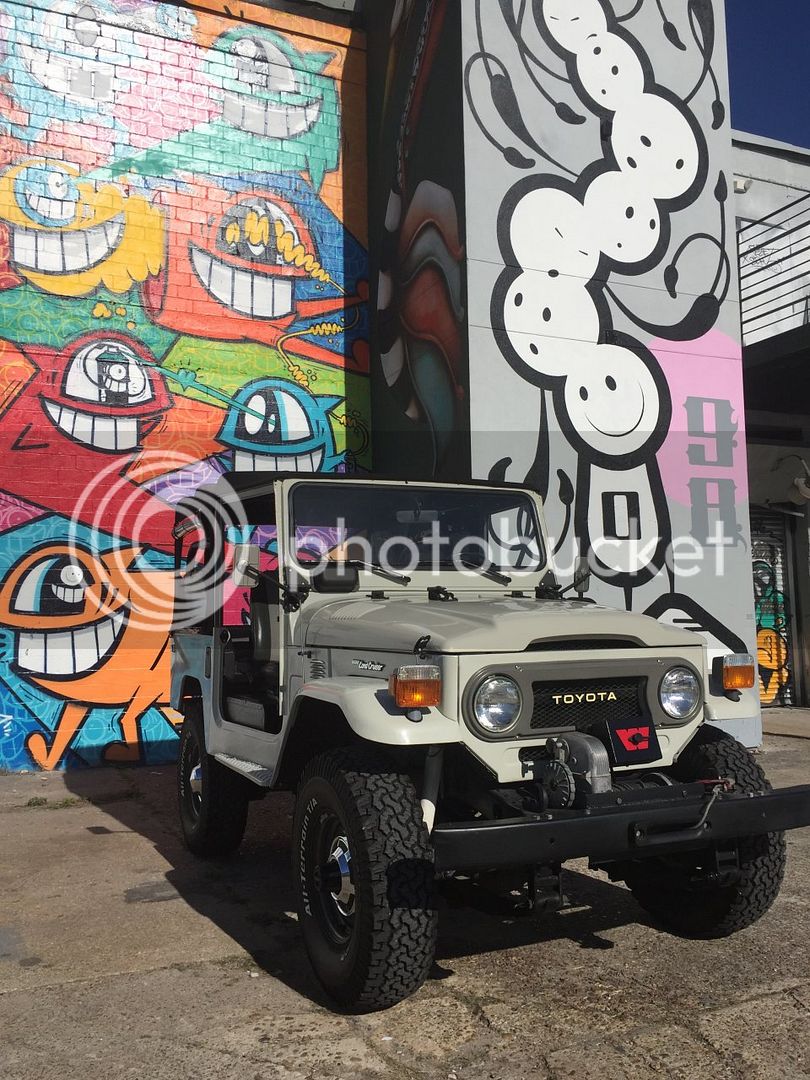

First time poster. Got my 40 back with a new (to it) wiper motor. Title transferred, registered and street legal ;). Pulled the top and doors, and then spent a couple hours with a 6 yer old helper trying to map out the unidentifiable aftermarket wiring harness. Next stop, getting the hazards and high beams to work.
Glamor pic from PO (@FARMAN33) for reference as all my photos are of it sitting forlornly in the garage.
@Skydog - yep Toyota 464 beige.

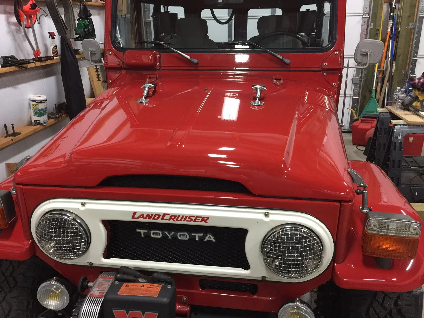

Waxed the cruiser today and for the first time I realized how beautiful the Toyota Freeborn red color was, they did an excellent job in selecting FJ40 colors!
full
full
Both of these Freeborn beauties look ALMOST too nice to drive! :steer:
