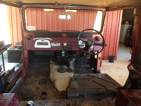

I'm fed up of getting as high as a kite from the smell of petrol whilst I drive, so ill be ripping the seats out to install a poly tank i got in from cruisercorps and then replace all the lines.

I would get a factory new metal tank, or, an aftermarket metal unit from CCOT.
I would not put a poly tank into a 40 and expect it to not smell like fuel.
But, hey, perhaps you will be the first user out here to have good luck with a poly tanks.

Cheers Poser. Next time should search first, but later. It was the same price as second hand ones in Australia, so i'll see how i go with it. Perhaps a two stage approach, I'll inspect the tank and hoses first before replacing.

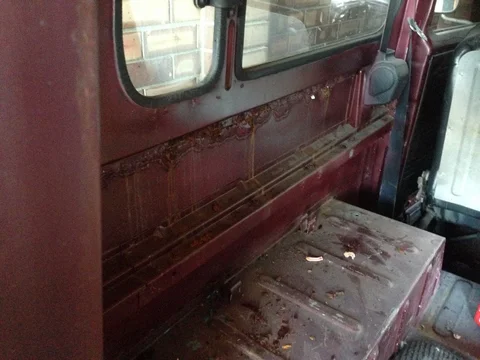

The more i pull this apart, the more rust i find. Roof off, windscreen down and side removed up from the tub. A lot of rust between the roof towards the back doors. Not sure what to do. Some advice I am getting is to get someone in to do some TIG welding to cut out the rust underneath the door panels. The windscreen and tub at the front hows quite a bit of rust as well. Again, not sure as to source another 2nd hand windscreen from a wreckers, get mine fixed or go fibreglass.
Im going to try to take some parts down to some local welding shops next week, and see what they say.
Hi Phil
For me, much of the enjoyment of owning these old cruisers is the DIY work. I've bought a little MIG welder that I use for sheetmetal work with flux-cored wire. (A lot of people apparently don't like the flux-cored wire, preferring instead to use ordinary wire + gas, but flux-cored works well-enough for me.)
Admittedly the only place I've had to tackle serious rust like you've got there was in my windscreen.
It looks like your FJ40 has been in a coastal (salt) environment.
Getting someone to repair that sort of rust properly costs a lot of $$$ and first you've got to find someone whose even capable of doing a proper job (ie. an all-steel job without using bog). Those people aren't present in most panel&paint shops.
Of course here I'm assuming you want a job that's going to last more than just a few years and allow you treat it normally (rather than storing it in a garage and bringing it out only in fine weather).

Don't get disheartened by the rust. When I get a repair done I stipulate that once all the repairs are done, before they fill with bog, I come down and take pics 'for resale' should I ever sell the truck. That way I know it's been repaired properly. Plus, you can always do the filler work yourself. It's easy. Mix it up, use a spatula to put it on, let it dry, sand. Repeat.

Some people get their tank re-glassed. A fibre glass resign is poured in. The other option is to put in a reserve tank in the rear and turn your gas tank area into a mini tool crib !

Cheers Tom. Im a home brewer and picked up the welder to do a bit of work - stands etc. Then i promptly put it back down! The FJ40 has definitely lived most of its life up and down the West Australian coast. My old man was a keen fisherman so its definitely seen a lot of salt.
Hopefully this weekend I can get an idea on the work thats required. Yeah i want it to last a good while.

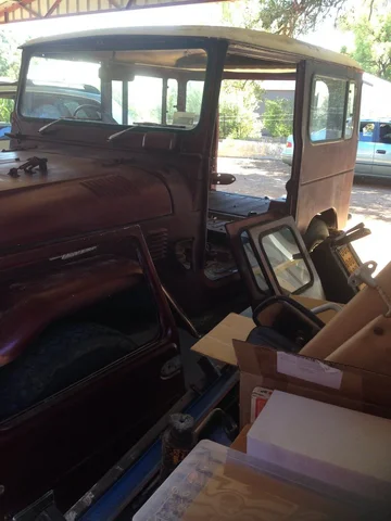

Windscreen off, windows out and most parts are now off to get prepped and primed.
Scored another windscreen as when i took mine off, had huge holes on the top left and right hand sides, as well as on the bottom where the vents are. I got it for $200 off gumtree, and it was perfect, just a small bit of surface rust.
The only other big parts of rust where I removed the window. Nothing major.
