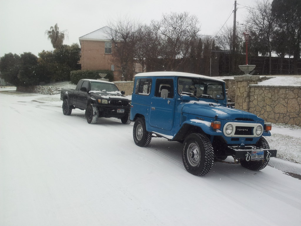

Used it to drag our airstream to safety. Wolf creek was well over its banks and the lower part of our property will likely be totally flooded tomorrow morning. Its been pouring all day and still going strong... glad we pulled it up.
