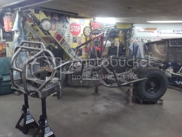

Took the whole damn thing apart and scattered the various parts and pieces all over my garage.
From this....
To this...
Yeah....
