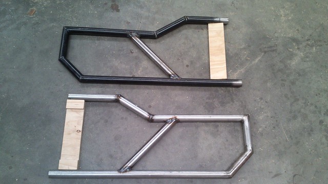

Nearly finished my tube doors. I wish I had a bender.

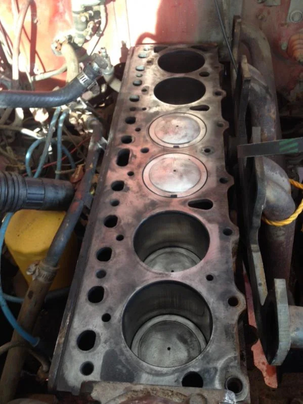

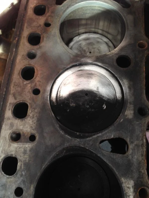

Pulled the head to work on the valves, seals and check for cyl wall damage.
Cleaned the pistons of carbon and old gas from sitting:
attachment.php
attachment.php

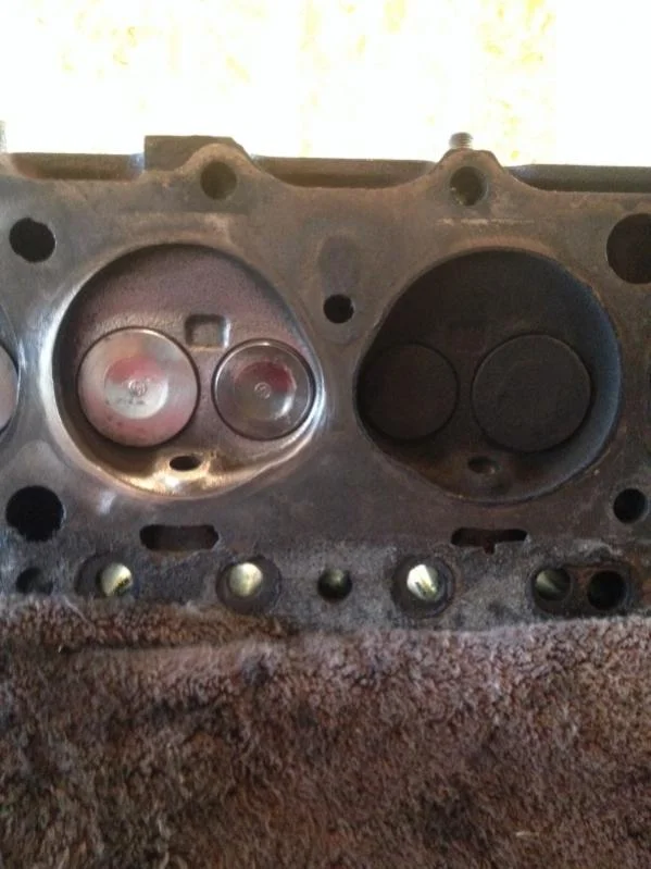

Before and after of the valves:
attachment.php
Now to pull two pistons and rehone the cyl walls.
