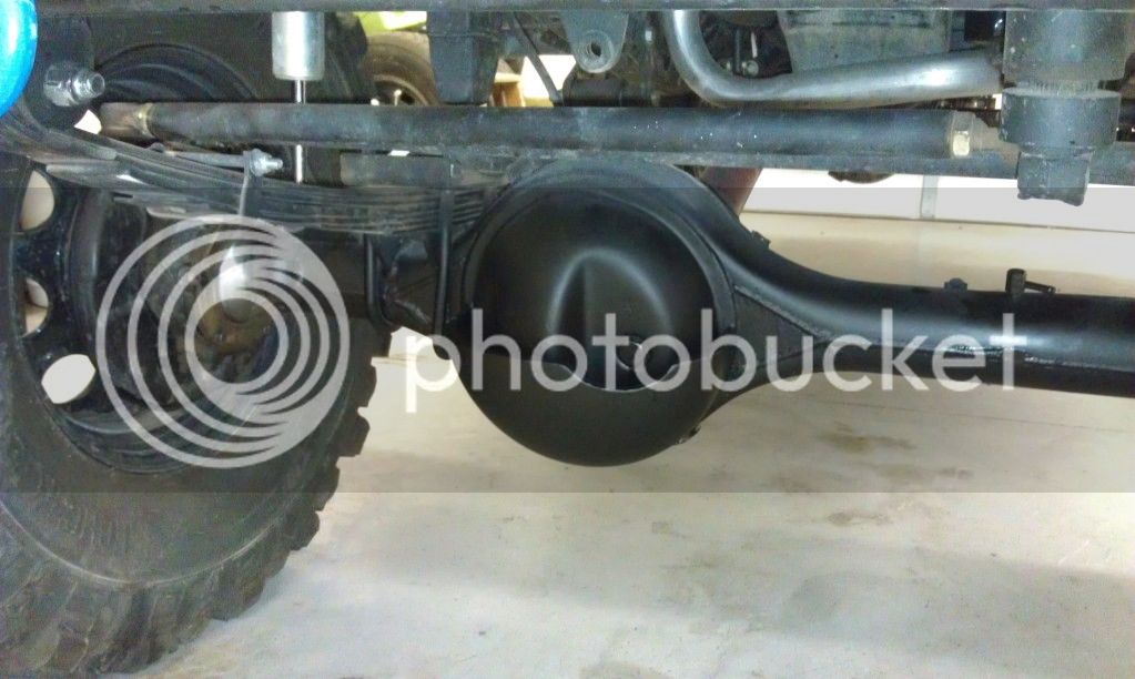

Installed front diff armor (thanks to spotcruiser)

Looks great, Jim. You did cut some sort of drain hole in it, didn't you? You don't want it to collect water and you do want some way to wash mud and crap out of there.
Yea put a nice little drain hole along the bottom. Already making plans to put some marks on it.
