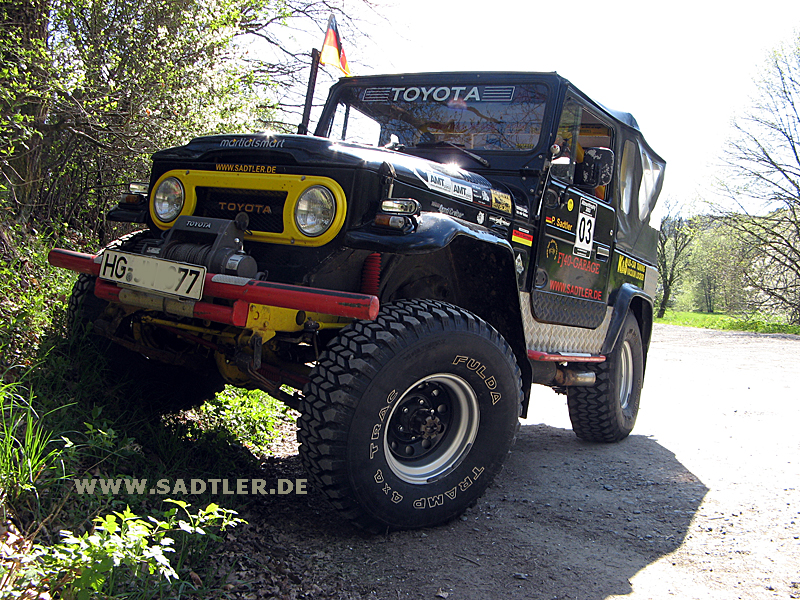

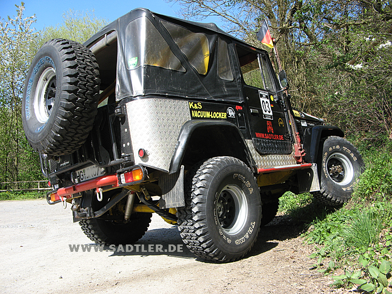

Did some minor trimming in the rear. Built a tube bumper, and installed the round LED tail lights. Swapped in a set of FJ60 rear springs flipped to get the wheelbase to 101". Had the drive shaft lengthened. Welded new shackle hangers and perches.
