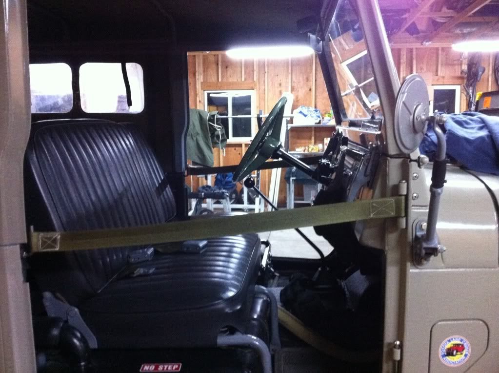

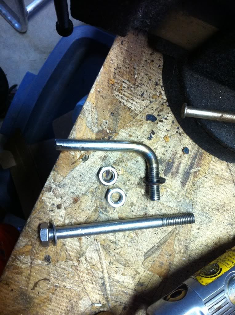

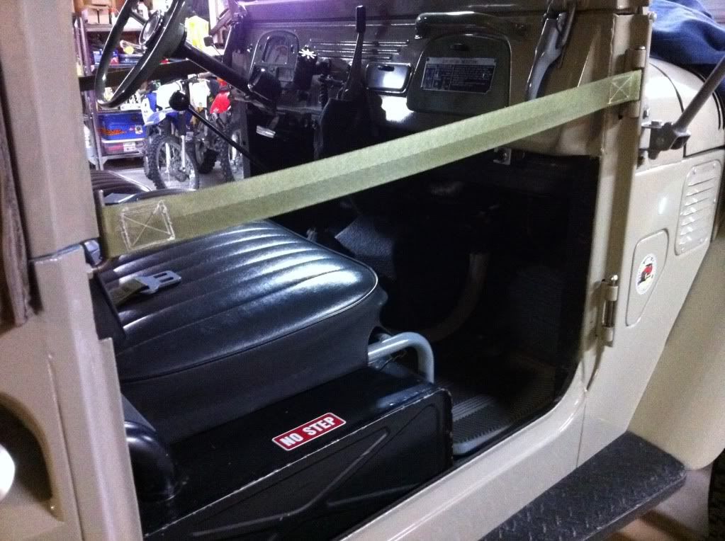

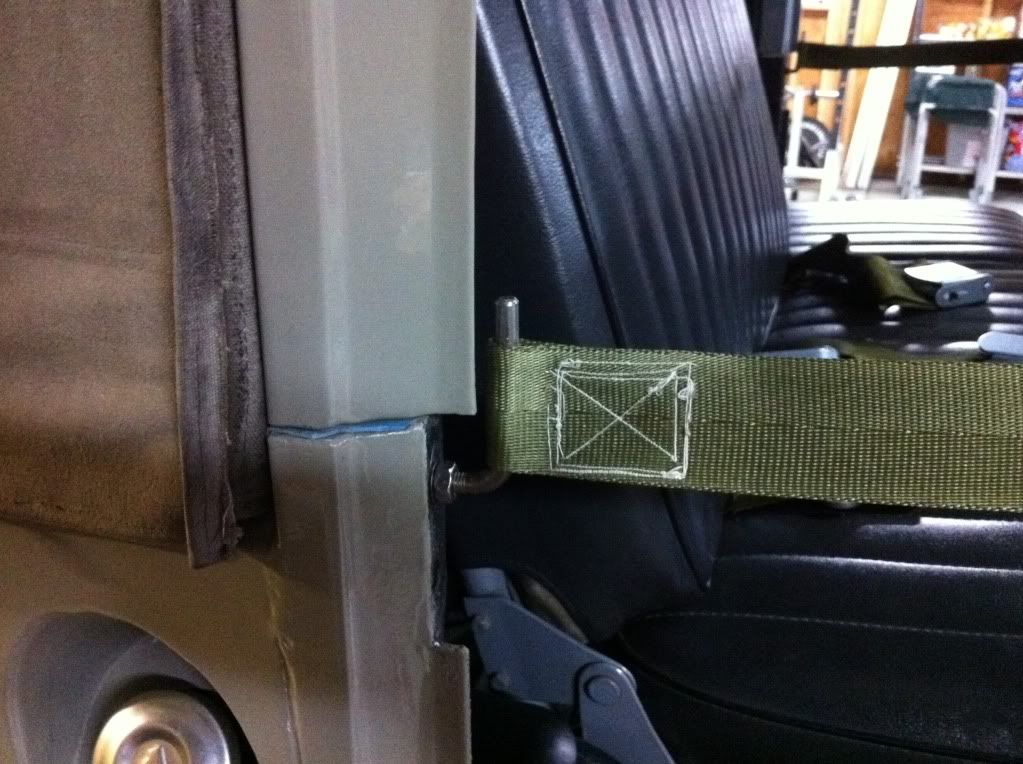

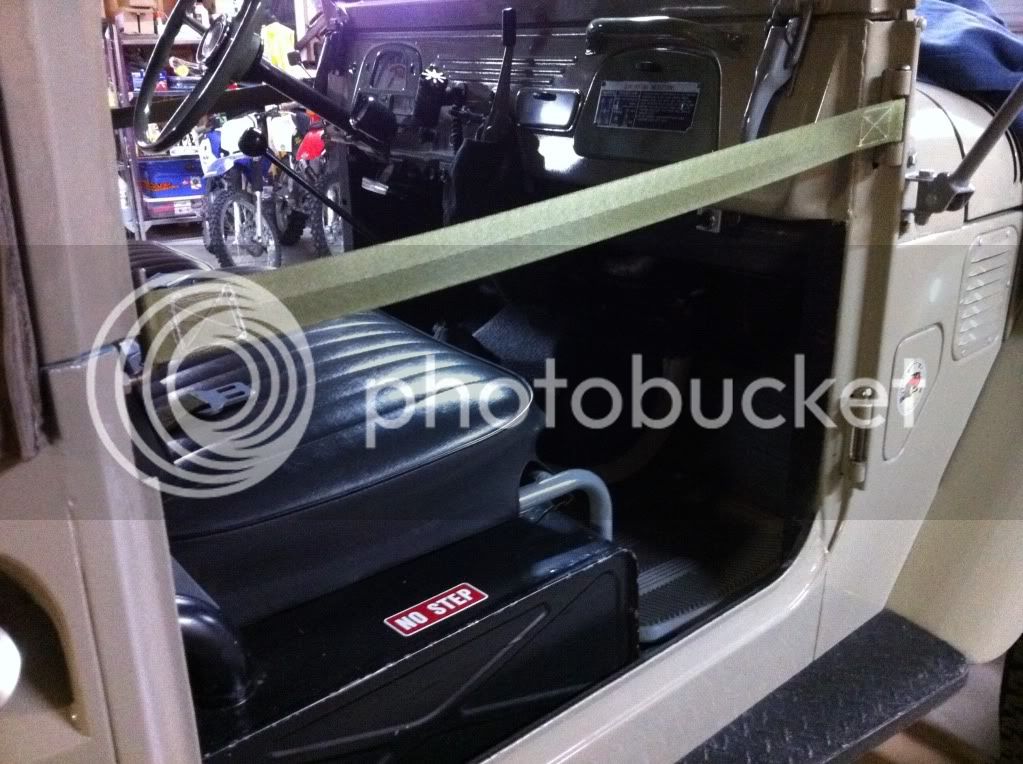

Got the Paki-top back after having both rear zippers replaced. Also made a cheap pair of 'factory soft top safety straps'.
I used two 8mm x 100 stainless bolts with nuts and washers and sewed the straps myself.
The strap uses the upper door hinge pin in front and the modified bolt is threaded into the upper bolt hole in the striker plate. I threaded it in until it bottomed out, un-screwed it til it was oriented correctly then tightened the nut / washer.
Love the "No Step", where'd you get it?
A friend that's an aircraft mechanic gave it to me. They're pretty common on helicopters; lot's of places to avoid putting your feet.
I put it on there after I stepped on the tank and caused a leak.:whoops:
I pit it on there after I stepped on the tank and caused a leak.:whoops:
Nice. I need one pronto then :beer:

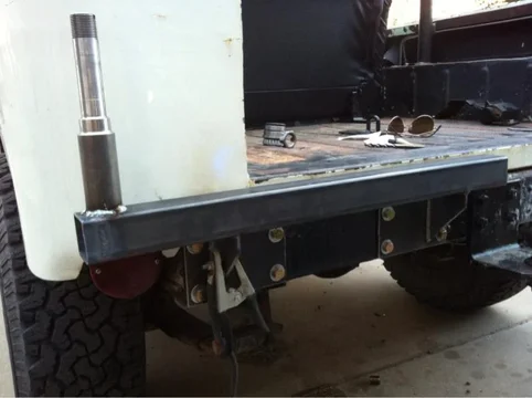

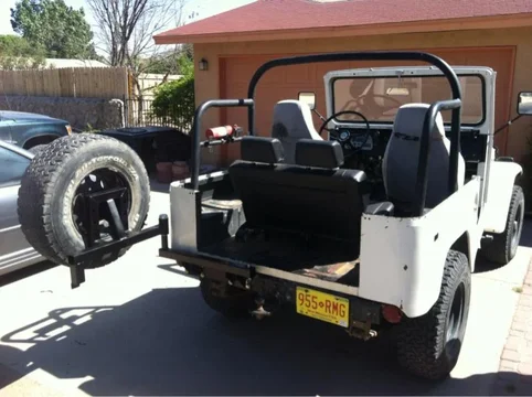

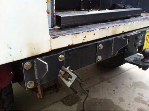

Finally finished fabricating my spare tire carrier!! I'm actually really happy with how it turned out......so was my brother, now I have to make him one!
Tire carrier looks good, however it's not really noticeable in the pics if the spindle is welded through the 2" square tube or if its just butt welded. Butt welding won't be able to handle the sheer forces applied to the spindle with the weight of tire and it bouncing around back there.
Thanks! The spindle sits down inside the square tubing and is welded at the top and bottom and vertically on either side inside the tubing. I'll be surprised if it goes anywhere. Plus the swingarm is fully supported on the right side as well so the only time the spindle is baring the full weight is when opened
It looks like you can see the heat penetration where he welded at least down the spindle. x2 on it looking good!
