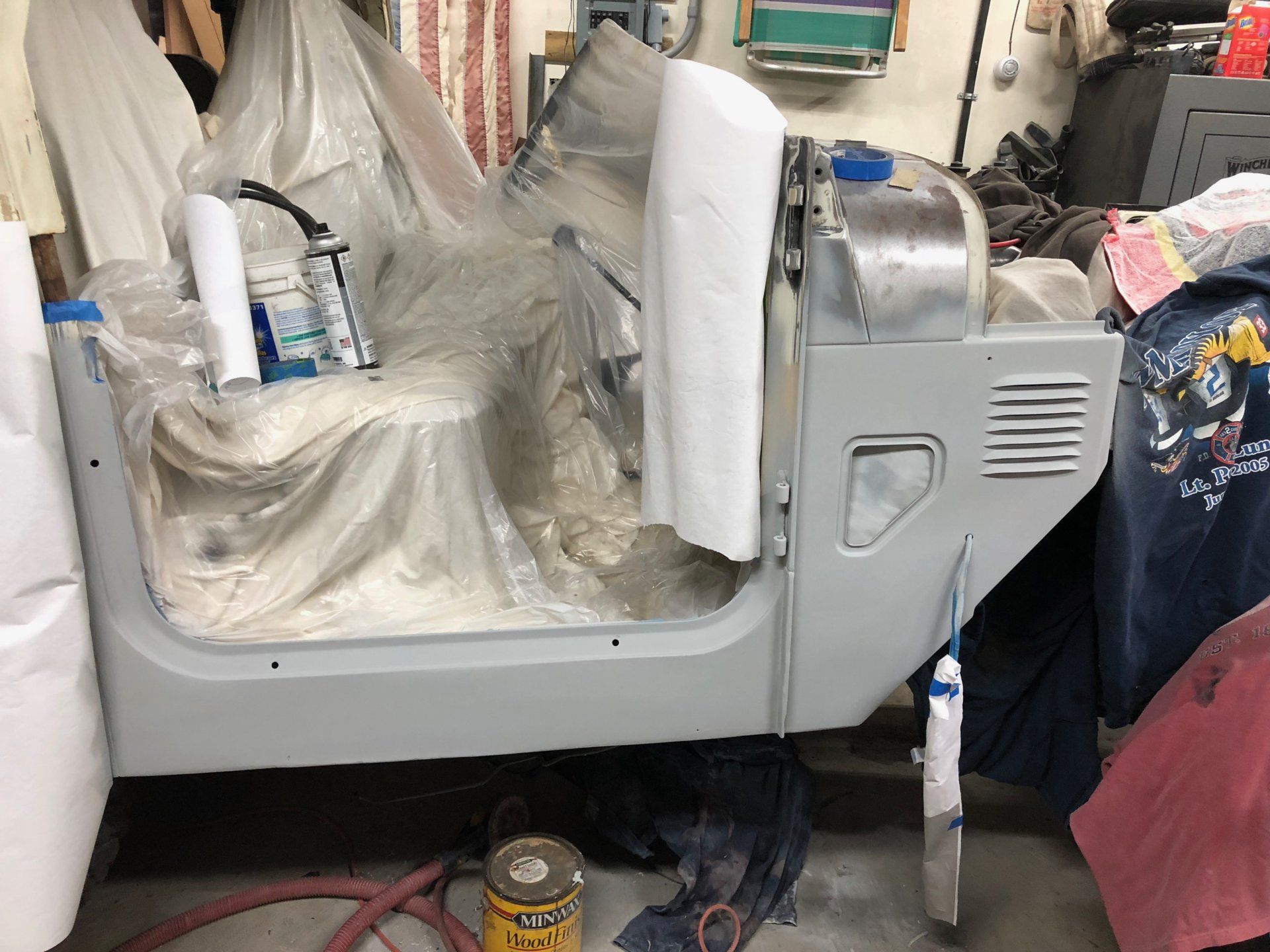

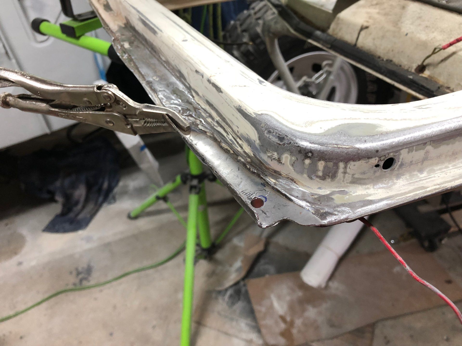

Finally in primer.
At first I thought what PO would cut-off the top tab from the windshield. Once I prepped it for paint, realized it rusted off.

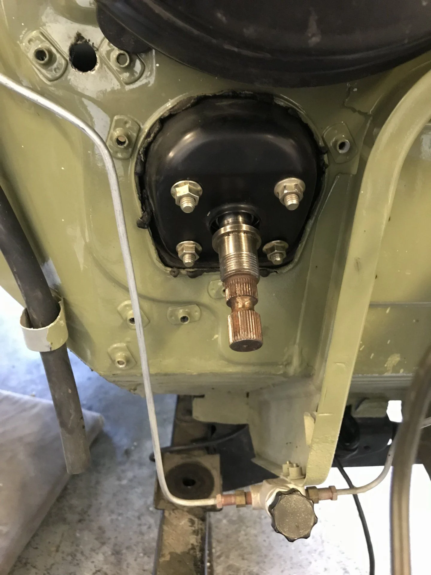

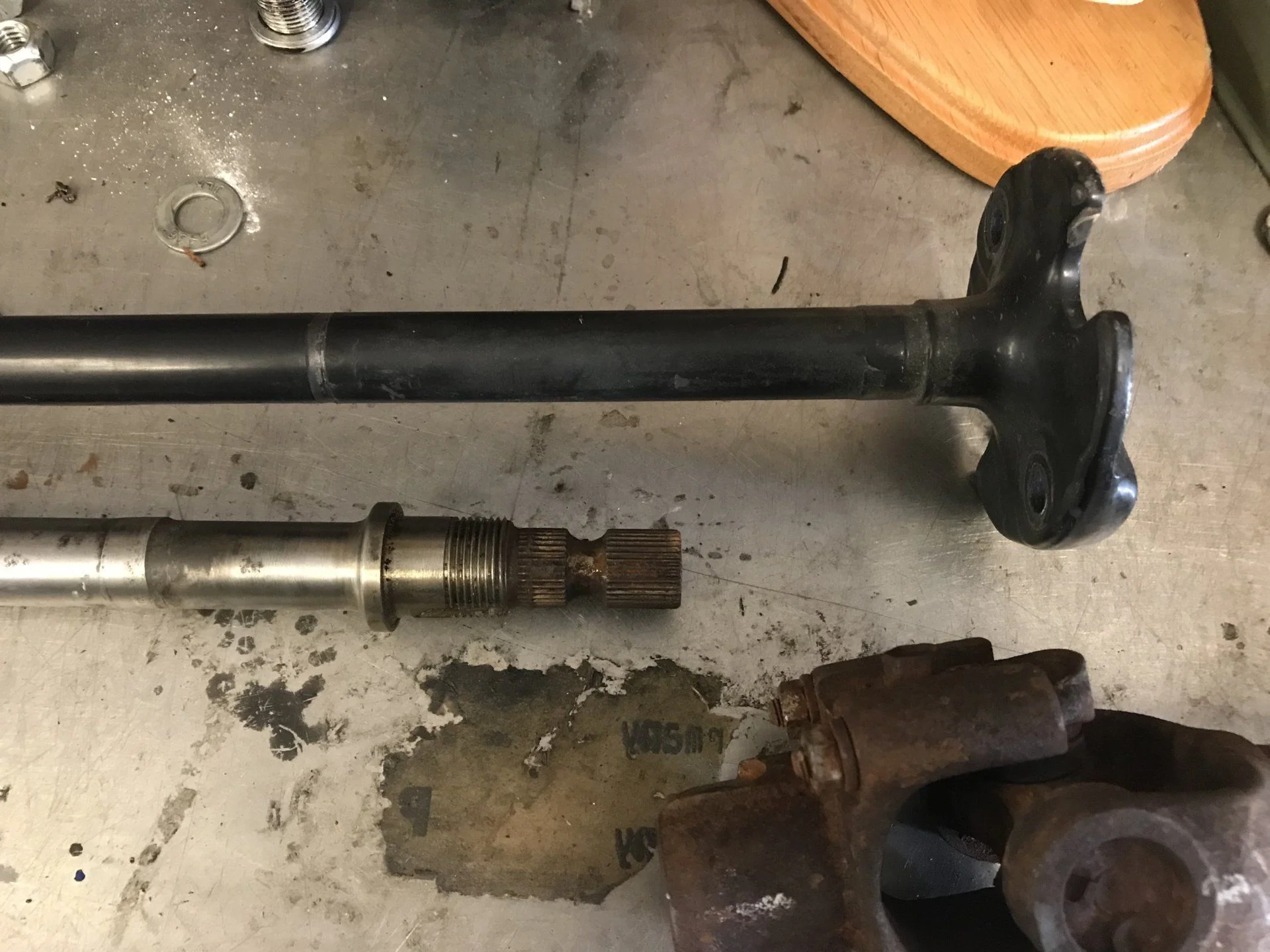

I started my FJ60 power steering conversion. I made a bit of a boo boo in that I bought a FJ55 column because I read it made the job easier but I didn't see that I needed a '74+ column until I had already paid for an older style that had the ignition switch on the dash. Here is what I'm after, a splined shaft that doesn't require scabbing or grafting:
here you can see that the early style -55 steering rod is slightly different dimensionally from the later style -40 rod (It was also .035" larger in OD).

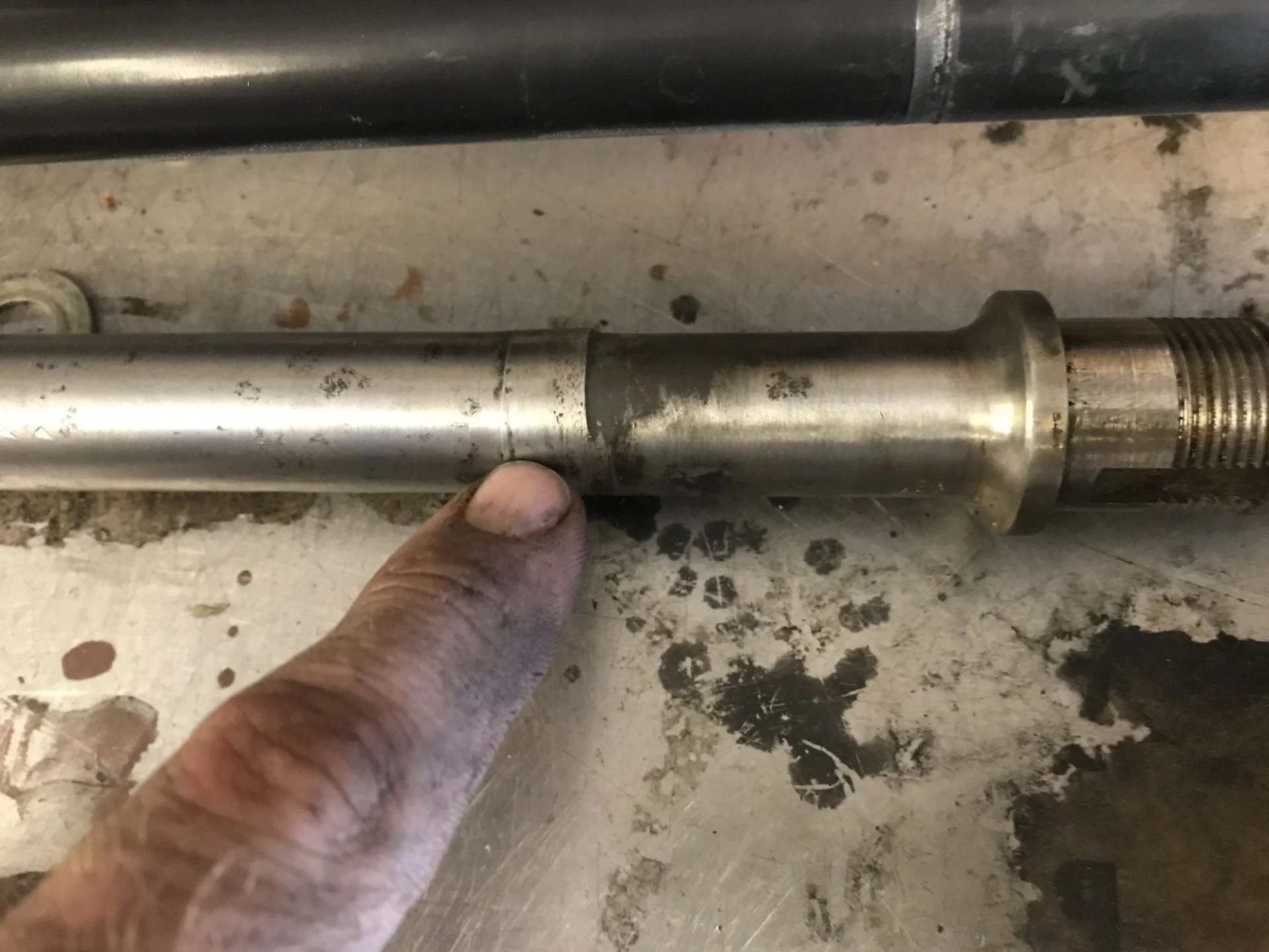

Undeterred, I took some measurements of the inner shaft and decided I could still make it work. First, I had to remove a raised area at the bottom of the -55 shaft so the bearing I got from Cruiser Outfitters could slide past:
I also had to turn down the OD of the shaft where it rides in the upper ball bearing at the ignition lock. A few minutes on the lathe and it works like a champ!
Perfecto!

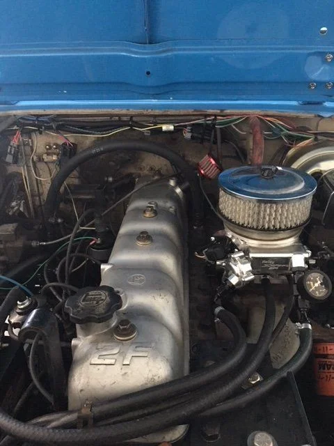

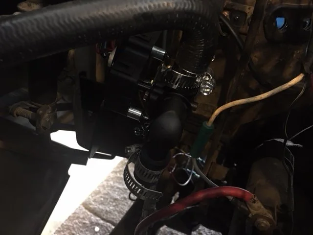

Then removed the Holley 2 barrel and installed the Holley Sniper EFI unit. A pretty easy 1:banana: or maybe 2:banana::banana: install. The main knowledge needed would be to understand the electrical system to wire in the EFI unit. Now time to just drive and enjoy it.
