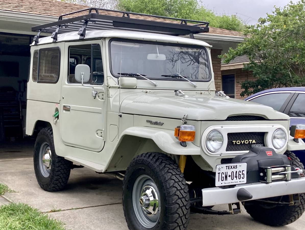

Finally got to drive this beautiful 40 for the first time! I can honestly say it is the most fun vehicle I have ever driven.
There are some states where land cruisers and their numbers are plentiful and people meet regularly to enjoy the uniqueness of their pride and joy.
