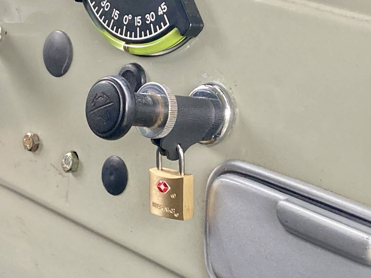

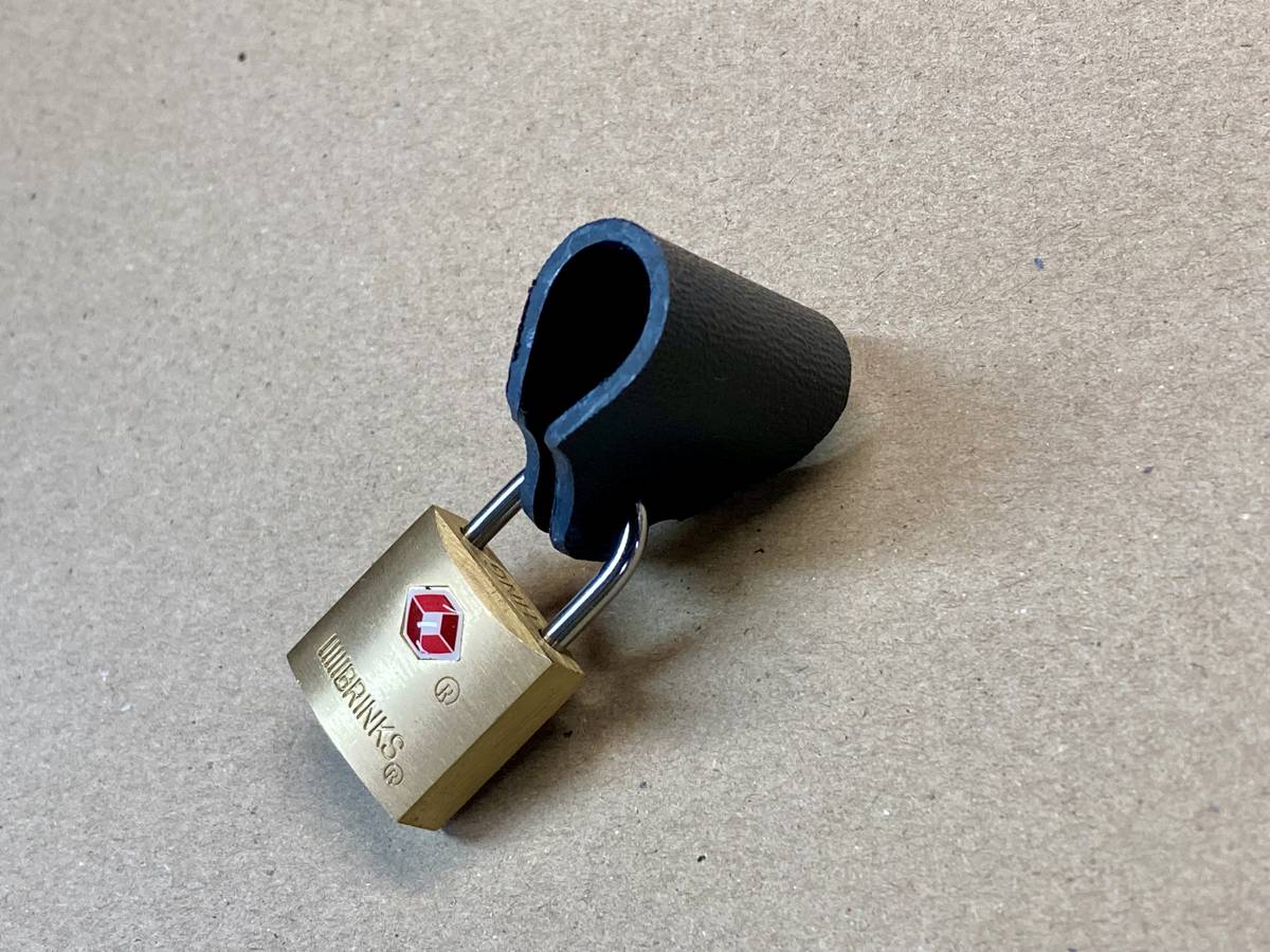

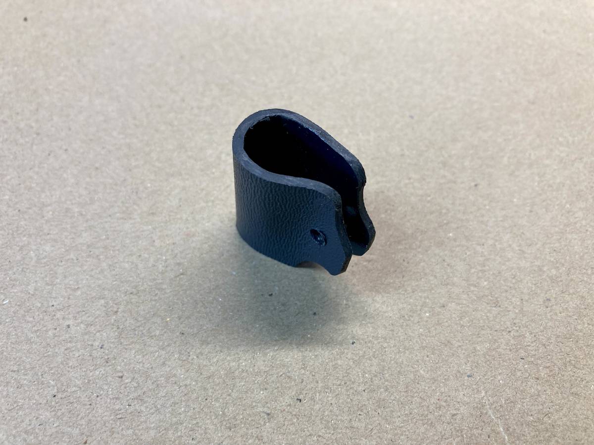

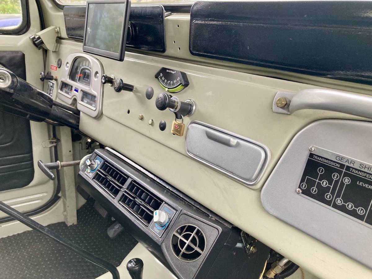

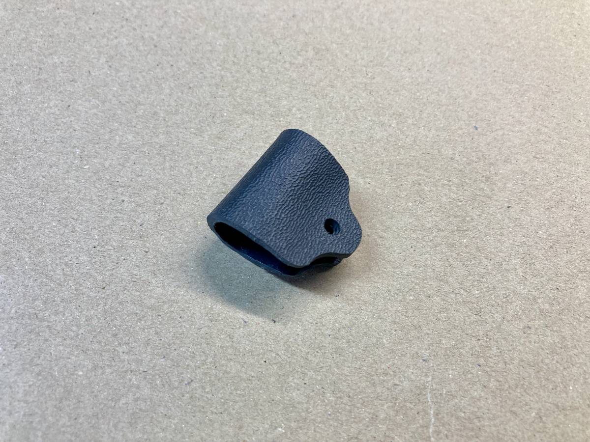

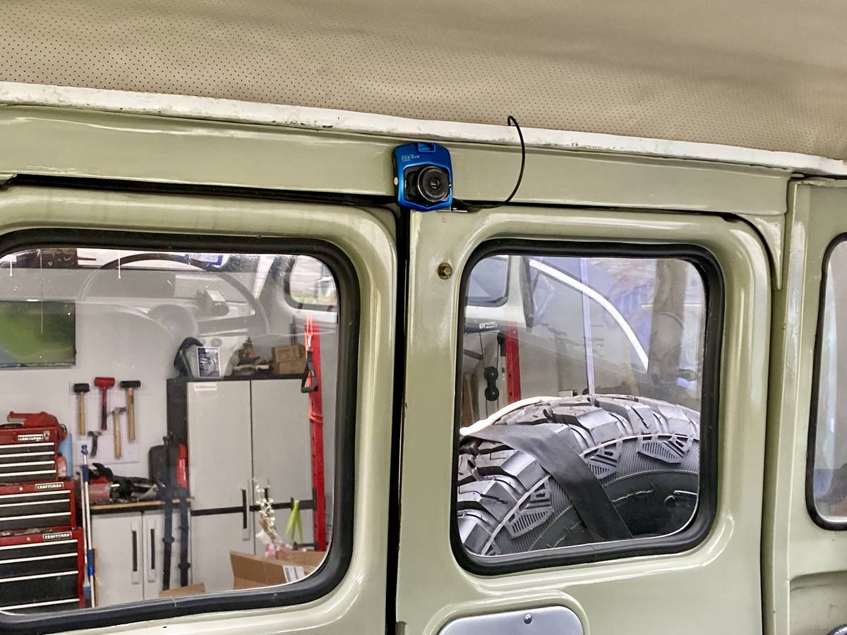

I made a Fuel Cut Off Switch Lock that works great. It prevents the switch from being deployed. “Popping the clutch” to start the engine will not work.

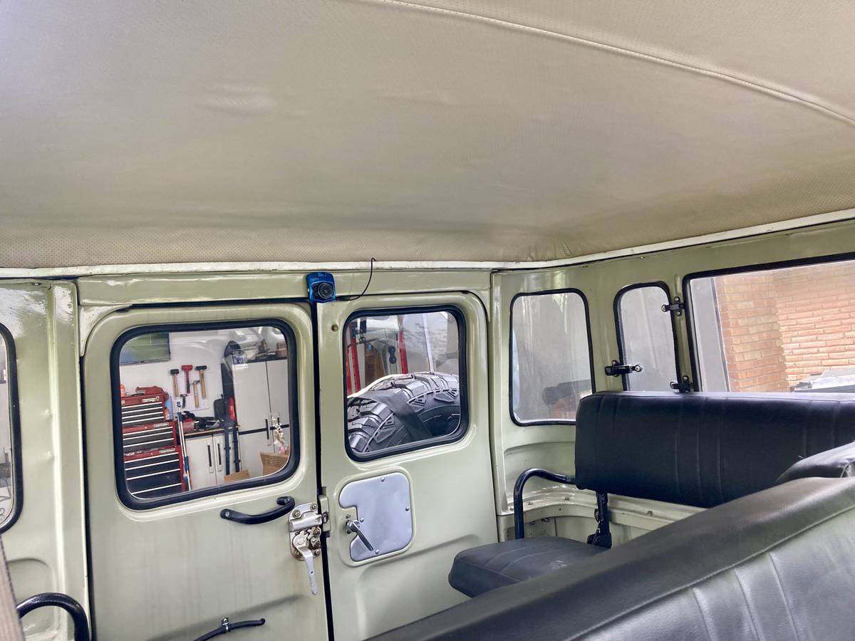

I also installed a camera in the back of the 40 facing frontward. It’s visible to anyone that peeps inside the cabin. Smile. You’re on candid camera.!
These theft deterrent devices will give me a little peace of mind when I take the 40 out to dine or to do a little shopping.
