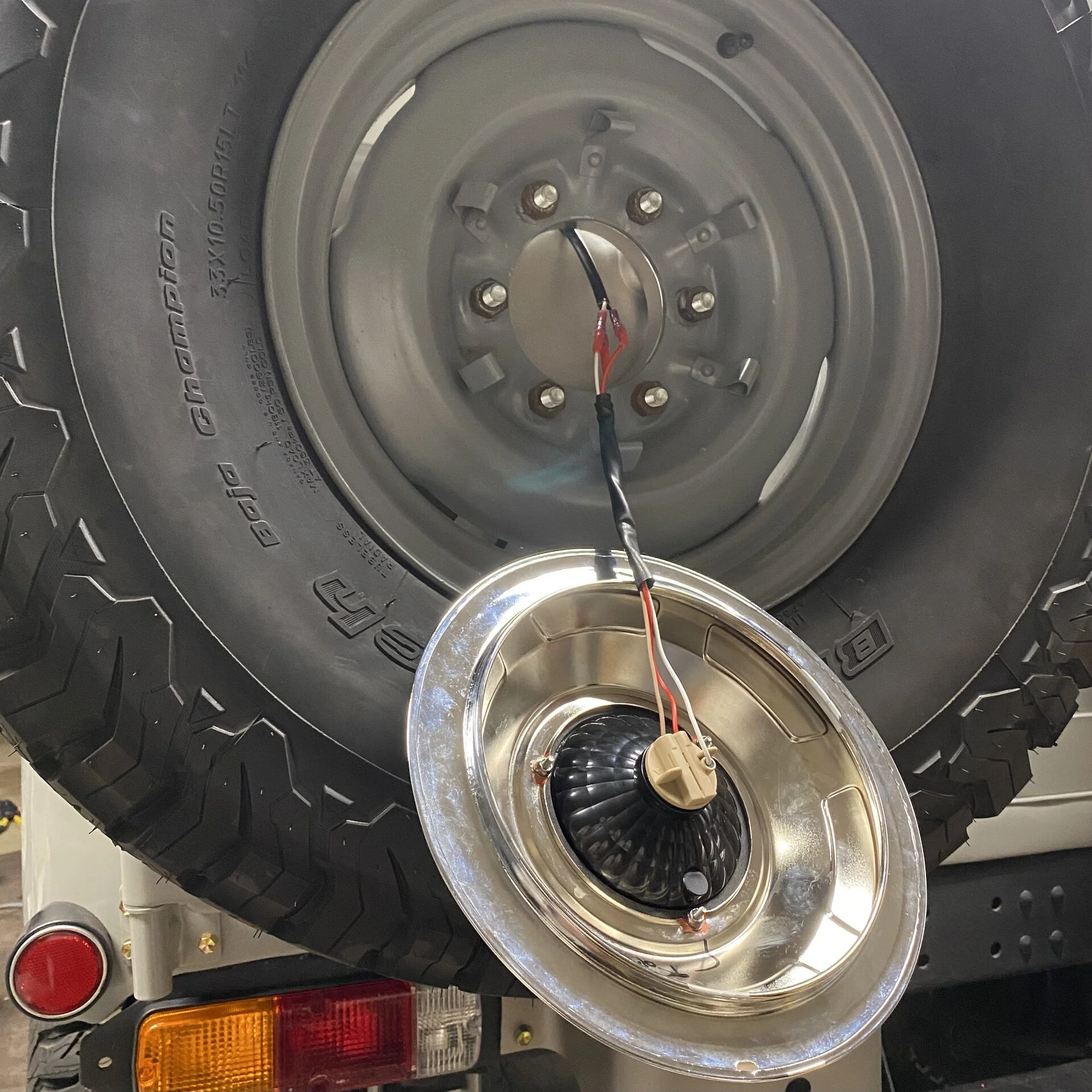

Constructed an idea I had thought up awhile back for a spare tire upper brake light on my 1975 Fj40. For more info on it and the thinking behind it see my build thread here:
Started with an OEM hubcap and DOT certified brake light that would sit inside of it.
Attached with some stainless hardware
Connected with waterproof bullet connectors to a length of wire that was spliced into rear wire harness.
The finished product
At night with running lights on then braking below.

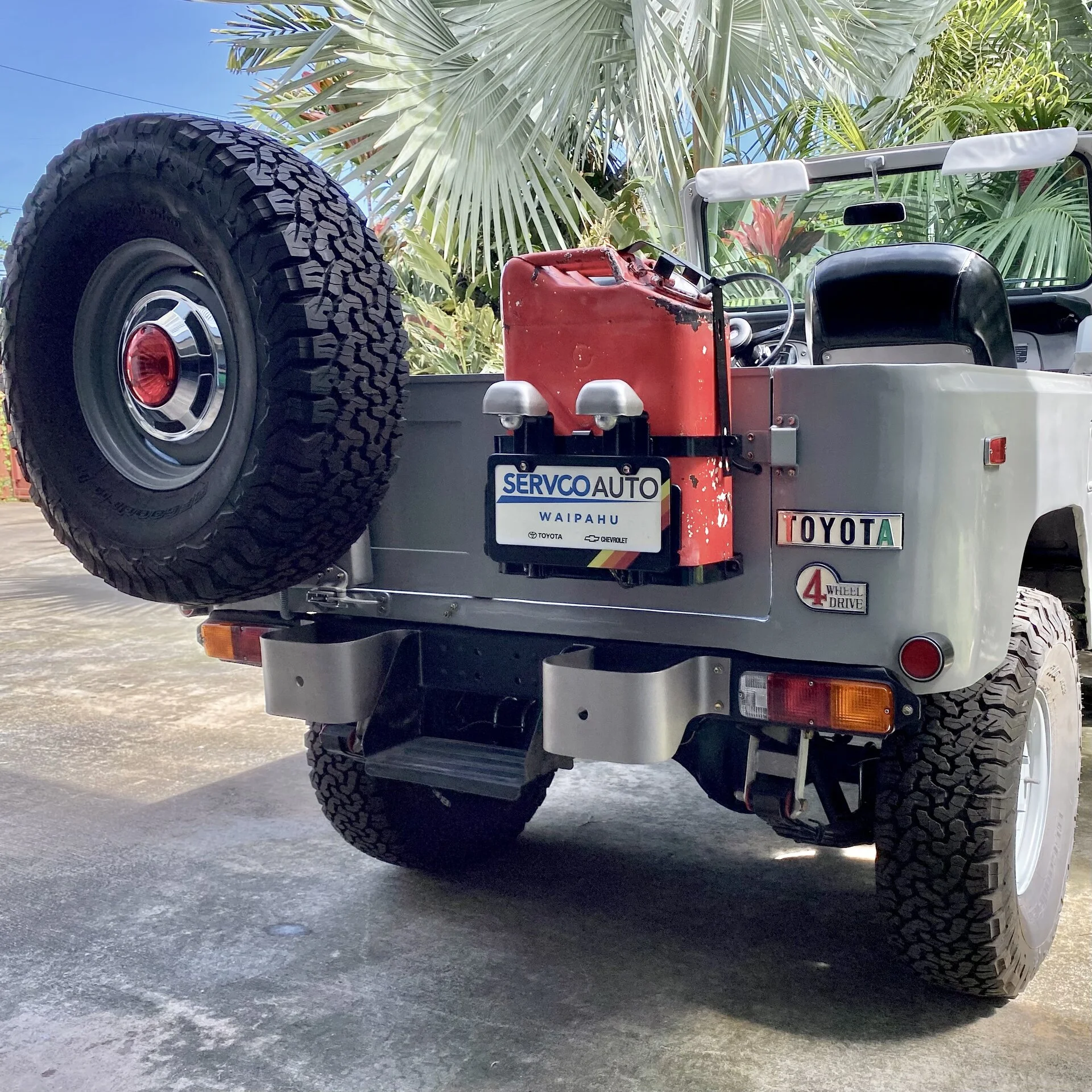

Finally got my tire carrier built. Still need to figure out what to do on the other side.
They were from my shelf. I have had them for about 4 years. I bought a rear bumper kit for my 3rd gen 4runner and never used it. The spindle and latch were in the kit. You can get them from Amazon. Nothing special .
Looks great! What did yo use for the hinge and the clamp? Suppliers and part numbers would be really helpful!

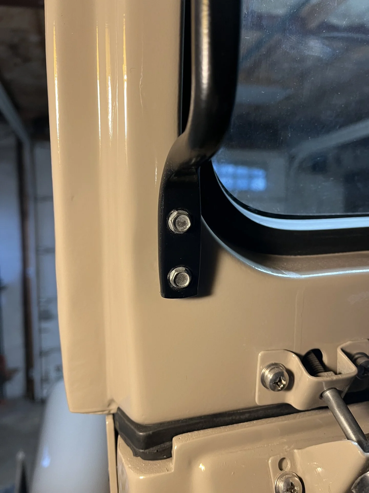

Can you tell/show more about your handles that are vertically mounted on your windshield? I always felt that was a good spot for one. I usually grab the outside of the windshield getting in.
Hi Airon23 these handles were on when I bought the 40 I don't think there automotive but I liked them to so I put the back on hope the pictures help
