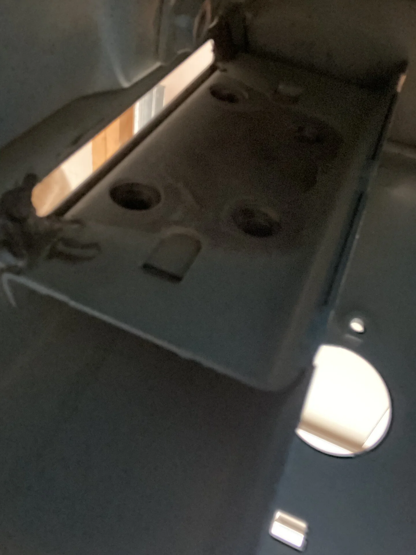

You may be able to get some adjustment by working the inner hinges. Here’s a pic of what the upper looks like. They offer a very small amount of movement but you may be able to adjust the lower one out and the upper one in. If you need more movement then you could remove them and slot the holes a bit for more room to adjust them.

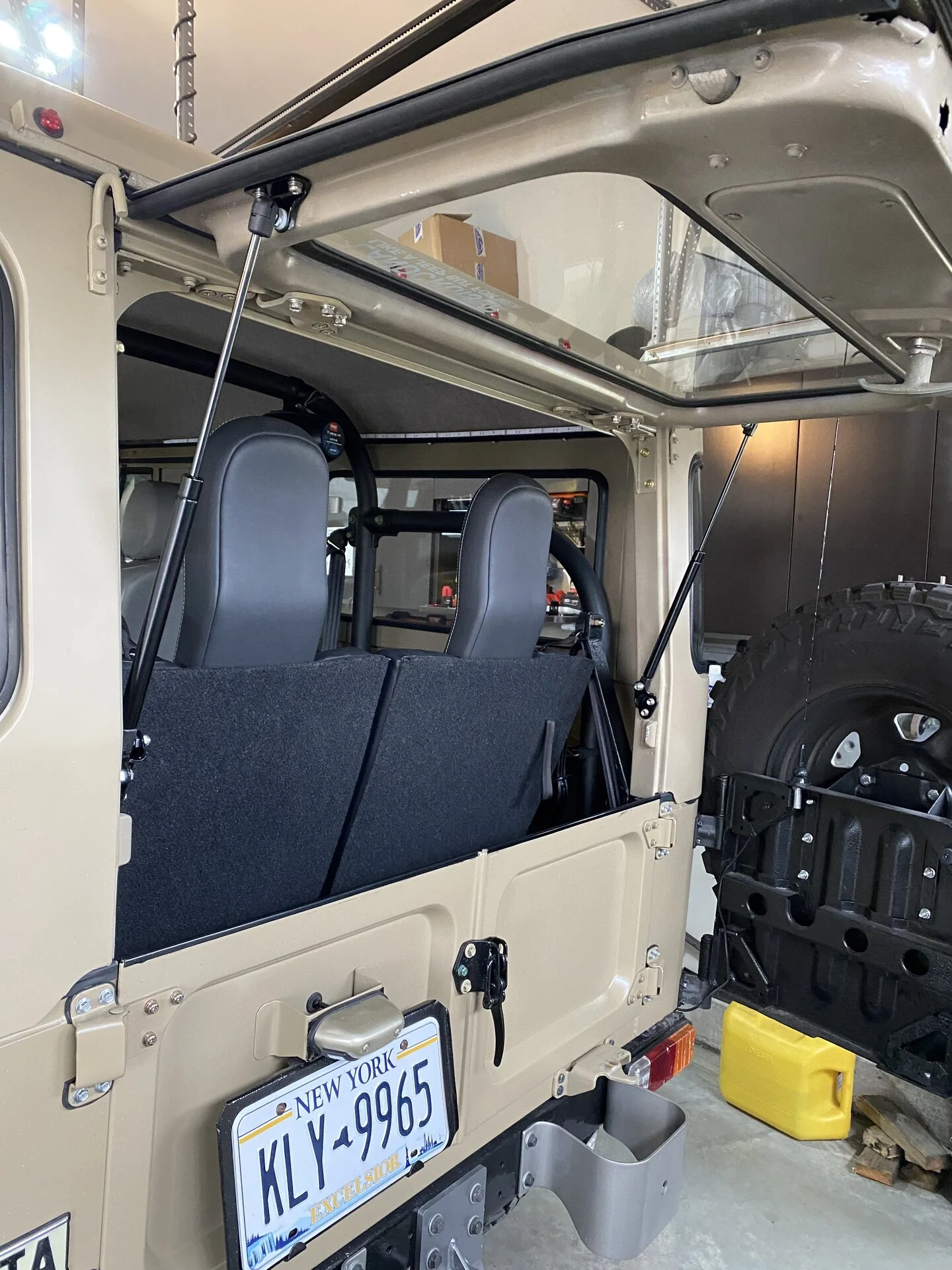

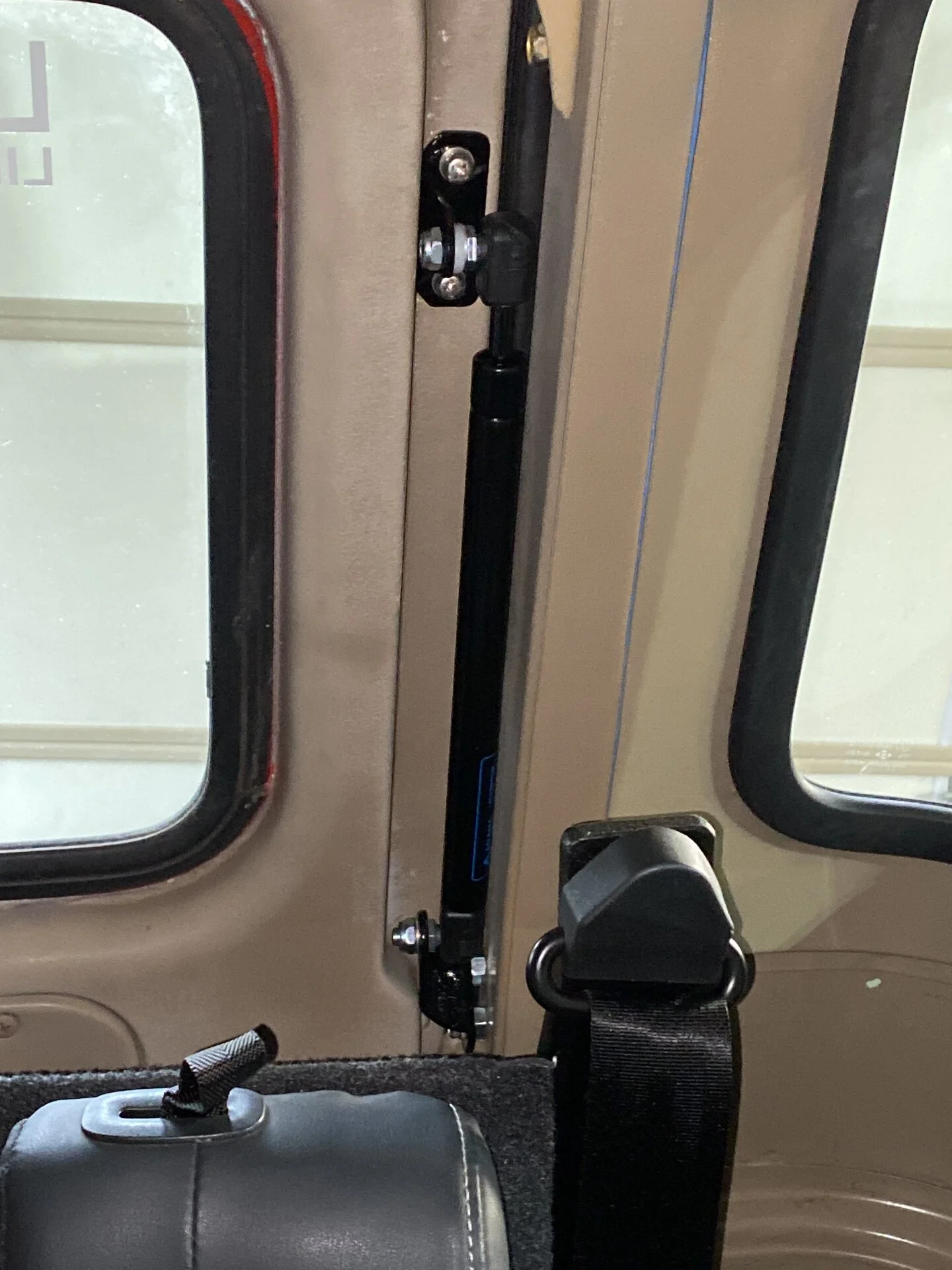

Here’s my latest adventure. The original lift shocks were trashed and I was too cheap to buy the CityRacer option so I got lucky ordering stuff from Amazon. I had to drill out the pin holes to make room for the shock studs and I flipped the top and shimmed out the bottom with extra nuts I had laying around. Super easy and works nice too. I believe I could’ve gone .5 to .75 inches longer on the lift struts if I wanted more height. I have the same lifted height as with the OEM.
Lift struts from Amazon Amazon.com - https://www.amazon.com/dp/B0B28PT9KG?ref=ppx_yo2ov_dt_b_product_details&th=1
Ball studs Amazon.com - https://www.amazon.com/dp/B076FJXJH5?ref=ppx_yo2ov_dt_b_product_details&th=1

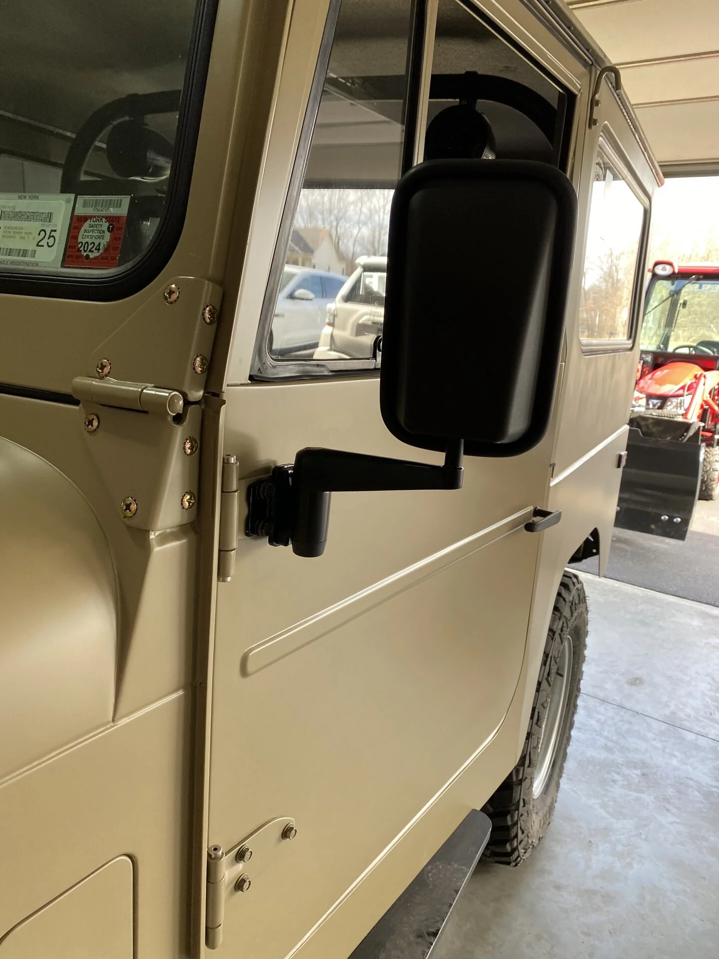

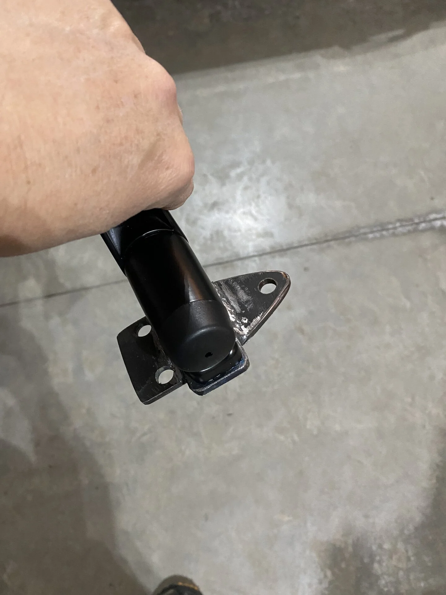

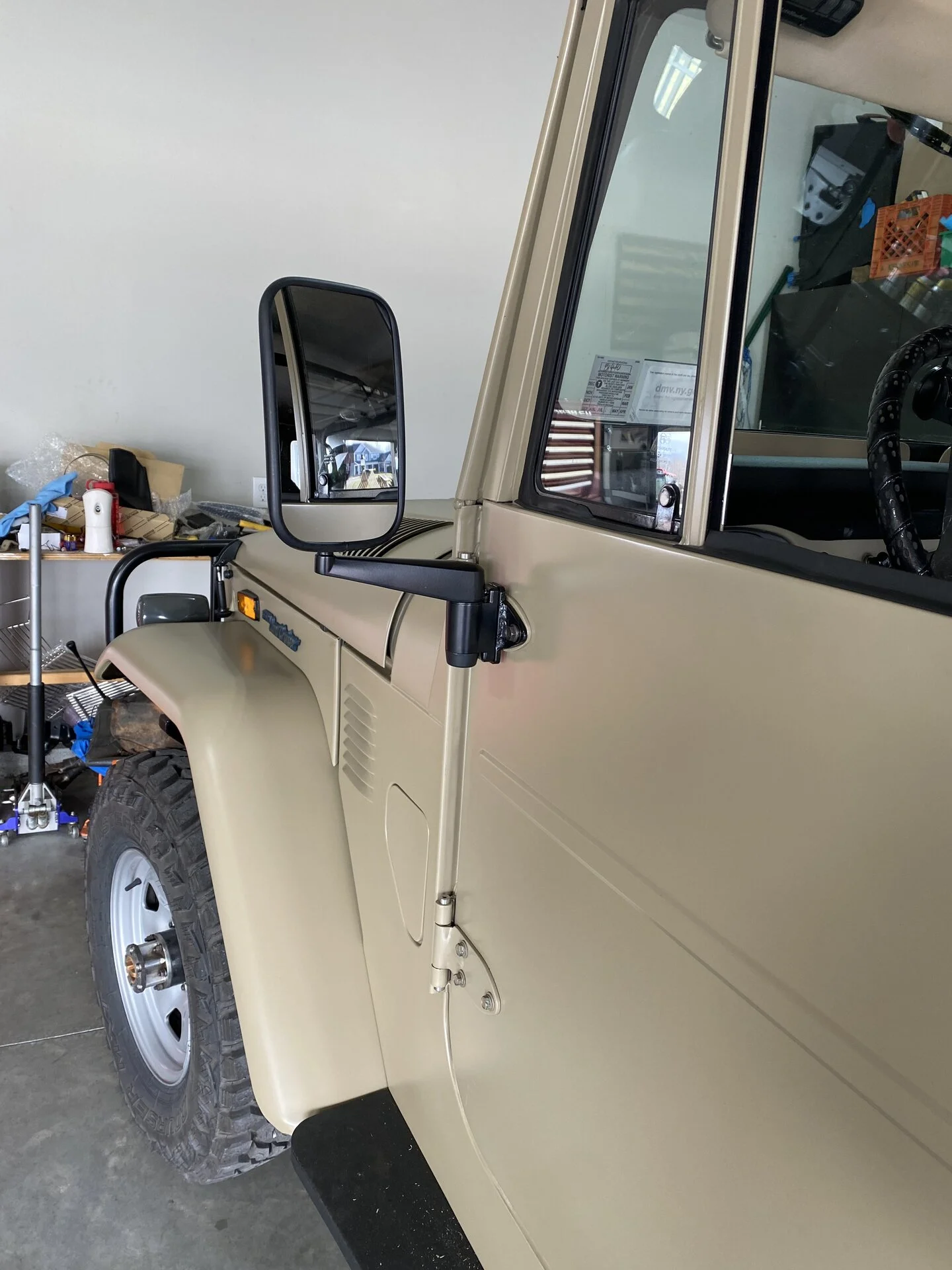

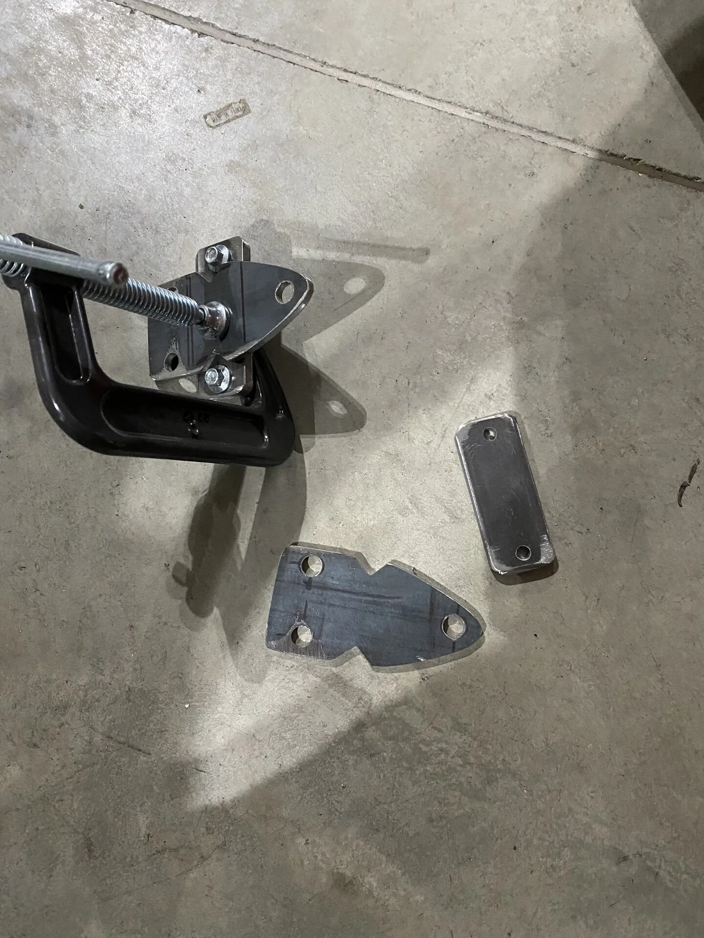

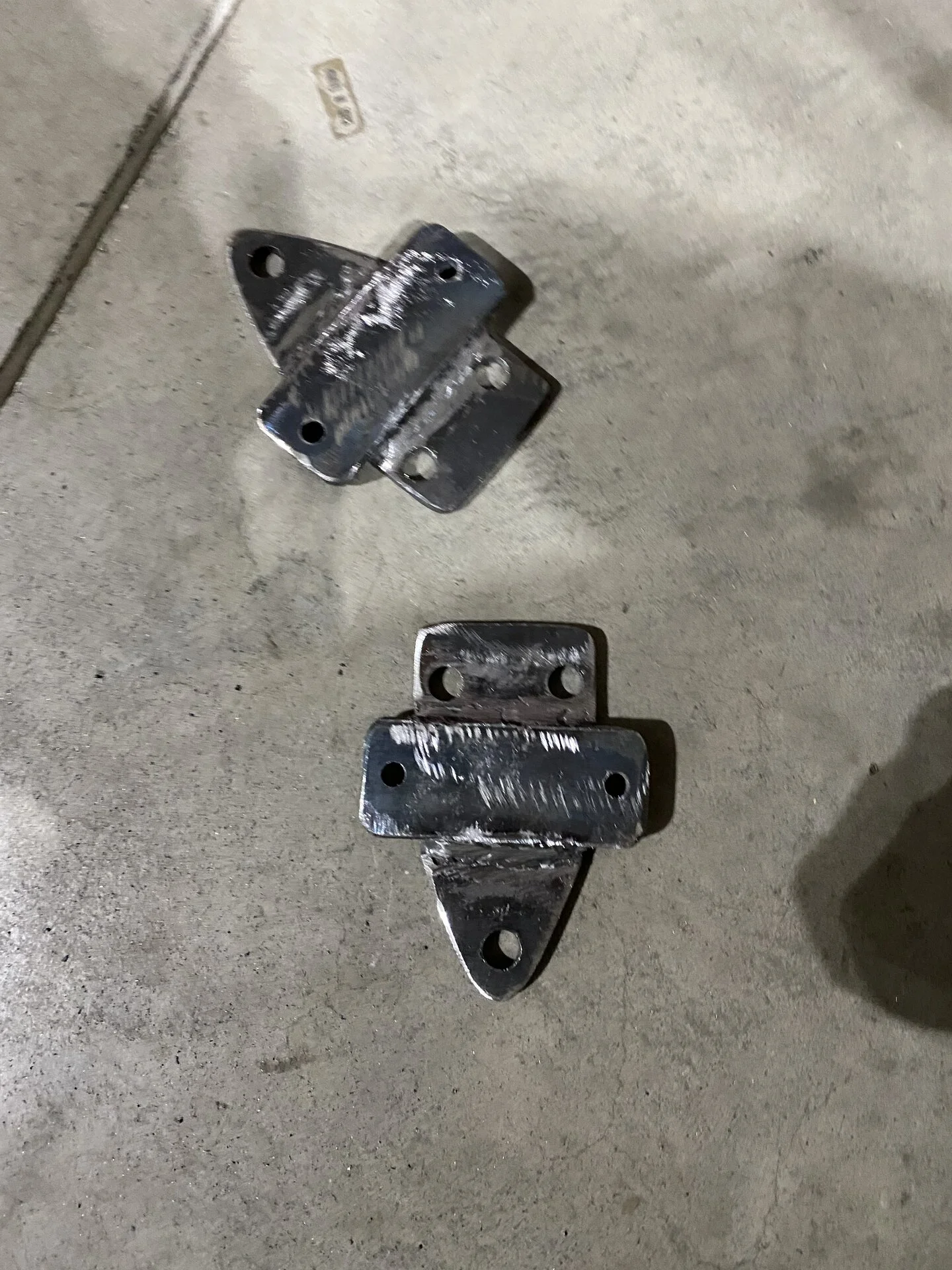

And another project is almost complete. I wasn’t crazy about the mirrors mounted in the windshield frame and I didn’t like the pre-75 model mirrors so I decided to build brackets to mount Land Rover defender mirrors. Many ways to do it, I went this route as I didn’t want to drill the door to mount the mirrors. Pretty stout and will snap out of the way it hit.
I love my defender mirrors, I chose to go the 3d printing route for that piece underneath. For those interested, there is a file here in mud w that info.

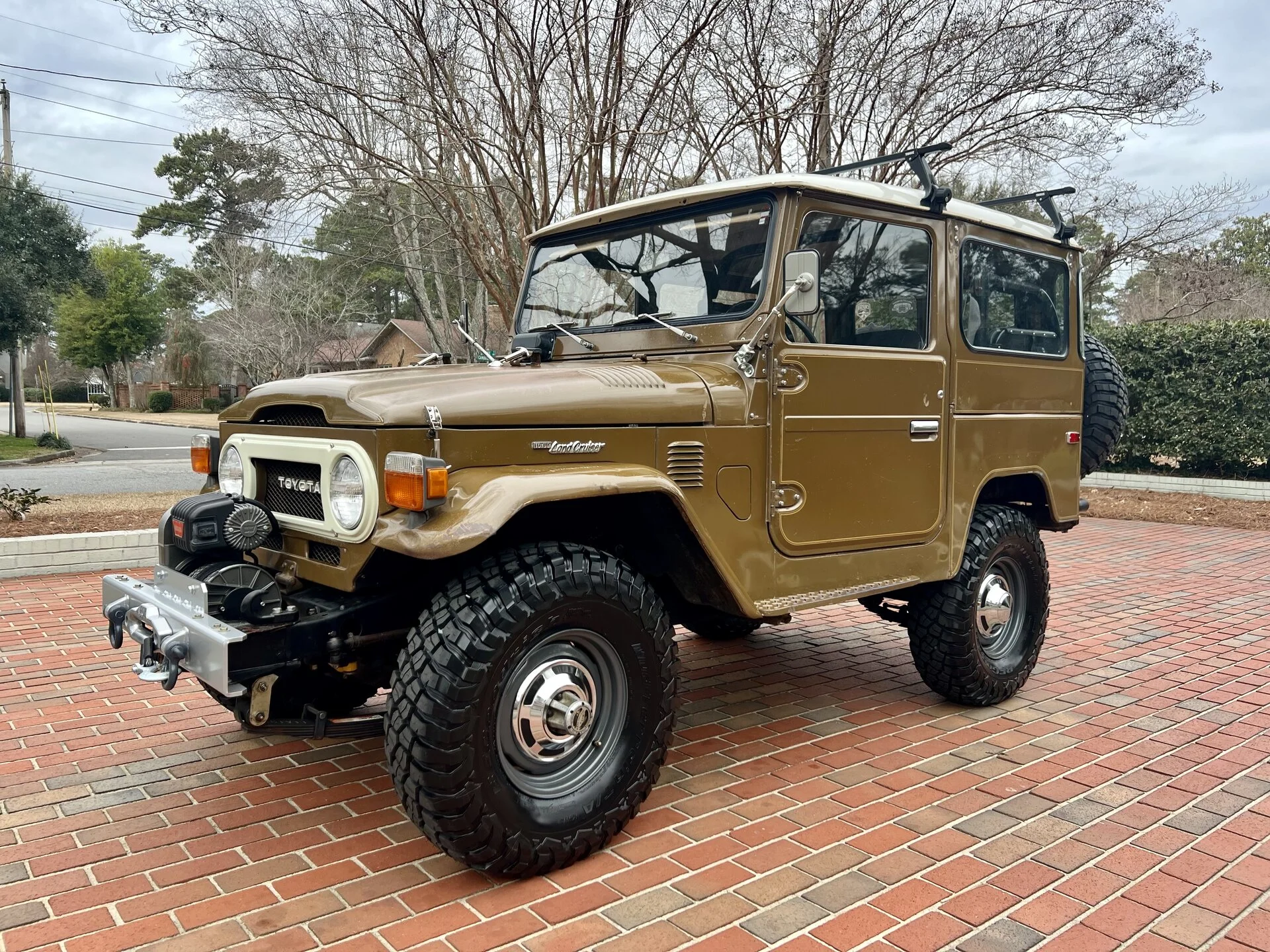

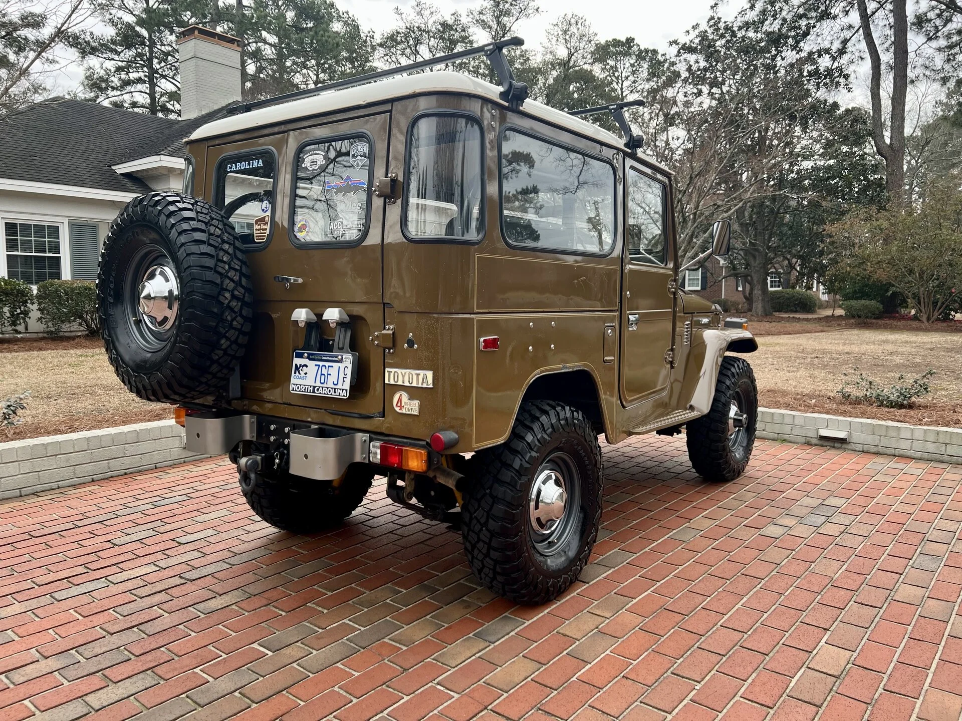

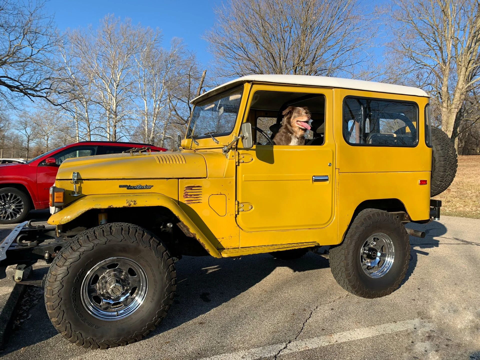

Finally replaced the old KM2s with the updated KM3s, absolutely amazed how much better it rides with fresh tires! Also put in a little elbow grease with some Meguiars #7 to get the paint shining a bit better and sealed it with Liquid Glass. Mr. T did a nice job with this single stage paint 48 years ago!
I like that color more and more every time I see it.
Thanks, it’s grown on me a lot over the years. Looks a lot more olive now, the pic below is the day I bought it - the paint was really oxidized and looked like a faded brown. Multiple applications of Meguiars #7, all by hand, and letting it soak in before removing completely changed the look a few years ago. This weekend just one application removed some mild oxidation and the paint is alive again!
